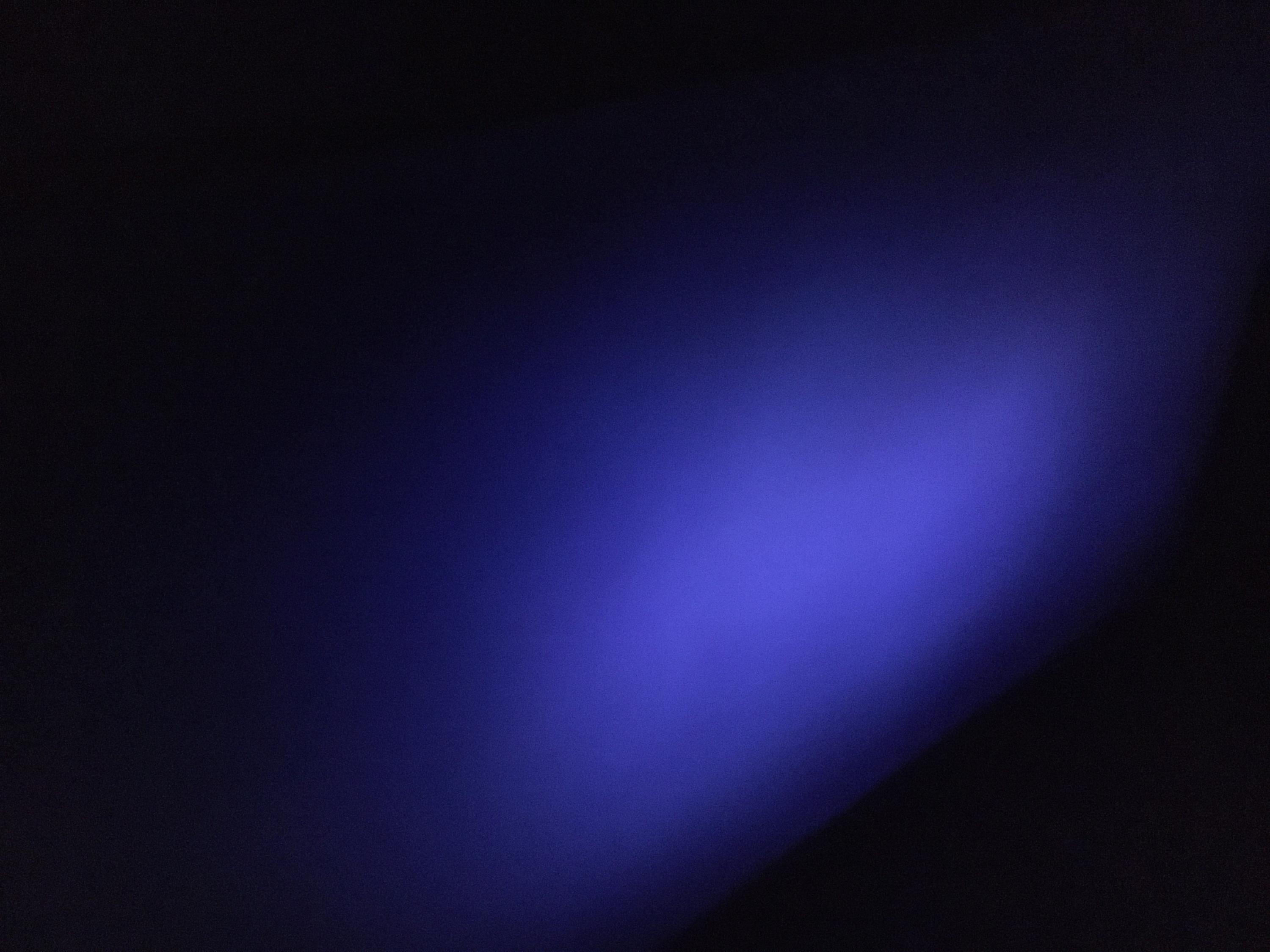

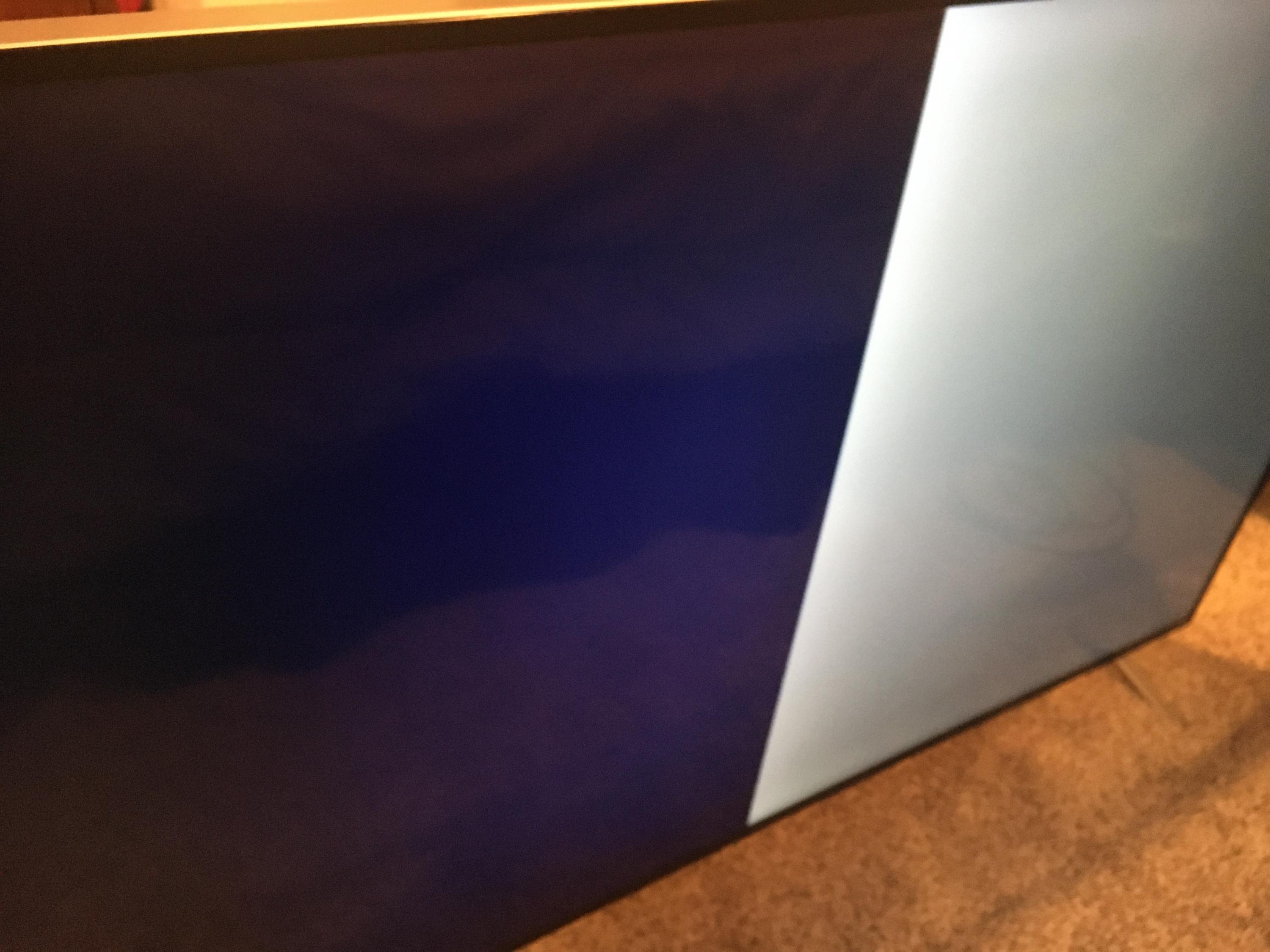

    I have an Vizio M60-C3 got it originally with a power on light and no picture would flash power light 15-16 times. Power board checks out and got a main logic board for it. It now powers with a bluish image, back light working. This post https://www.badcaps.net/forum/showth...ghlight=m60-c3
    Seems to show that removing the perimeter ribbon cable could fix it. Just want to make sure that's the next step. And a quick description of how if I mess anything up its ruined. Thanks for any help.
    Pic #1: Screen powered and menu lightens/darkens it
    Pic #2: White side is with T-con cable disconnected

      Everything you need to know about the side tab peel off is in this thread, a lot of times the tell tale sign was distortion and or horizontal __, not vertical | line/s:
      https://www.badcaps.net/forum/showthread.php?t=49281.

          My guess is either bad tcon board or bad panel.
