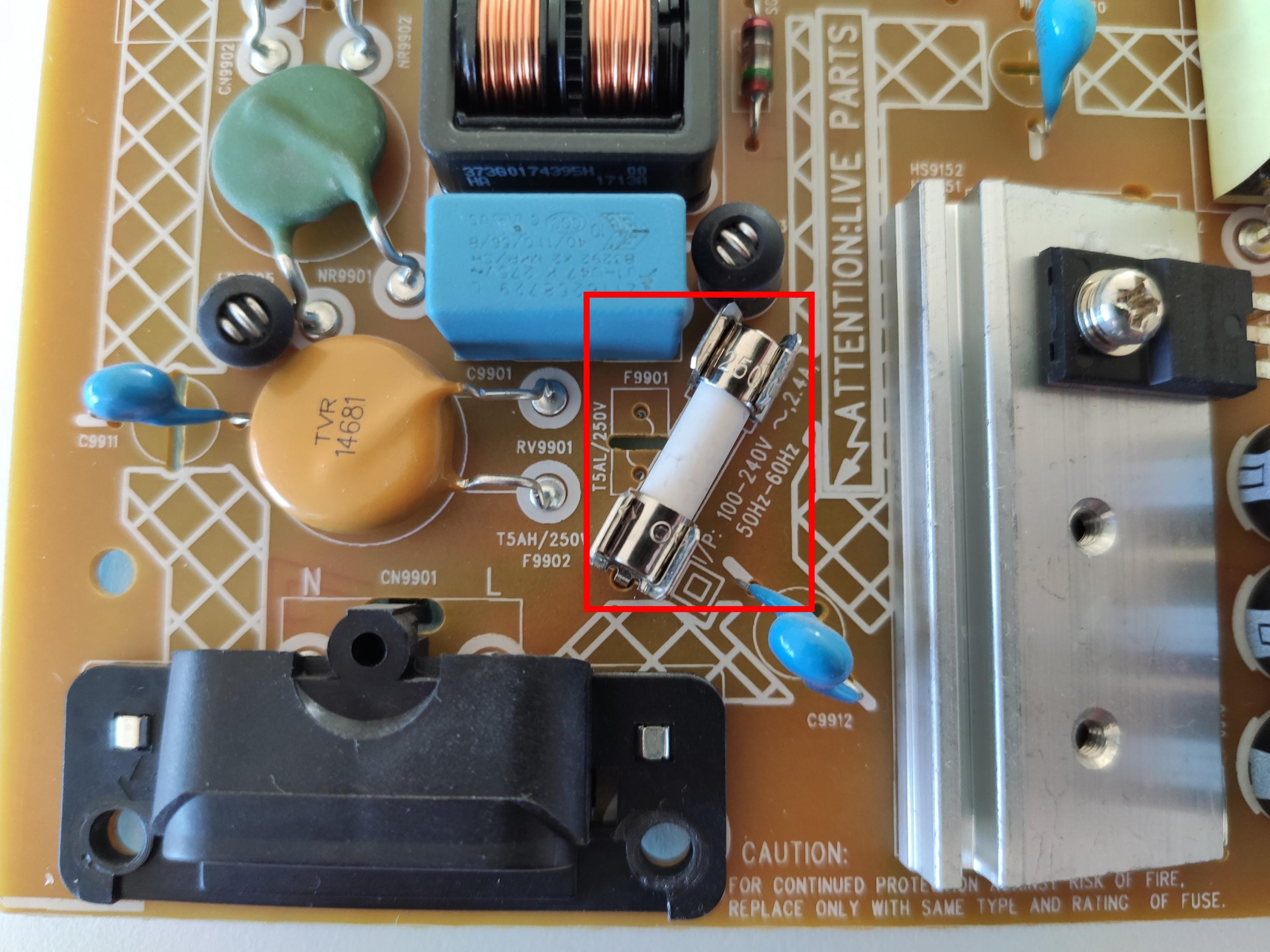

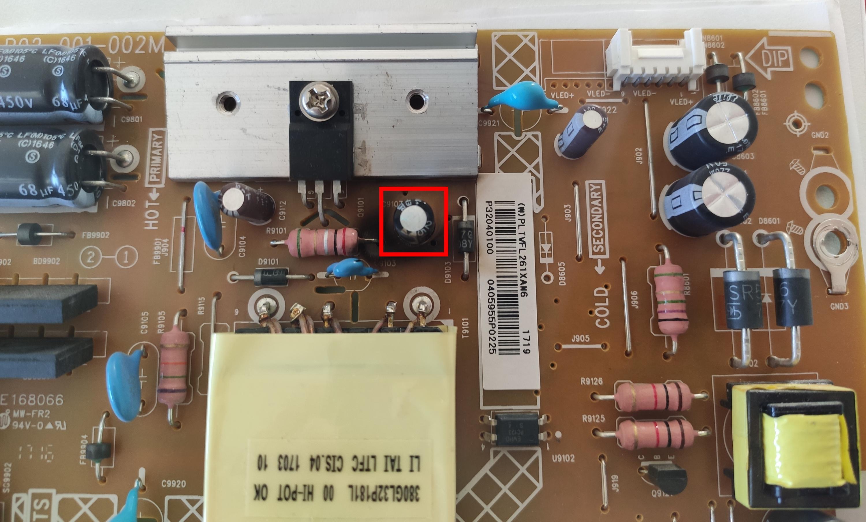

    Hello everyone! I own the TV as per subject that out of the blue with no apparent cause (I mean storms, black-outs and the like, obviously there was a cause!) went off. Immediately before I've literally heard an explosion (then, after opening it, I've understood why!).
    It was the C9107 capacitor literally exploded with a flame that had blackened the whole surrounding area. I also checked the input fuse, also gone.
    I replaced both components and, as I feared, just after reconnecting power I've got exactly the same result. Both components went the exact same way. To tell the truth (but I have to physically check the board which I don't have at hand now) looking better at the photo now it seems to me that the adjacent button capacitor C9103 is also damaged while the first time it wasn't so.
    The power supply is a 715g7364-p02-001-002M. I attach detailed photos and service manuals of both the TV and the power supply (the power supply one is for the 715g7364-p01-001-0020 but everything matches).
    Could you give me a tip? The replacement board seems impossible to scour... Above all, given the massive damage is it worth looking for a replacement or attempting a repair or is it likely that the motherboard and / or the screen have also been damaged? Thanks everyone and have a nice day!

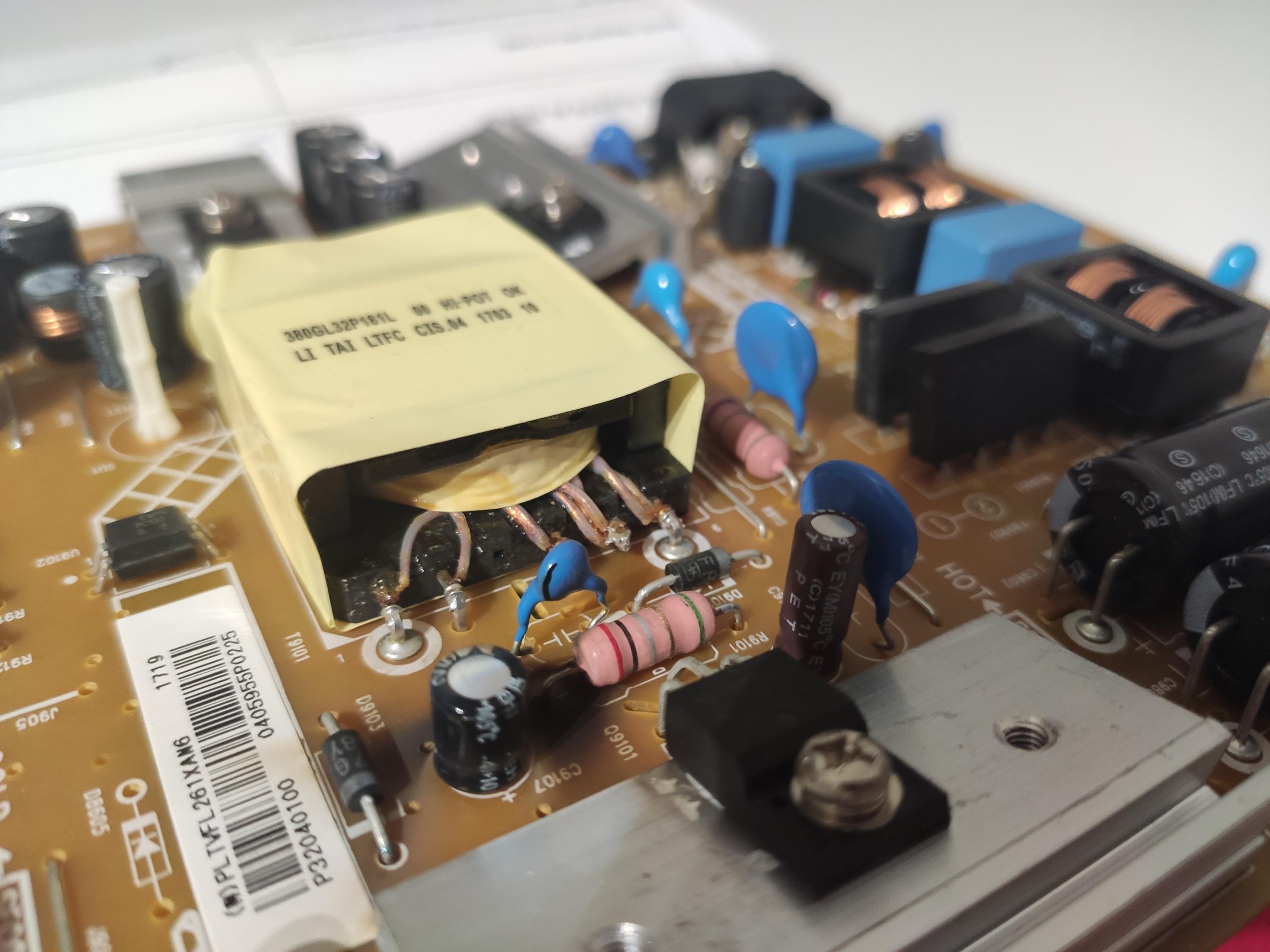

    Re: Philips 32PFS6402-12 qm17.4e_la repeating PSU capacitor and fuse blow up
    Are you sure it was that capacitor that went faulty. It tends to be the snubber capacitor (C9103) for the mosfet (Q9101) that tend to go faulty in the manner you describe.
    Check C9103, Q9101, R9101 & D9101
      You can see (in the picture) that C9103 is damaged and likely shorted. It will be rated at 1kv replace it with a 2kv
        Hi and thanks for your help as always. We've already 'met' and you've always been very kind and free to help! I can confirm that even C9103 is gone (it wasn't so the first time, at least apparently). I attach a detailed photo.
        What's certainly damaged are the fuse, C9103 and C9107 (the right naming for the previously attached photo is ali_c9107 and not ali_c9103 as I've mistakenly written). I would test Q9101, R9101 and D9101 (what about D9103?). I assume all of them need to be desoldered, don't they? Could I make the check in circuit just to see if the diodes are shorted? I don't know but for R9101 and Q9101 I'm rather certain I need to desolder them, the main problem being Q9101: I haven't ever desoldered a mosftet and apart from the screw I imagine it is bonded to the heatsink with thermal glue; I could try with a cutter but I fear to damage the packaging...
        Thanks for your help and the advice about the rating. I would take it into account. As I was previously explaining, you're right: I can confirm even C9103 is gone.
          Hello again. I've checked on the service manual and both D9103 and D9101 are FR107G-A0 rectifying diodes 1kV 1A. Is a 1N4700 a suitable replacement? It should according to the specs if I'm not missing anything...
          C9103 is a 1kV 100pF and, as adviced, I would replace it with a 2kV 100pF.

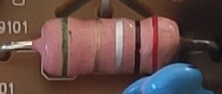

          For what concerns R9101, on the service manual I read only 0.2R: shouldn't I have also a Wattage and percentage? What does 0.2R mean anyway? I apologize for the dumb question but I've made a search and I couldn't find an answer.
          Finally, Q9101: a N channel 18A 650V 50W to-220f transistor (AOTF18N65).
          As already asked: is there a quick way to check them in circuit or do I have to desolder everything? Thanks again.
            The 0.2R means the reistor is a 0.2 ohm resistor. Not sure of the wattage. Attach a picture of it.
              The picture is attached. Please tell me if its quality isn't good enough.

                Look again in Mouser for 0.2 ohm (200 milli ohm) metal oxide axial resistors and compare the size shown on their data sheet to the one on your board which hopefully will match one of their 1 Watt, 3 Watt or 5 Watt versions.

                  Just a note on NEW resistor wattage sizes from some manufacturers, I ordered some 4.7Ω 1watt (Yageo brand) from digikey and they were about the size of old 1/4 watt resistors. I checked the datasheet and they were correct wattage for their physical size.
                  I have new replacement resistors rated 1/2 watt but are also older 1/4 watt size.
