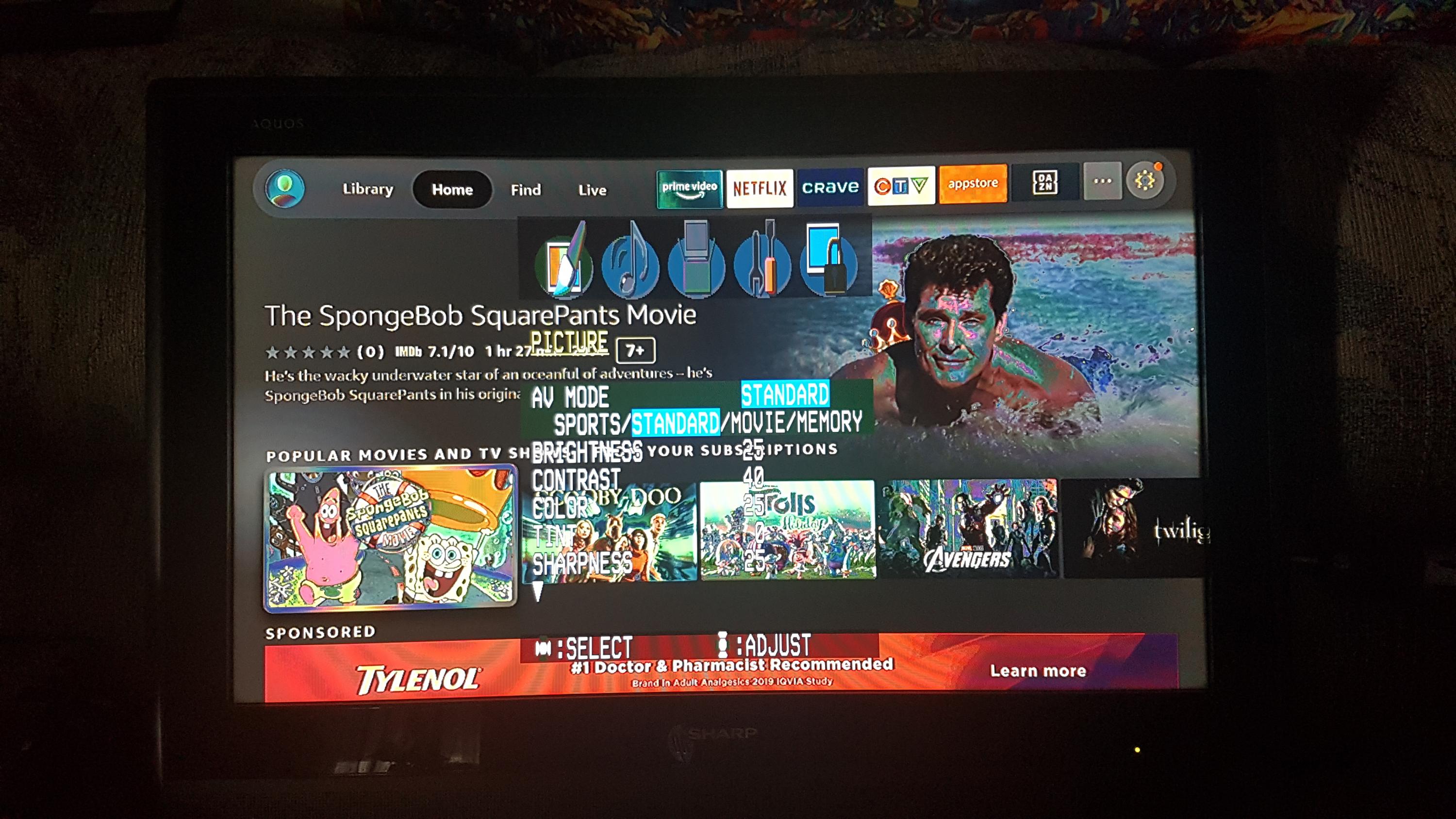

Sharp LC-32D40U Negative picture unless the contrast is almost 0
  • MikeRWK
    • Jun 2017
    • 121

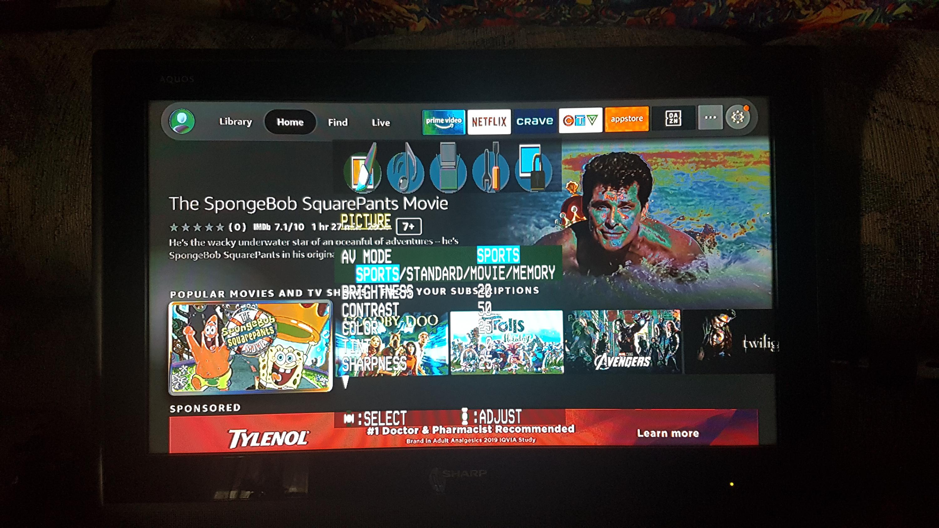

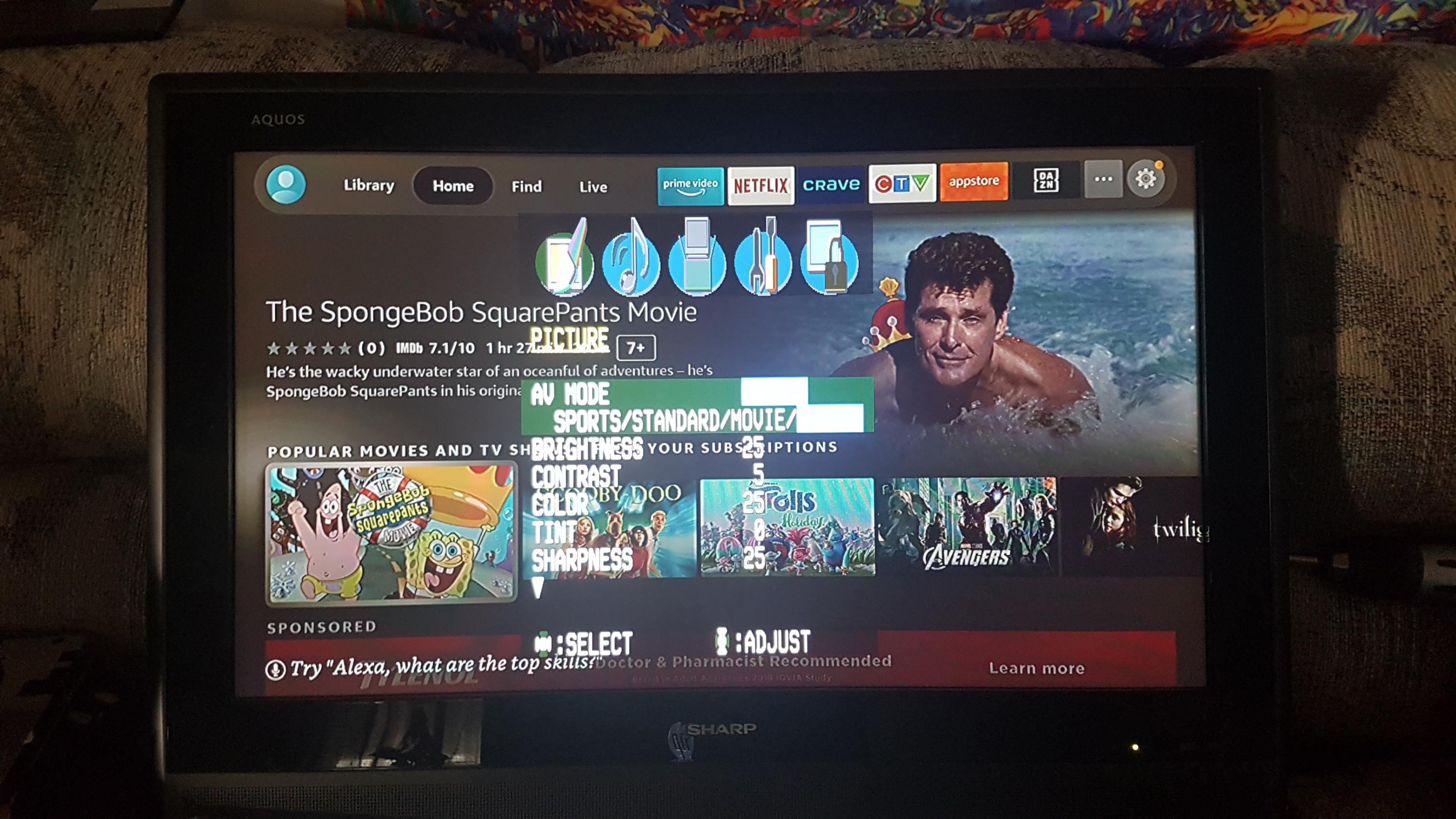

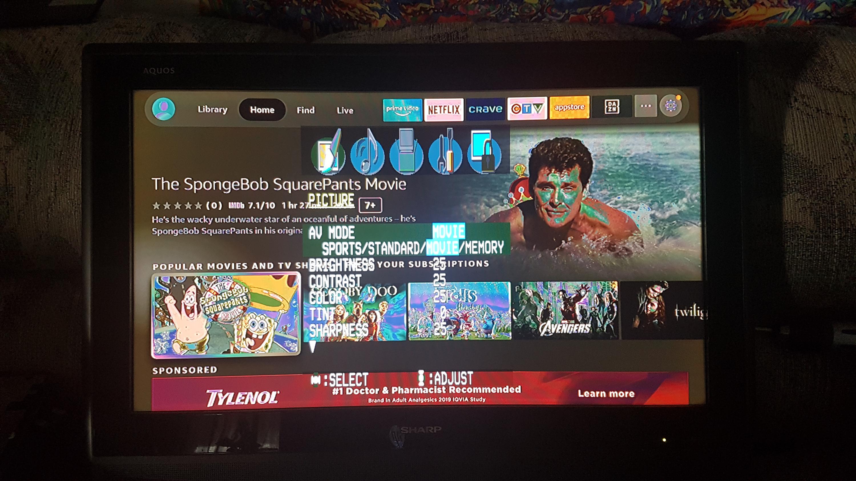

    This only affects the picture but not the tv menus. Selecting any of the default picture settings gives a negative picture but turning the contrast down to 5 'fixes' it but then the tv is too dim which is hard to tell in the pictures.

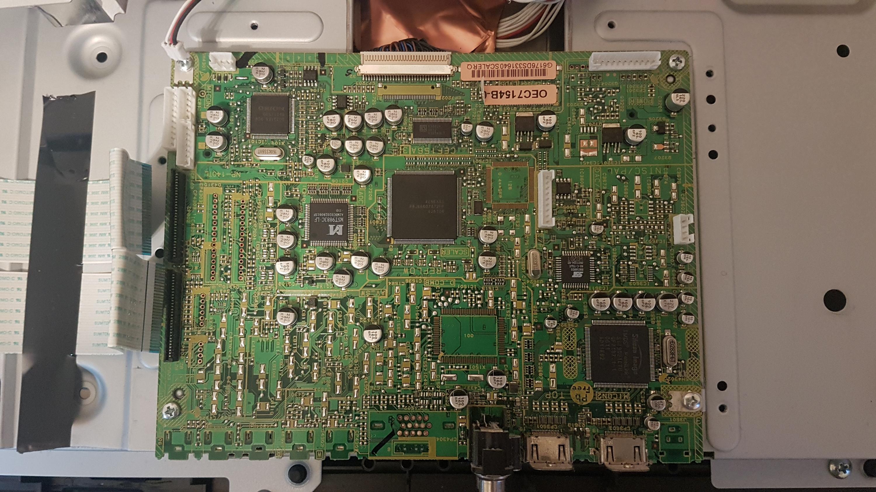

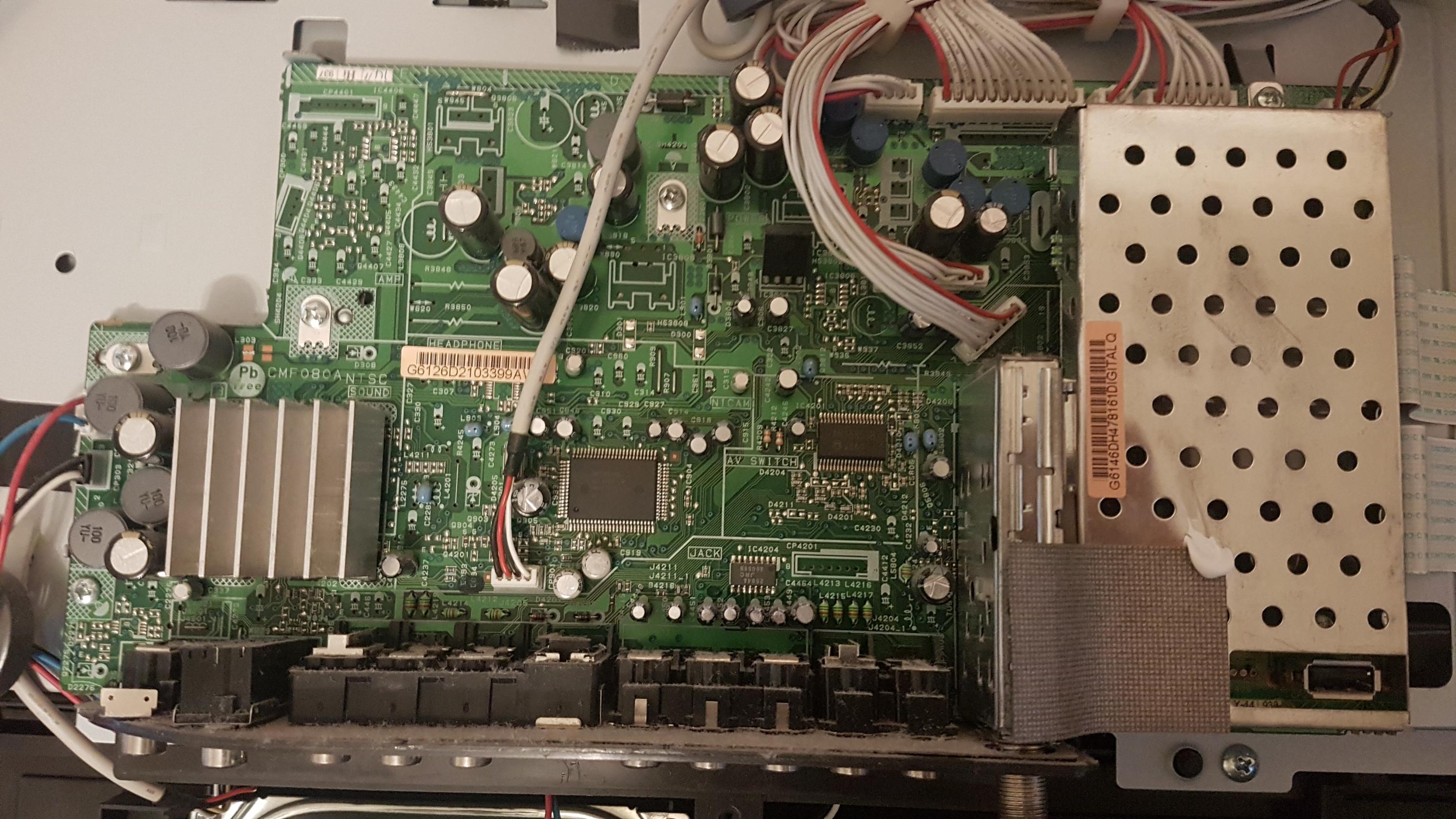

    This tv has a main board, scaler board, and a tcon.

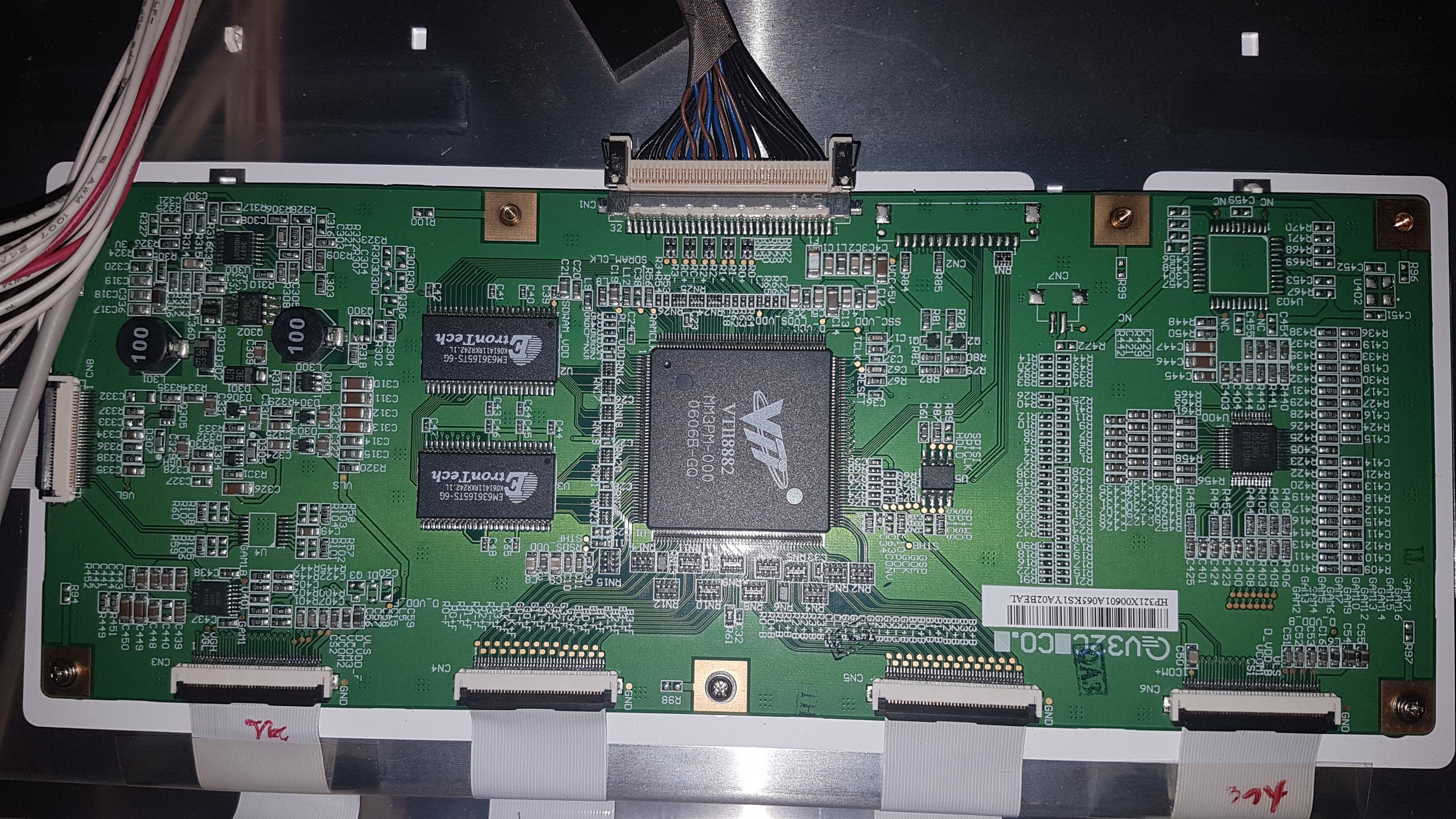

    I tore it down so I could probe the tcon which is nicely labelled. I've also included a pic of it.Here are the voltages I got:
    VGH 32V
    VGL -6V
    GAM1 14.6V
    GAM18 185mV
    VLS 14.67V
    3V 3.01V
    RESET 2.95V
    TCLK 0V
    SCC_VDD 2.99V
    D_VCC 2.99V
    VCC+5V 4.9V
    D_VDD 2.98V
    VCOM3 6.58V
    VCOM2 6.57V
    CS2 6.57V
    SDRAM_VDD 2.99V
    PLL_VDD 2.99V
    RSDS_VDD 2.98V
    STHF 0V
    D_VDD_F 2.98V
    LVDS_VDD 2.99V
    D_VDD_B 2.99V
    VCOM1 6.57V
    CS1 6.57V
    1COM+ 6.41V
    SDRAM_CLK 1.46V
    RAMCLK 1.44V
    STHB 0V

    Re: Sharp LC-32D40U Negative picture unless the contrast is almost 0
    Check all the gama voltages 1~18. The fault is likely the AS15-f
    gam1=
    gam2=
    gam3=
    etc.
    gam18=
    the voltages should be linear: something like 1,2,3,4,5,6,7,8,9,10 etc. and not 1,2,8,9,5,6,7
      gam1=
      gam2=
      gam3=
      etc.
      gam18=
      Here are the voltages, I couldn't find points GAM8 or GAM11.
      GAM1 14.58V
      GAM2 14.22V
      GAM3 12.08V
      GAM4 11.27V
      GAM5 10.65V
      GAM6 10.21V
      GAM7 10.05V
      GAM8 --
      GAM9 8.25V
      GAM10 7.16V
      GAM11 --
      GAM12 5.18
      GAM13 5.07
      GAM14 4.79V
      GAM15 9.37V
      GAM16 3.45V
      GAM17 0.65V
      GAM18 0.18V
      • nomoresonys
        • Jan 2013
        • 12206
        • U.S.
        Yep, bad, 8, 11, 15, need new gamma chip or tcon board.
        • MikeRWK
          • Jun 2017
          • 121
          I meant I can't find physical pads for 8 and 11 but i think you're right
          • nomoresonys
            • Jan 2013
            • 12206
            • U.S.
            Voltage on 15 should be between the voltage of 14 and 16, like around 4 volts or so.
            • MikeRWK
              • Jun 2017
              • 121
              Looks like i'll be ordering a new ic
                I think the pc board numbering is wrong, I believe there should be 15 (14+1) test points
