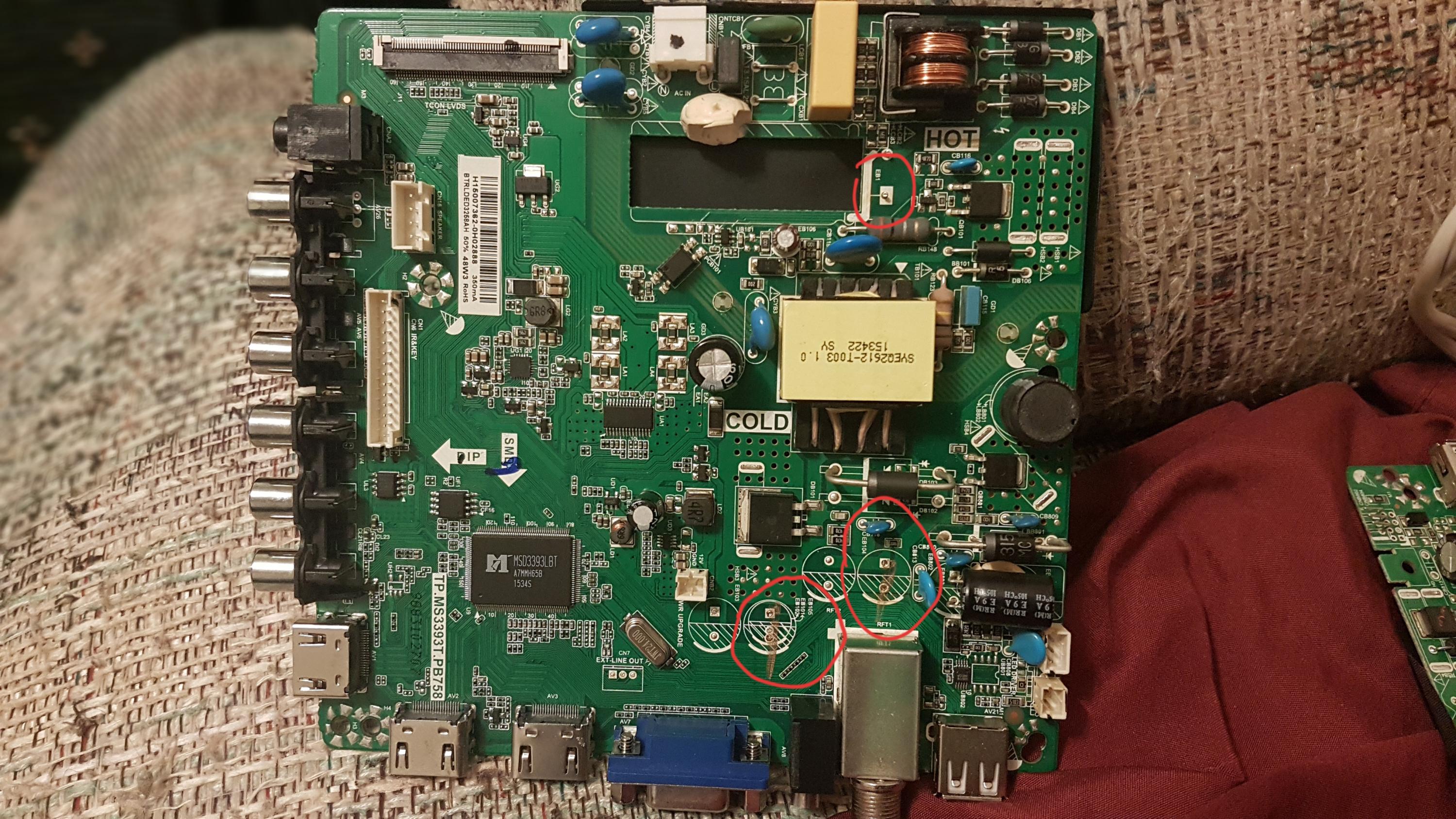

    I stupidly borrowed capacitors from this board without noting what values they were I need the values for locations EB1, EB105, and EB101.

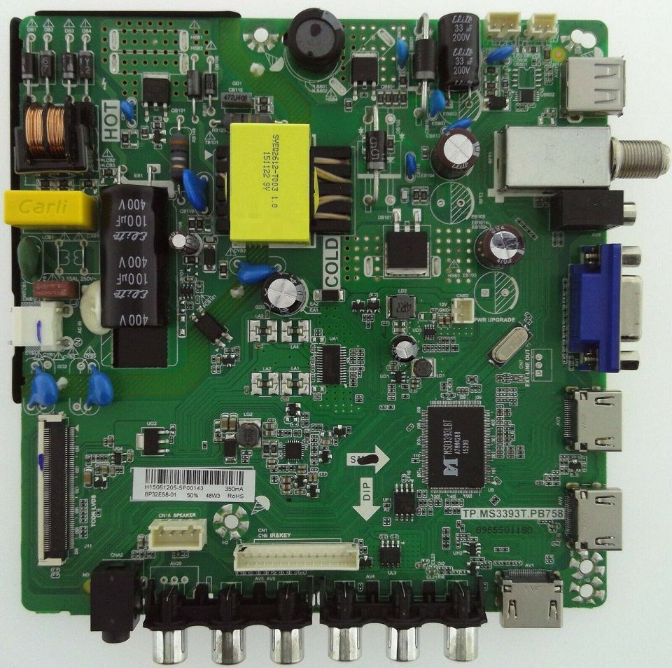

    Looking at the boards at Shopjimmy the large capacitor 100uF @ 400Vdc
    The one missing by the blue connector 470uF @ 25V?
    The one nearest satellite input ??uF @63V

      Those sound right, thanks.
