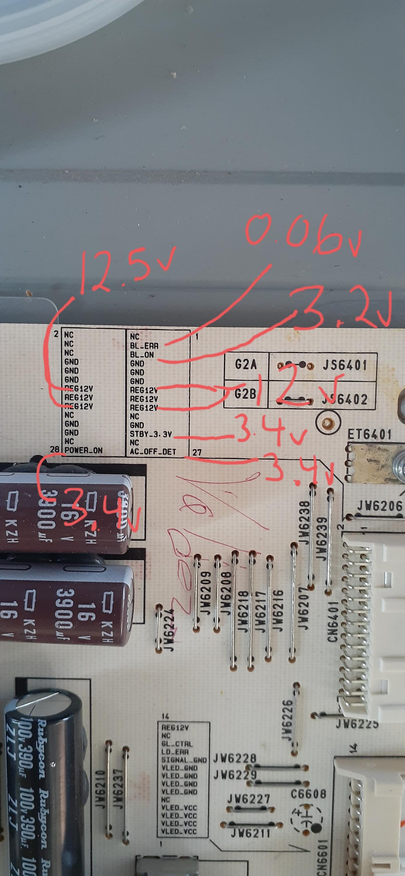

              So what i think the main is not giving the pow_led or bl_on
              Backlight_on...but i dont know what the voltages should be present in order to backligth to work..

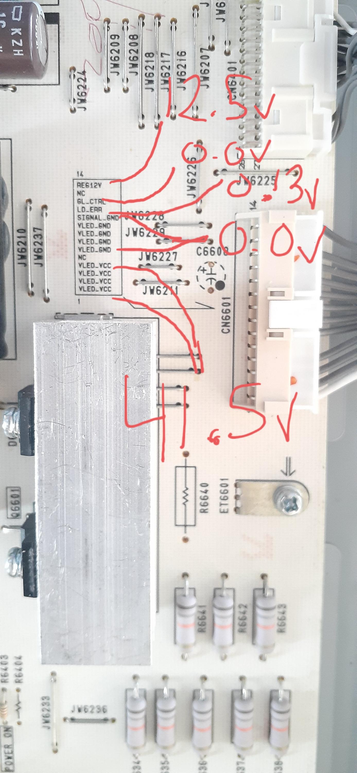

                #47
                Re: Sony KDL-70W850B T-CON problem
                This is where most testing should start: Start with testing the voltages at the connector on the powerboard CN6401, see the legend/map right there by the 16 volt caps, with EVERYTHING hooked up, you measure them with your mutimeter, set meter to 20 vdc then report them, put neg probe on chassis metal ground, pos probe on pin of connector, measure in standby take note, leave probes where they are then power on tv and again take note of voltages, report them here, example pin 1-ps-on-0 volts standby-power on-3.3 volts. Look closely the pins are numbered, see where 1,2,27 and 28 are labeled? you may need skinny end probes to get the readings on the bottom, I usually use a stripped bread tie or small paper clip to make connection if necessary.

                  #48

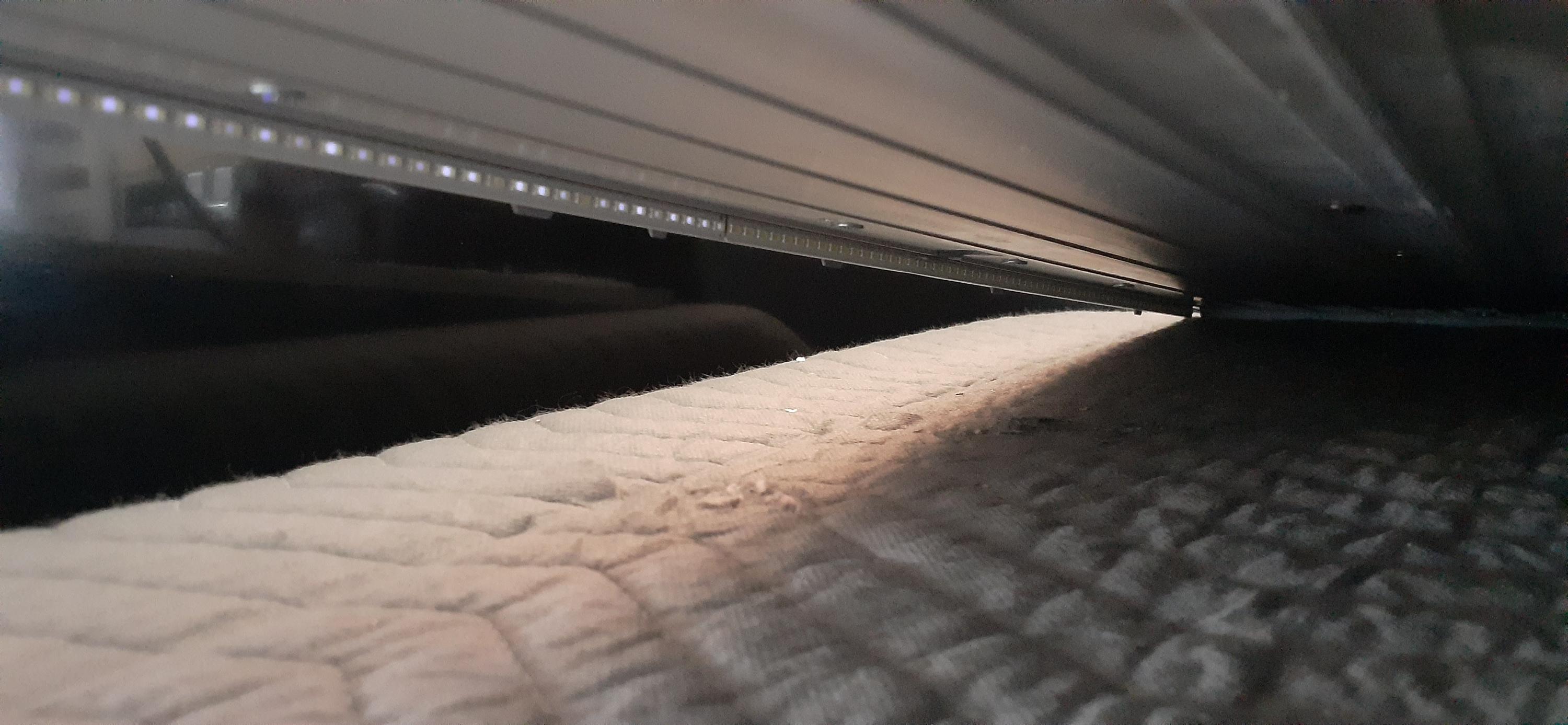

                    #49
                    Took out the screen... with led tester work great every single line work on both sides... and the picture above is with the tv on and thats how they look very low dim but just only on the seccion on the top and on the bottom the nothing and both sides

                      #50
                      flip it so you can see correctly after you turn it on.. you can record it with camera to see the off side did they blinks once shortly at turn on.

                        #51
                        I did turn up side down the tv to see if it blinks, but nothing happend. I just see very low dim like vearly see the dim..i test them again with other advance led test and evrything work well...so my theory should be on the main...or etheir the the service menu i think there should be a backligth switch on and off maybe.

                          #52
                          forget the LED tester.. spend time to test each LED with yours digital meter.. if yours DM 9V batteries then with Diode mode the working LED should light on Dim and if you reverse the probe it should read zinner diode 0.75 to 0.58 ( depend on the LED Type) if no reading mean its defect open. or with beep ton to see if it had shorted zinner.
