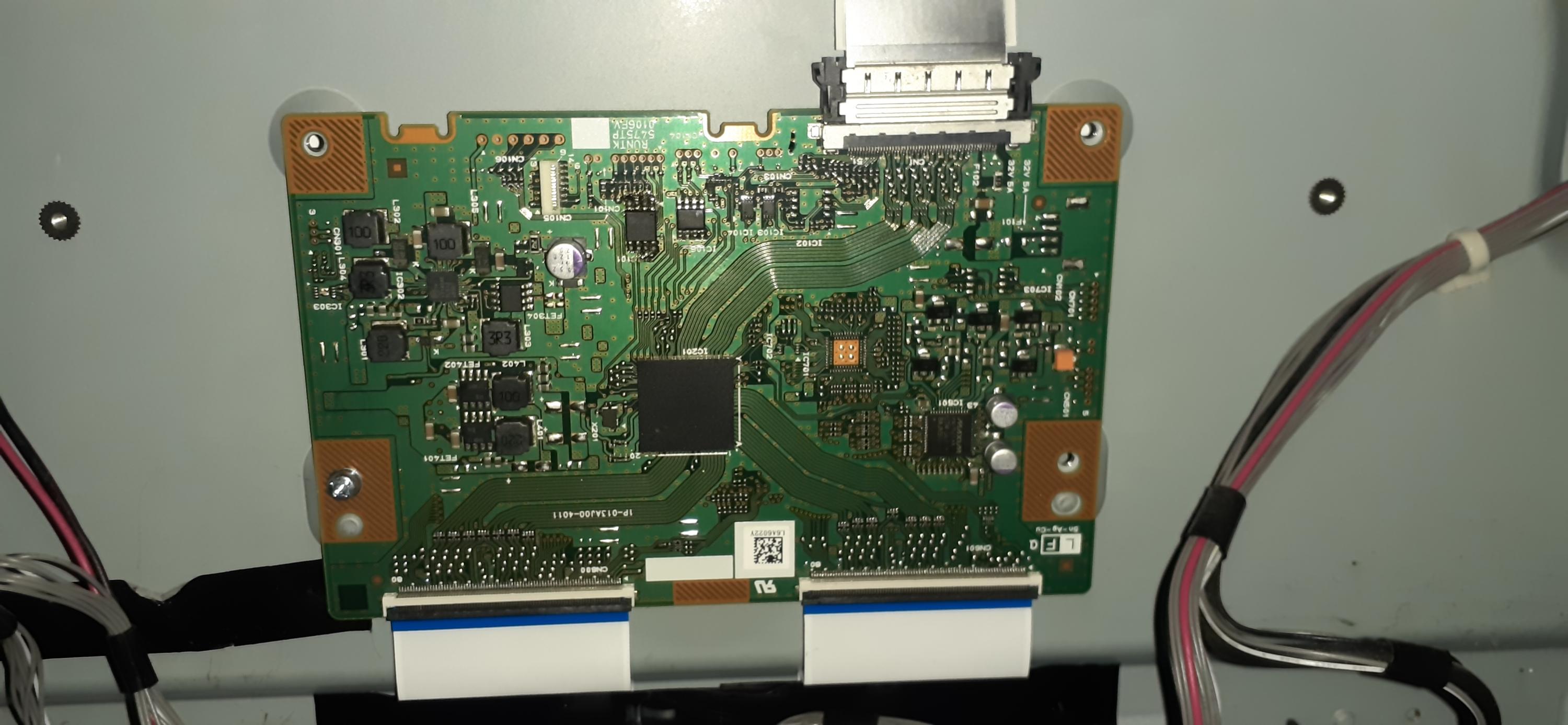

            Re: Sony KDL-70W850B T-CON problem
            T-CON replacement dont need any pair at this sony. the T-CON must be 100% for the same model and screen size.. but if the original are defect and it register 5 blinking error ,, then need to clear the error at self diagnose service menu..pairing and adjustments need only if Main boards or tuner replaced..
            so..
            why you changed the T-CON ??
            put back yours yours original T-CON in place and turn on to let the set running normal again..... and show us clear photo on the boards and the issue you have.

              The problem of the tv with original t-con is that when tv is turn on works great all day once its to be turn off you cant turn it back on it gives green and orange ligth...i need to unplug it and it will turn on good until its turn off....so did change t-con new and does not come on green and orange ligth

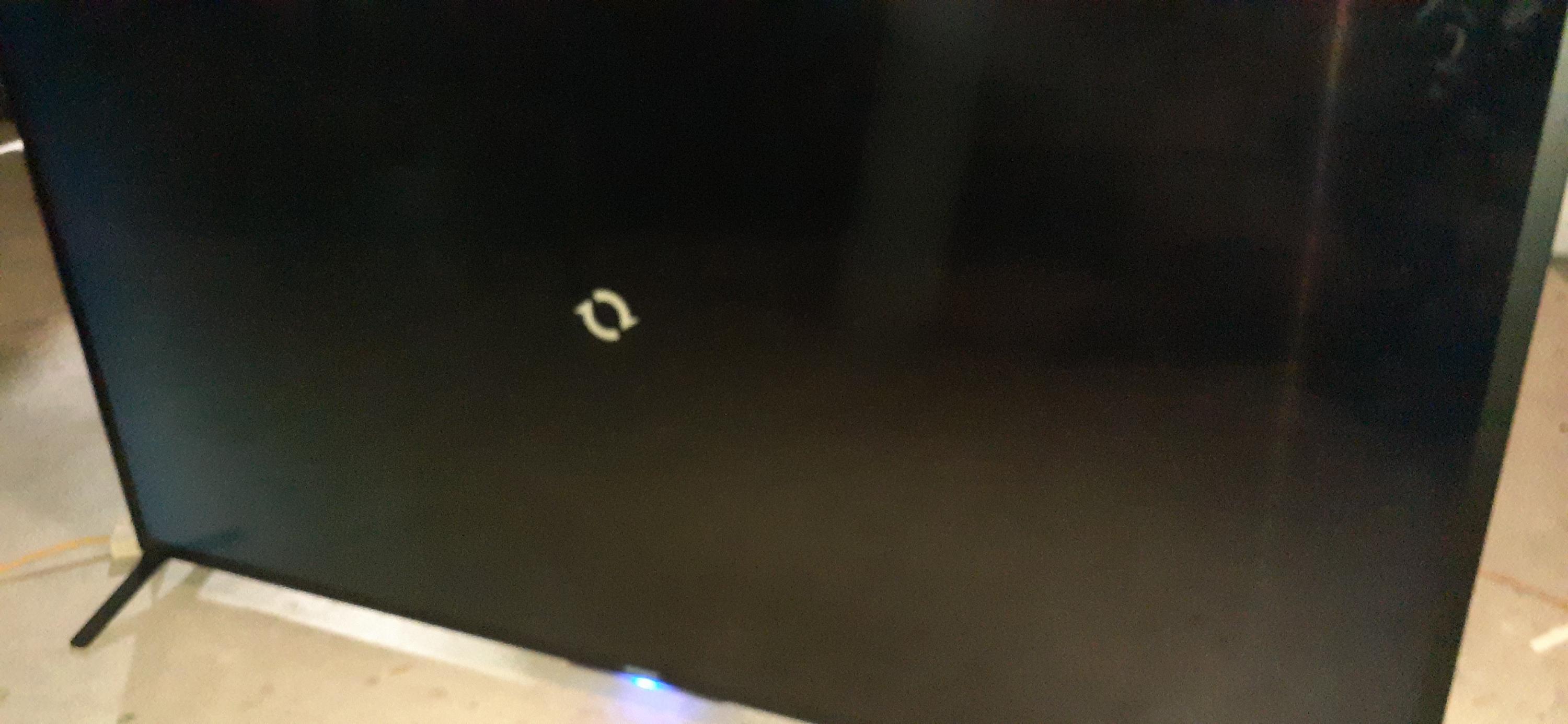

                This what happens with new t co....to get to this ...i had to press and hold power button and plug to ac/outlet and gives me the circle just going like buffering..and stays like that...
                  The ligth change to blue..

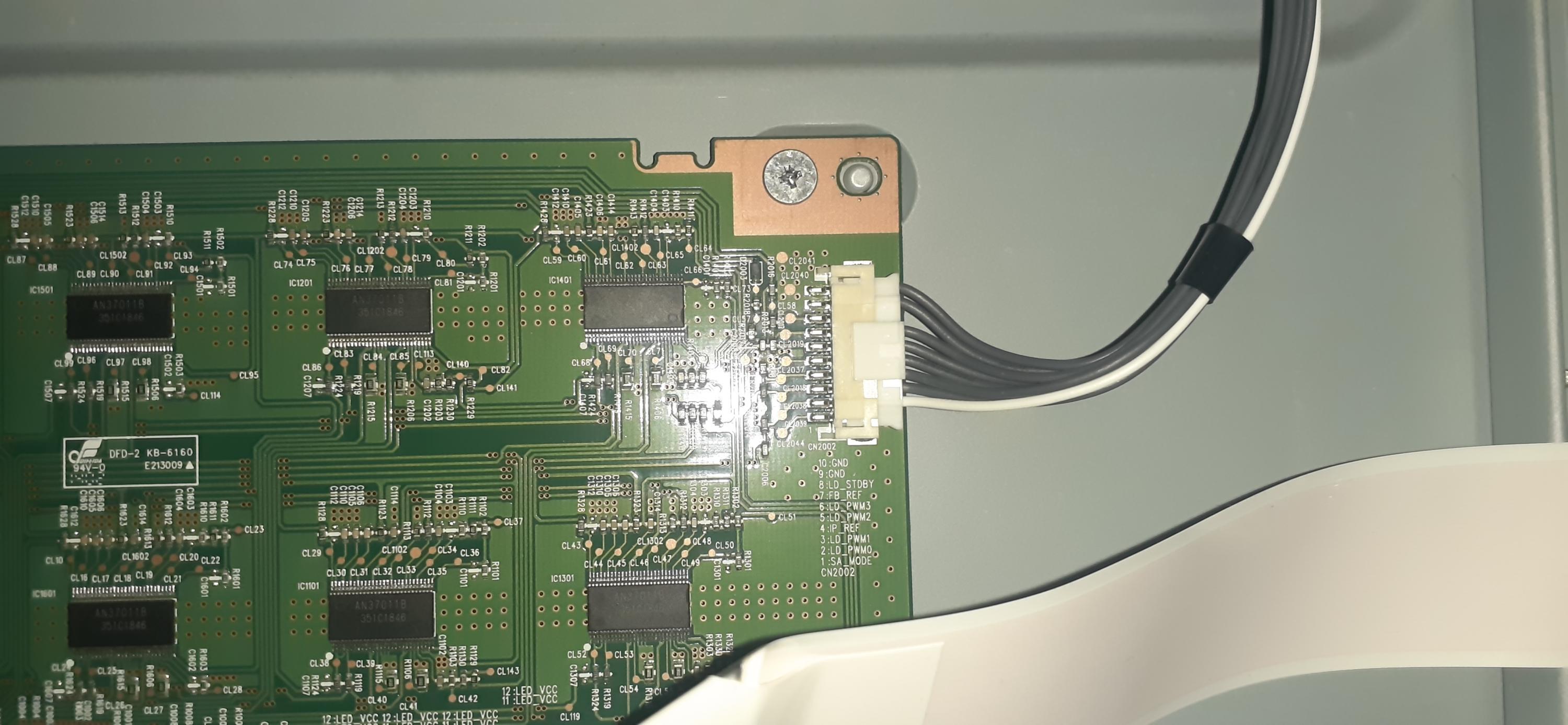

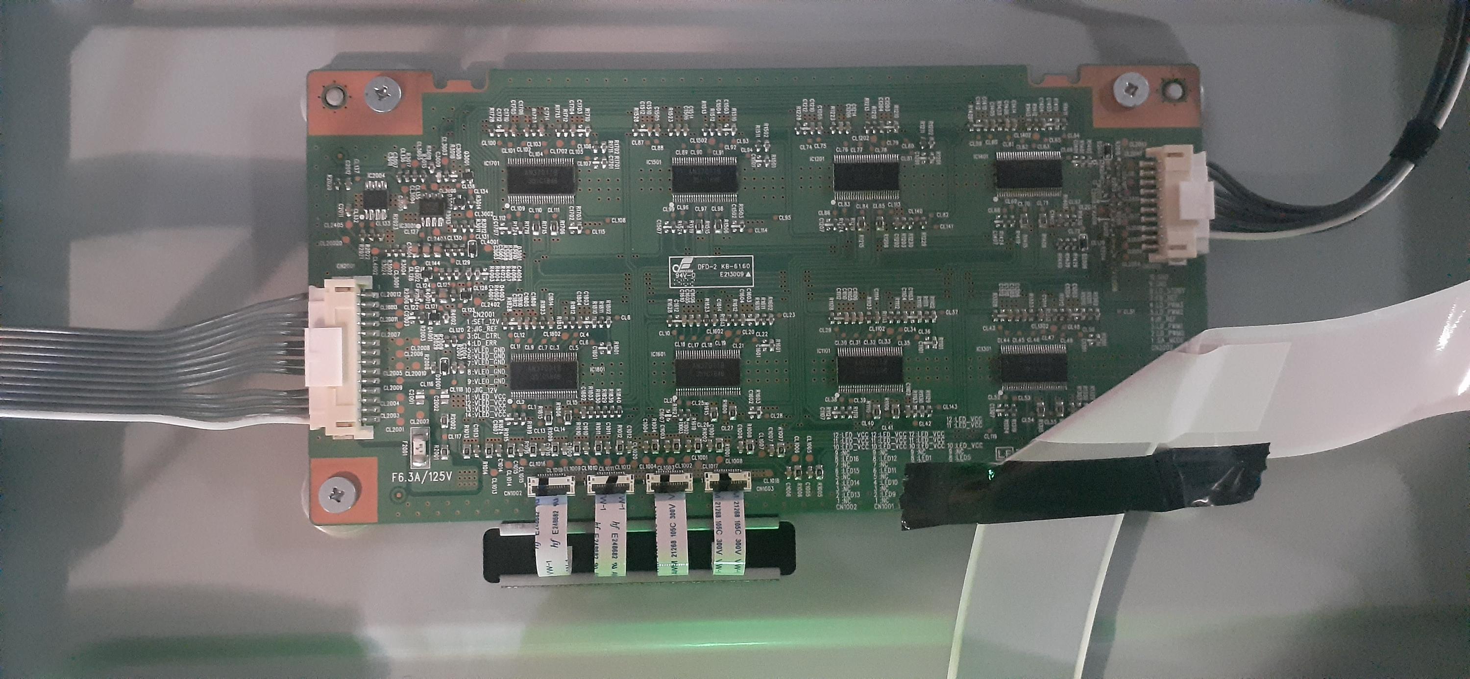

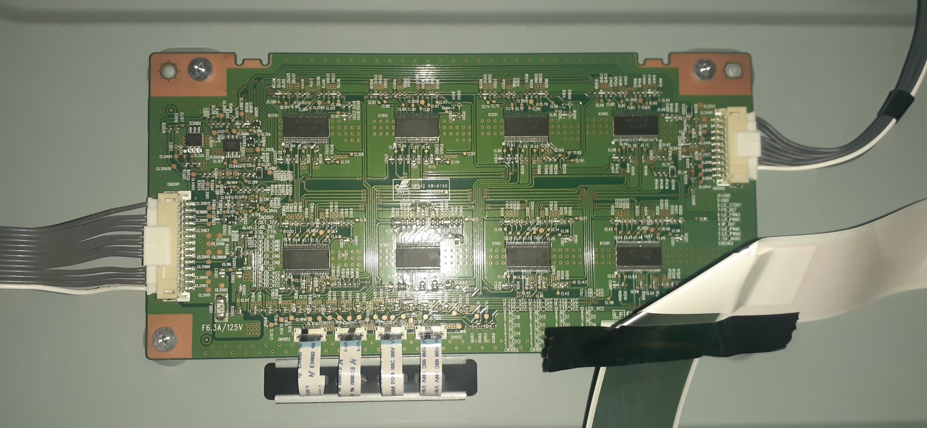

                              Hi...i change the main and got it to work...i did the upgrade t-con was fine all the time...now the tv stay on the green ligth and shows pic...but now the no backligth with flash ligth it shows the picture...i see the channels and menu.......
                              • hmendez86
                                • Jun 2015
                                • 344
                                • united states
                                But before did the update the backlight were working...first i put the usb with update then i connected to outlet and started alone updating and backligth on with the circle arrow doing his update when it finished turn on and off then back on but with no backligth...but i can see the image with flashligth now it stays green ligth...

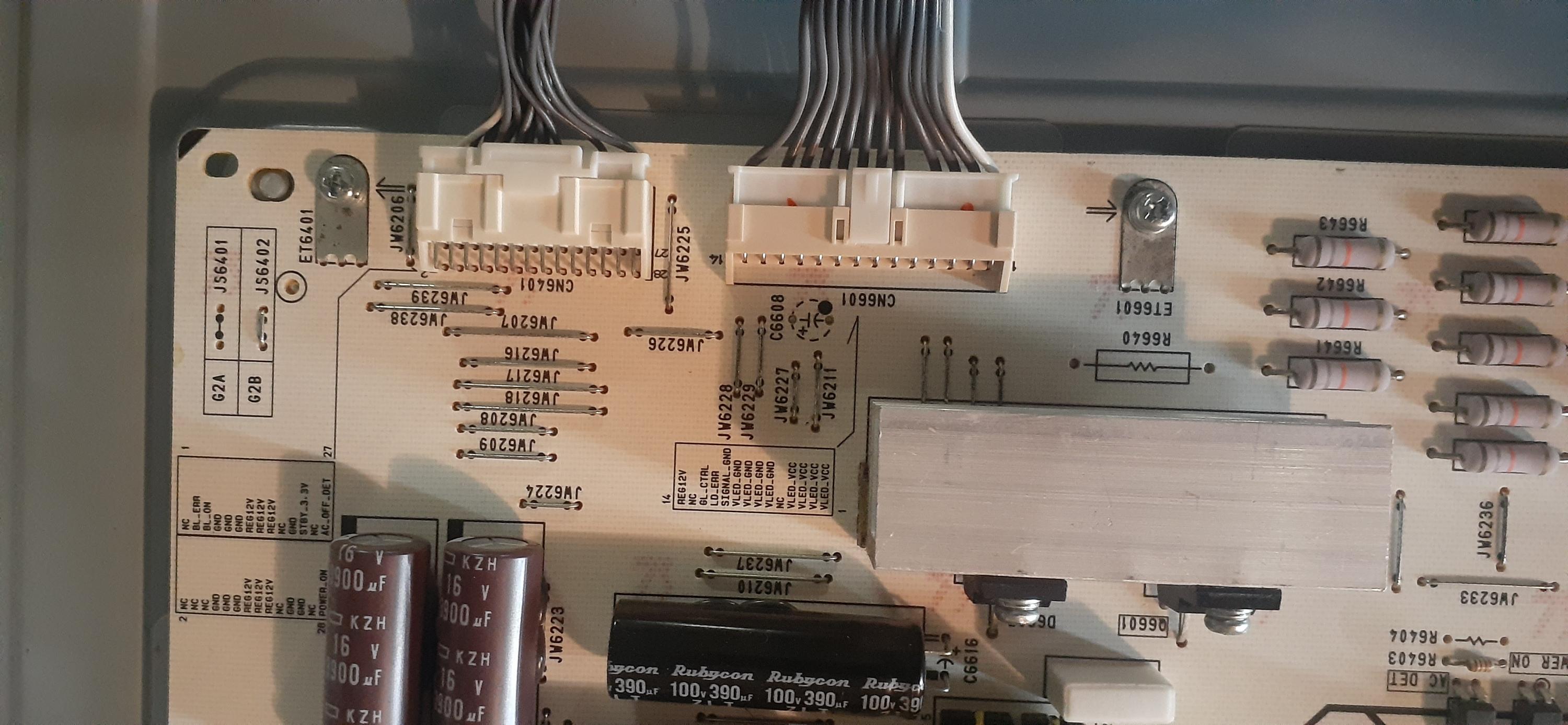

                                    Want to know the voltages for.. vled_vcc am gettig 41.5v
                                      Ill post later the voltages am getting on all pins to see whats missing.
