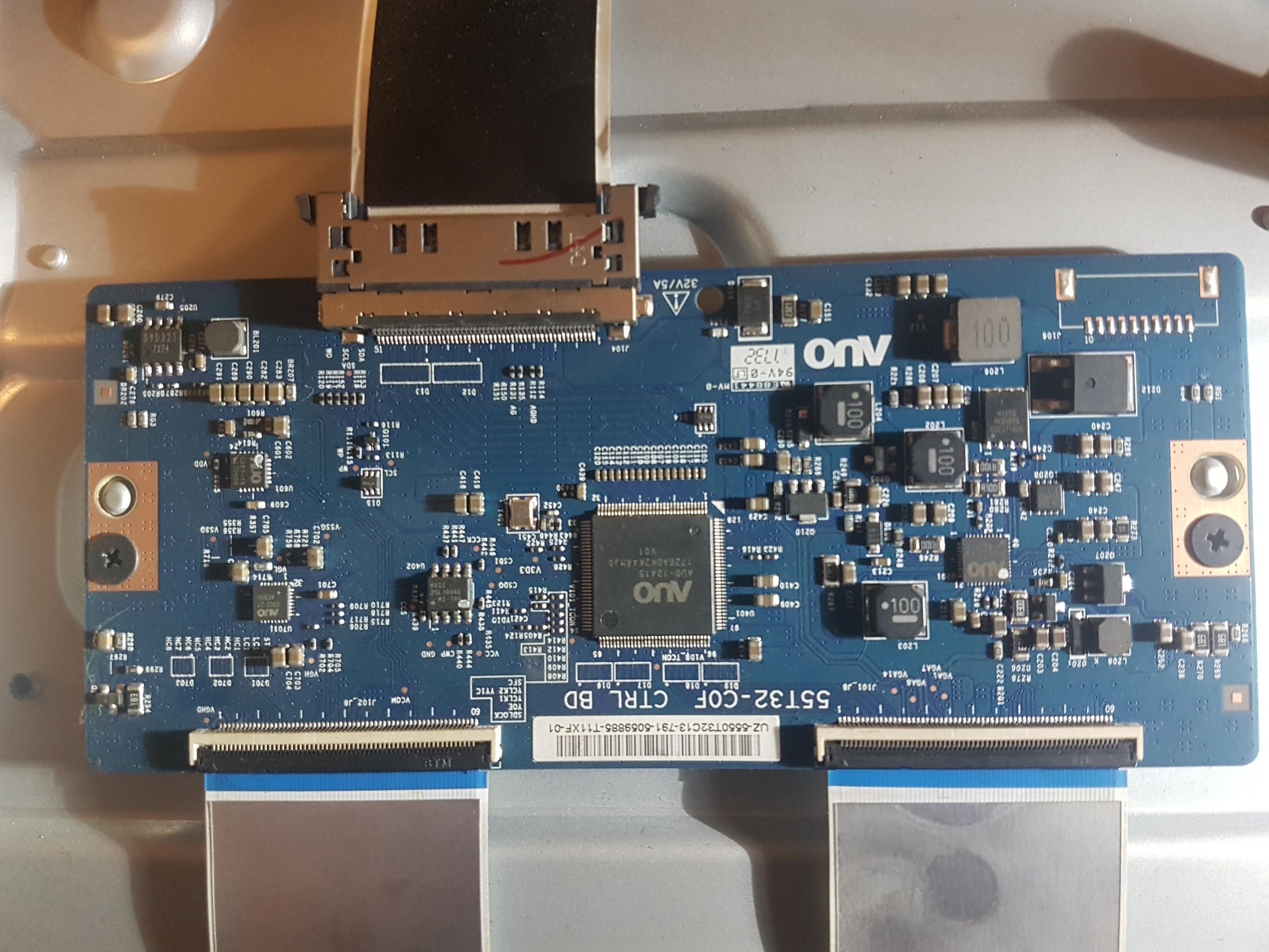

    Insignia ns-50dr620ca18 (NS-50DR620NA18) tcon voltages

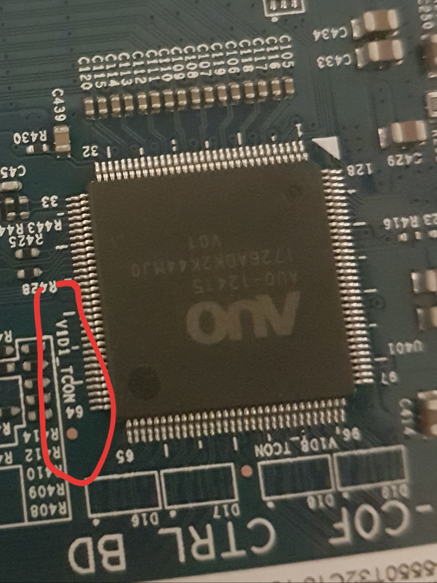

    Does anyone know what the voltages should be at the test points on this tcon? I'm mostly concerned with TCON VID1 which is reading 1.1v which seems strange to me.

    Re: Insignia ns-50dr620ca18 (NS-50DR620NA18) tcon voltages
    Dose the one marked V1D8 read 1.8 volts
      Yes
        So it looks like VxDy is the voltage at that point x.y volts so it looks like V1D1 is correct at 1.1 volts
          Thank you.
