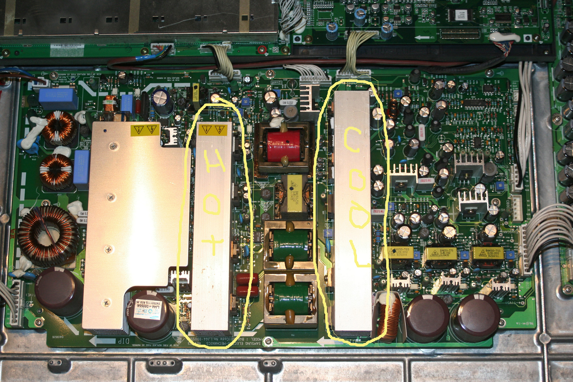

    Trying to salvage this unit powers up fine I get sound but no video please see attached photos any help would be greatly appreciated

    If you need different or more photos let me know .

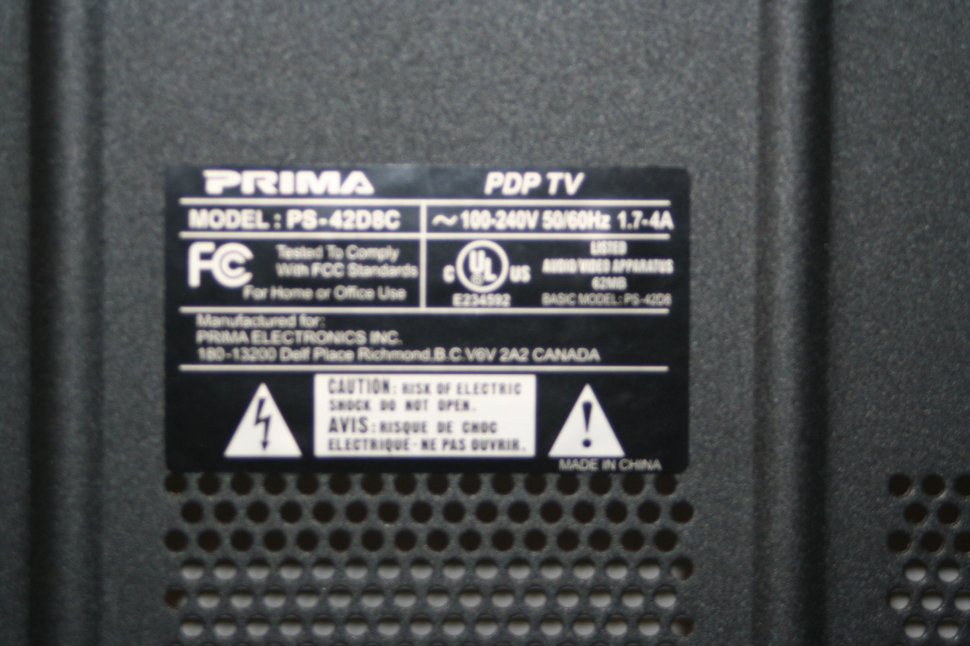

          Re: Prima 42" Plasma

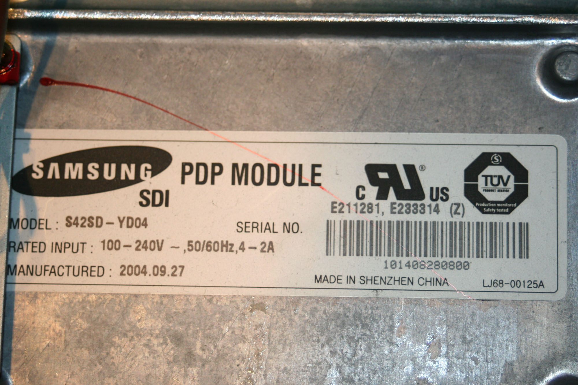

          Model #= Prima ps-42d8c (on outer casing sticker)
          Samsung s42sd-yd04 (on sticker inside )

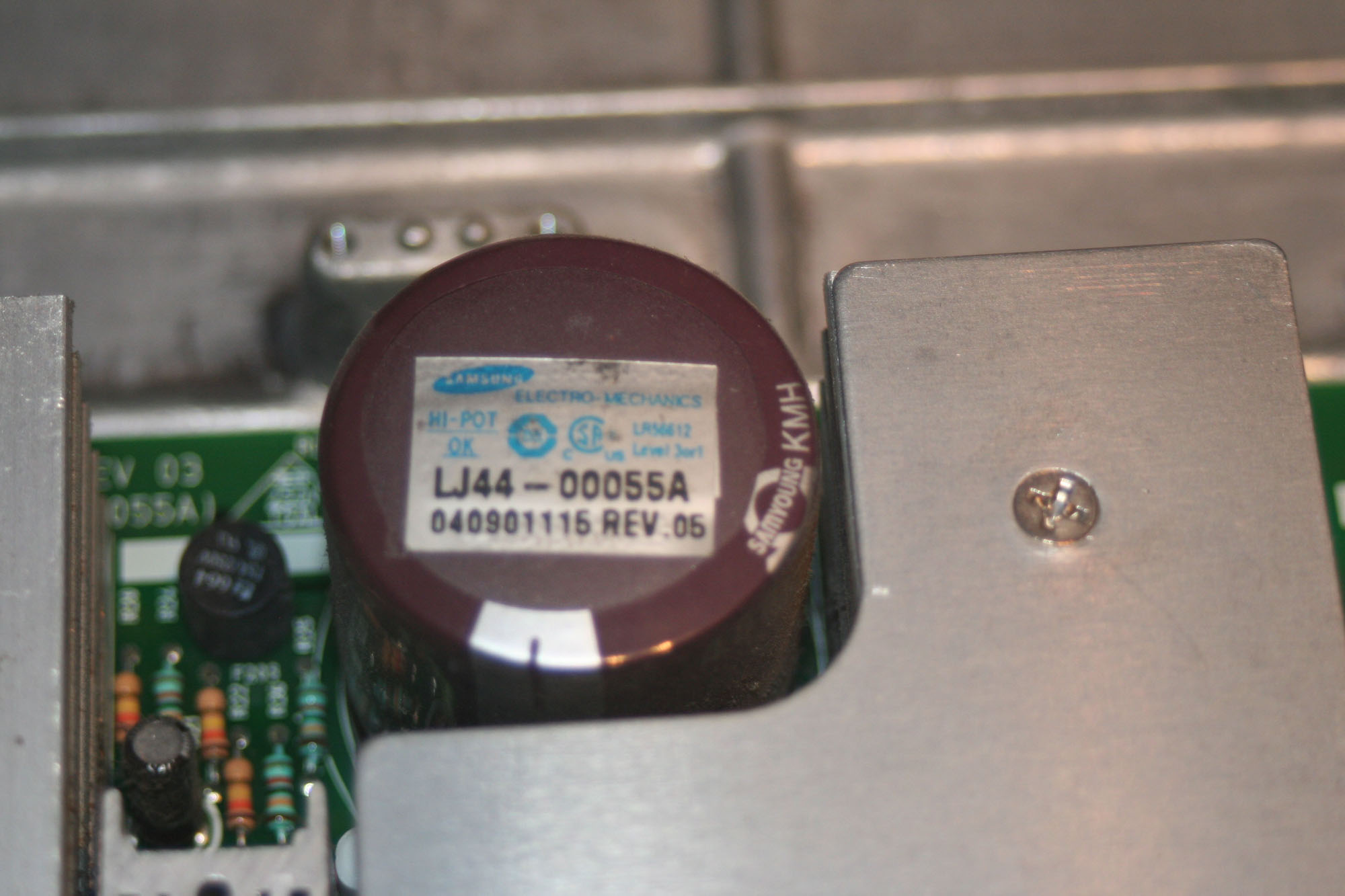

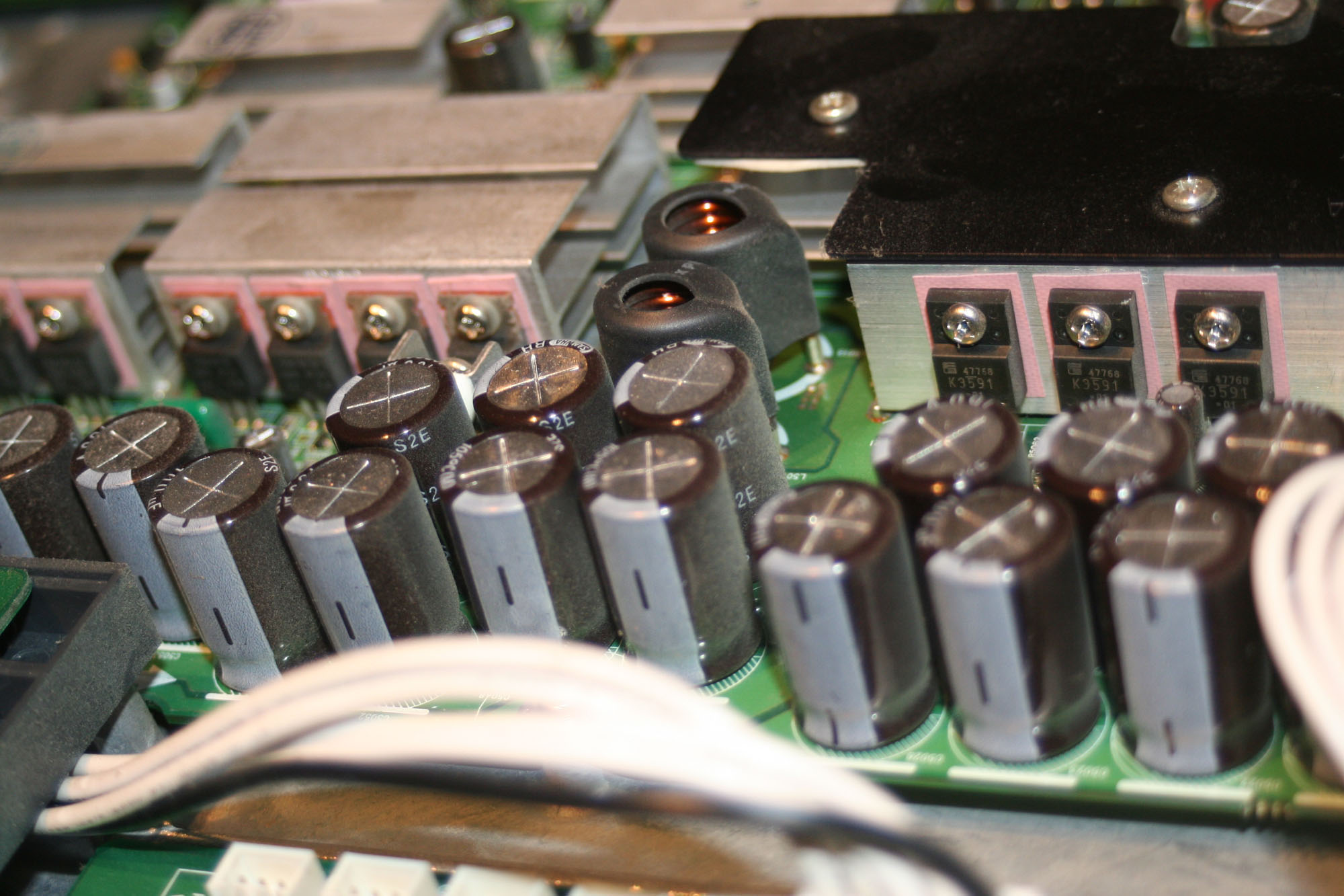

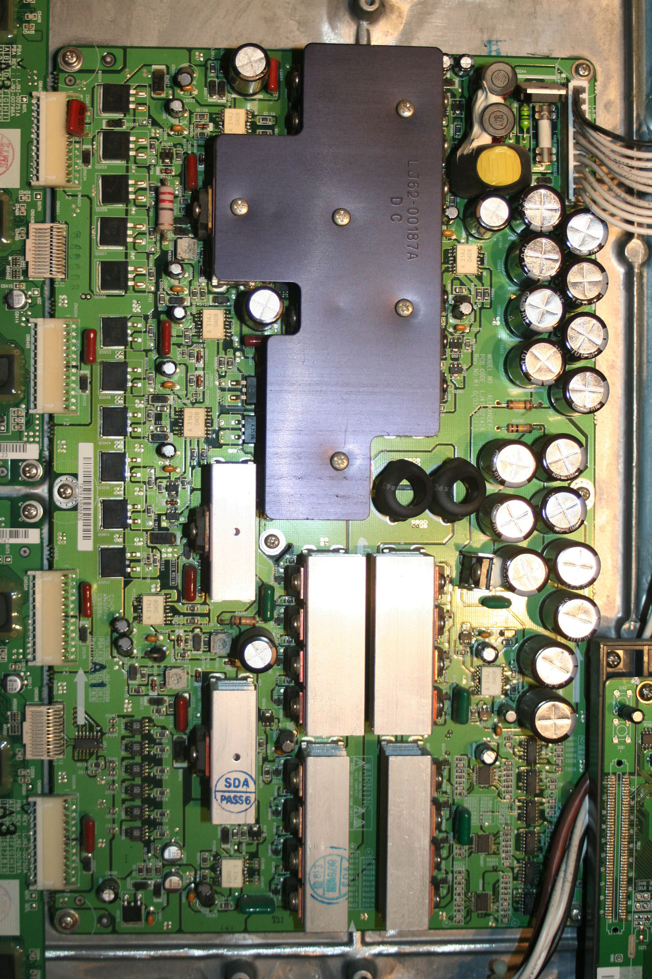

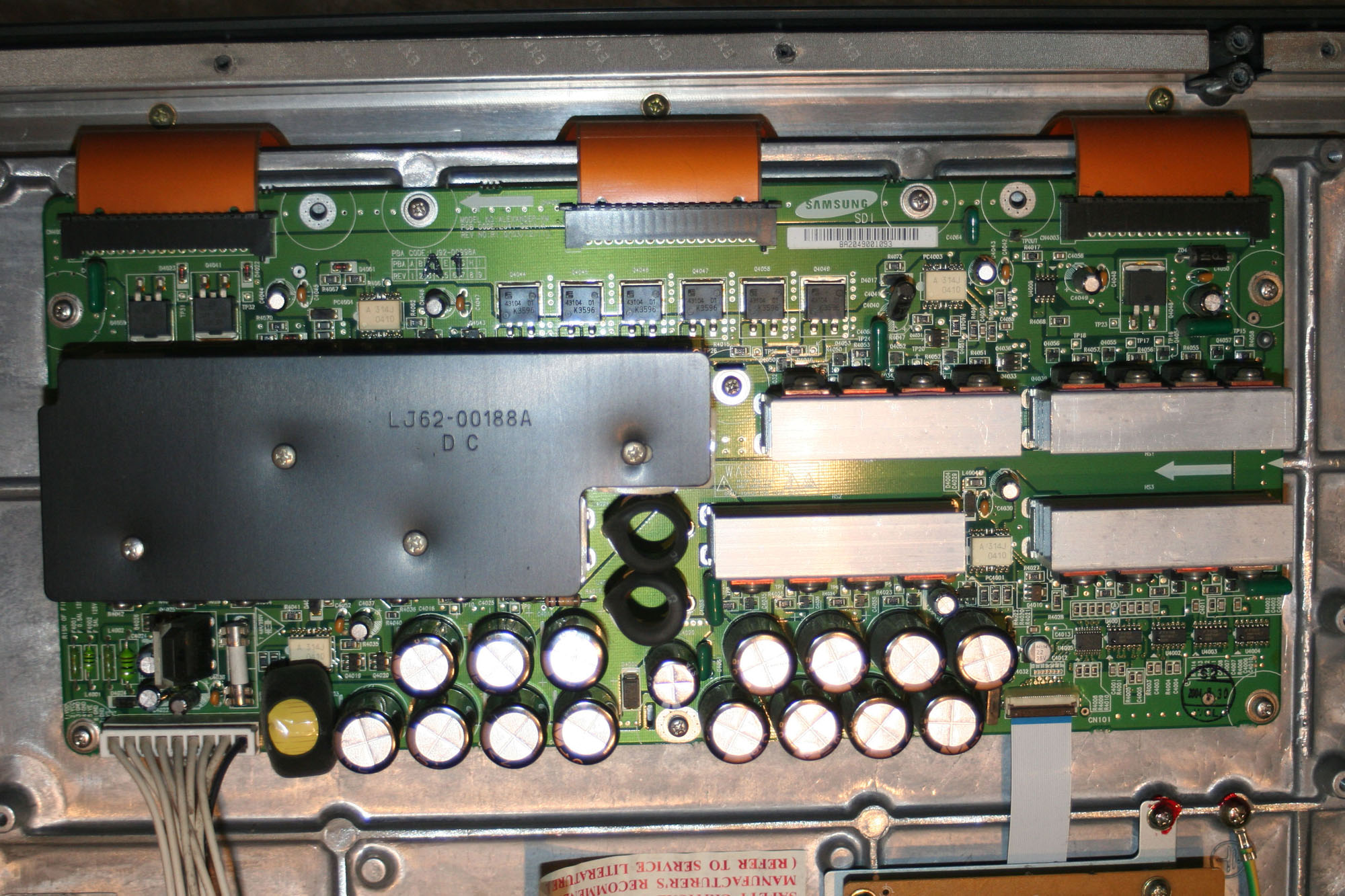

            Can we get a better picture of the caps please?
                Originally posted by rb0746
                You want a better look at the caps pic 1, 2 or 3 or all ?
                All but just the ones you can photograph from the side easily. Like in Pic 1 just the main caps (big ones) and in the other two I'm interested in the ones you can easily photograph.

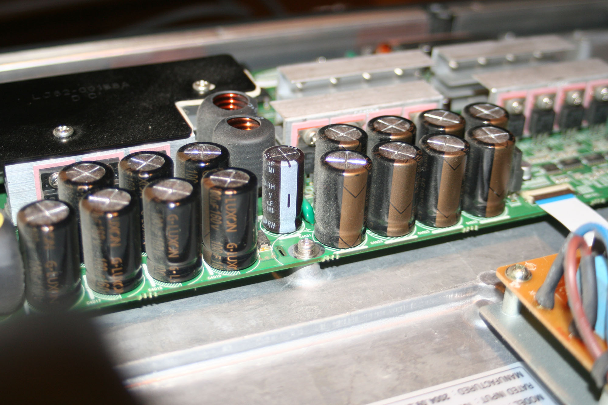

                  https://www.badcaps.net/forum/attach...id=13431&stc=1
                  pics of caps on boards x and y
                  Will that be it ?https://www.badcaps.net/forum/attach...id=13433&stc=1
                  pics of info plates

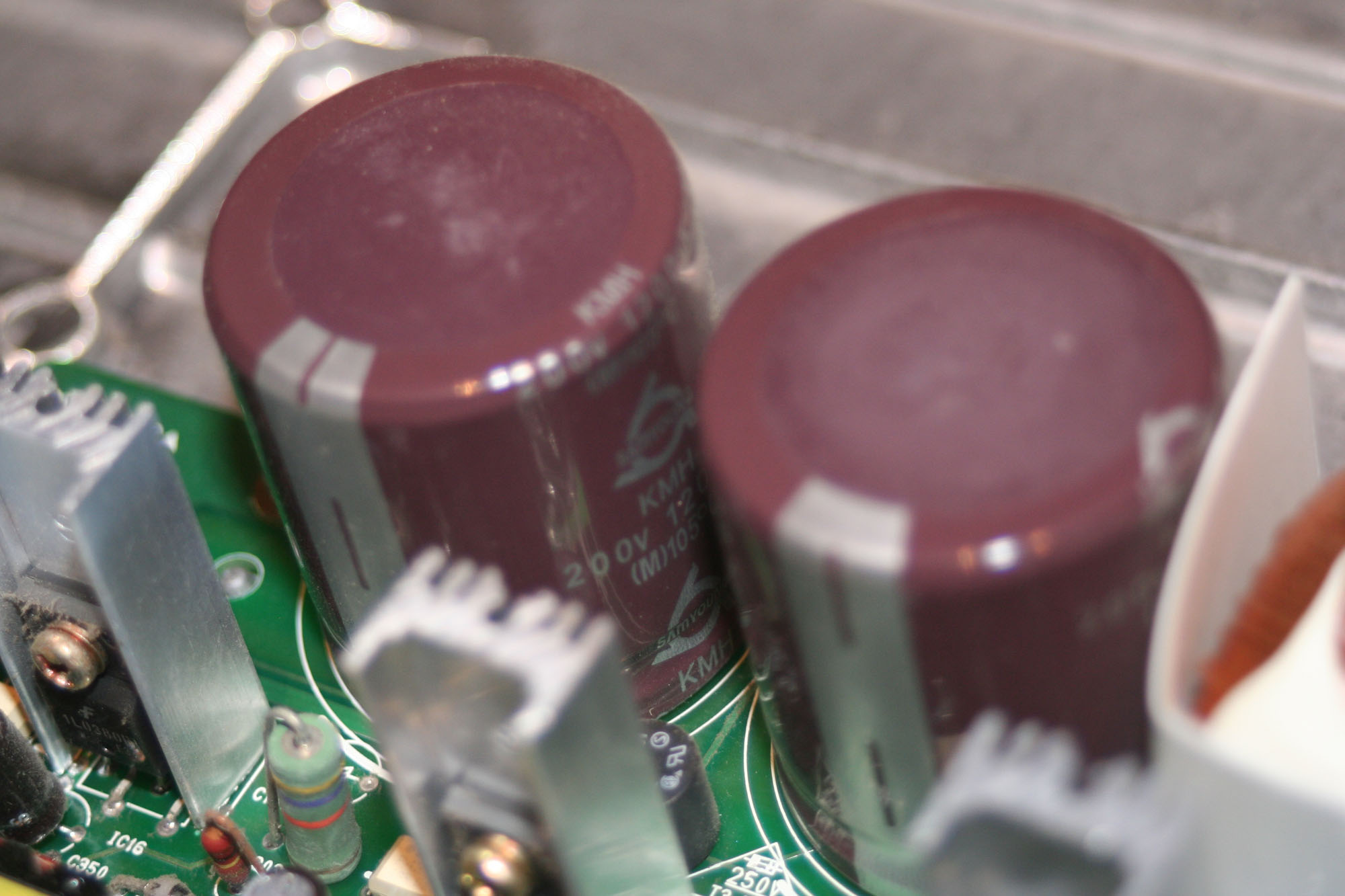

                    Ok, you've got a mix of G-Luxon and Samwha caps. Both known garbage brands. Can you take pics of the two big black caps too?
                    Chances are those caps are dry failed. You will probably need to replace them.

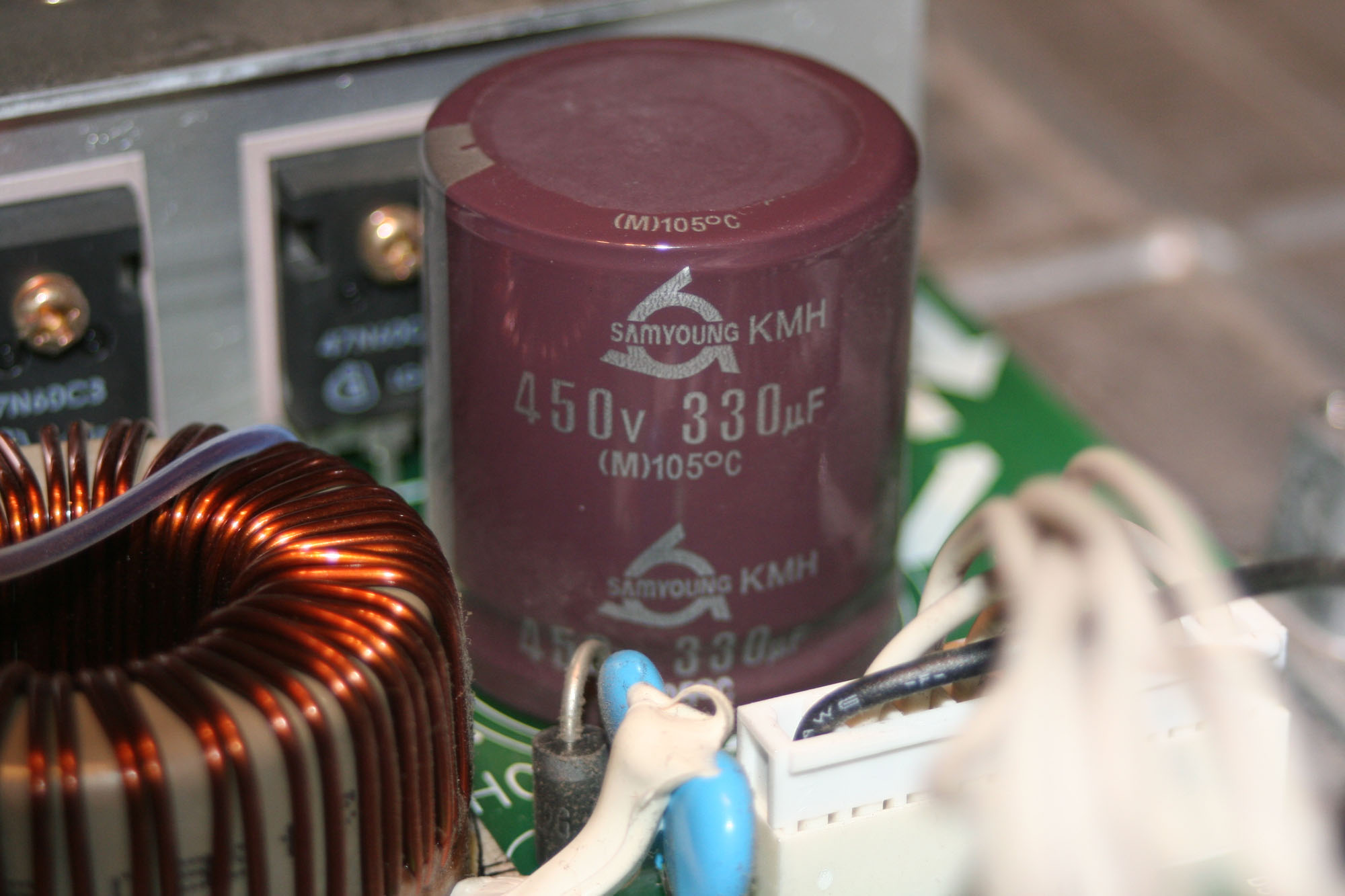

                      ...and no, it's not the same as my Akai I need to fix. Mine has a MFG date from 2006.

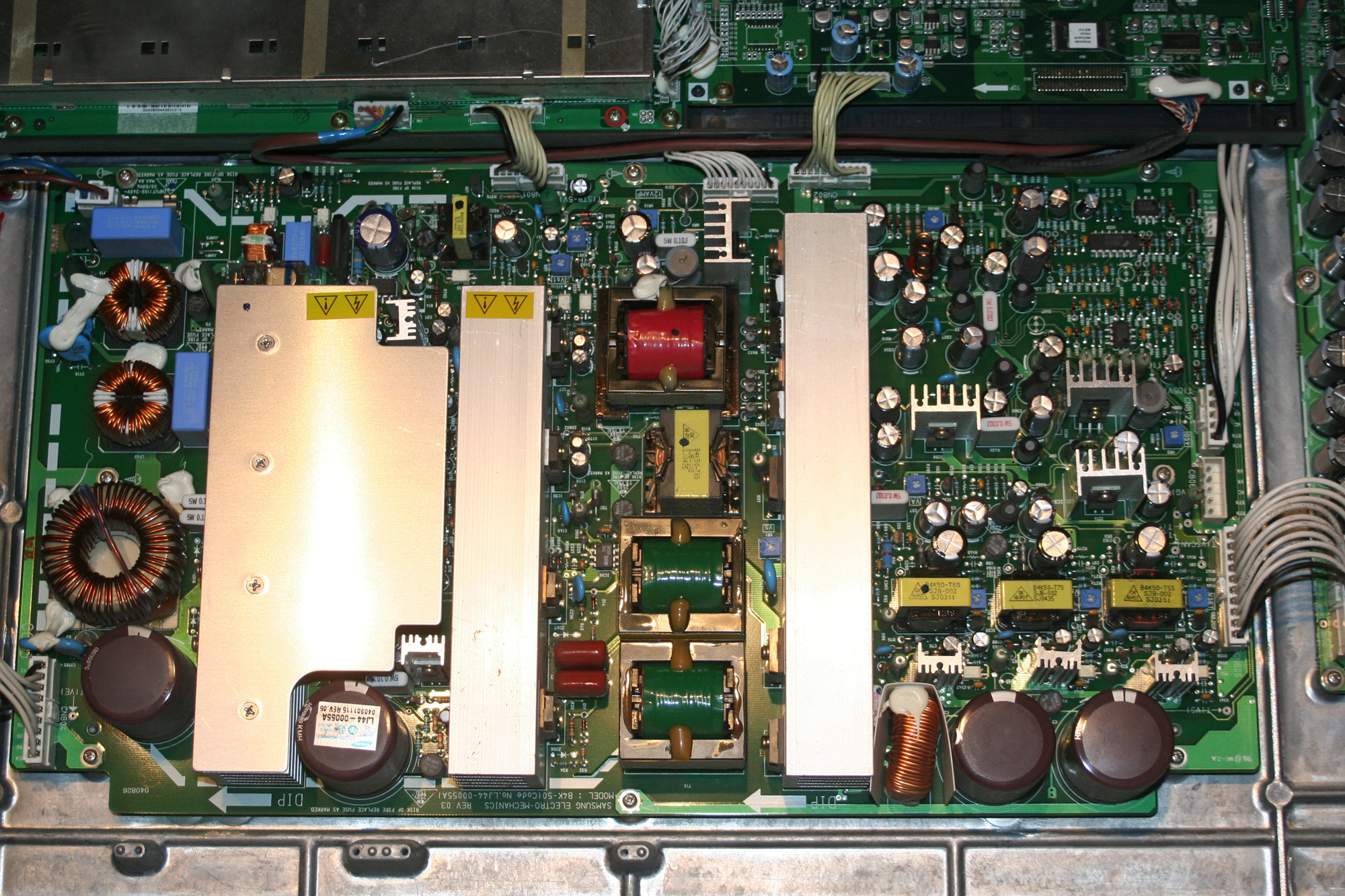

                      Are these the ones ? there are four and they are brown as you can see

                        Another observation I have made is the hot and cool heat sinks is this okay ? or should they bothhttps://www.badcaps.net/forum/attachment.php?attachmentid=13443&stc=1 be equally hot ?

                        • mockingbird
                          • Dec 2008
                          • 5488
                          A cold heatsink indicates the mofsets are not attached but that's not important now.
                          You're also going to have to change the "SamYoung" primaries. Someone here said that it is a lot cheaper to buy primary caps off of eBay as opposed to digikey.
                          In any case, if you decide to change the caps, follow the instructions in my post here:
                          https://www.badcaps.net/forum/showpo...65&postcount=3
                          And also note the series. If there is no series then list the maximum temperature it should be 85c or 105c.
