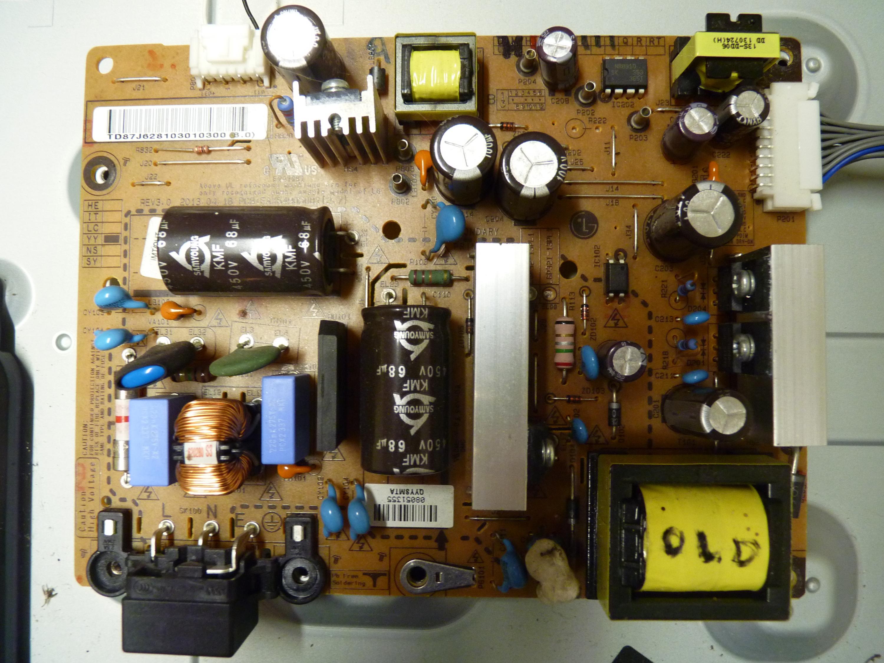

    The guy who gave it to me had bought a replacement power board, but that behaves exactly the same way.

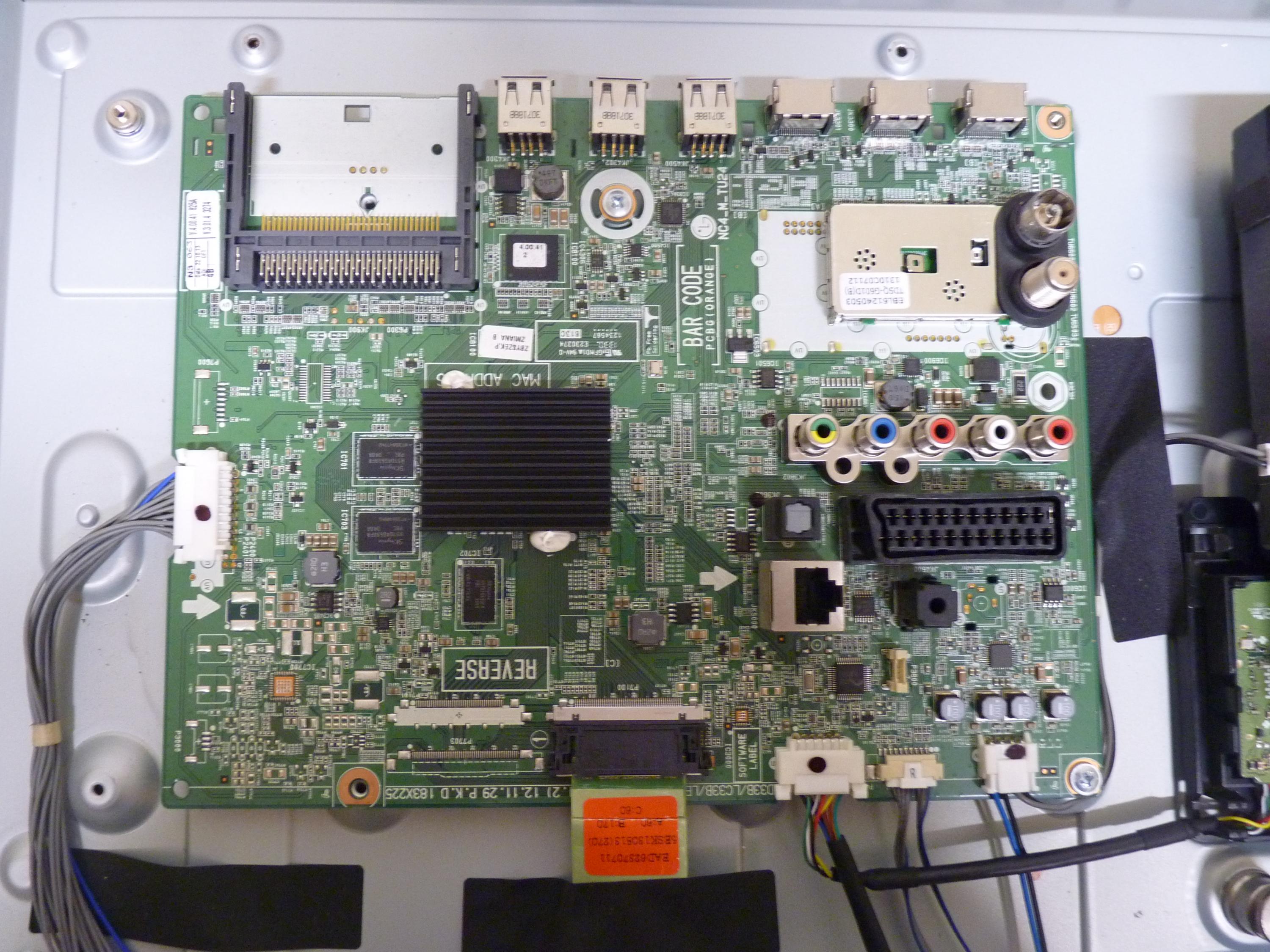

    So I metered the connector from the power bd to the main bd.
    Main voltages are OK. However there are three lines whose function I don't understand:
    pwr on 3.5vdc 6.4vac (I measured with the multimeter set to DC and AC)
    drv_on 3vdc 5.7vac
    pdim 1.1vdc 2.1vac
    I get no voltage out to the backlights.
    What next? Should I get voltage at the backlight connector even if disconnected? (I don't)
    Should I start looking for a new main board?

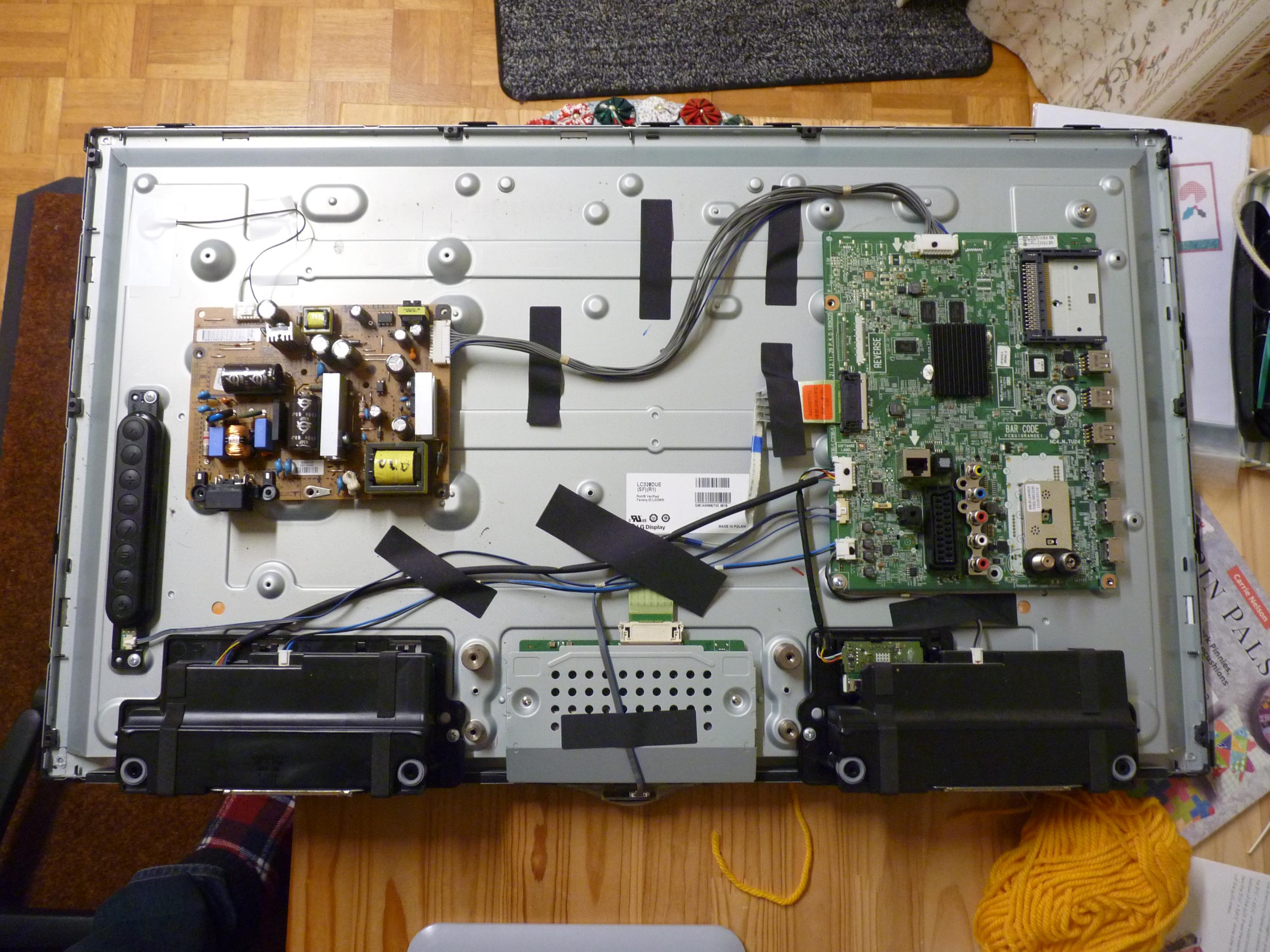

                              OK I worked up the courage to disassemble the screen, having never done it before.
                              And I discovered it's actually not too daunting a procedure.
                              So I have one bad LED strip, which I have now ordered.
                              Thanks for all your help guys - Peter
