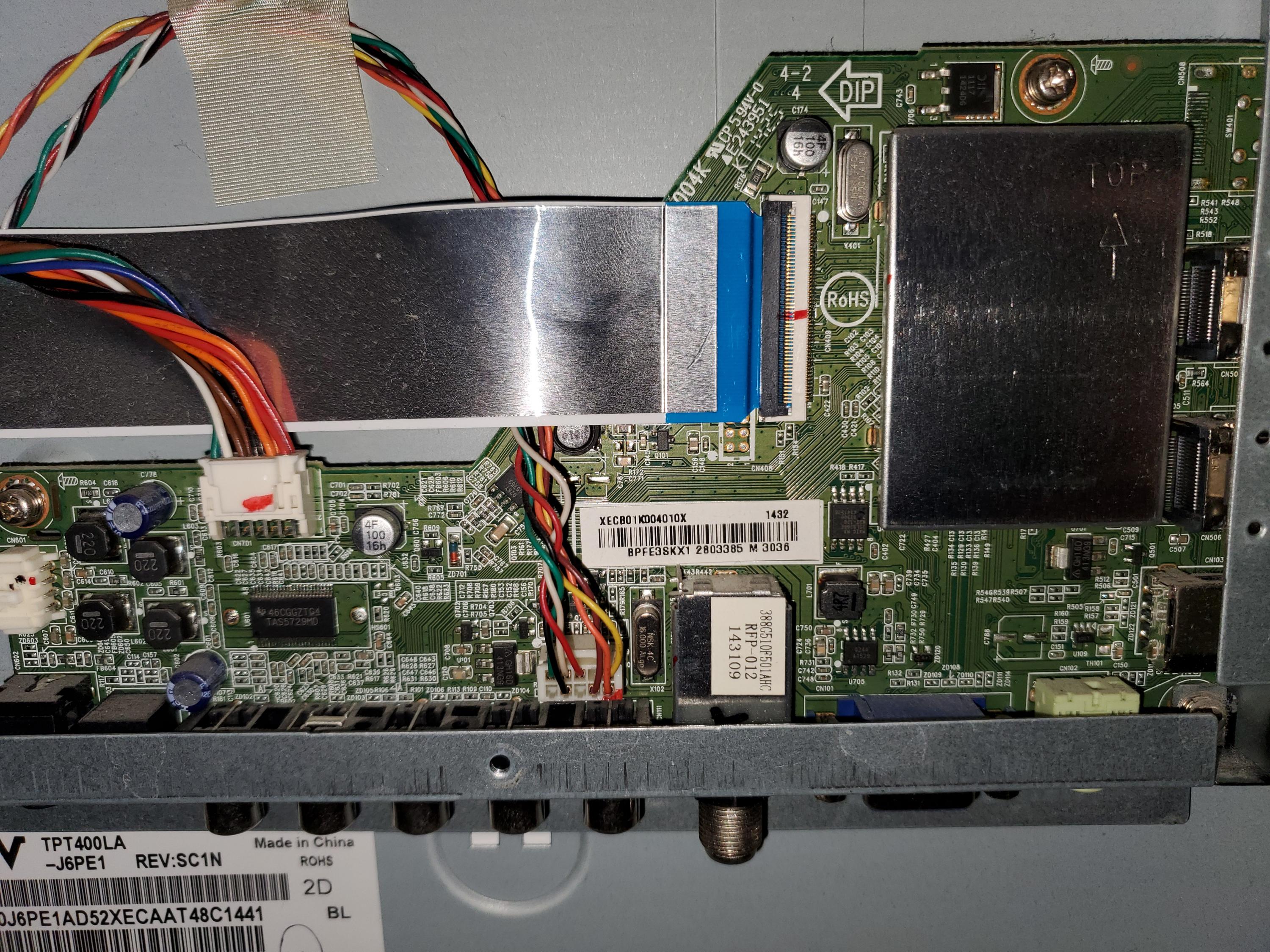

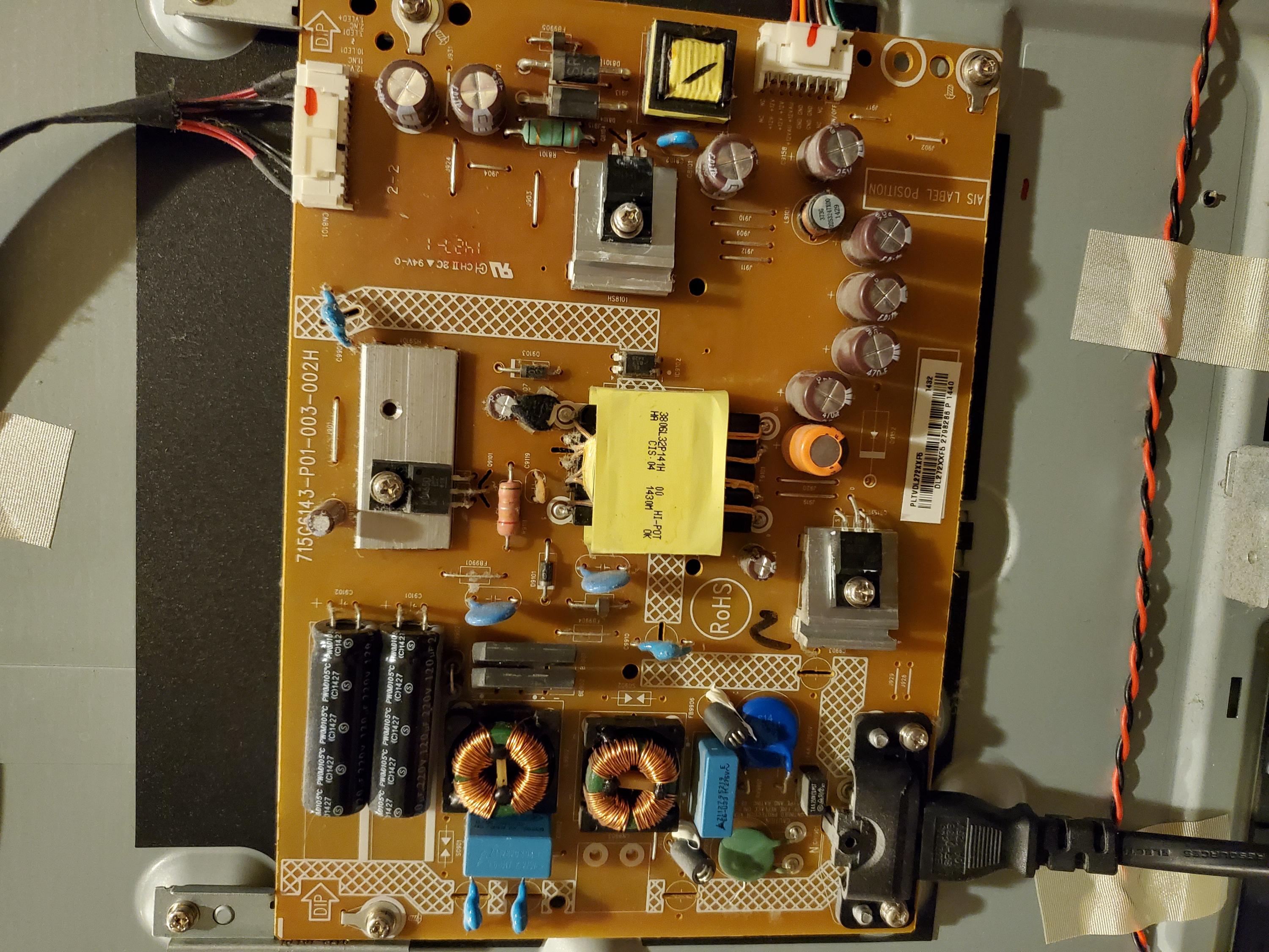

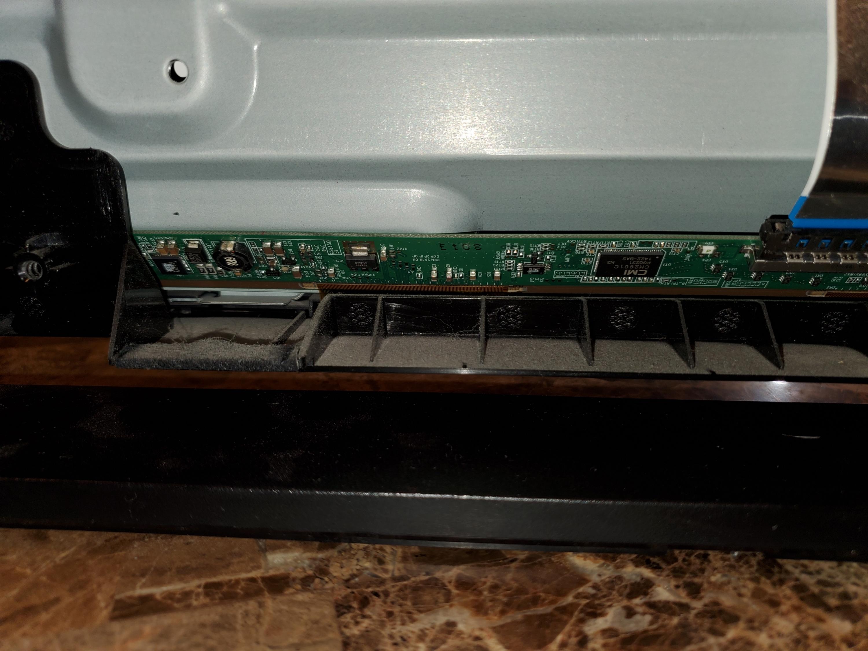

    Insignia NS-40D510NA15 no picture only sound
    Turned on tv one day and only sound worked
    Checked for obvious blown caps and none found
    I have my dvom ready. What should i check?
    I only see 3 boards on this set

              Re: Insignia NS-40D510NA15 no picture only sound
              Can you also show backside of the TV showing all the boards?
