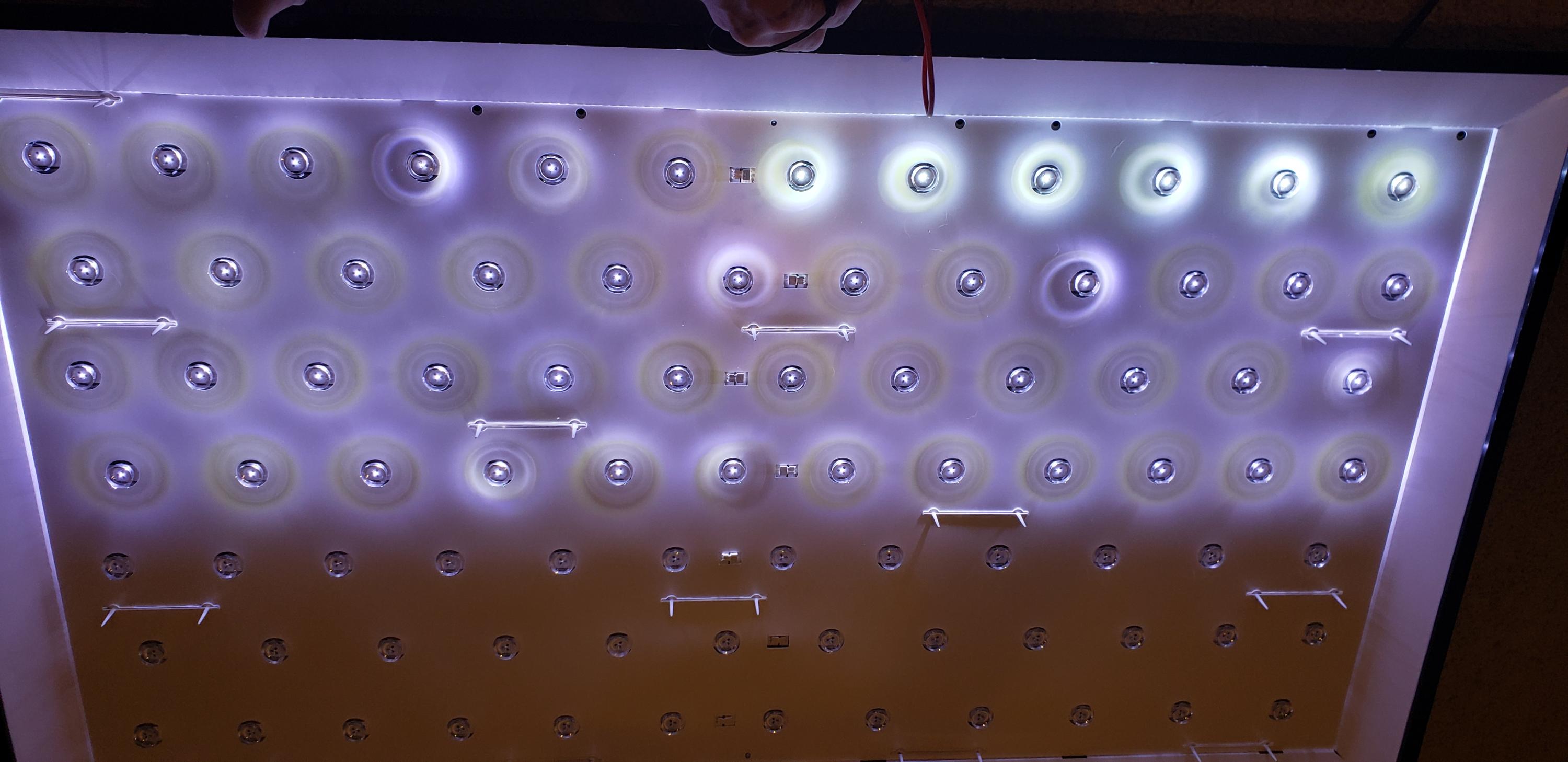

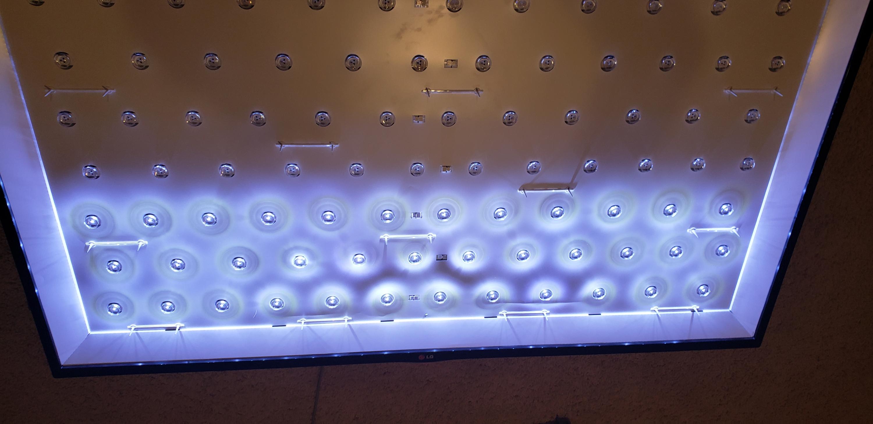

          3 full A-B strips (36 old LEDs): 78.9v = 2.1917v per LED (~2.2v per LED)
          4 full A-B strips (42 old LEDs + 6 new LEDs): 110.0v
          So, 6 new LEDs = 110v - (42*2.1917v) = 17.95v = ~3v per LED

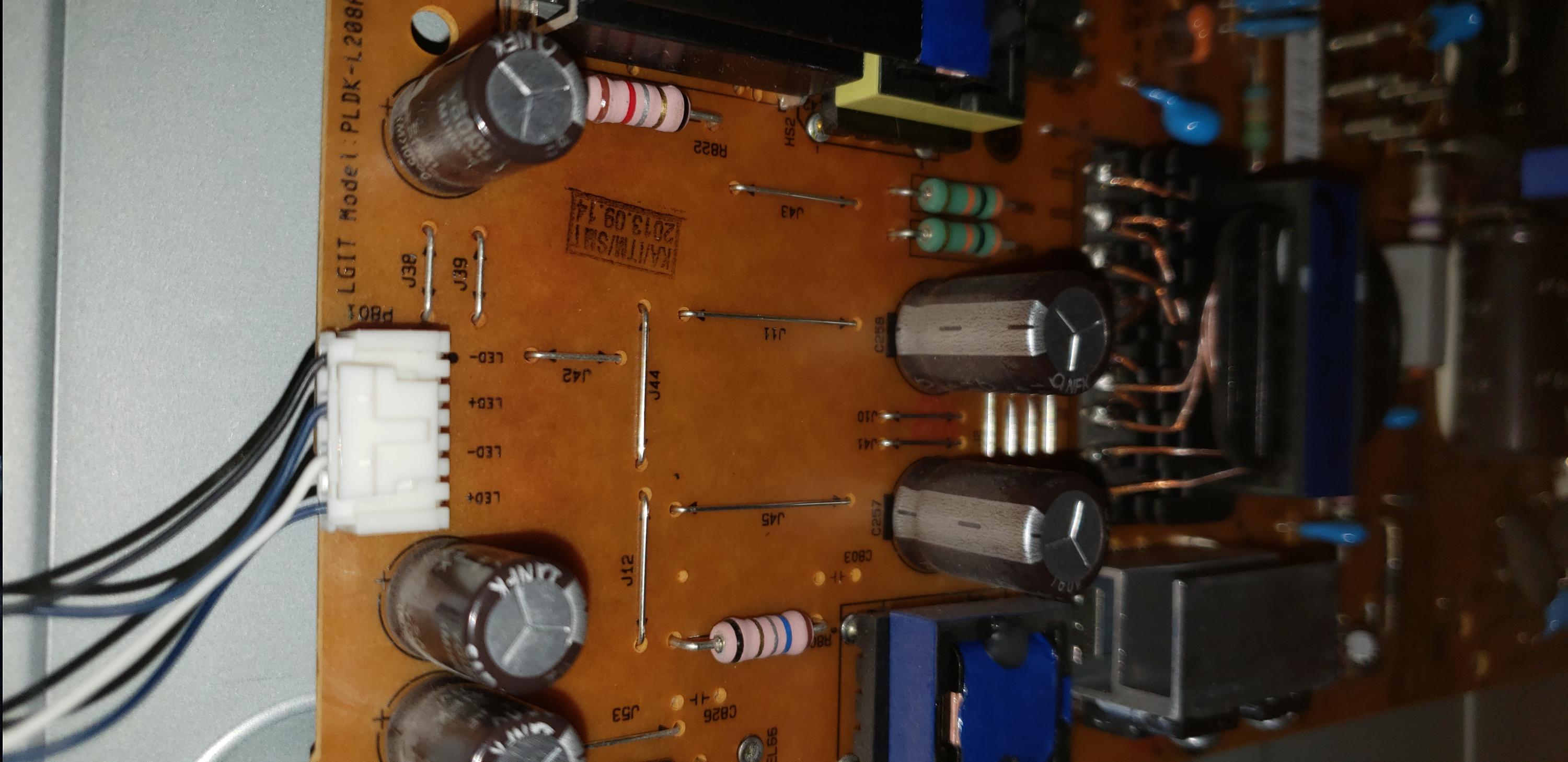

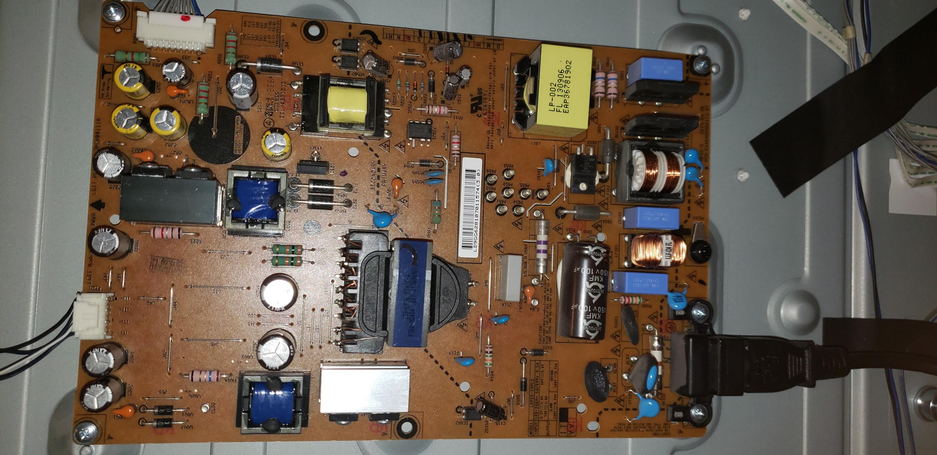

            are you sure from the wiring.. it make no sense to me if the power boards had 2 channel LED per yours wiring 36 LED + 48LED, at least it should 42 LED each.
            can you show clear photo on yours powerboards at the LED Sockets from both side please.

              Re: Does anyone know what LEDs an LG 55LN5400 uses?
              The wiring goes from end to end of the LED strips up the chain (in series) with a terminator at the end of each of the 2 the chains. 1 chain is 4 A-B strips, the other chain is 3 A-B strips.
              The blue/white pair of wires powers the 3 strip chain, while the blue/black pair of wires powers the 4 strip chain.

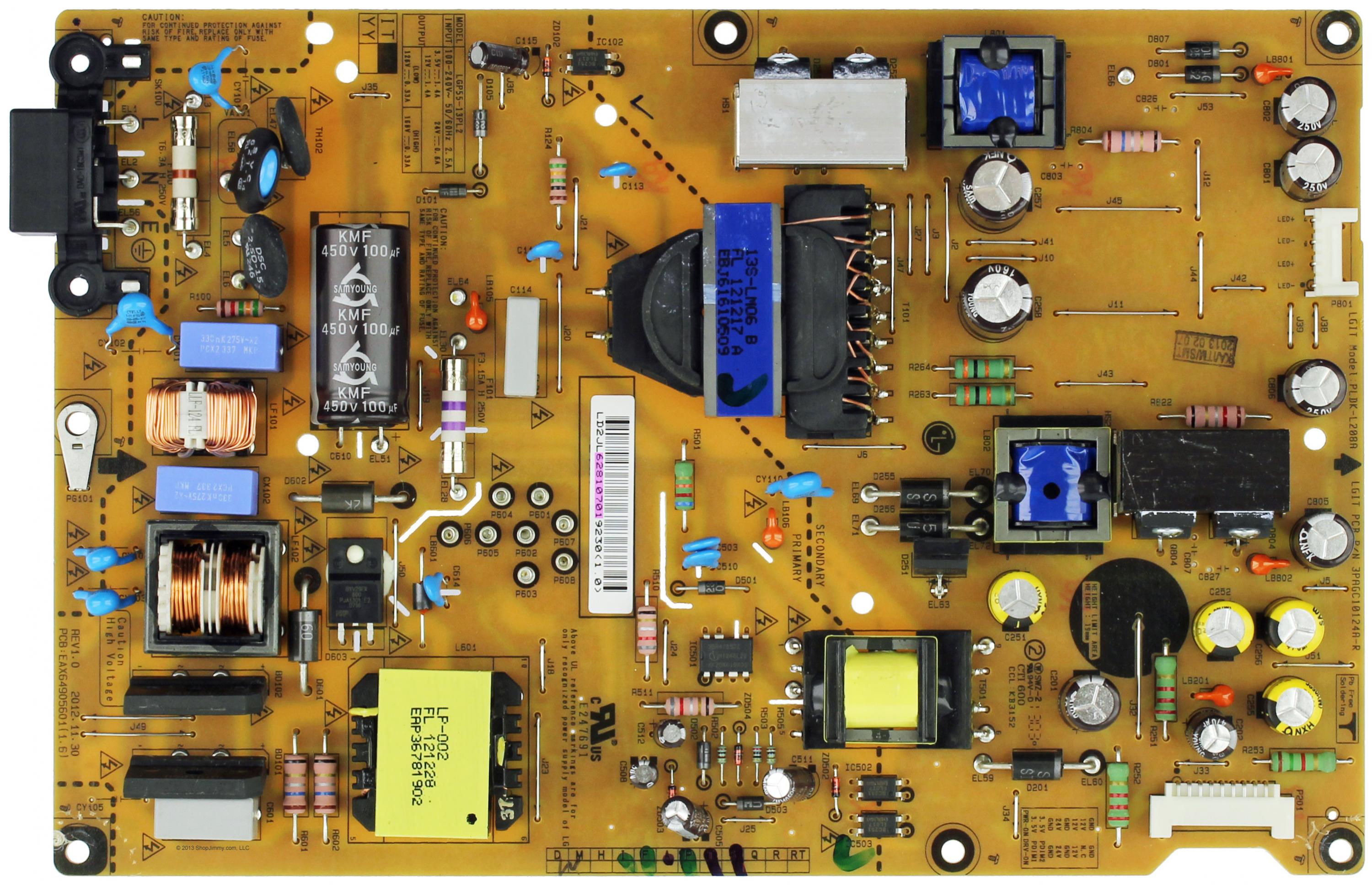

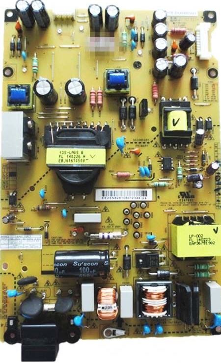

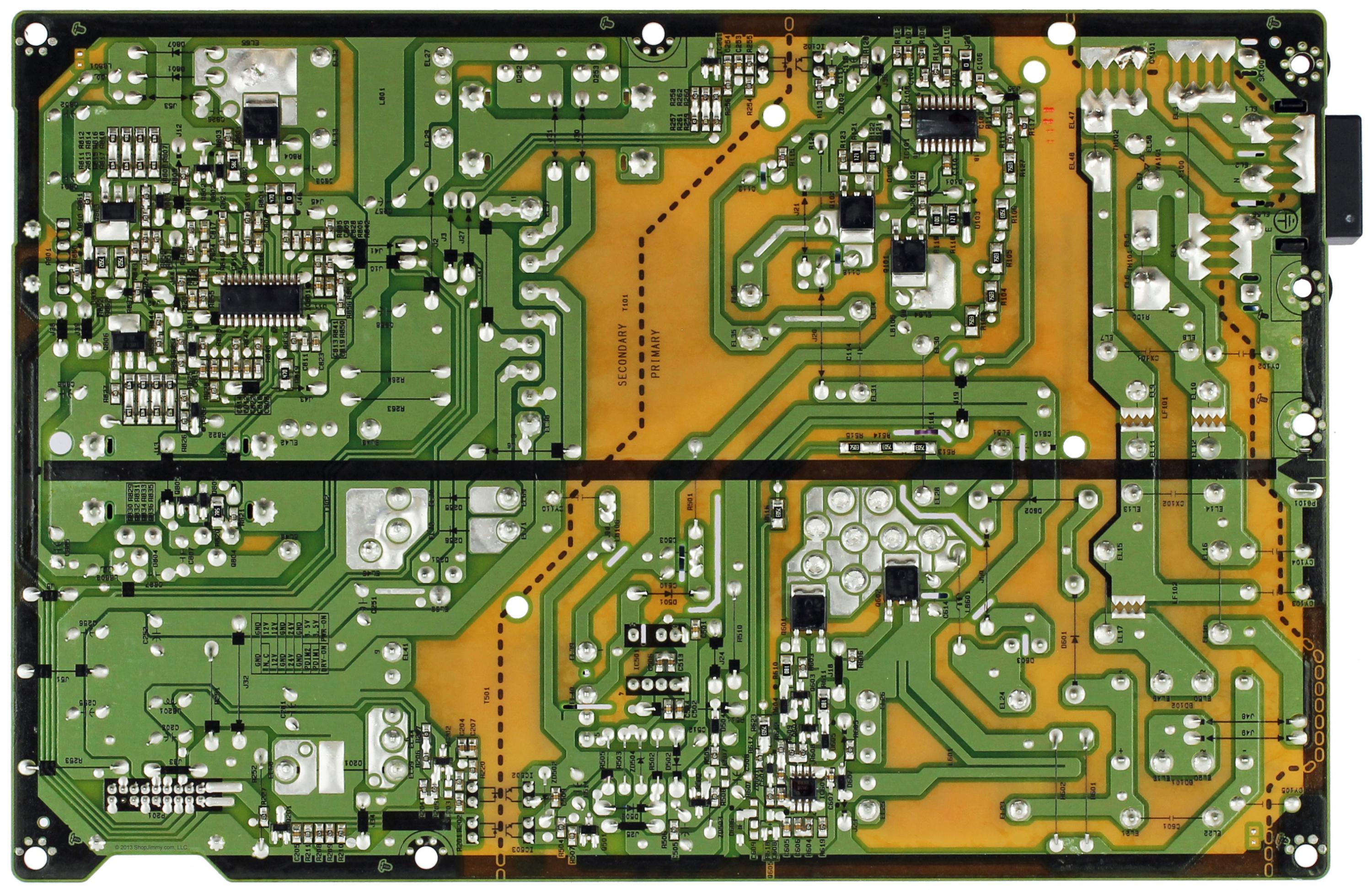

                Re: Does anyone know what LEDs an LG 55LM5400 uses?
                You LCD panel does not use the same amount of LED for each LED string, if you look at the Voltage chart and the Voltage rating of the filter caps for the two boost converter circuits you will see the two LED drive Voltages for the Low LED string and High LED string, thus different LED drive Voltages.
                Pictures provided by shopjimmy.
                LG EAY62810701 (3PAGC10124A-R) Power Supply / LED Board
                https://www.shopjimmy.com/lg-eay6281...ply-led-board/
                • Daveleone
                  • Apr 2016
                  • 267
                  Just to close this thread out, I got the replacement original LED strip and everything works great. No hot spots. Case closed.
