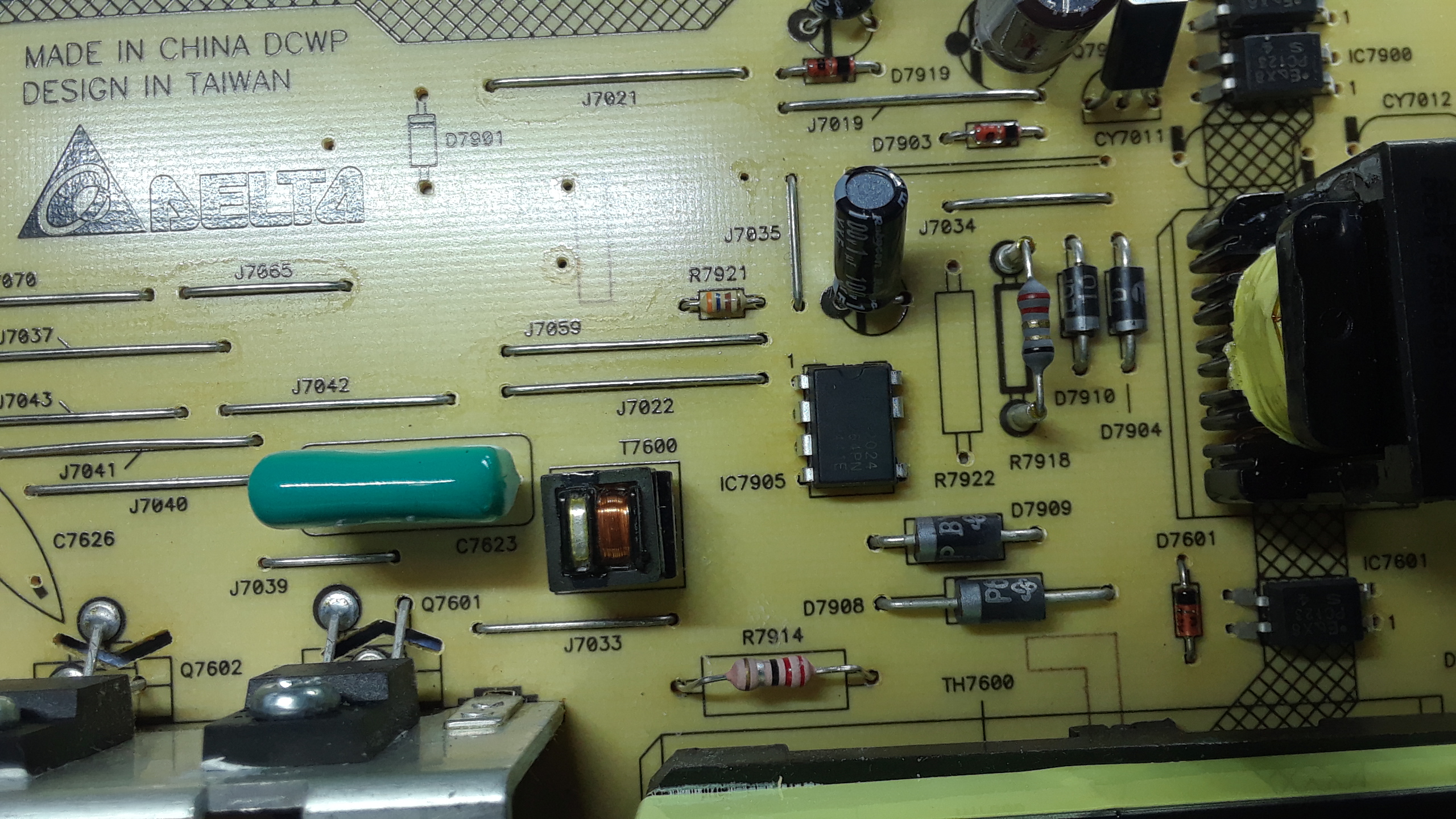

    I couldn't find a picture in which you could read the chip part number but did you mean IC7905 on the power board,
      Re: Sharpe LCD TV LC60E77UN
      Must be IC7905.
      Per shopjimmy pictures, it looks like TNY264PN by Power Integration.
      Some one on the web sell the IC and the 2.2 Ohms resistor R7914 that will be blown too when the IC7905 blew up.
      TNY spec:
      Here is the link to one of the kit: https://www.yoycart.com/Product/566813822866/

            Finally got IC7905 replaced and the fusible resistor R7914. Tried to power up the board with still no success. Here are some of my findings.
            I still do not get any standby 5 volts on the low side of the power supply. It seems that I am getting 28 volts AC all over the low side of the power supply board.
            Does anyone know where I can find the source of the 5 volt standby voltage on this power supply board? This is a DPS 343AP-A. Any suggestions as to where I should look would be greatly appreciated.

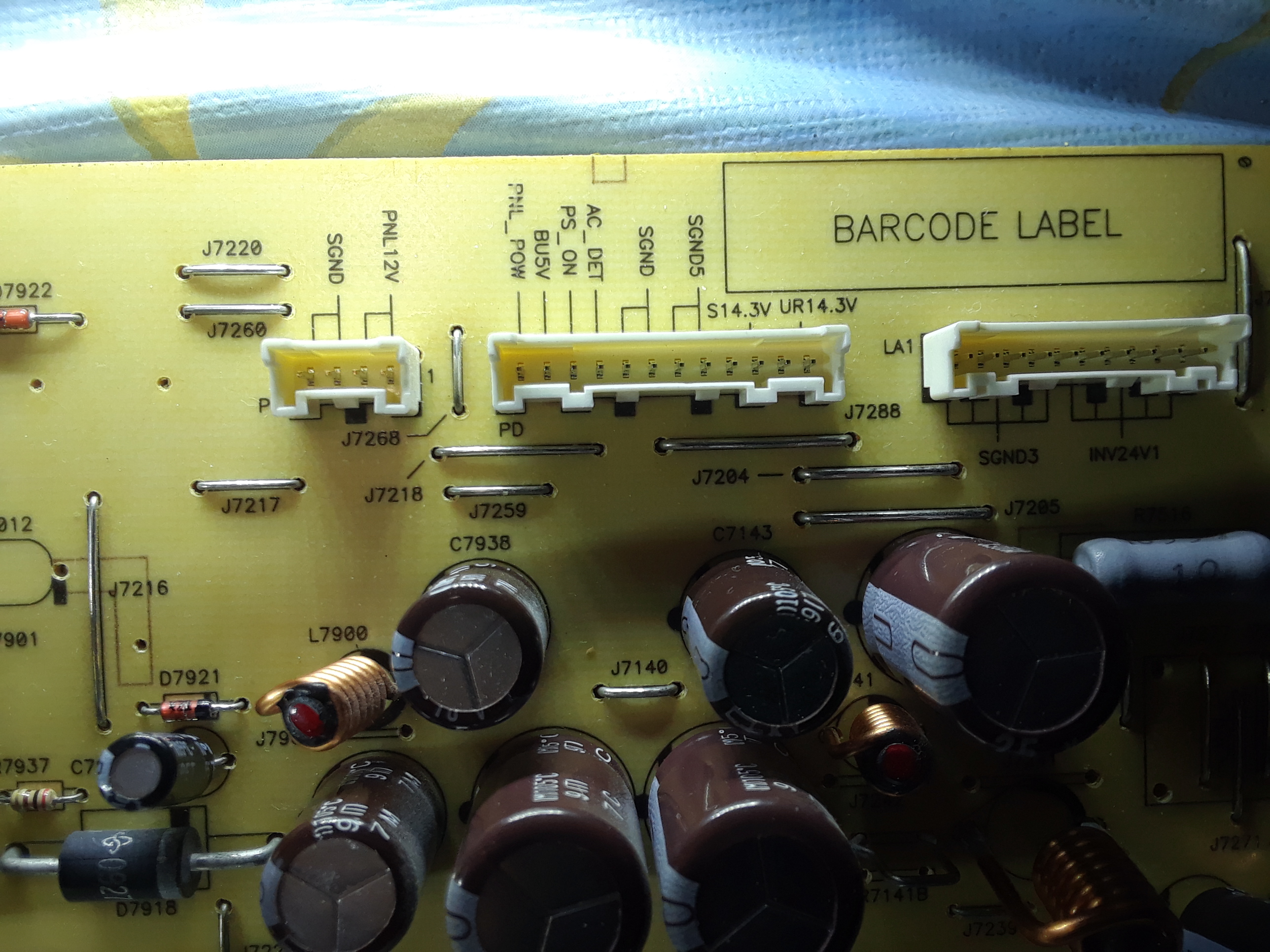

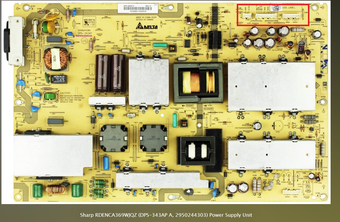

                          That's why photo's of your circuit boards are helpful when posted.
                          I'm not 100% certain but if this is your power supply then PL, PD and LA1 are the connector names.
                          Photo from Shopjimmy

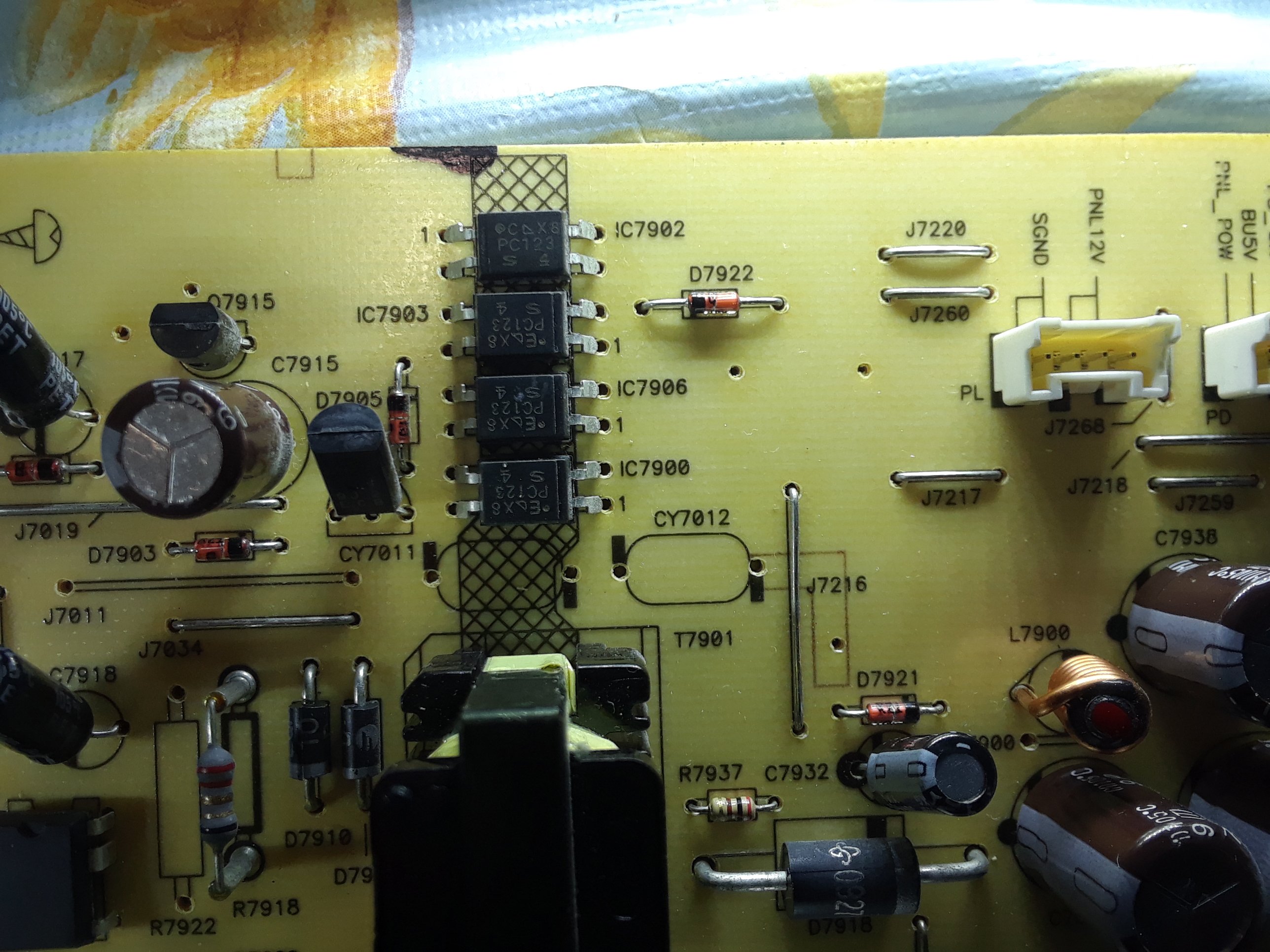

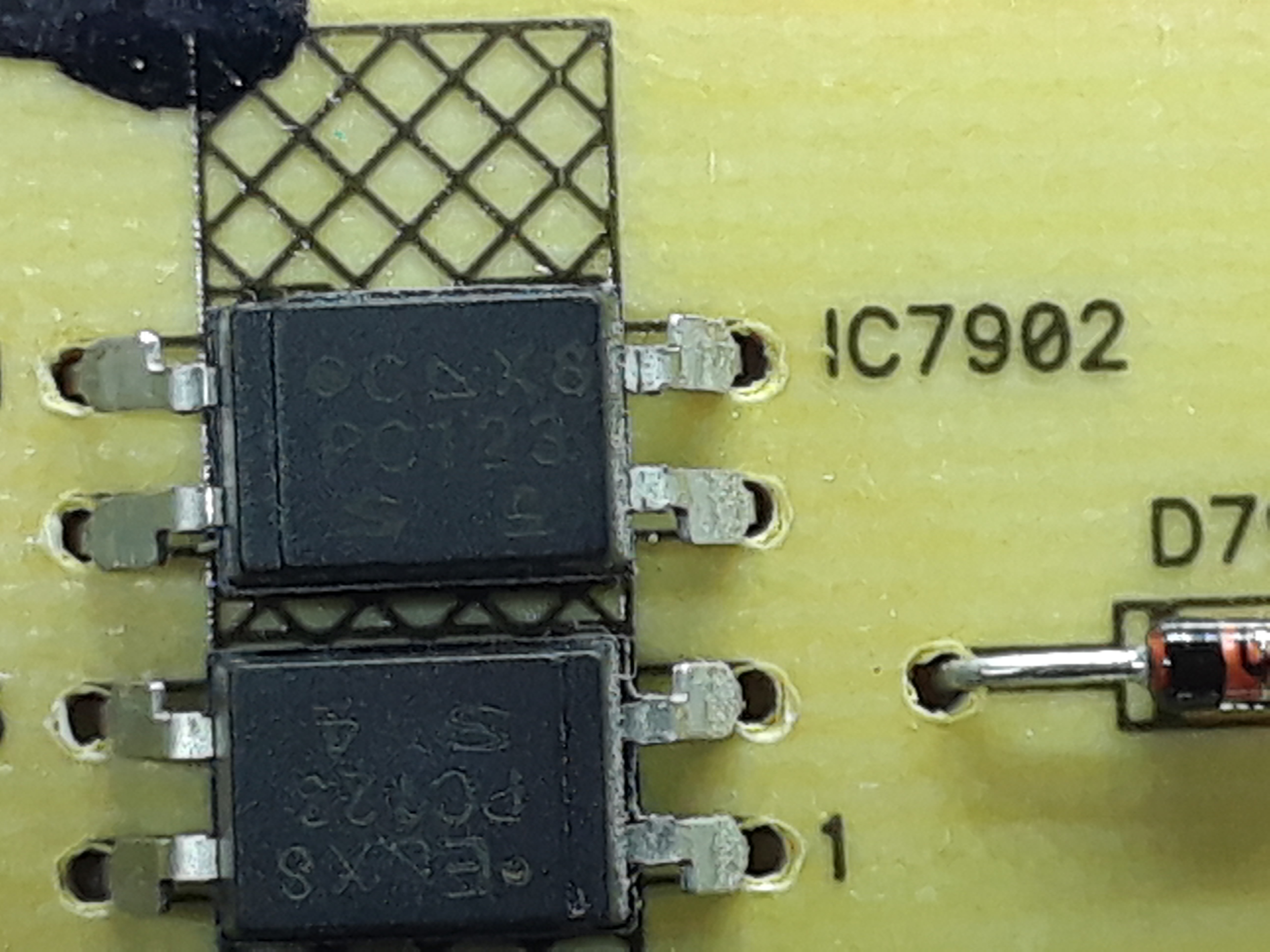

                            Dick you are sharp yes this is my board.
                            With the power to the board and I use the chassis connection point as my ground and I measure any of these pins I do not see any voltages. Perhaps I am not connected correctly to see the voltage.
                            For your information I did find the 5.93 volts on pin one of IC7905 I believe. These are I believe opto couplers PC123. There are 6 of these between the hi and low side of the board and only IC7905 is upside down it is the very top one by the connectors you are referring to. I think I should see the 5.93 volts on pin 2 as well and if this coupler is not working would this prevent the 5.93 volts from getting to the low side of the board and on to the connector. Hope this makes some sense to you.
                            Bruce
                                IC7905 is a PFC control IC and not an opto-coupler.
                                What dc voltage do you have on pin 4 (EN/UV) of IC7905 with the black meter lead connected to negative leg of capacitor C7830.
