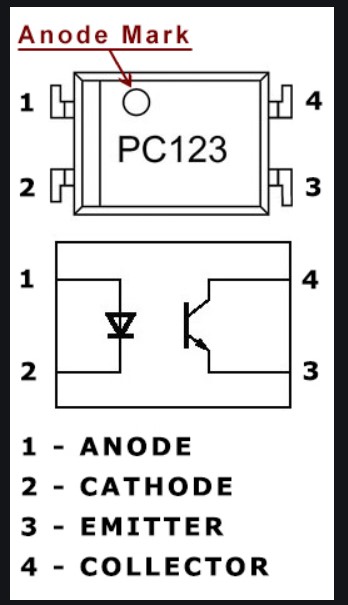

                The diode requires approximately 1.2V across it to switch on the transistor within the package.
                What the IC does in your power supply I don't know without a diagram to reference against.
                Basically the Opto's are switches and work by apply a voltage across the diode that then (shorts) turns on the transistor between pins 3 & 4. The diode and transistor are electrically isolated from each other so they can work between the HIGH / LOW section of the power supply. That is, if the diode is on the high voltage side of the circuit then the transistor can be on the low side or vice-versa.

                  Thank you for the explanation. I will reread this slowly and try to apply your explanation to my circuit
                  I have taken some additional readings for you to review and taken additional pictures of the surrounding circuit to see if this might help.
                  C7830 167.5 VDC across the capacitor.
                  IC7905 between the neg of C7830 and pin 1 5.94 VDC
                  IC7902 between pin one and two as mounted on the board .790 VDC
                  IC7902 between pin 3 and 4 as mounted on the board .726 VDC
                  Therefore by your explanation I believe I have a diode that is defective on the pin 1 and 2 side of the board correct?

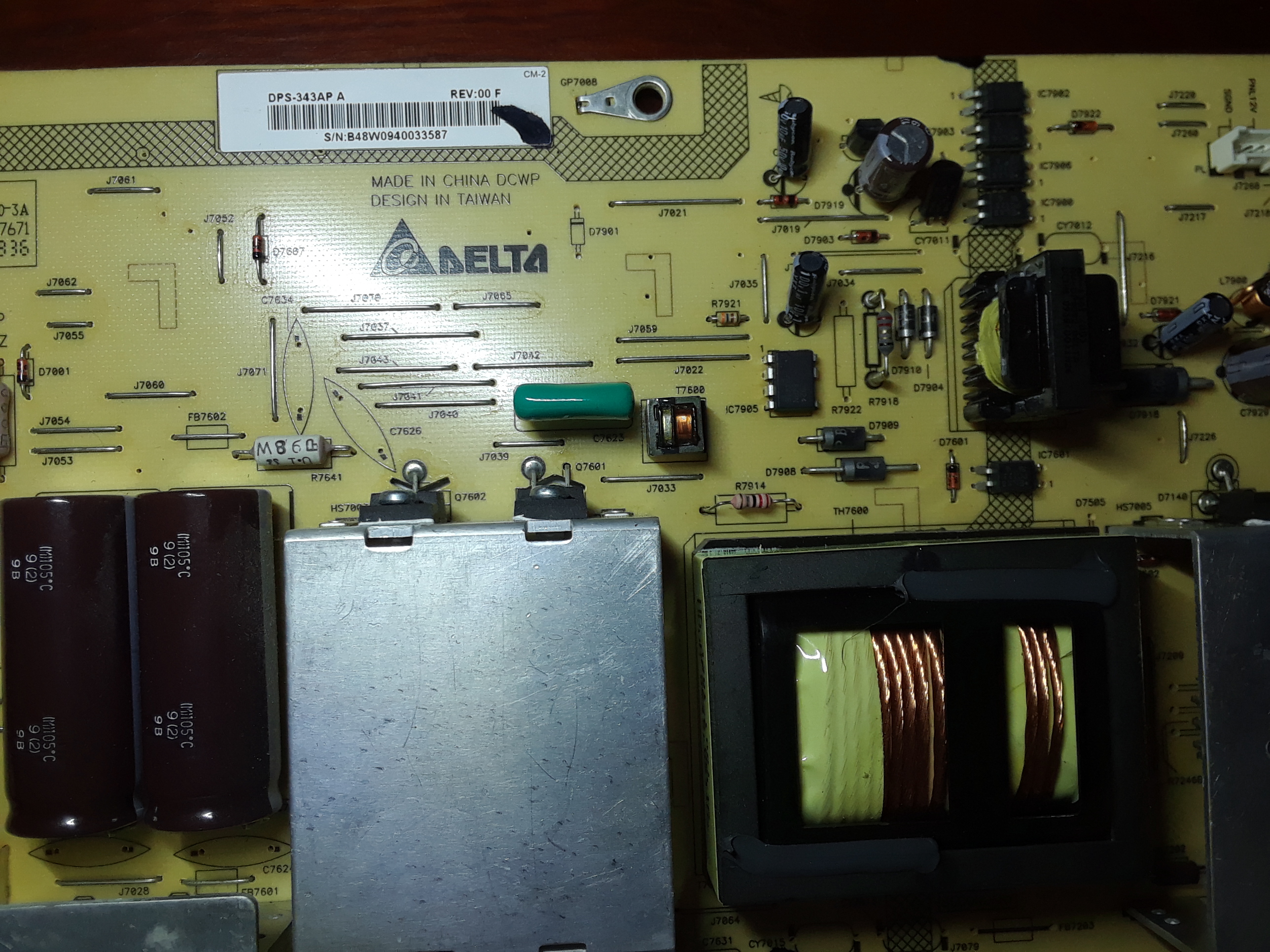

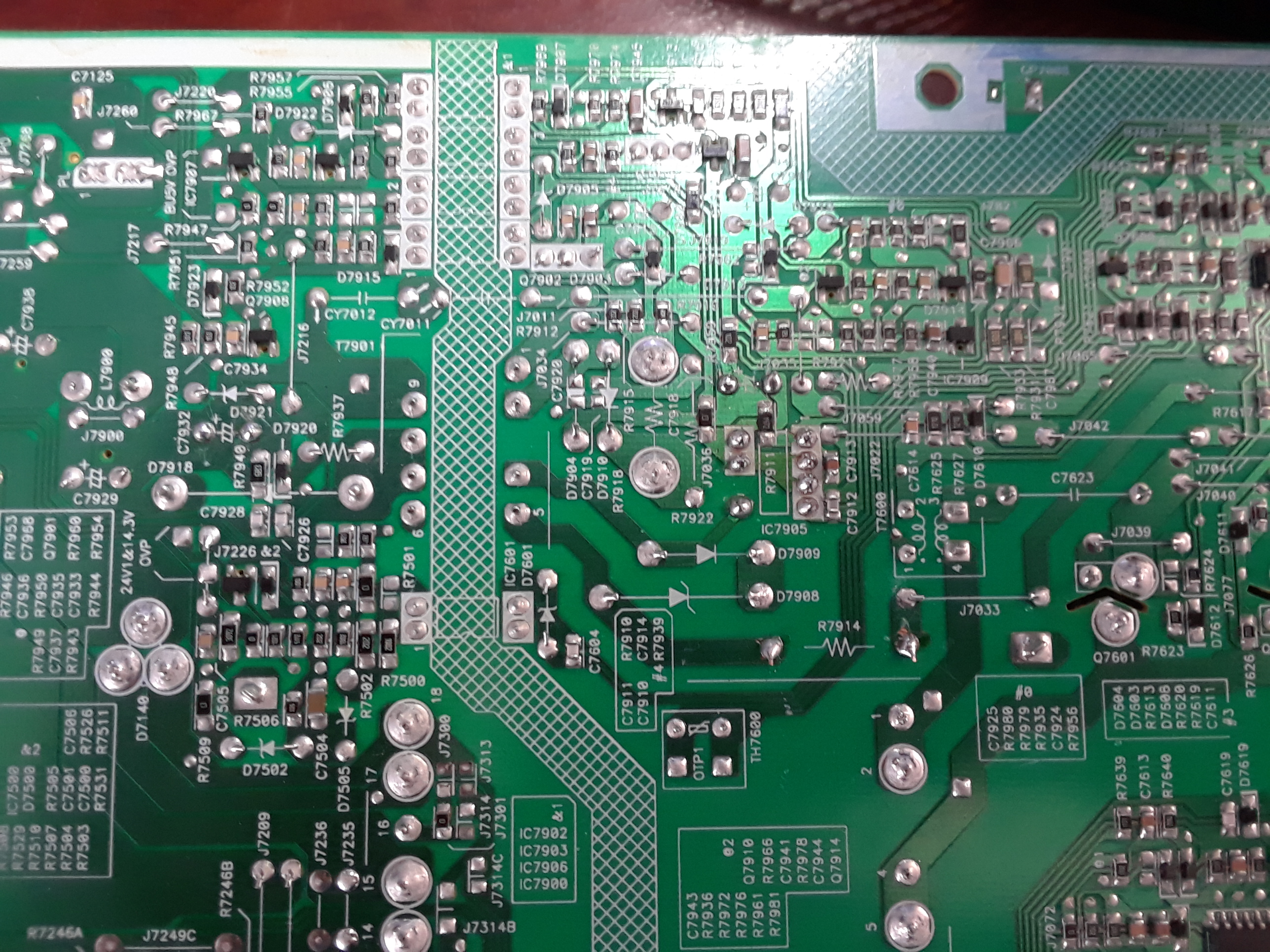

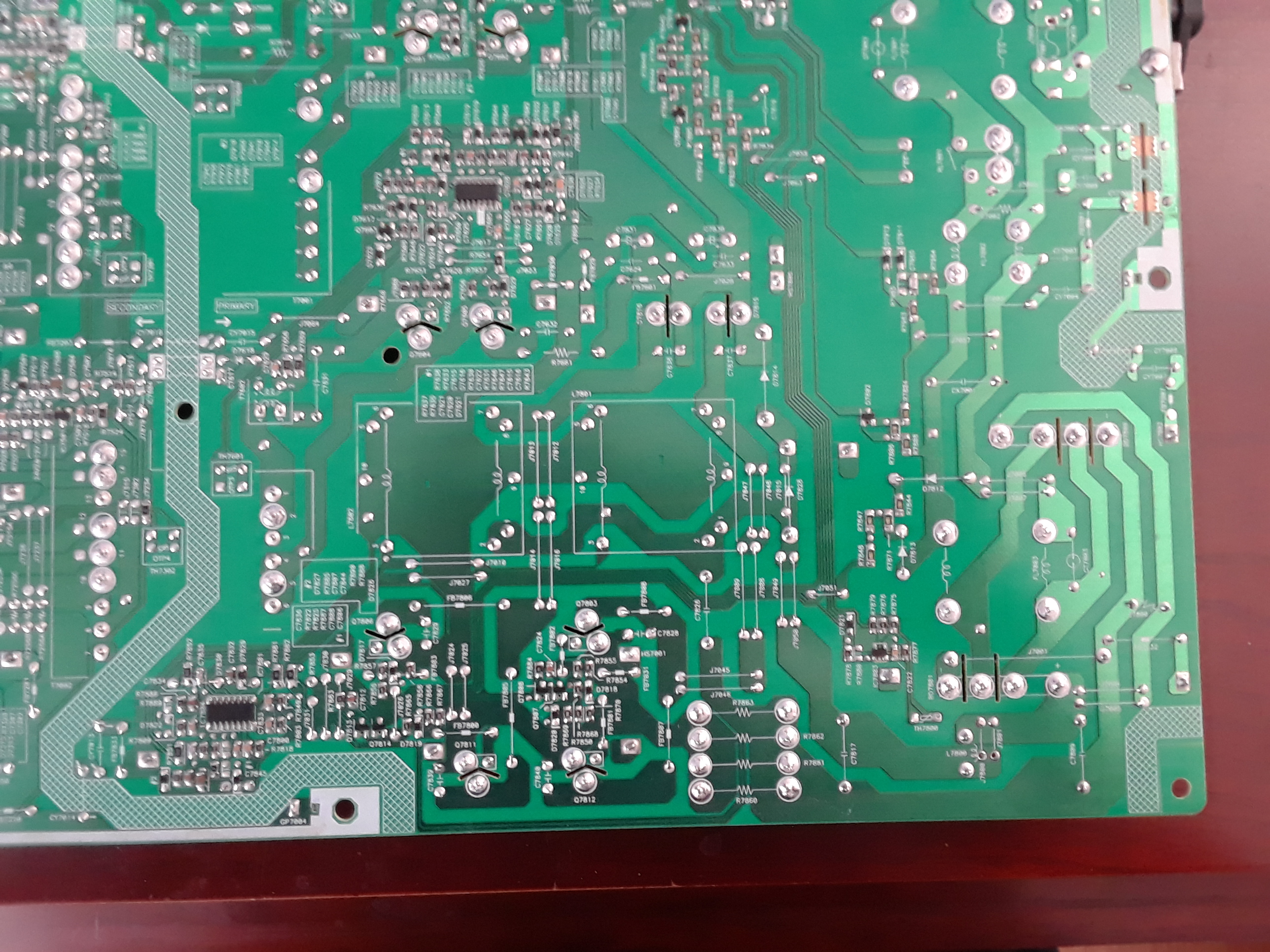

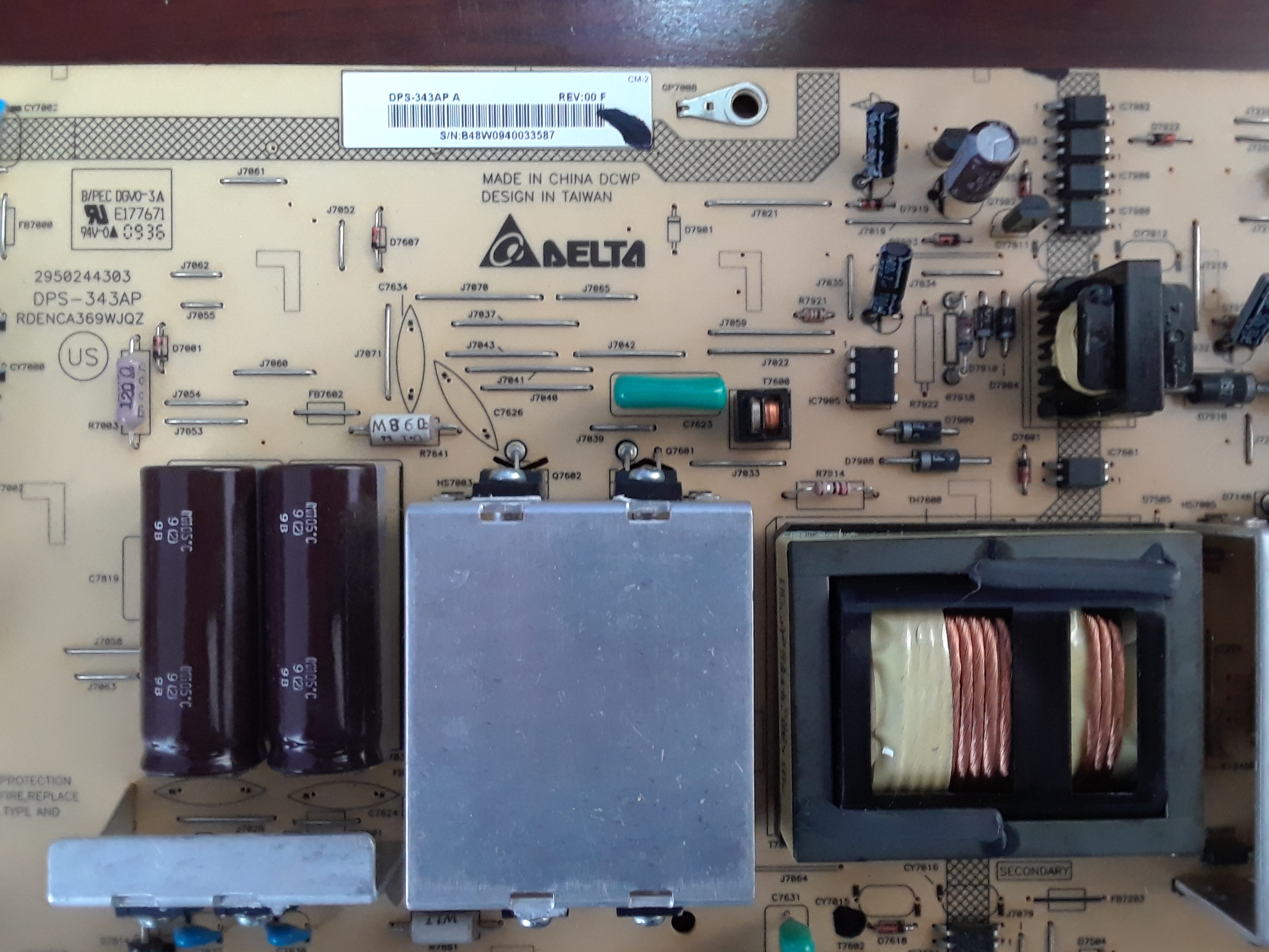

                            I need good clear hi res straight shots of the whole top and bottom side of YOUR board, and also close up of the bottom side of the board around IC7905. I suspect either Zener/opto/solder bridge connected to pin 4 is bad but I need your picture to verify.

                                    Re: Sharpe LCD TV LC60E77UN

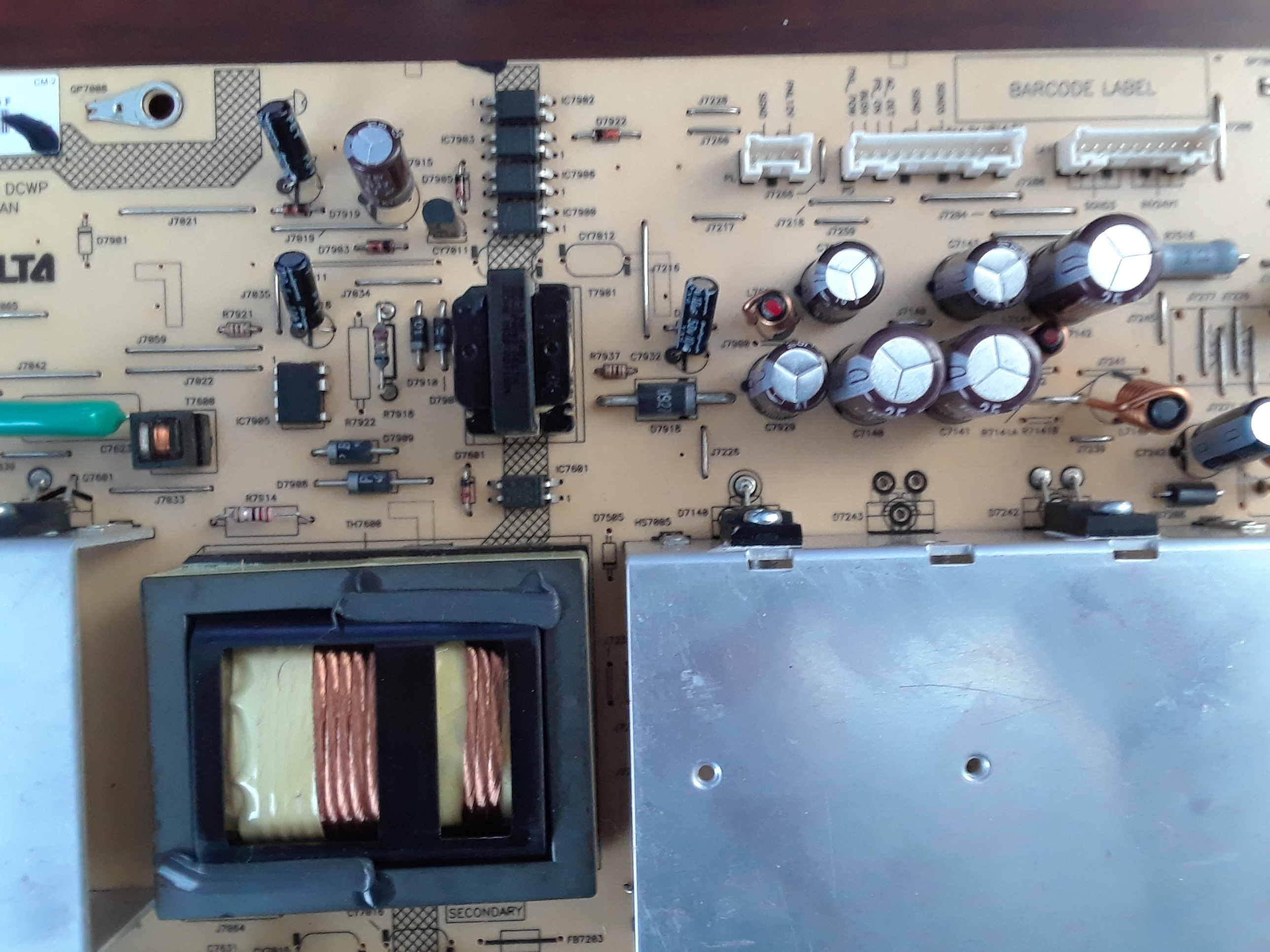

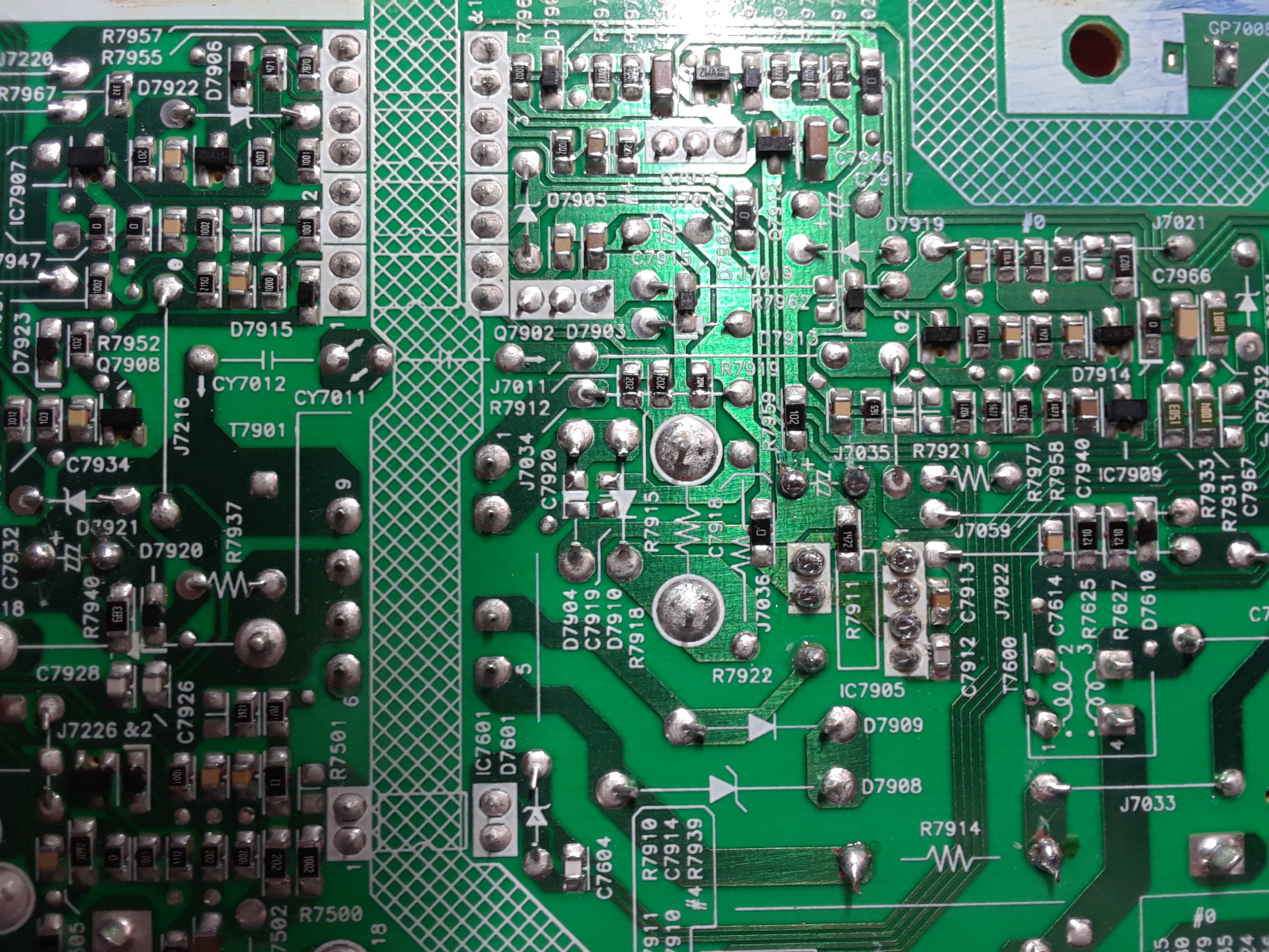

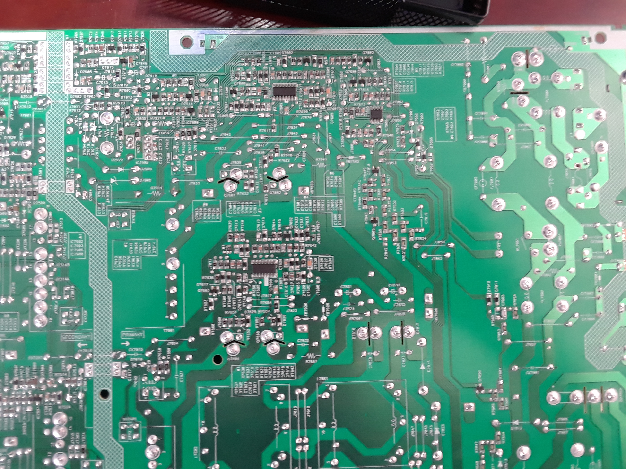

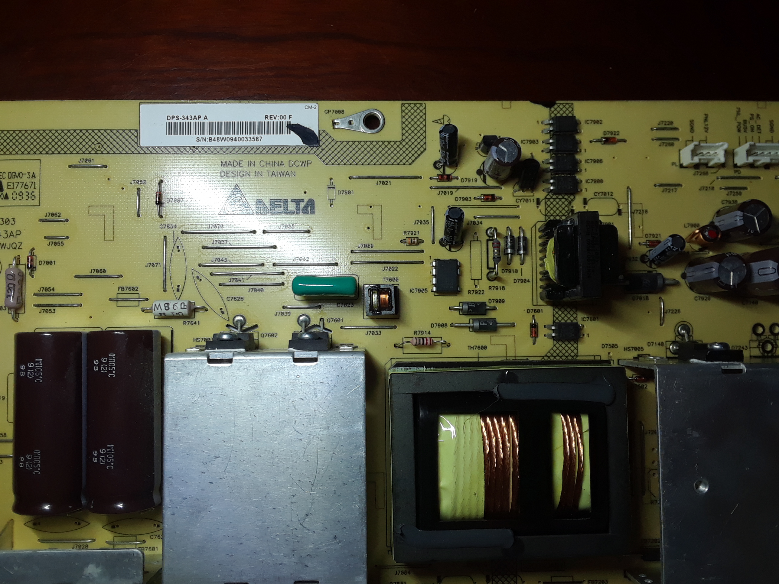

                                    Attached are pictures of my power board. Hope this helps if you require any additional pics I will get them to you.

                                          We need to find out first why Pin 4 of the standby SMPS IC show very low ohms reading, I try to trace out pin 4 of the IC using shopjimmy pictures but it is not clear enough to see where pin 4 goes to. Can you check pin 3 and pin 4 of other OPTO IC to see what they show?
