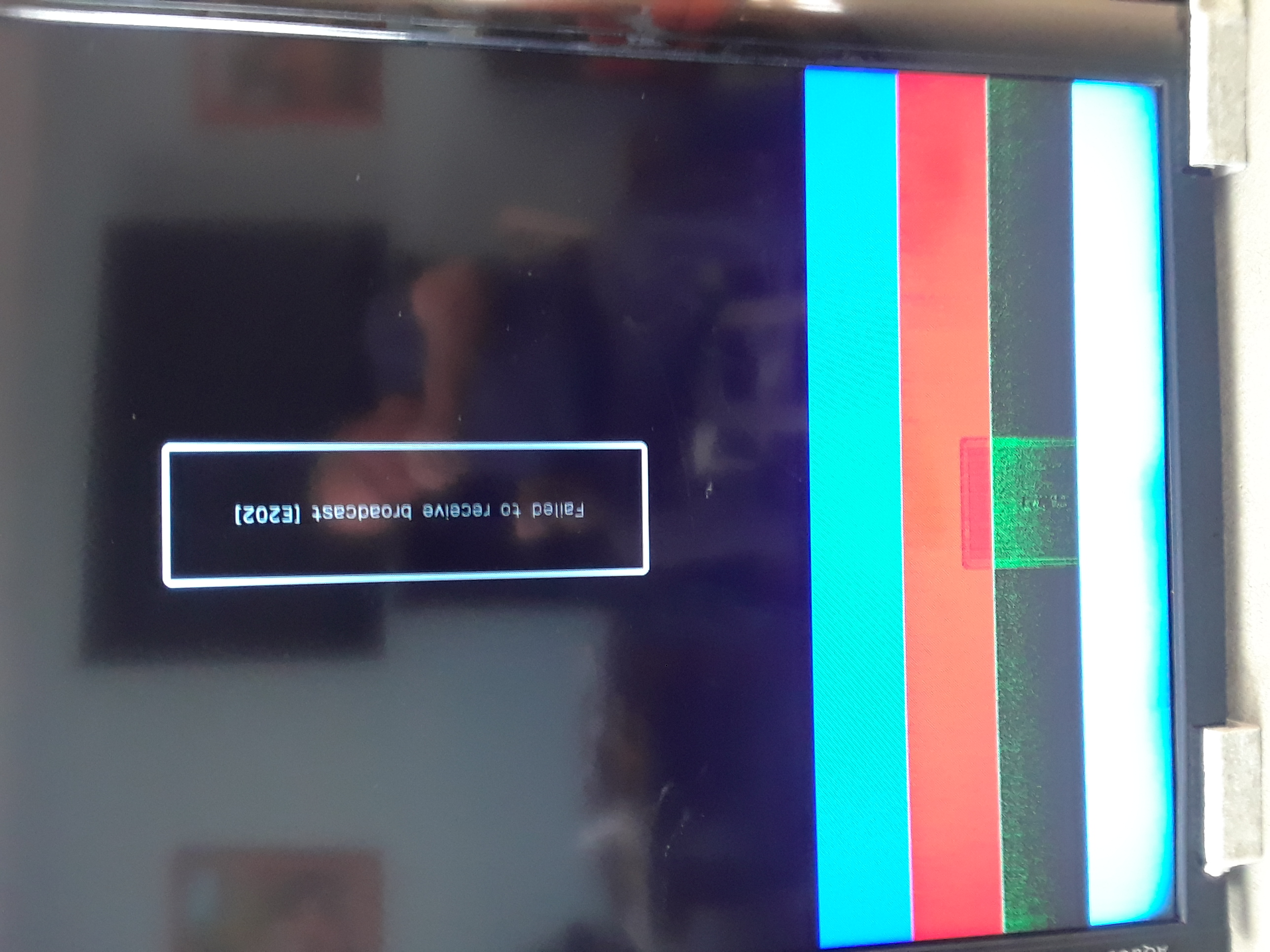

    Thank you for getting back to me. If you look at the above pictures the second one of the back of the board you will see the opto isolators at the top The bottom one is IC7900 and the resistance between pin 3 and 4 is 3.41 meg ohms however the IC above this one IC7906 the resistance between pins 3 and 4 is 2.8 ohms and there is a Zener diode D7905 that has a resistance of 2.8 ohms either way I test it. This diode is connected between pin 4 of IC7900 and pin 4 of IC7903. Hope this helps.

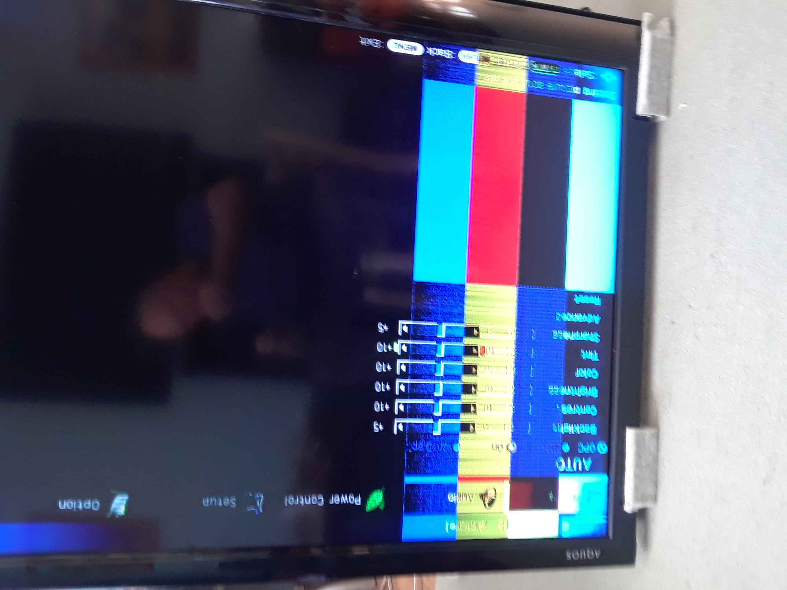

                    #49
                    Re: Sharpe LCD TV LC60E77UN
                    Here is the latest update. I finally received the Zener Diodes that I suspected had failed and I replaced D7905. I then powered the TV up and it came to life. That was the good news. Attached is what is now displayed on the screen. I believe that I still have a power problem but also a video fault. I feel now that this is beyond my capability so I am going to throw in the towel unless the fault is obvious to anyone. Thank you very much to everyone who helped me along the way.
