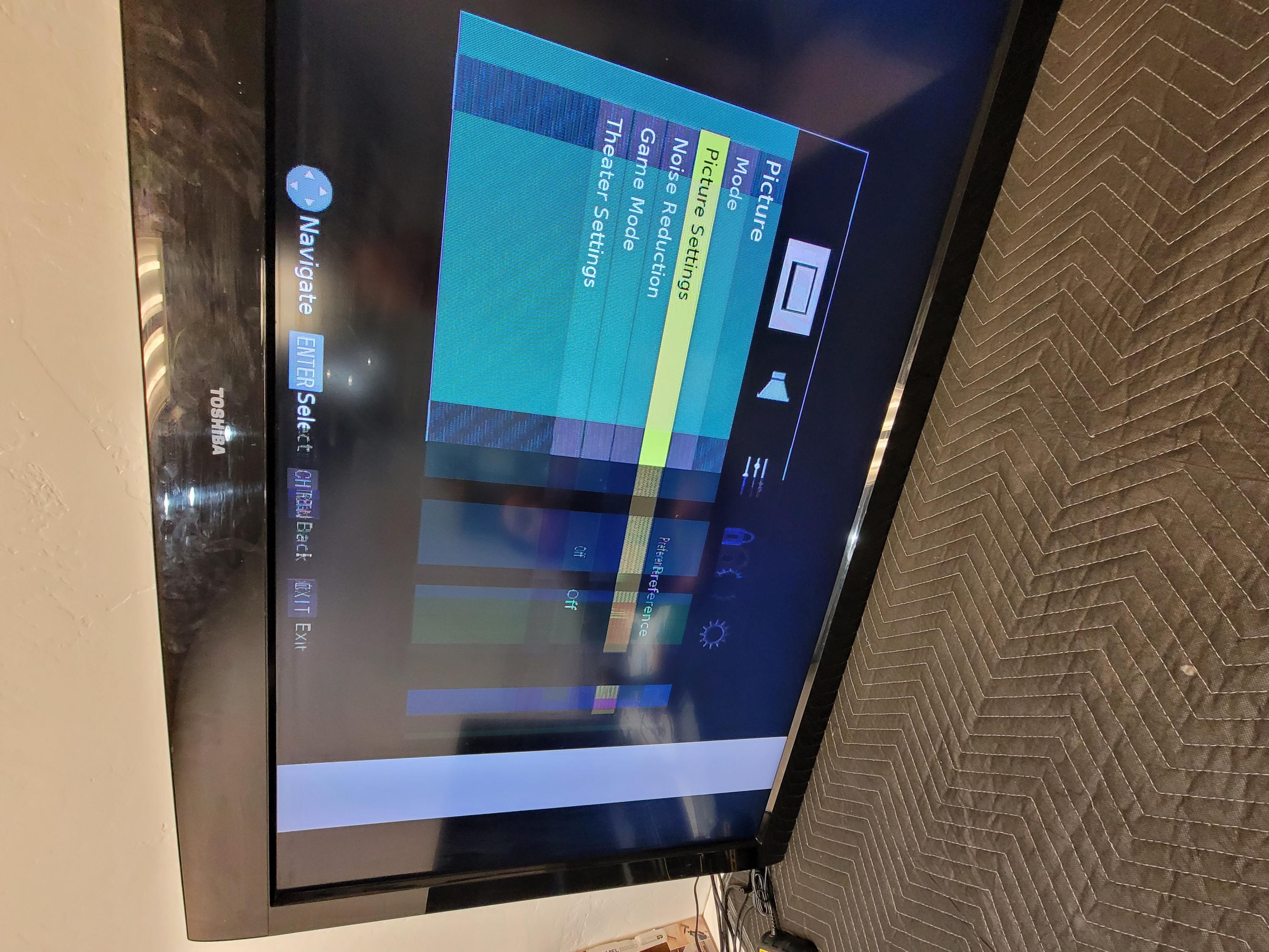

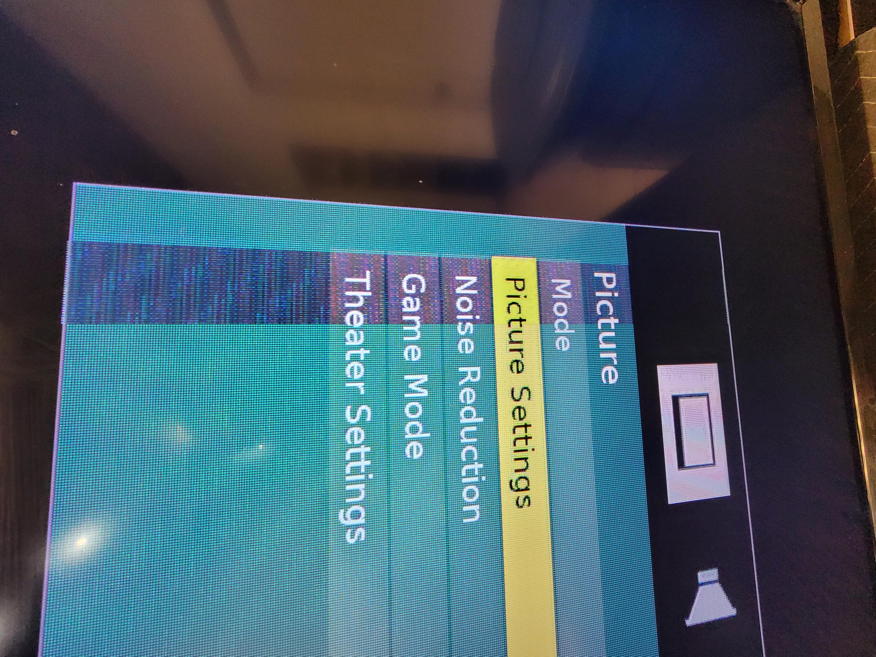

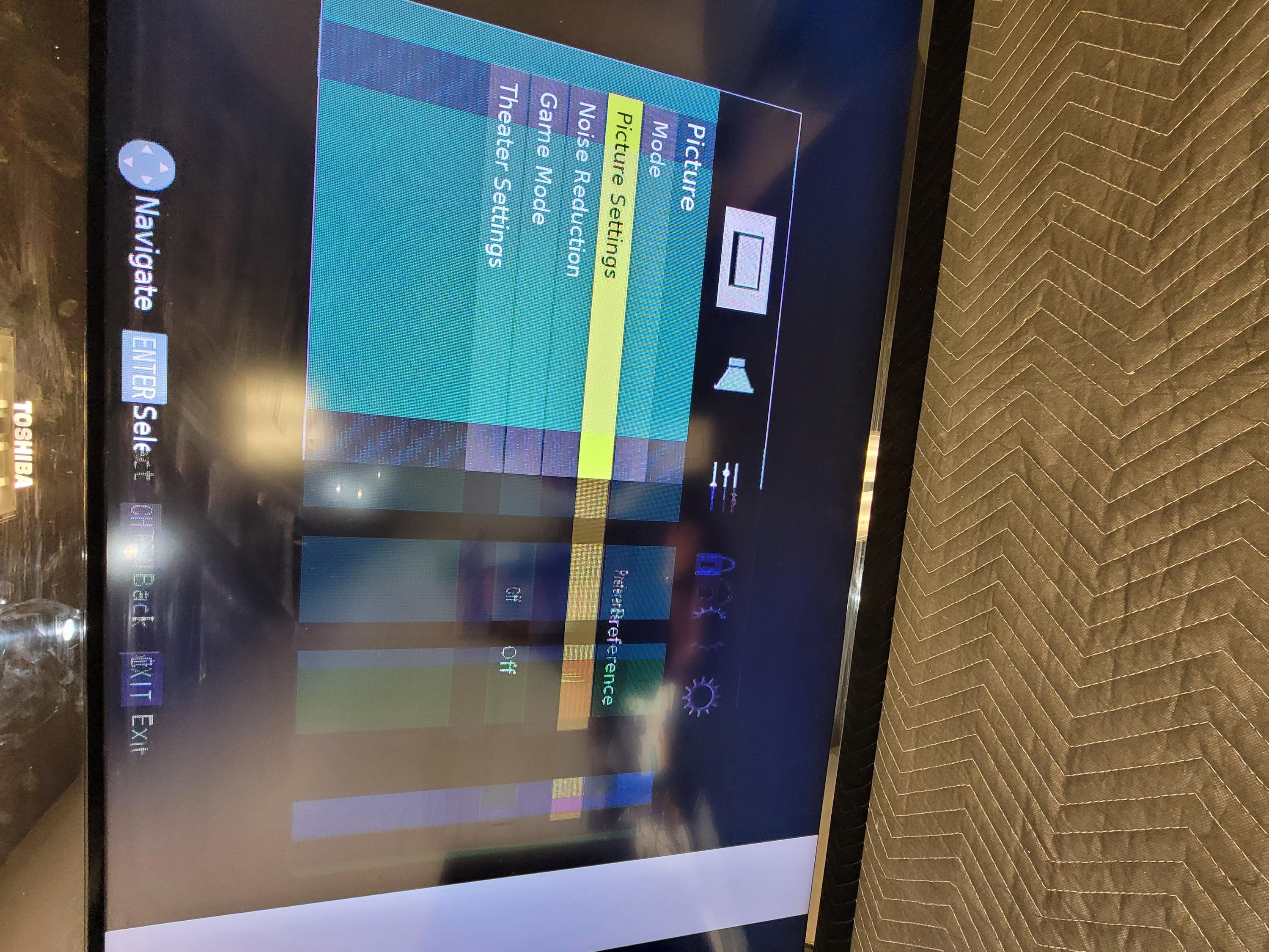

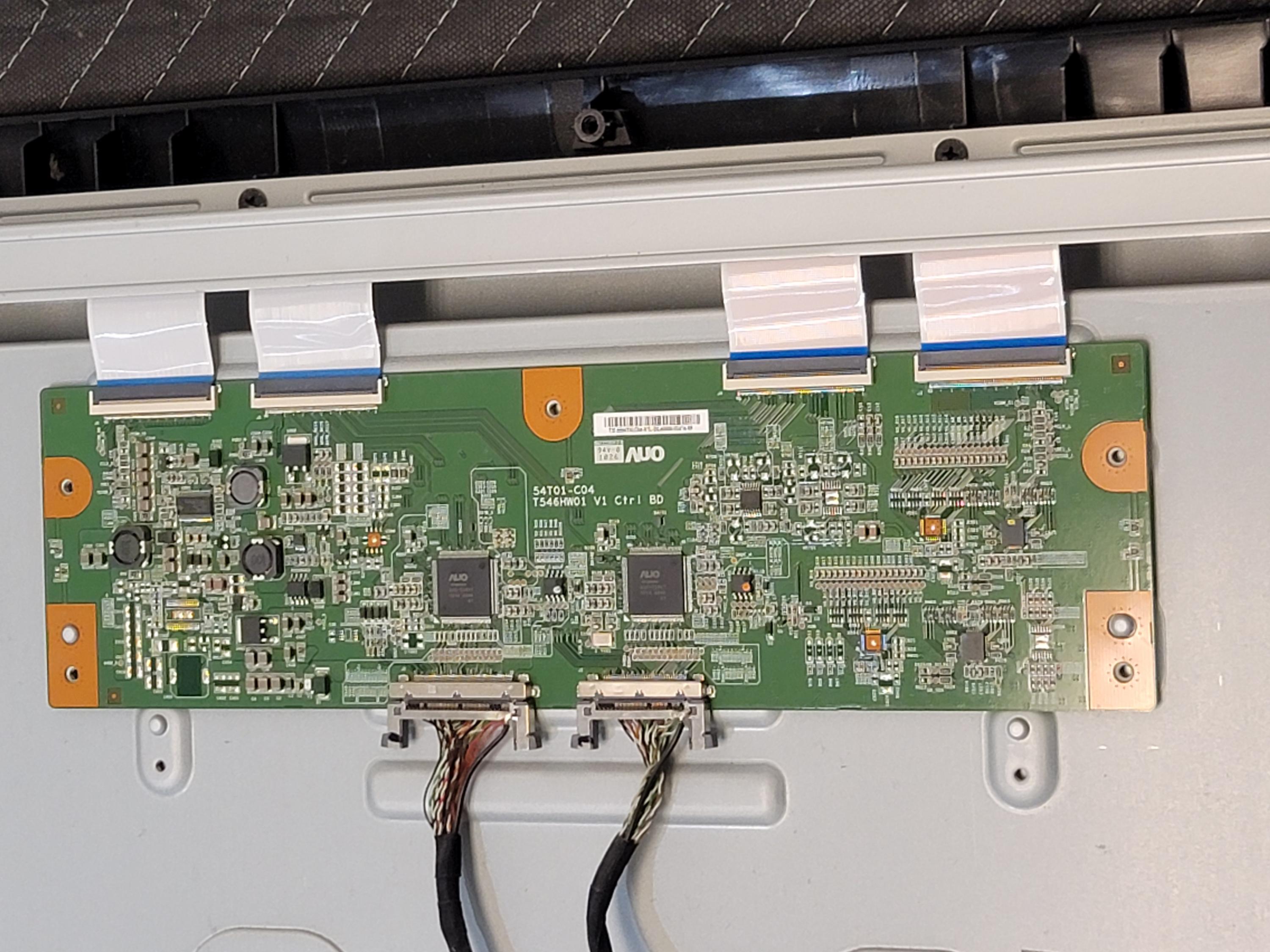

    55HT1U possible bad tcon
    I have a 55HT1U that is displaying an image that is distorted and somewhat "staticy"
    My anticipation is that the T-con is bad. what do you guys think?
    Re: 55HT1U possible bad tcon
    What does it look like with video source?
    What is the history of the TV?
    • petehall347
      • Jan 2015
      • 4450
      • United Kingdom
      looks split in the middle . no idea if its safe or even possible to swap the feeds to the tcon to see if its main or tcon . i would clean connections first
      • Jeryswan
        • Mar 2020
        • 39

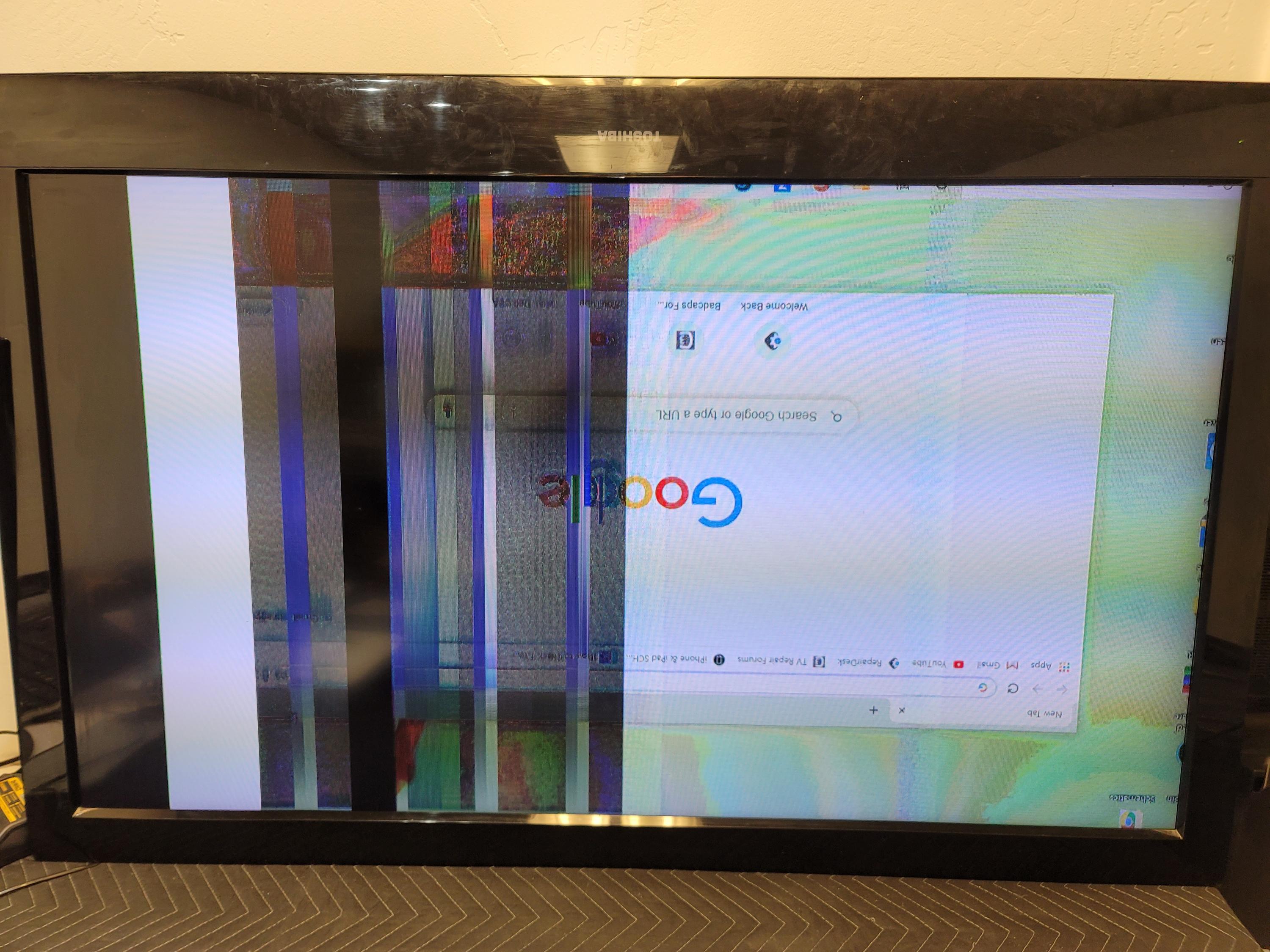

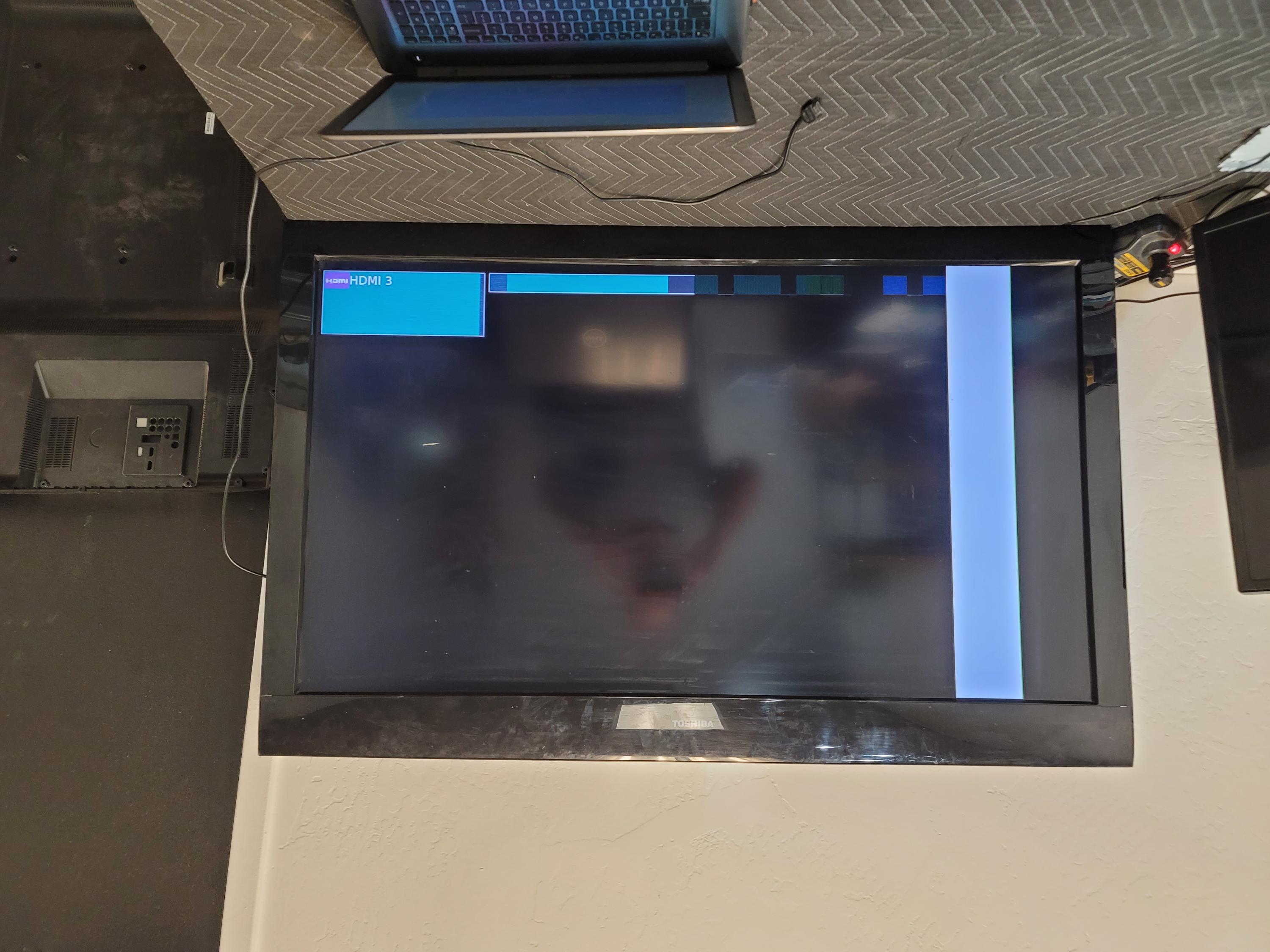

        Here is what it looks like with a video source. One half is still very gritty. The other half is almost indistinguishable. While there is no video, there is a white line down the worse half.
        • Diah
          • Feb 2013
          • 6614
          panel damage..
            Panel problem. Do you know the history of the TV? Used TV?
