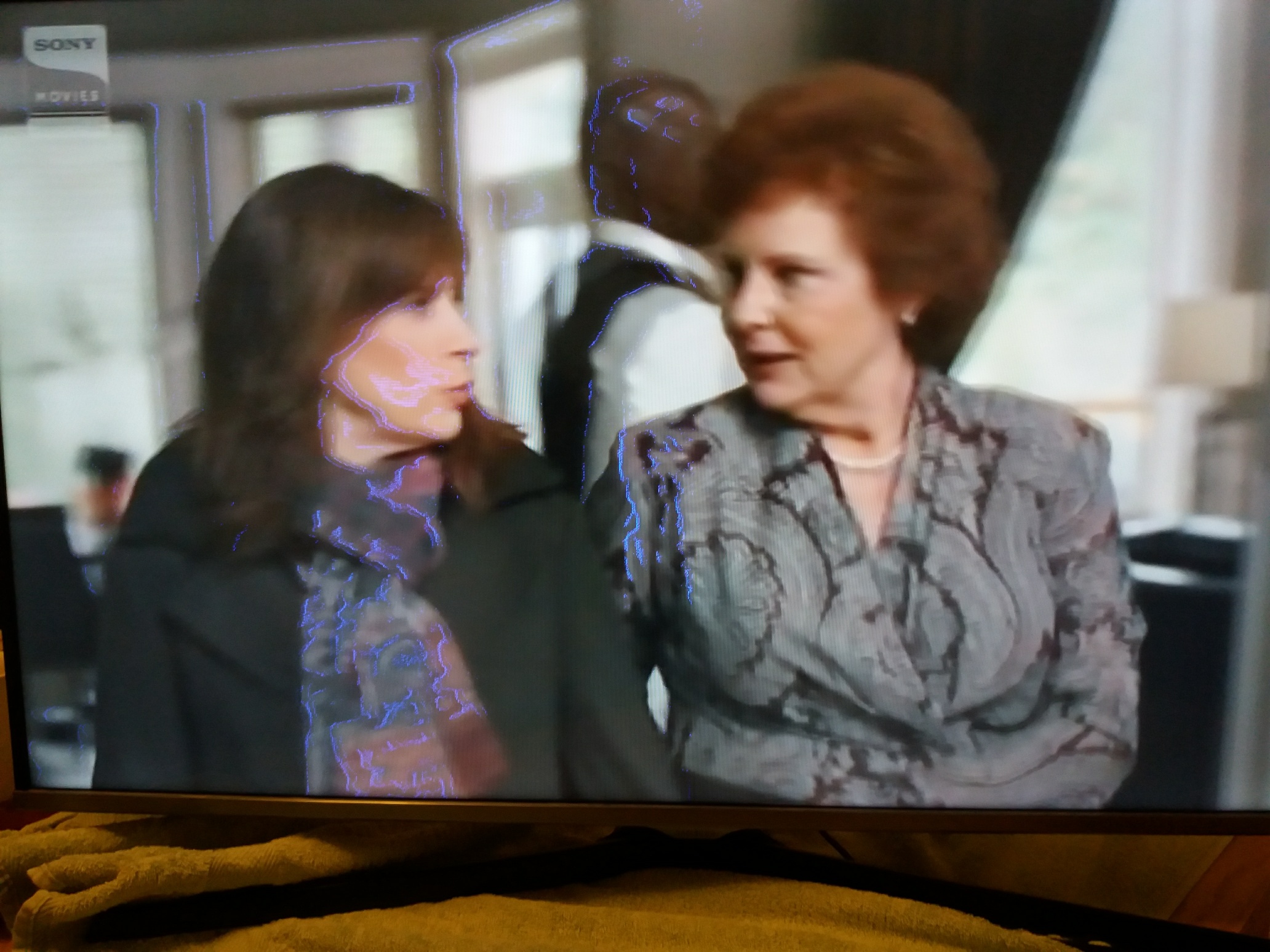

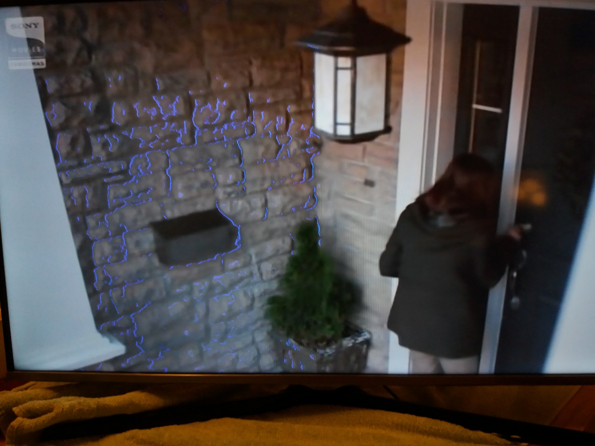

    Samsung 40" LCD originally had no picture - I repaired that fault by replacing the T-Con (RUNTK 5538TP ZA).
    With the new T-Con the left hand half of the screen now shows what I can only describe as 'dynamic blue threads' which appear when there's any blue content in the picture. The right hand side is not affected. The attached photos show what's happening.
    Could my new T-Con be faulty? - it arrived from China wrapped in non-ESD (antistatic) bubble-wrap which is a concern.
    I've searched this forum but haven't found a similar fault mentioned - I hope someone here may be able to throw some light on this.
    Many thanks in advance, John.

    I don't know for sure but I think you got a bad one.

      Have you checked the flat flex and connectors ? If you can't see any damage, try rotating the cable and see if the colour changes.

        Thanks for the suggestion Diif but unfortunately no difference to image after rotating the LVDS cable, I also gave the connectors a good spray with board cleaner to no avail.
        So it looks like nomoresonys wins this round.
        If the TV was mine I'd just go ahead and order another T-Con but I'll have to leave that decision to the owner.

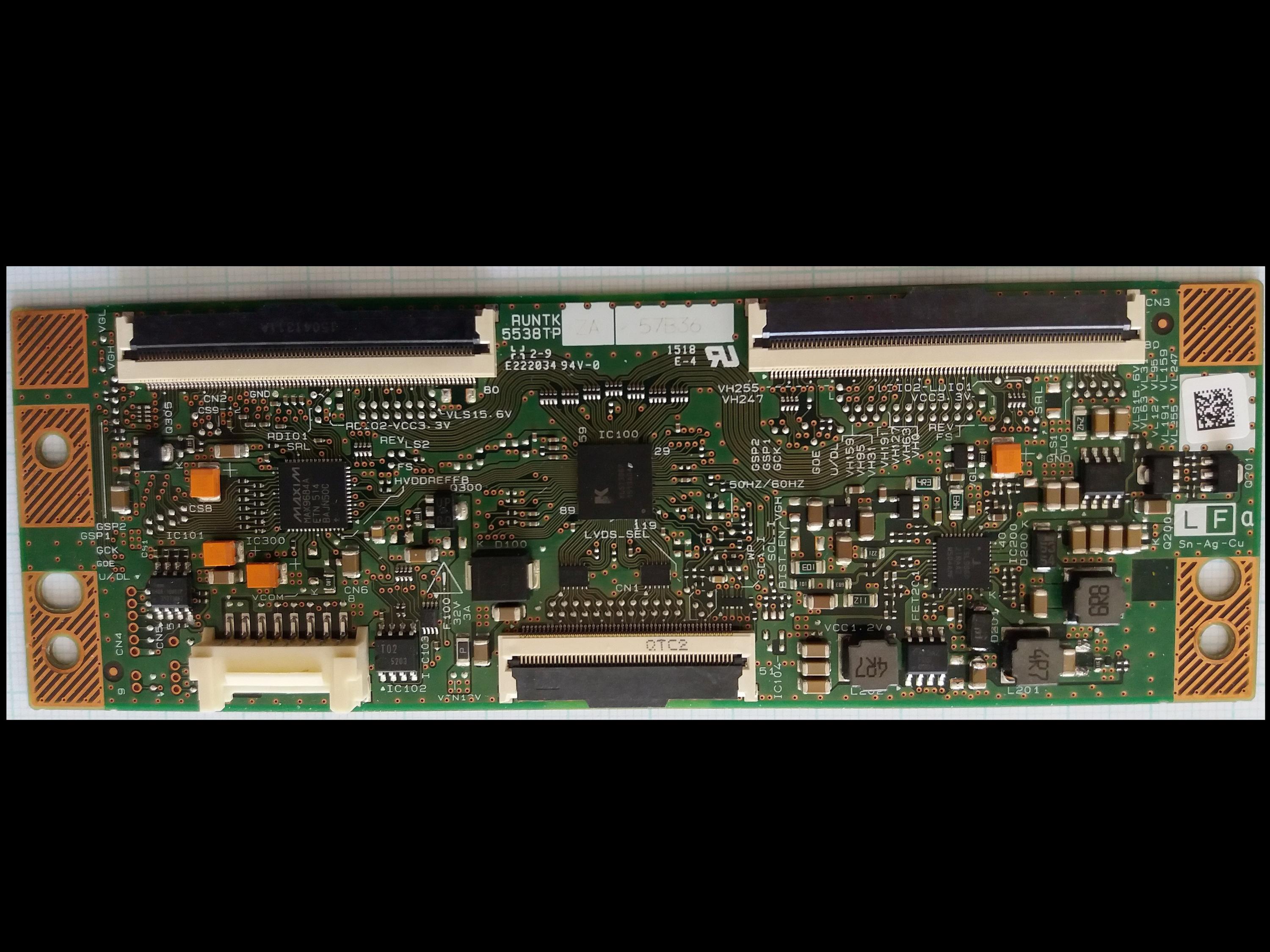

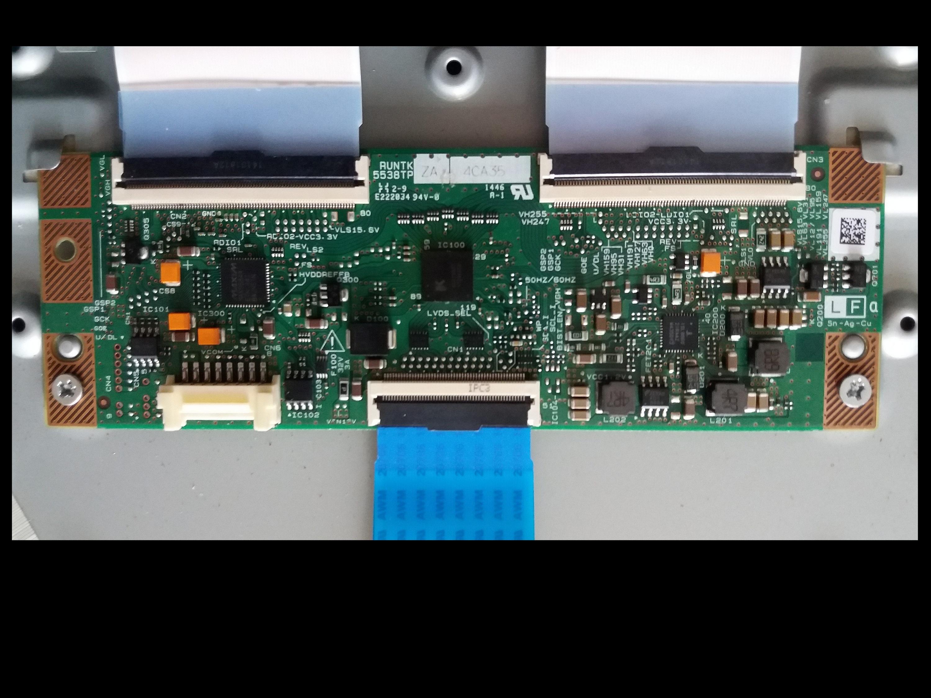

          That looks a little like a solarized picture which you wouldn't expect with a replacement tcon. Measuring the VGx voltages on the Tcon may give a clue as to the problem.
          What is LVDS_SEL written on the tcon. Can you post sharp focused picture of the two tcons to compare

            VGH = 32.4V
            VGL = 6.0V
            LVDS_Sel = 0V (So LVDS data format = JEIDA)

              I'm no expert, just an observation, but on the new board there's a pin on the right hand ribbon cable just to the right of center that doesn't appear to be connected compared to the old board.

                I was hoping an eagle-eyed sleuth like yourself may be able spot the problem but that pin buzzes out ok between the pcb track and the pin side of the connector.

                  Is VGL +6V or -6V. I think VGL is normally a negative voltage.

                    Yes, VGL is -6V
