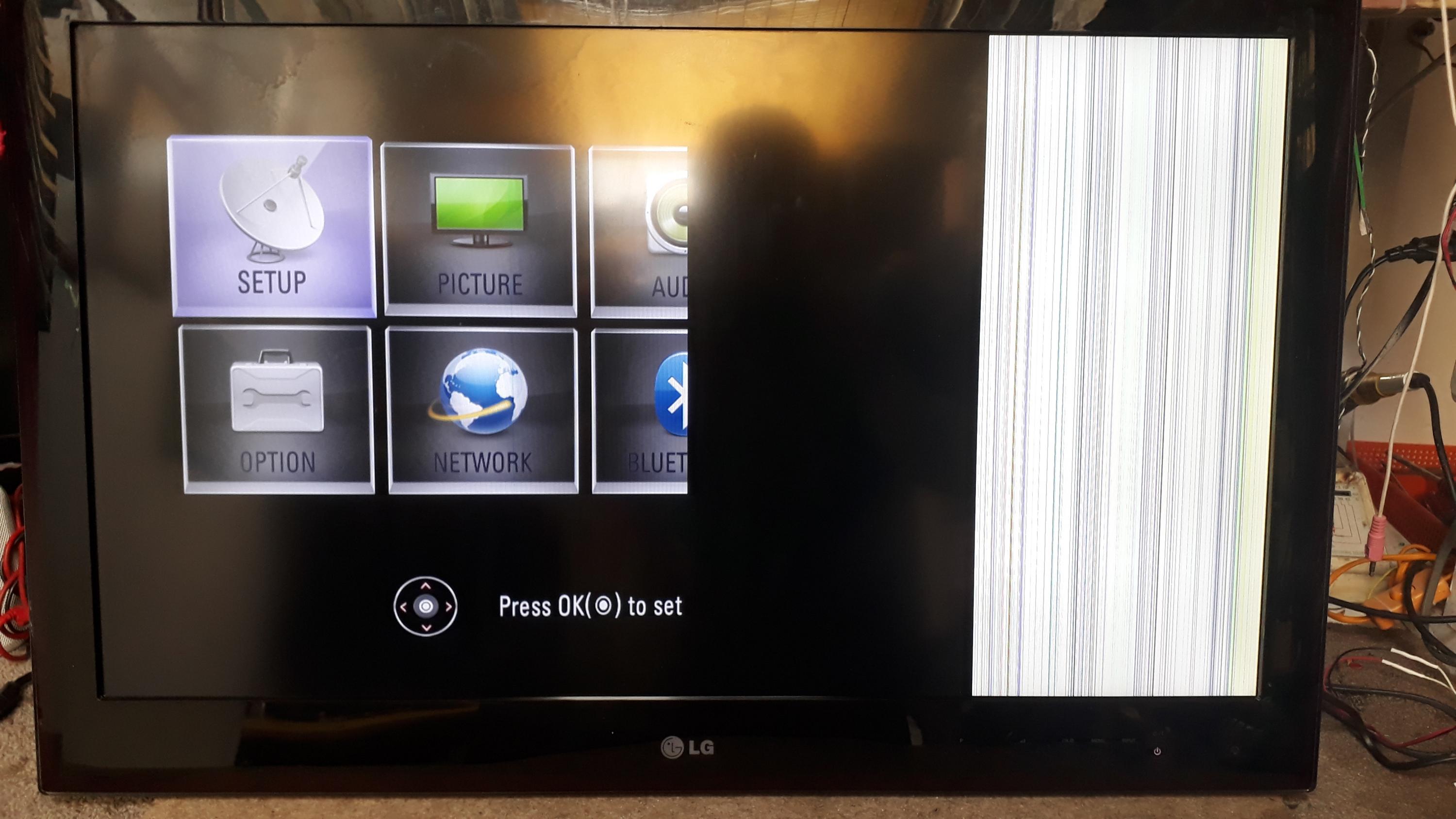

    Hi All
    I got an LG 32LE550 TV
    Half the screen has a picture the other side is blank with some vertical Lines on the Right Hand side
    I think it may be the panel.
    Hope someone else can set me right
    James
  • Duranitron
    • Jul 2014
    • 544
    • Philippines
    Re: LG 32 LE with half picture
    your correct its an lcd panel problem.. your best option is test all the components there hoping to find shorted cap or blown fuse try to press the flex if the panel response you've got a loose flex on glass bonding a temporary fix is just pressing it with something and hope it holds. . focus on the defective panel. putting new tcon there will not solve the problem
