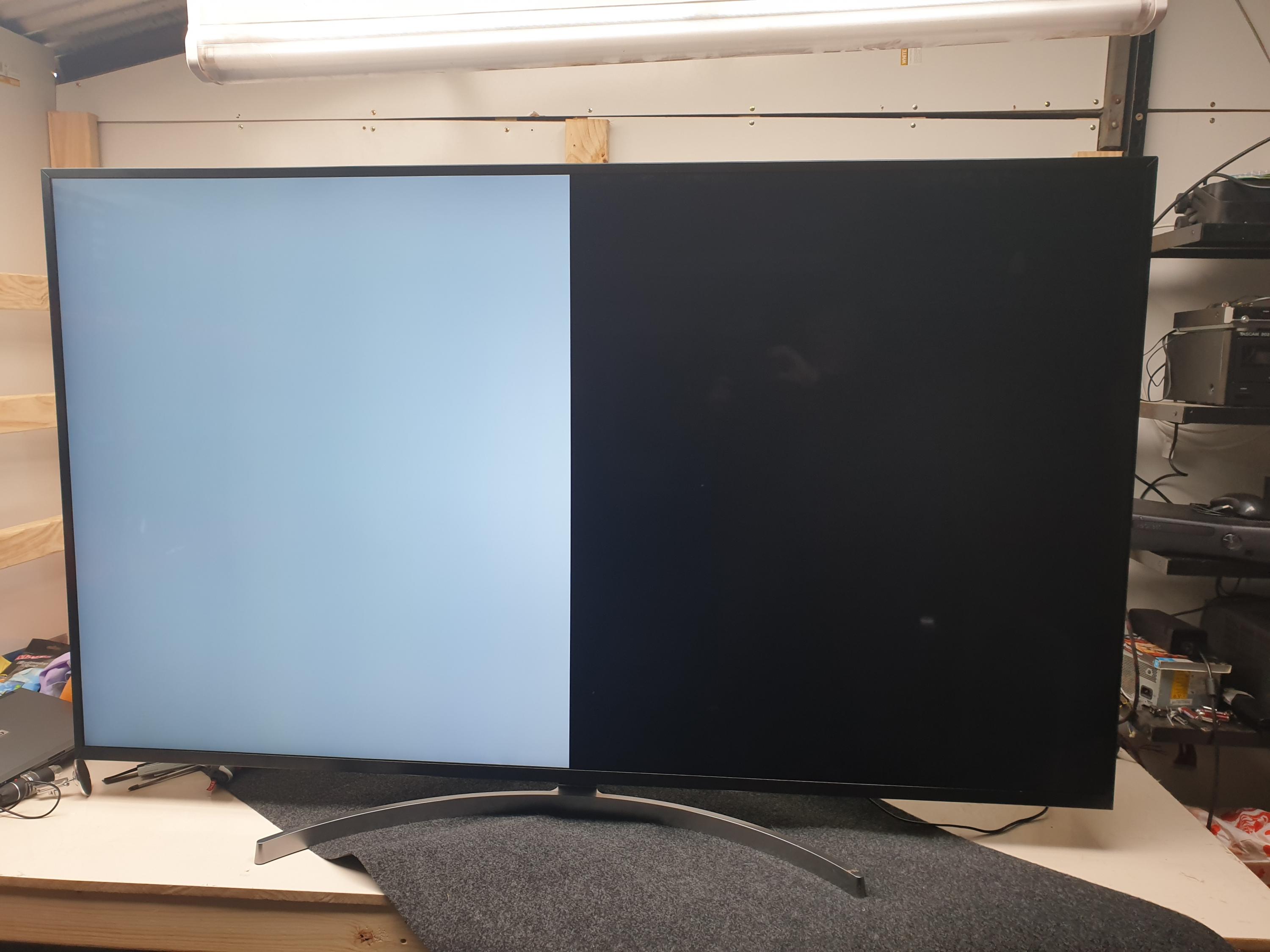

          when i unplug the right hand side SVDC cable on the tcon i get a white bar on the screen nice and bright picture, but the left hand side of the screen remains dull blue , i swaped to the right by unplugging the left and plugging the right back in on the Tcon and i still do not get a image it just remains blue
          I do get a very defined response from the remote control you can see shadows moving on the screen so i believe the main board is ok
          I have 13.2v at the fuse on the TCon board & 12v present on the 4pins on the 51 pin SVDC cable

            Re: LG75SK8000PTA Blue screen no image shadows showing
            Is the lower Buffer Boards the issue maybe
            show us please here photo on how it look the screen when you disconnect the ribbon cable between T-CON and panel ( you called them SVDC ) prefer with signal .
            BTW. try to access to lower Buffer Boards of the panel...you have on each side at this boards U ribbon cable at the middle . disconnected ..start with the fade blue side.. also prefer with signal..
            any further diagnostic always helpful if you upload photos over here showing the issue..

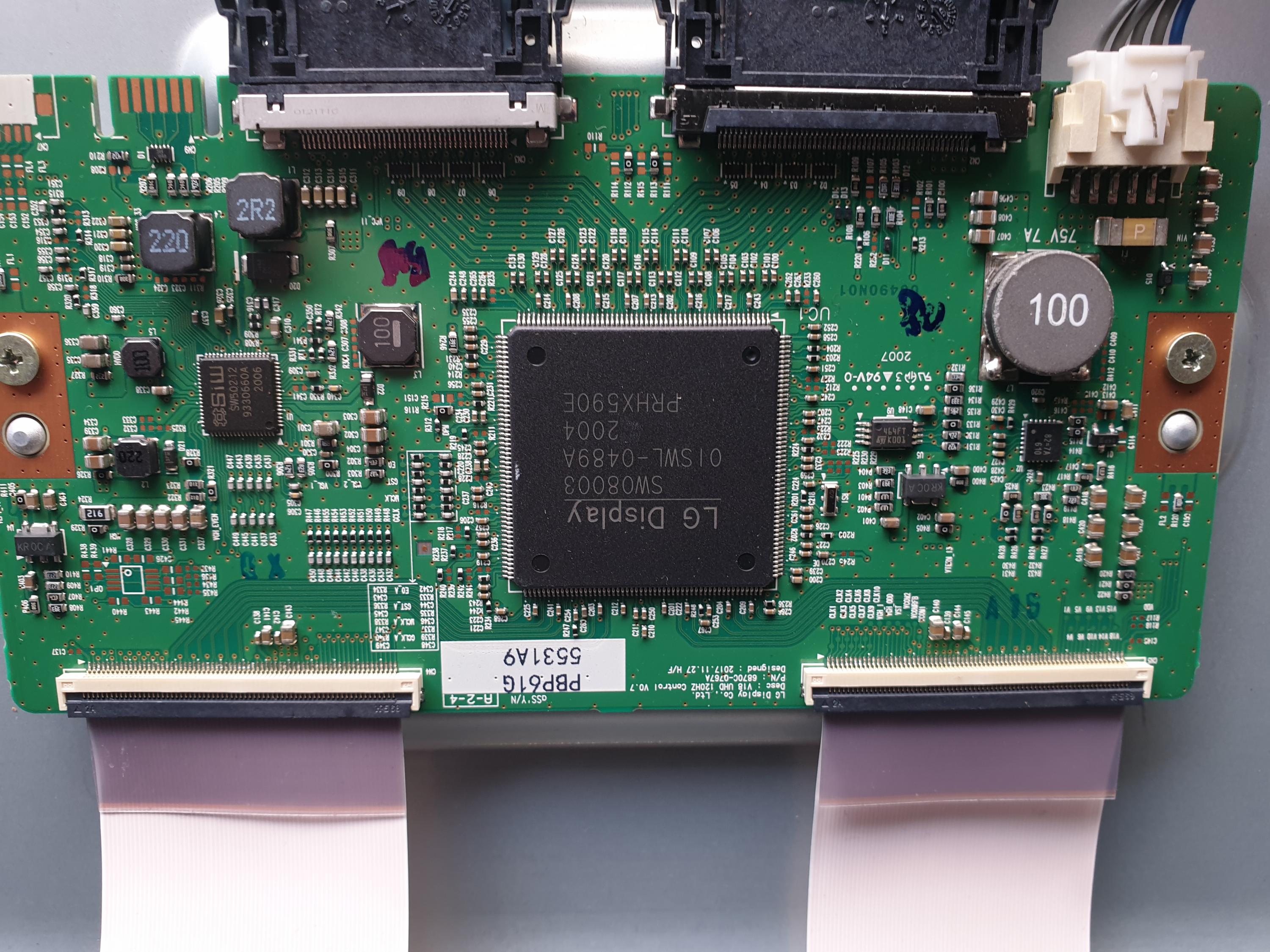

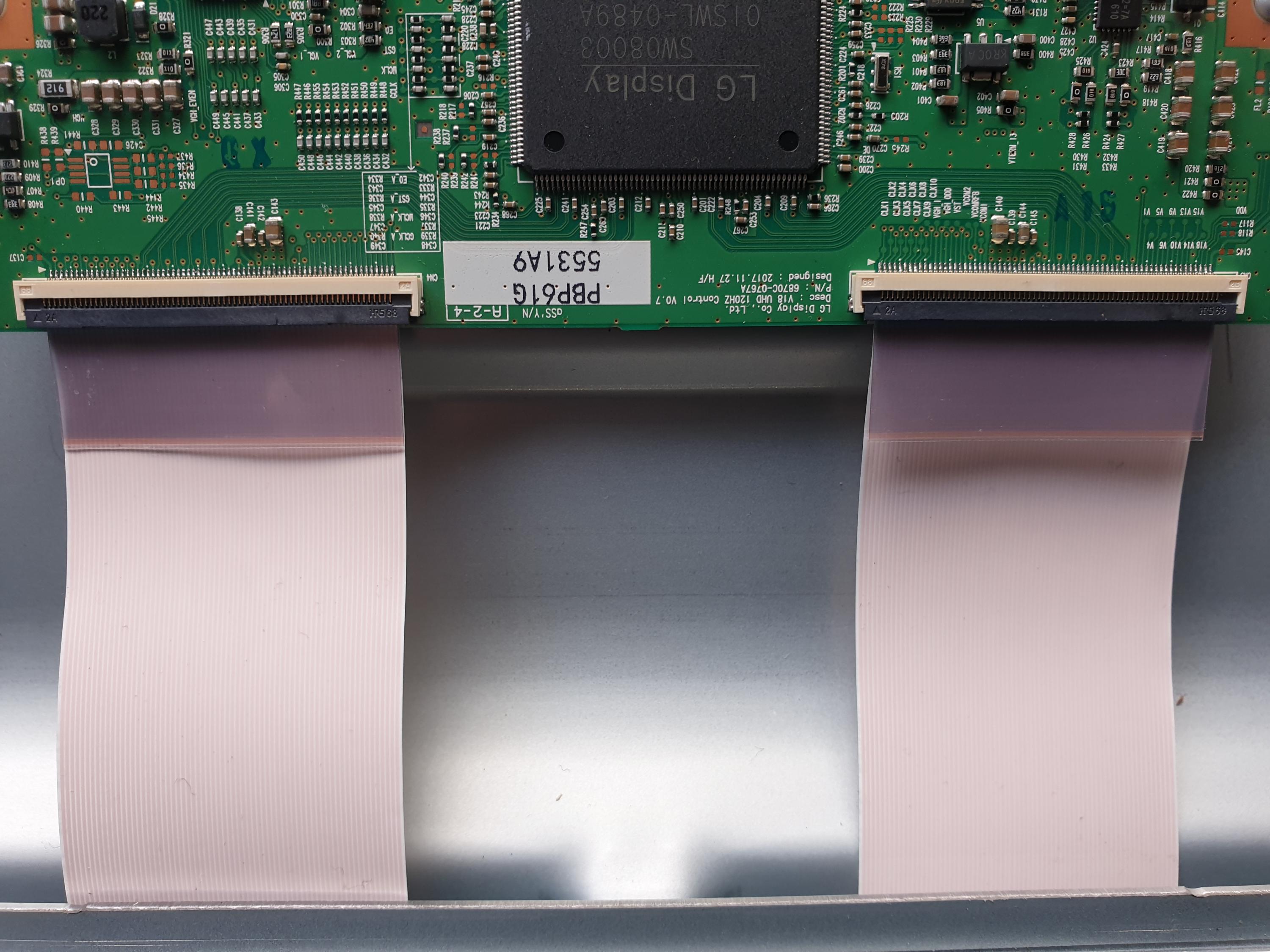

                I have now uploaded high res pics of the tv boards and the Tcon right hand cable disconnected as per your instruction with a source connected
                when I connect both tcon ribbon cables I get a dark blue faded to black screen
                no IMAGE No SOUND no channel or input display
                I have tested the tcon fuse ok 12v
                i have tested the lower FCC board where the tcon ribbon cables connect
                i have 13v plus 3.6v lines
                I don't believe it is the main board as I can see a response from the smart remote control like dark shadows moving when I press the remote
                your help is appreciated
                thankyou
                    thankyou
                    please check the following.
                    1- check on the side of Main boards sockets ( which it come from PSU ) if you have 20V.?
                    2-unplugg the wifi socket and check your TV screen.
                    Update i am still waiting on a LG service remote to be delivered so I can Perform a IN- command
                    if the points 1&2 above was done and no change. lets wait for yours LG service RC to send IN_STOP. if no change then it may we are facing BGA issue at the Main boards.

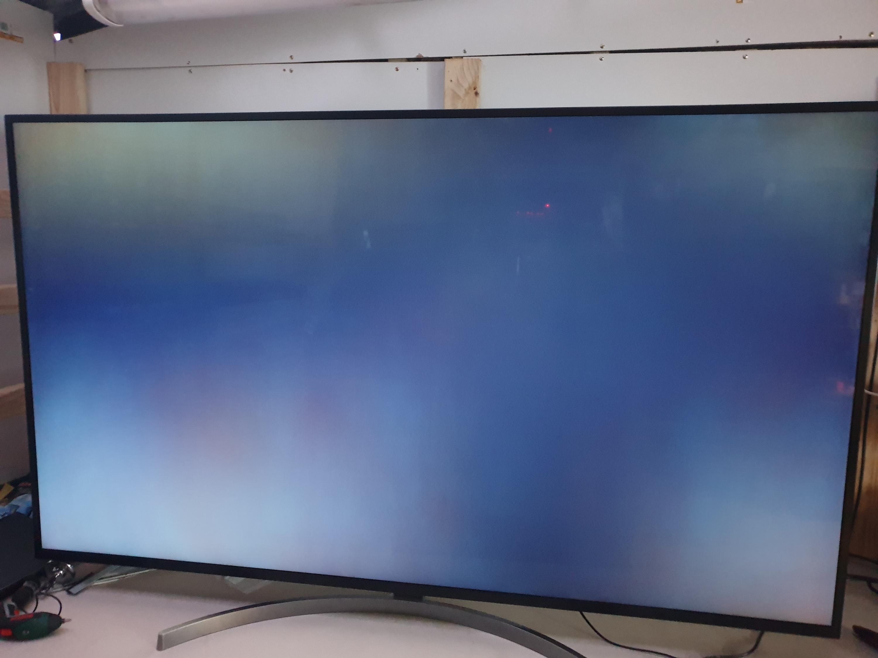

                      Hi here is updated Photo of Original Fault condition showing No image
                      Backlight on

                        DIAH just a quick Note ...
                        when I first received the tv it was showing this condition
                        so I thought it was a Tcon issue Reballing BGM chip
                        So I have a Heat bed I use for doing Ipads screens etc So I laid the Board down Chip face down & heated it for 4min at 150deg i then plugged it back in and I had the channel number and LG Logo come up on the screen for 1 Minuet
                        So that's why I thought it was the TCON board and ordered a new one
                        I have since replaced the TCON board with the new one from LG and the Photos of the Blueish screen is what I am presented with now
                        I am a little confused as to why the old Tcon Board responded after I heated it for a sec
                        But the new one wont respond at all ?
                        Anyway I will try the following instructions you stated and report back
                        Again thankyou for your assistance

                                      Hi Diah
                                      I received service remote and tried N-stop that did not work
                                      so I ordered and I put a brand new Mainboard in
                                      I have an instruction sheet that came with the mainboard from LG
                                      stating that I have to follow a 3 step process to make it work
                                      1. I have to make a USB disk and download from GPRS website portal a special firmware patch
                                      2.then I have to install it on the tv
                                      3.then I have to change the ID serial country number
                                      then I have to perform a N=stop command from the service remote.
                                      Problem is I can't access the GPRS portal as i am Not an authorised service agent so i am unable to download the file required
                                      I have checked the LVDS cables on the tcon board and the ffl boards
                                      they seem ok

                                        you make it complicated and lost as we here the reader lost too.
                                        Now you have Empty T-CON with Empty Mainboards.. so if you cant have the patch firmware at any reason.. you need to put back yours Original Mainboards in place... then take out the SPI flash from the original T-CON, dump the firmware of it and write ( program ) it on the New T-CON SPI. so it should be and i did wrote it at the end of post #14
