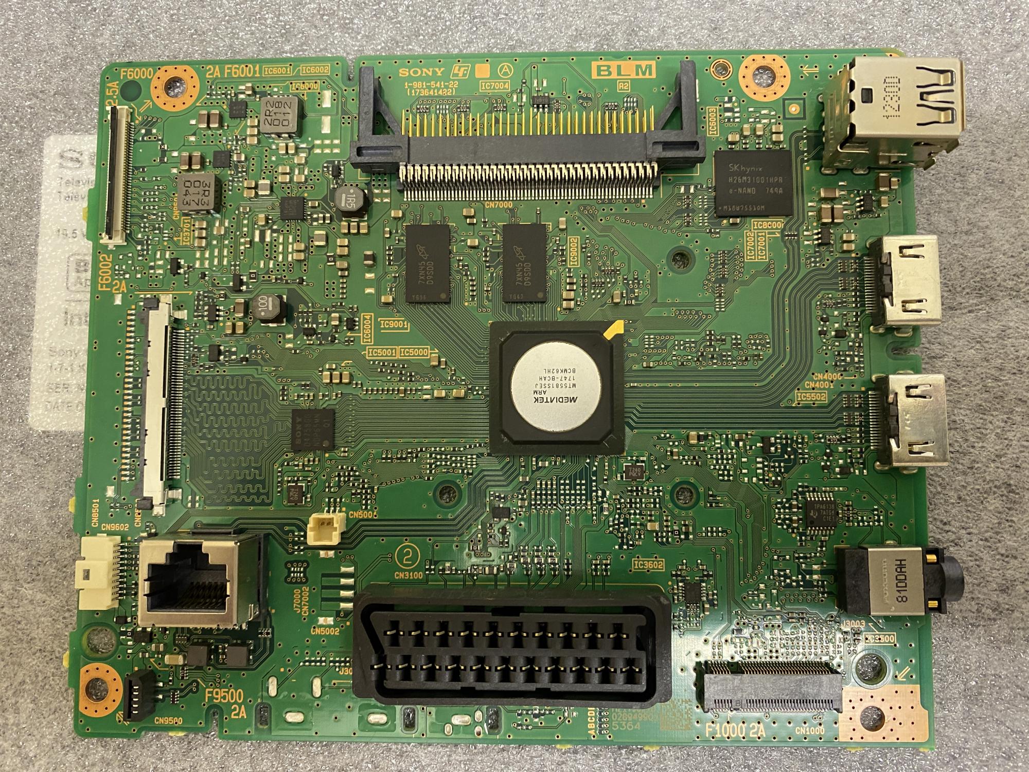

    Hi guys been a while but I am still here
    Latest project got this Sony 4K for £10 as not working, was told came to it one day and dead
    No Led light when plugged in no power, suspected power/led board, replaced with used part still no power so replaced mainboard, TV powered up and was perfect ???? however as the set warmed up the right hand side of the screen started to go lighter than the left and get patterns in the background.
    I think faulty mainboard, so ordered another mainboard from another seller, result exactly the same perfect picture when first on but as set warms right side of picture goes lighter maybe hazy and same pattern in picture.
    This set does not have a tcon board appears to be built in to the lvds board on the screen
    Anyone any ideas on a fix for this now, not looked at lvds/tcon board yet

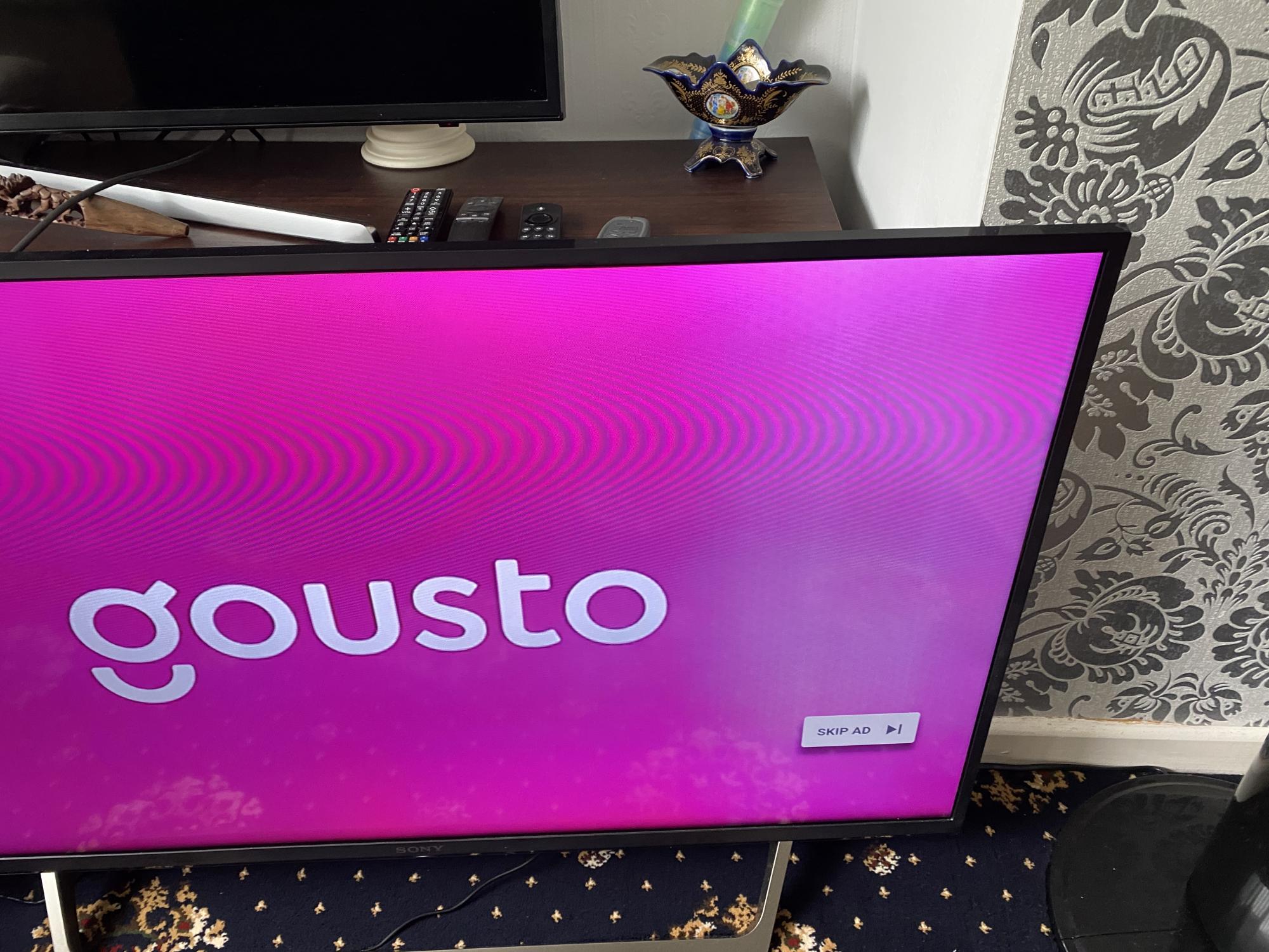

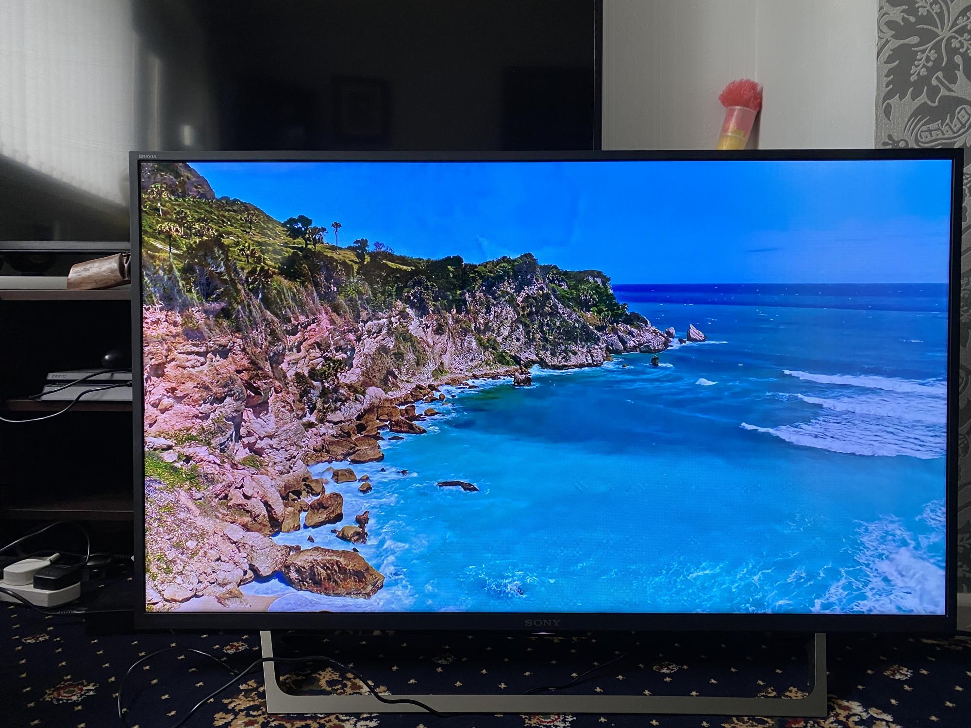

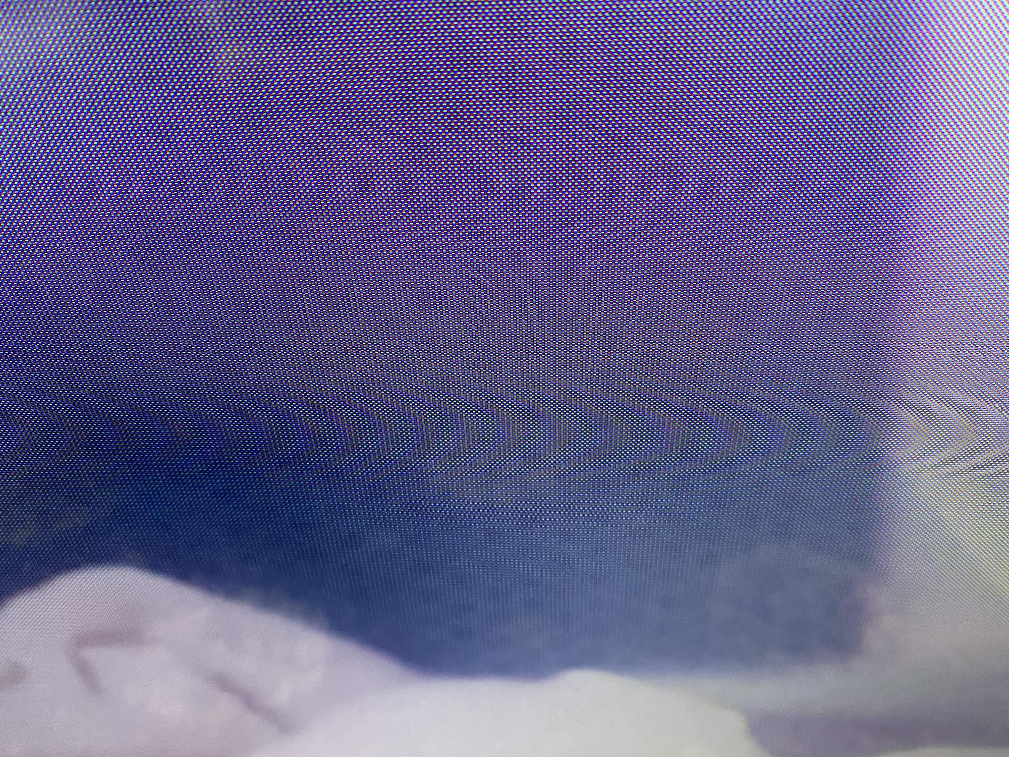

    Not sure how well the pics will show the fault but will post some, bear in mind picture is perfect on a cold set
    Picture is also ok on the Sony picture test screen
    Hope someone has some ideas on this one

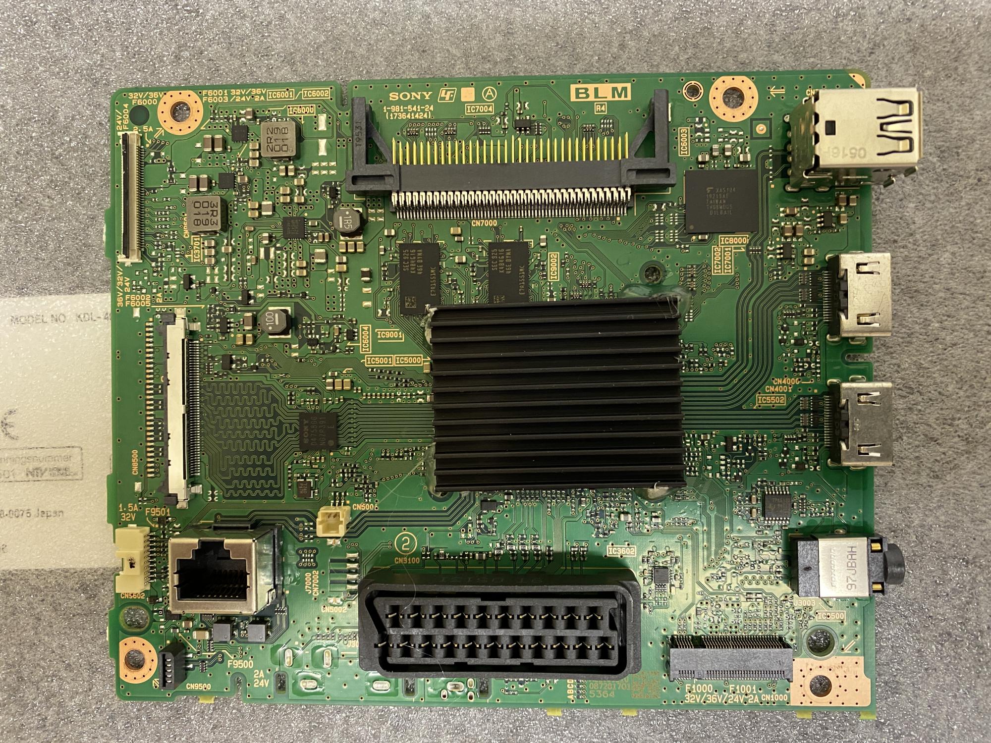

    I have now put a heatsink on to the big chip in the centre of the mainboard which I assume is the graphics chip, no difference picture still goes the same as it warms up

                        Hi yes the built in sony test picture seems to display ok
                        Display fault seems to appear whe using tv through antenna signal and playing youtube etc through built in wifi and app

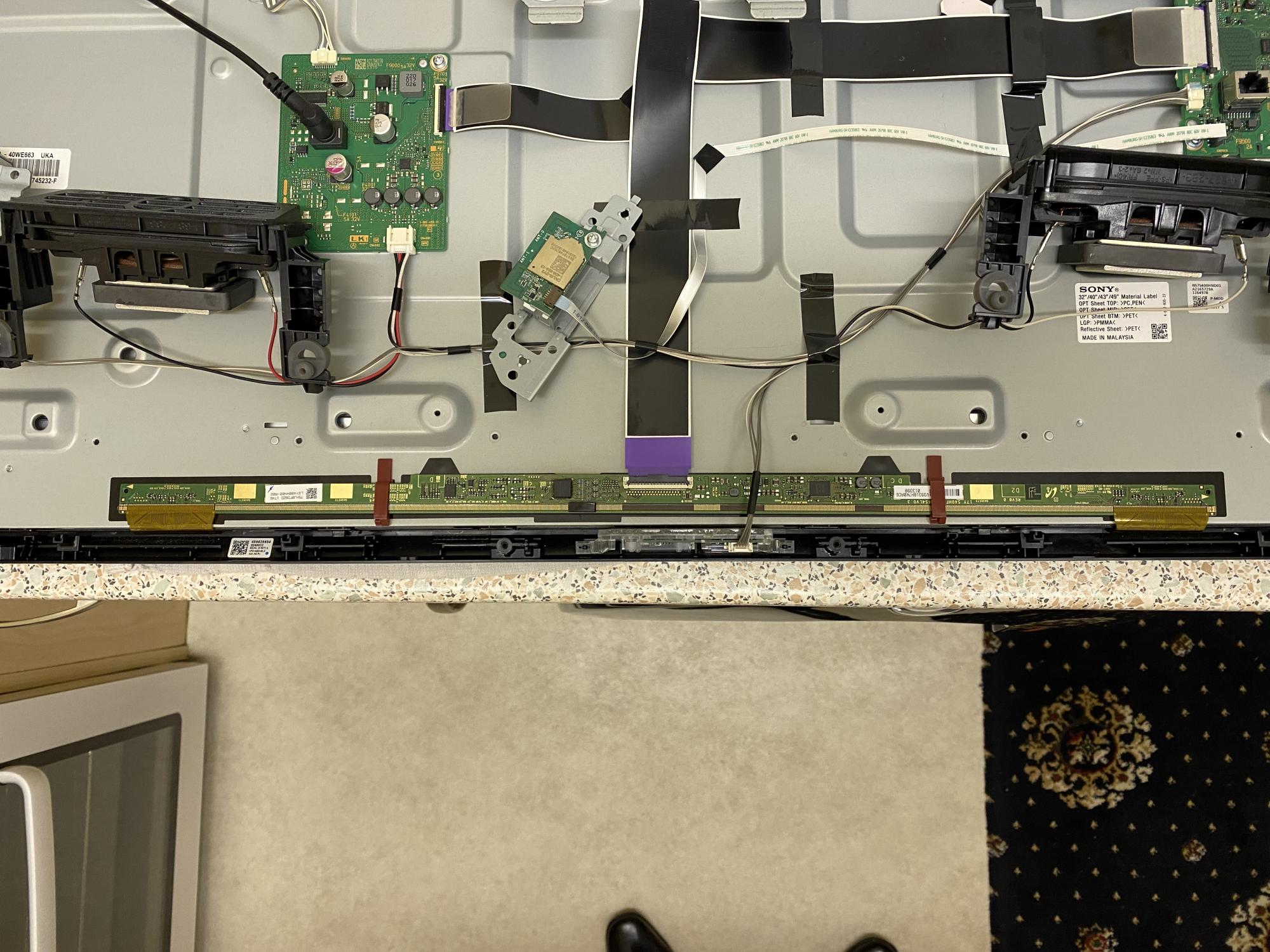

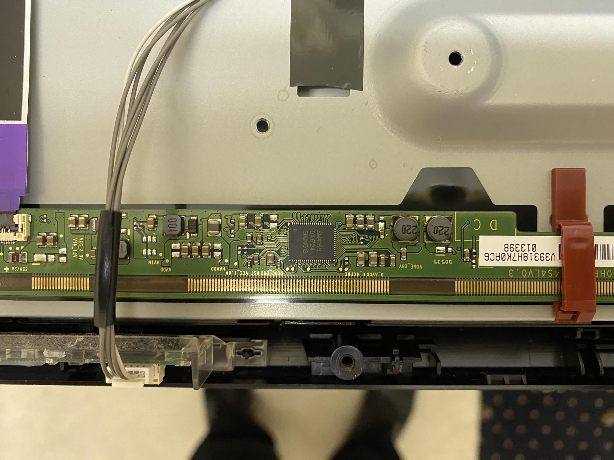

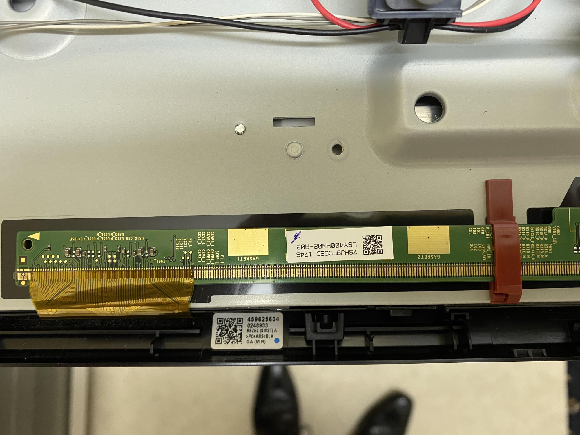

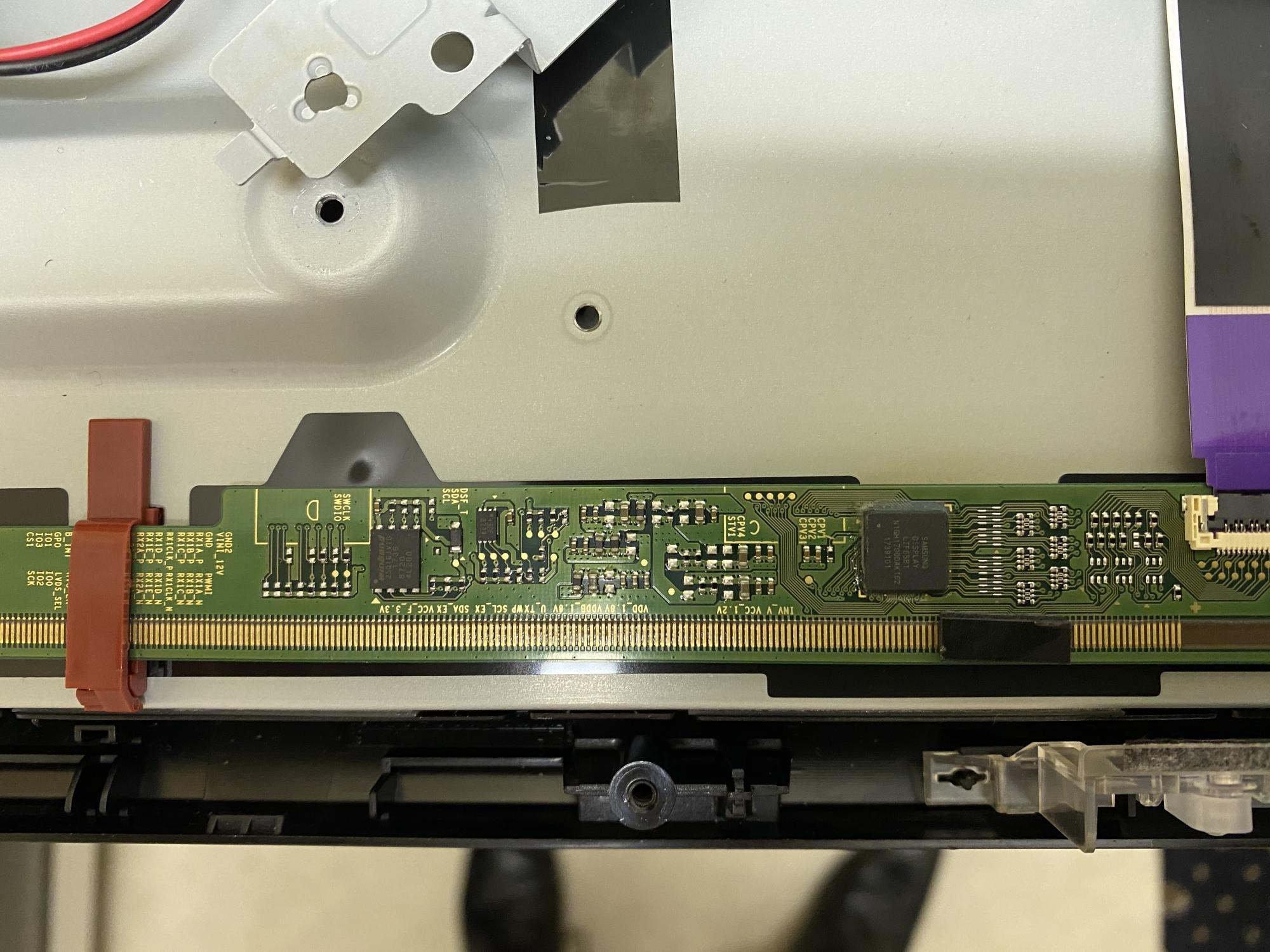

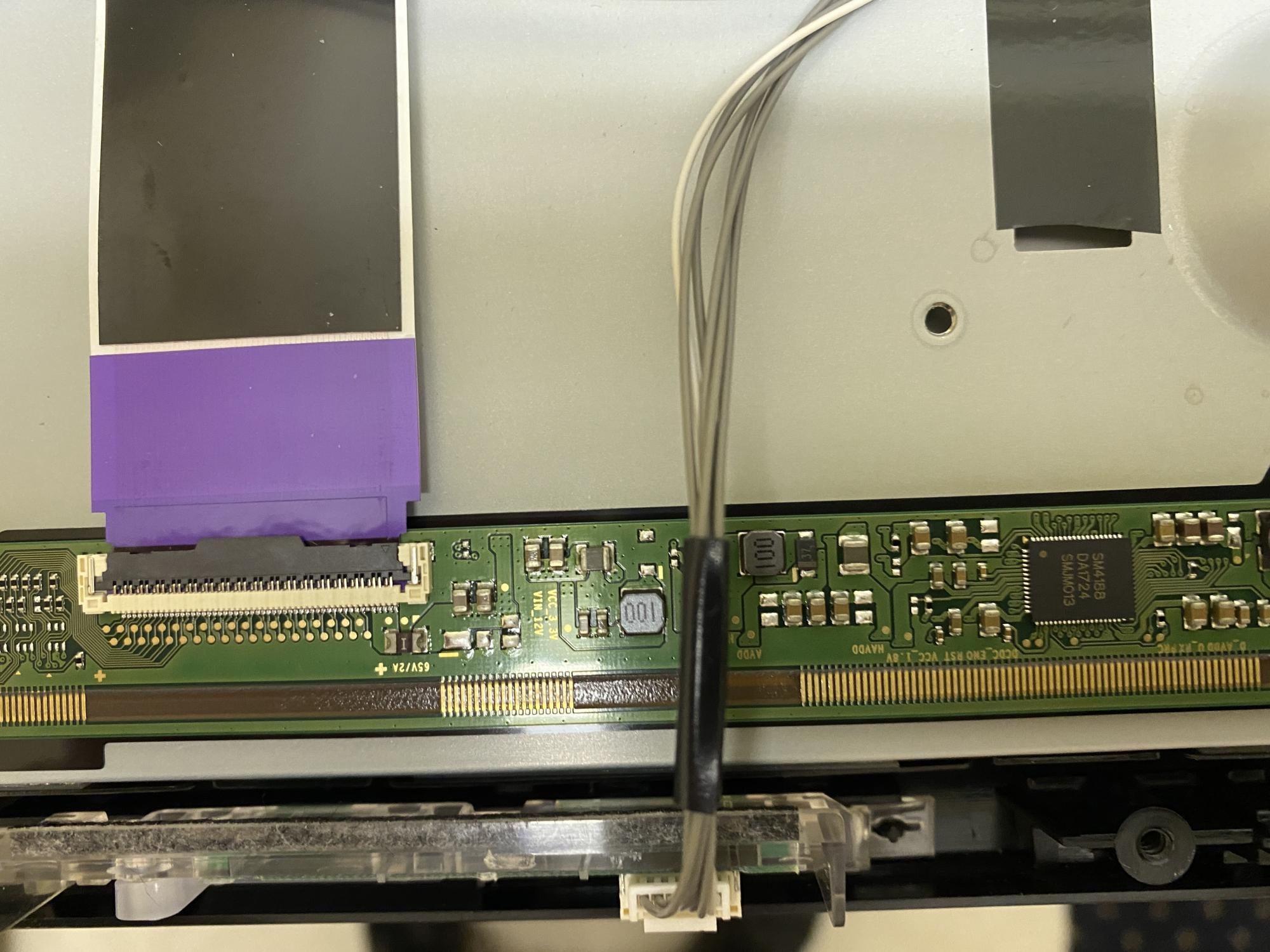

                          pics of lvds / tcon

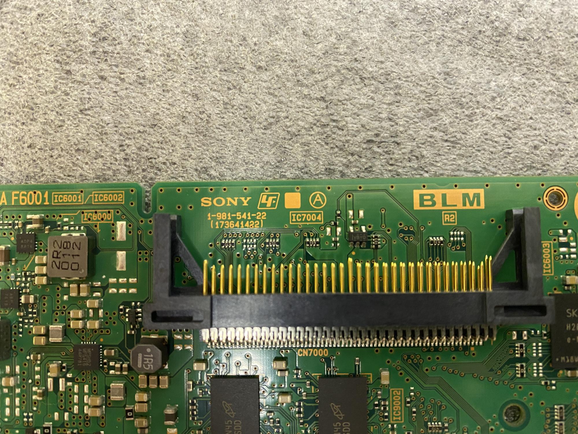

                              Re: Sony KDL-40WE663 Screen problem

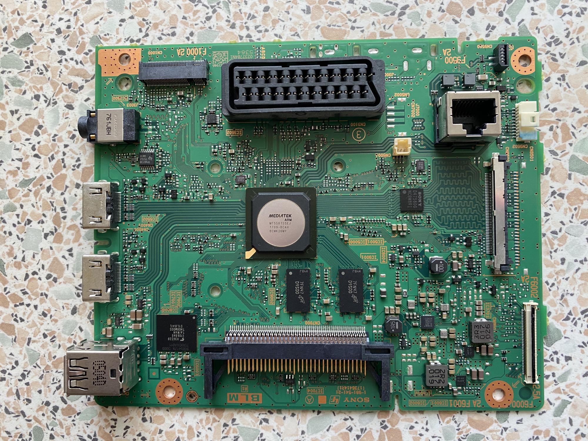

                              Think I may have found a possible cause
                              Picture is of the original dead mainboard looking at the numbers on this board the last two numbers on the replacement boards are different
                              So I have 22 original and 21 and 24 on the replacements
                              I ordered boards by Model number of the tv
                              Do you guys think this is the problem ??
                              If it is schoolboy error by me

                                Not a possible but exact causes. here we have LVDS depth don't match.
                                please don't hurry... because the different time between me and this forum ,,, upload focused picture on replacement and original MB, and explain with easy long detail what was the fault with original MB. so we could find the best and easy way to solve it.

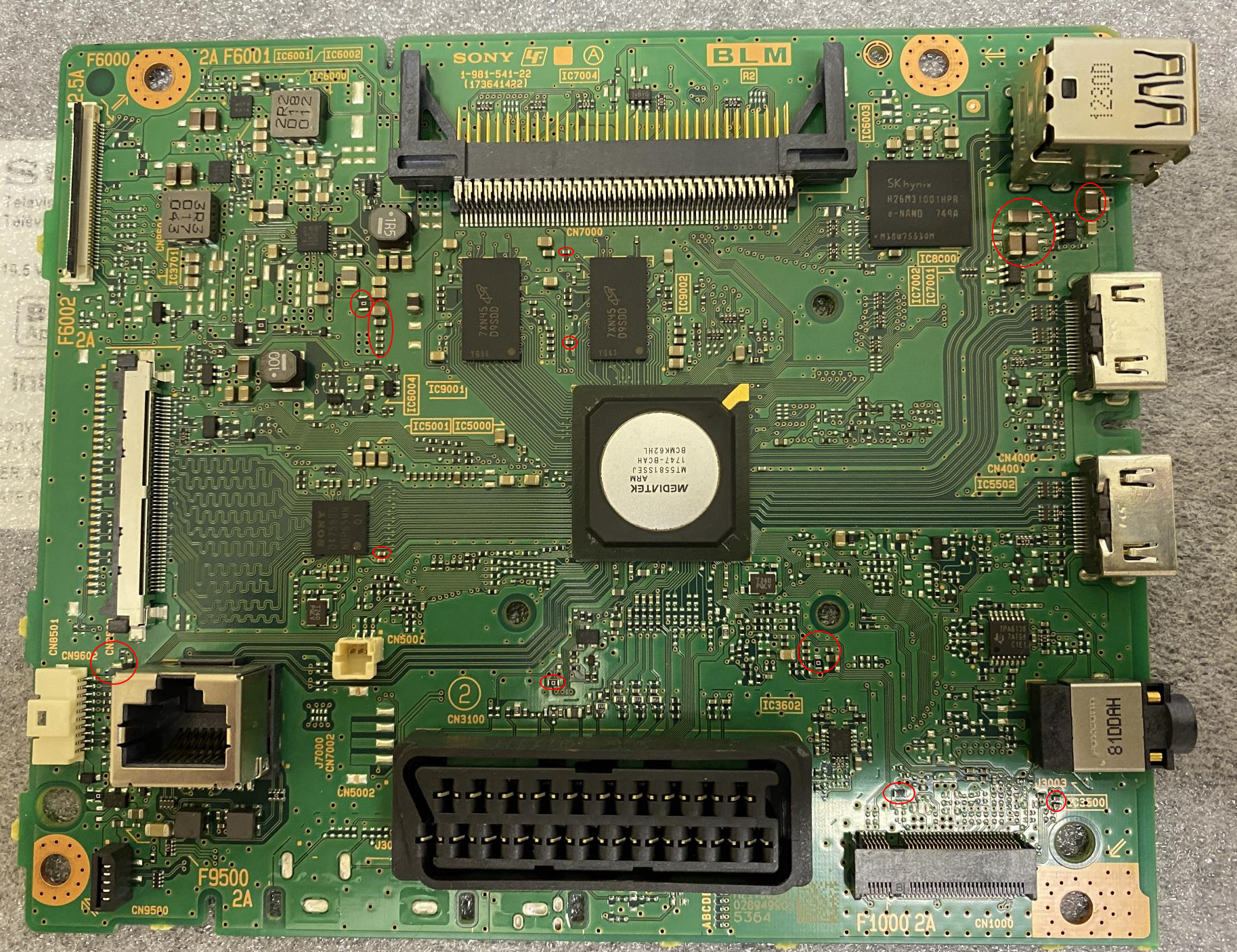

                                  Hi thanks for that here are the two pictures of the mainboards the original mainboard and the replacement mainboard, the replacement mainboard is the one with the heatsink fitted that I put on.
                                  Fault with original board was a completely dead set, no front panel led, no response from remote or on off switch
                                  • Biruslapio
                                    • Nov 2013
                                    • 552
                                    • Brasil
                                    I don't know about this TV, but this is what I could find comparing the two images. It's mostly some capacitors missing on your new board, but there are some 0 OHM resistors and inductors positioning that may enable or disable some circuit.

                                      good work Biruslapio.. not only what you marked.. but the most important was the NAND, ORG. was from south Korean hynix the other TAIWANESE
                                      this tell us allot.. since we don't know the source of the replacement boards
                                      you need to start with detective work. log in the service menu to see this boards belong to which series model / size
                                      don't change any value just shoot photos always to hold the values on hand

                                        Entered into Sony Service menu, board is showing correct tv model KDL-40WE663
                                        Many many settings to look at and possibly change, but I would not know which ones I may need to change or what to change a setting to
