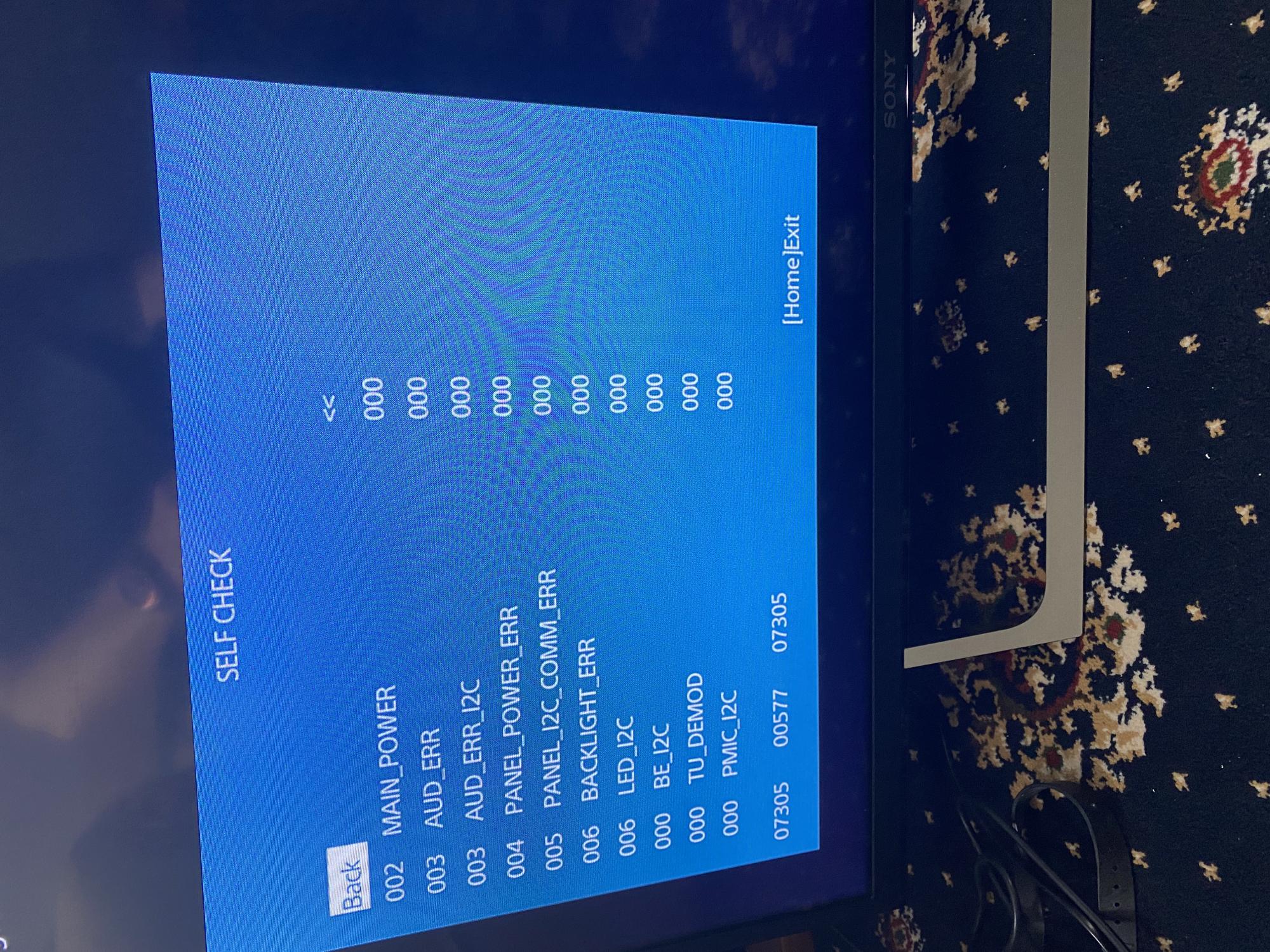

          it may listed reset option at service menu under different name such as "factory default".. also you have option of self check. this will diagnose whole hard ware and if there are error for example at T-CON will be listed too. self check are very useful option at SONY.

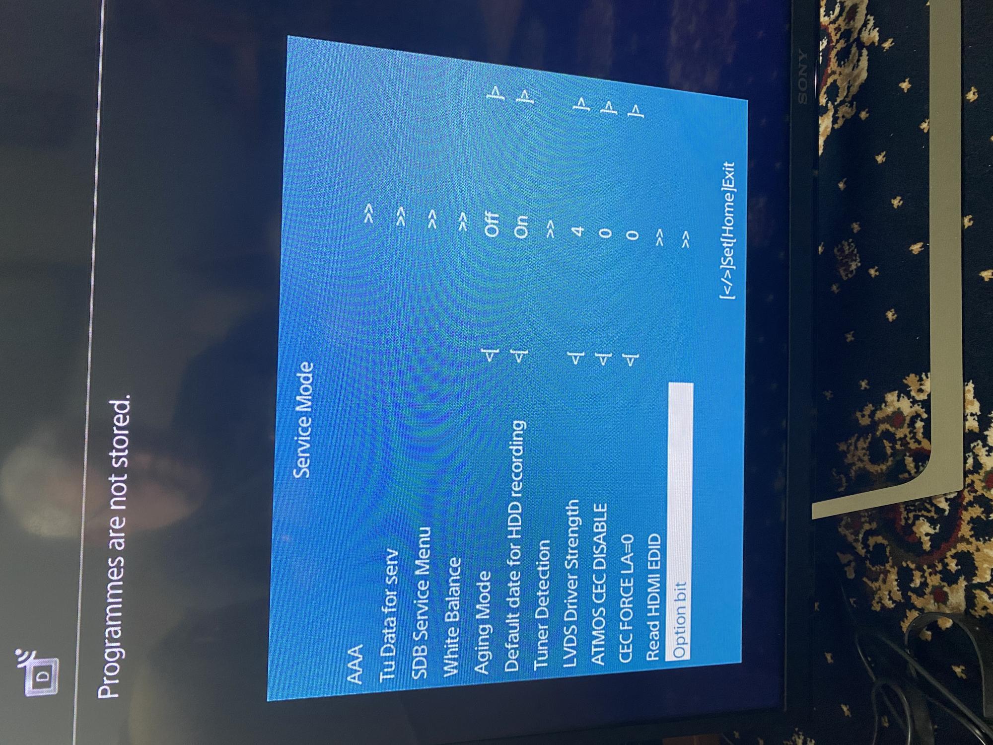

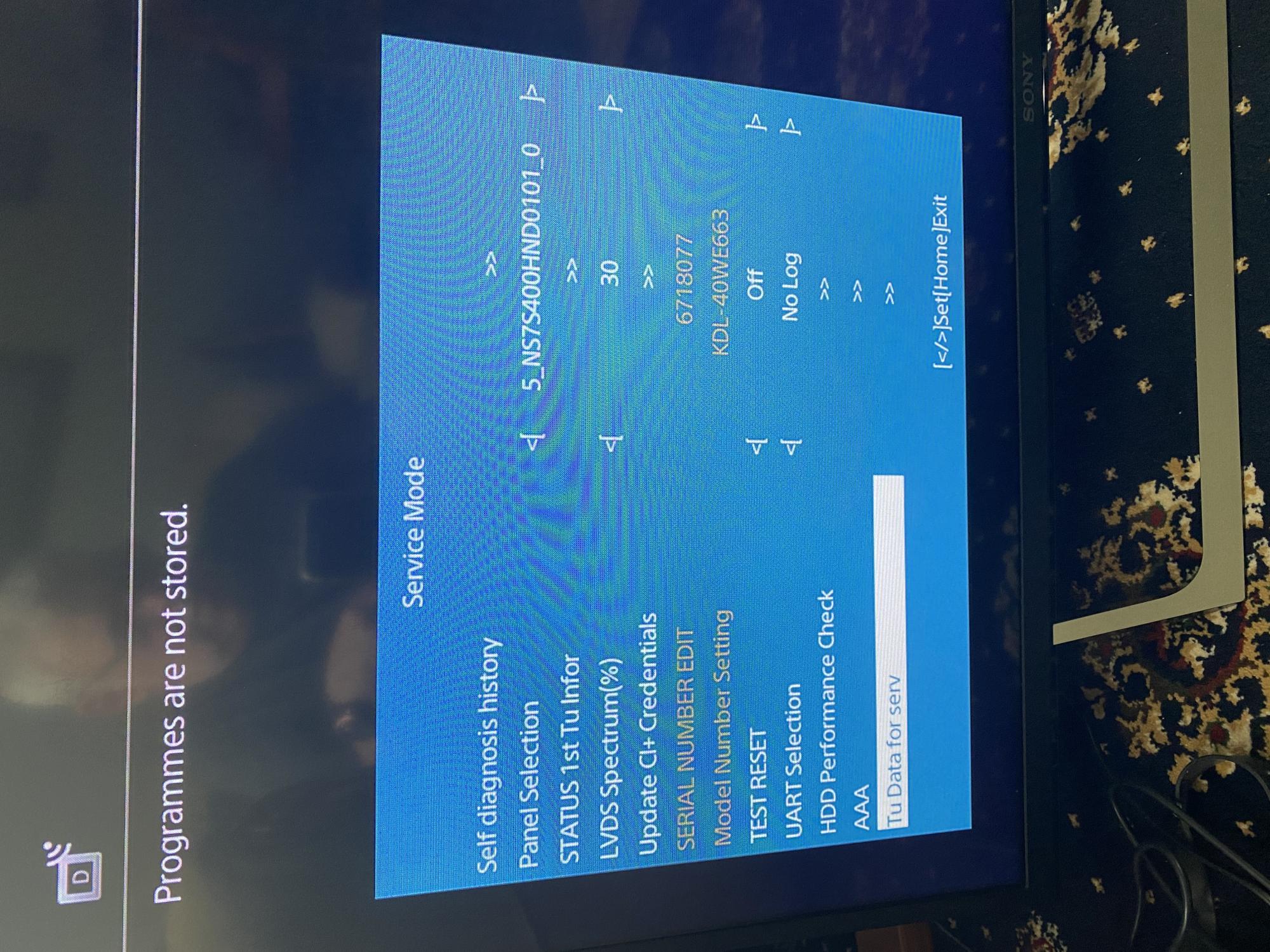

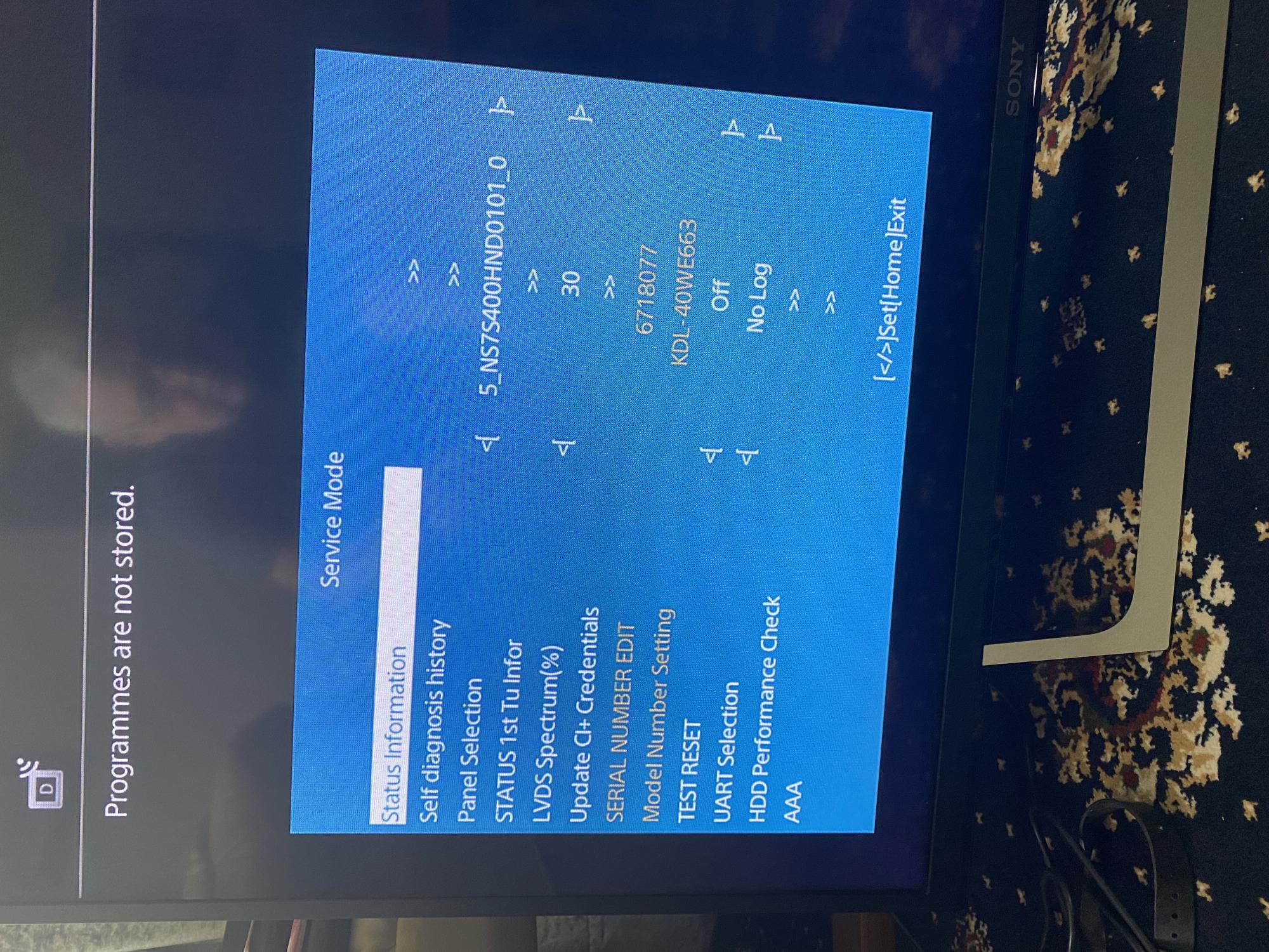

            Here are the pics of the service menu, one thing I had a quick look at was the panel selection, it lists about 12 different panels, maybe that may need changing if this board is for a different panel as to what is fitted in this tv

                take looks on yours TV chassis there should be barcode or label show the panel No.
                in case you couldn't find label. you can pattern the listed Option at Panel Selection. Choice one and test..
