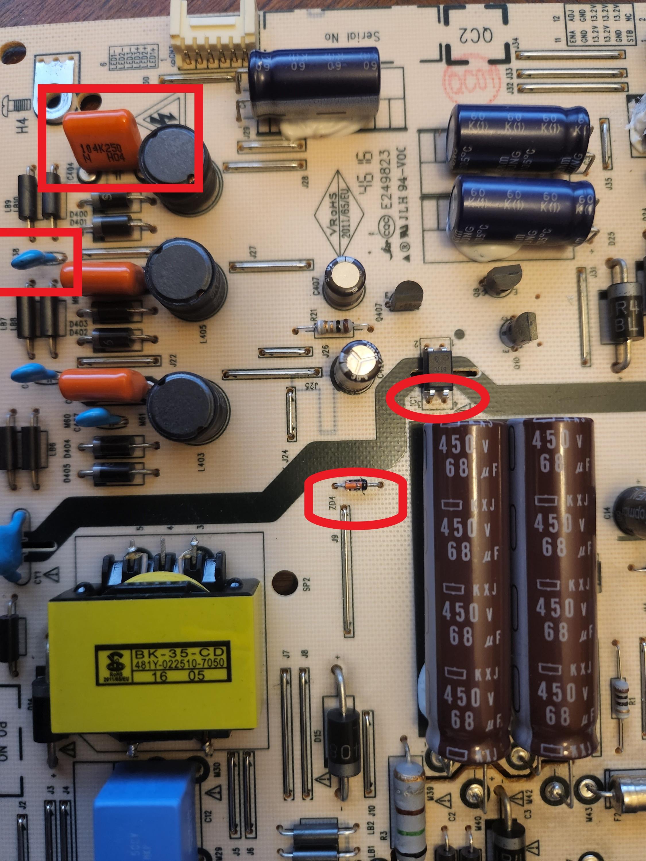

    Originally posted by R_J
    What voltage do you have across C5? is it also fluctuating in standby mode?
    What is the main filter (C2/C3) voltage? does the pfc turn off in standby and back on when powered on?
    Yes C5 fluctuates between 14 and 20V
    C2/C3 have some ripple 392 to 406v, but PFC is on. I dont think it turns off on the model

      Re: LG 50UH5530 Turns Off And Wont Turn On: diagnoses included
      ok, forgot you had one working, that makes it easier, check each pin on those ic's in question with the good board, take note, then check them with original board, also check the transistors on the heatsinks and the diodes and resistors, check your voltages on the transformers too.
          maybe check Q8, Q10, Q407, compare to good board.

                • jason123
                  • Oct 2015
                  • 1083
                  Q5. Q404. Q405. F3.
                  These check out.
                  The only big difference I see between the boards is the orange Capacitor section (LED Drive Circuit) - C403, C404, C405
                  Good board reads 0.6 MOhm across these orange caps
                  Problematic board, reads 4.1 MOhm across these caps
                  Opto (and zener dioded - circled) Hot Side:
                  Good board 23.9 k
                  Bad board 2.4k
                    "Opto (and zener dioded - circled) Hot Side:
                    Good board 23.9 k
                    Bad board 2.4k" That looks like a pretty big difference.

                      #30
                      I might be tempted to change all 5 if I had them on hand.
                        Good board 23.9 k
                        Yes.. factor of 10
                        Though I find it odd that there seems to be 2 failures.. one on the hot side (somewhat isolated?) and one on the cold side
                            do you have about 1 ohm across the opto?
                              cold side about 1k on both boards
                              hot side 23k on good board, and 2.3k on the bad board
                                what are you getting on that zener in diode mode?
                                  0.7 VF... tests as good. Out of circuit (when diode removed) hot side of opto now measures 23k (same as good board)
                                    hmm, seems ok, wonder if it's those caps to blame?
                                      So transfered the good zener from good board to bad. Now bad board reads 23k across hot opto side. TV powered up for 3 seconds then off. Something else is a problem.
                                      Disconnected LED Connector (to exclude these caps) and no change. I don't think these caps are to blame. Took them off voard, and did ESR and C measurements. No significant difference
                                        ok, yeah the ceramics are usually pretty reliable, wonder if it's the opto?
