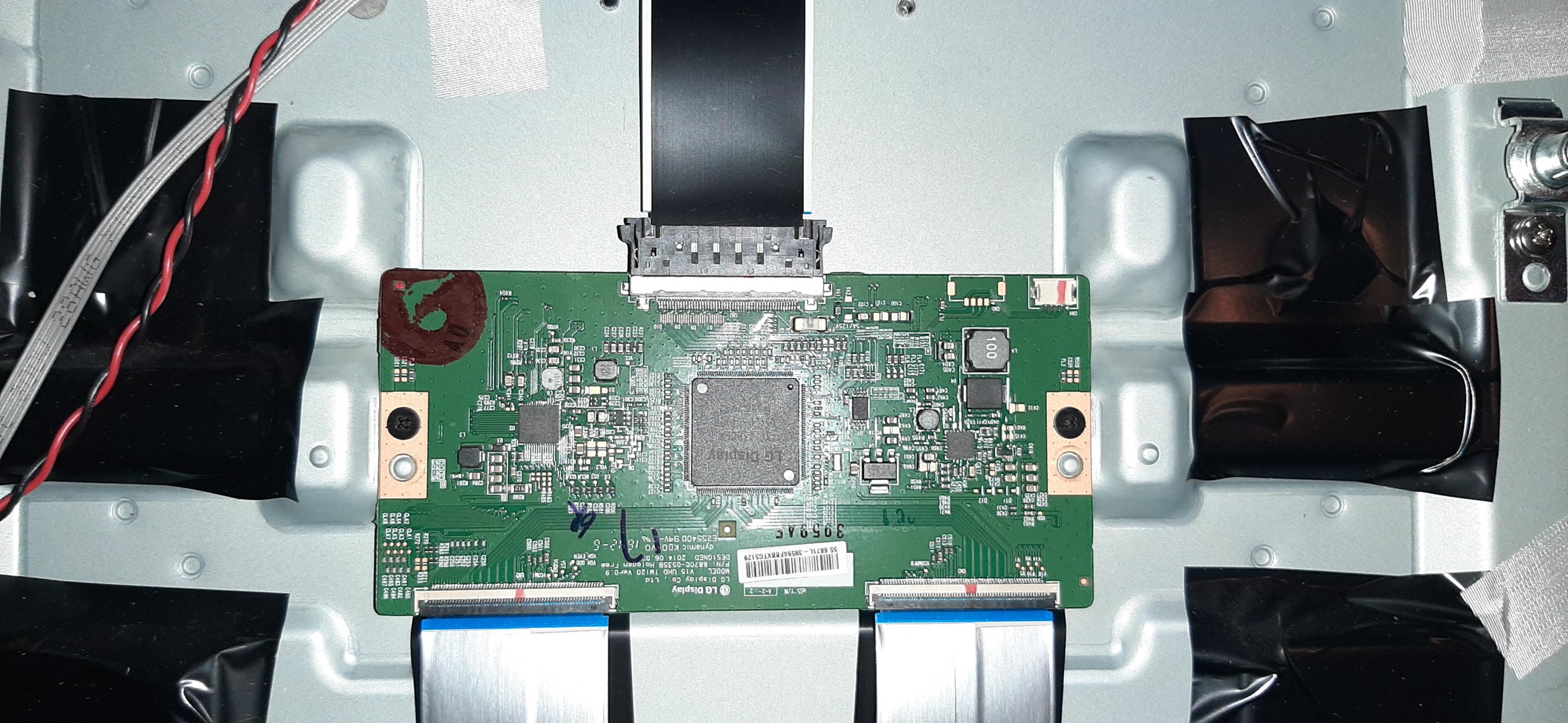

    I replaced the T-con board to no awail and now I have started measuring voltages, but electronics on this level is above my knowledge.

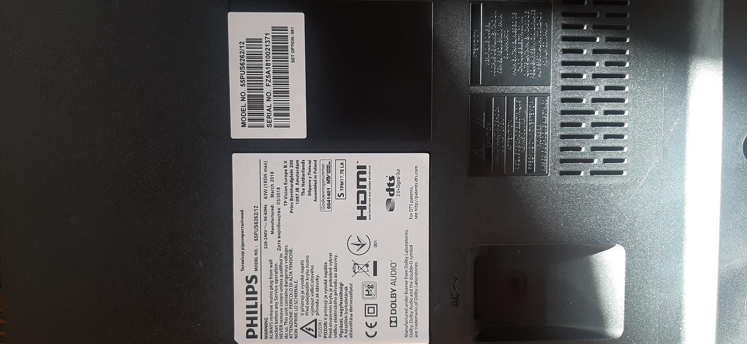

        Re: Philips 55PUS6262/12 always ON but no picture
        Originally posted by trunks81
        What is the chasis number of this type ?
        Hm I have a serial number if that helps?
            there is an bigger sticker on the tv with also the type and chasis number so i can look up the service manual for u

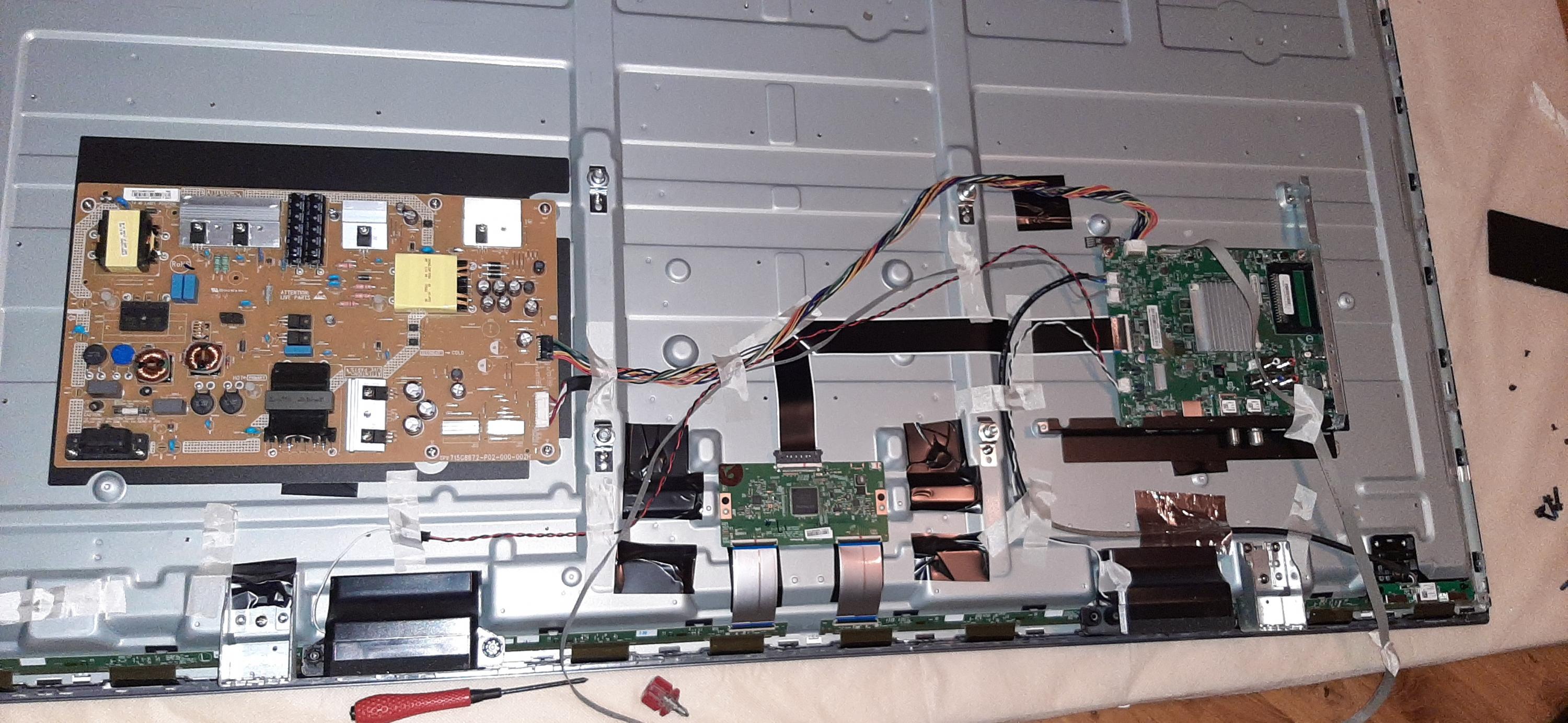

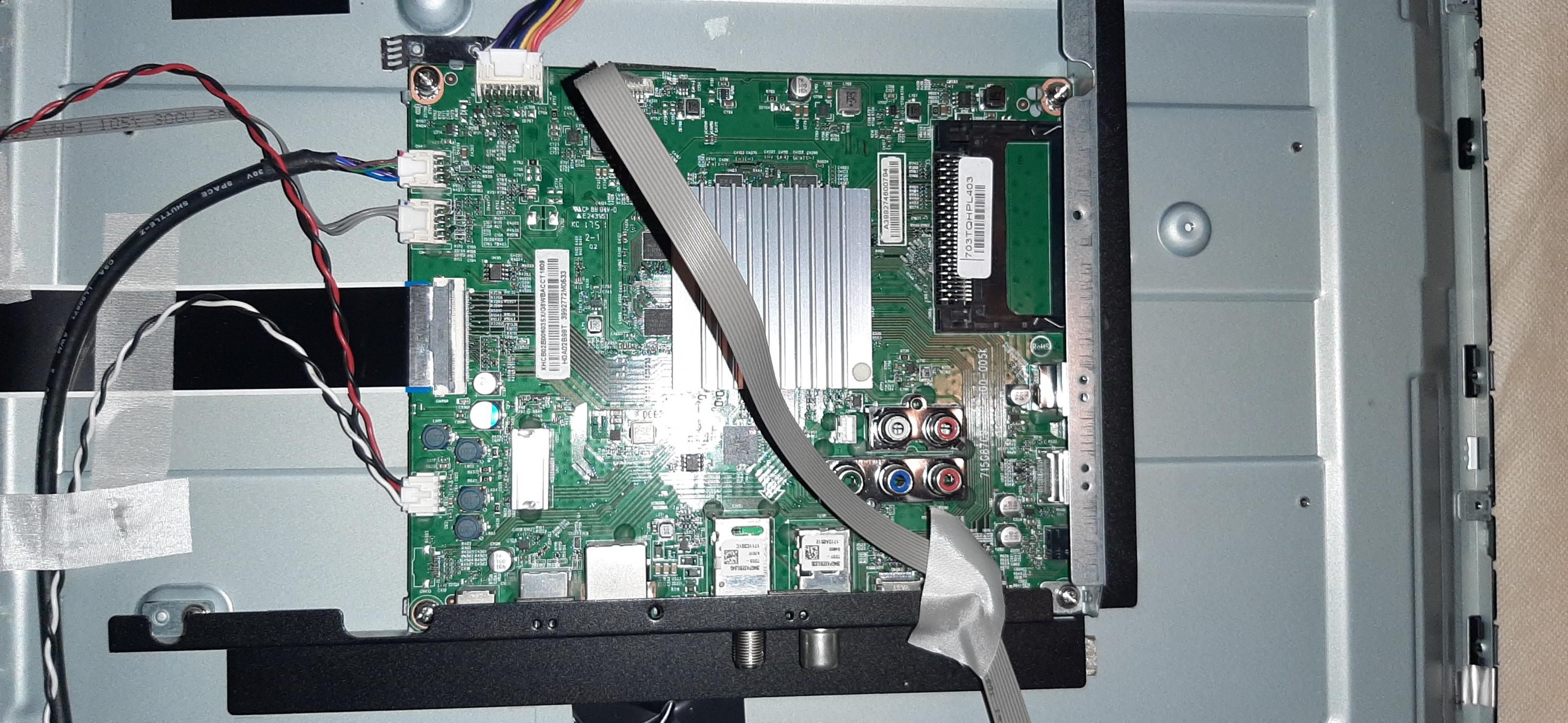

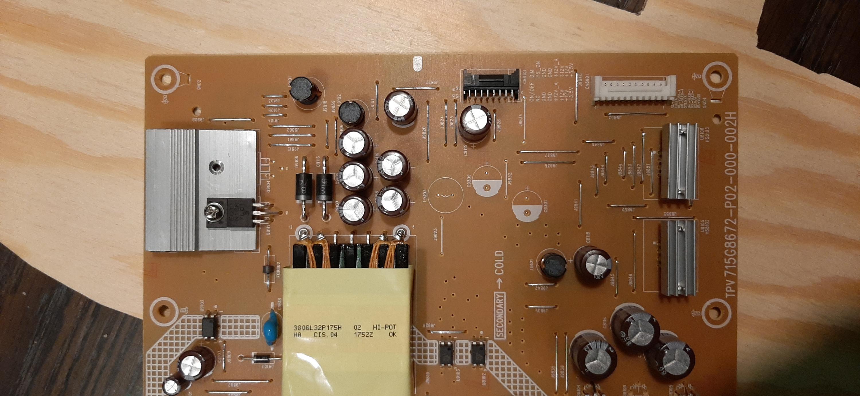

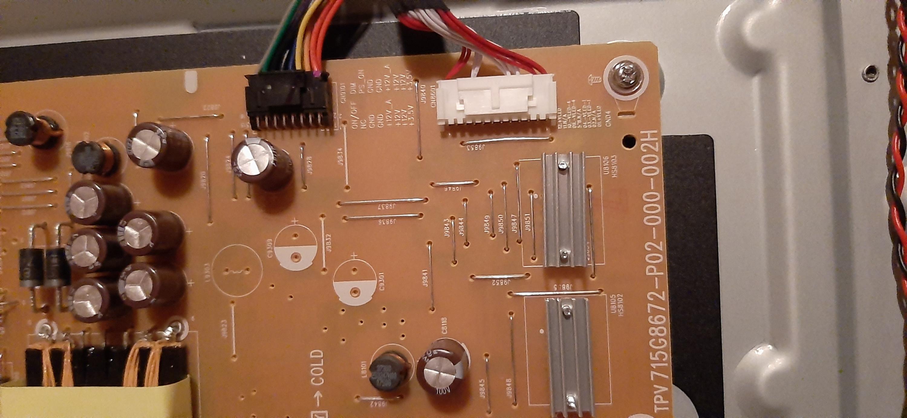

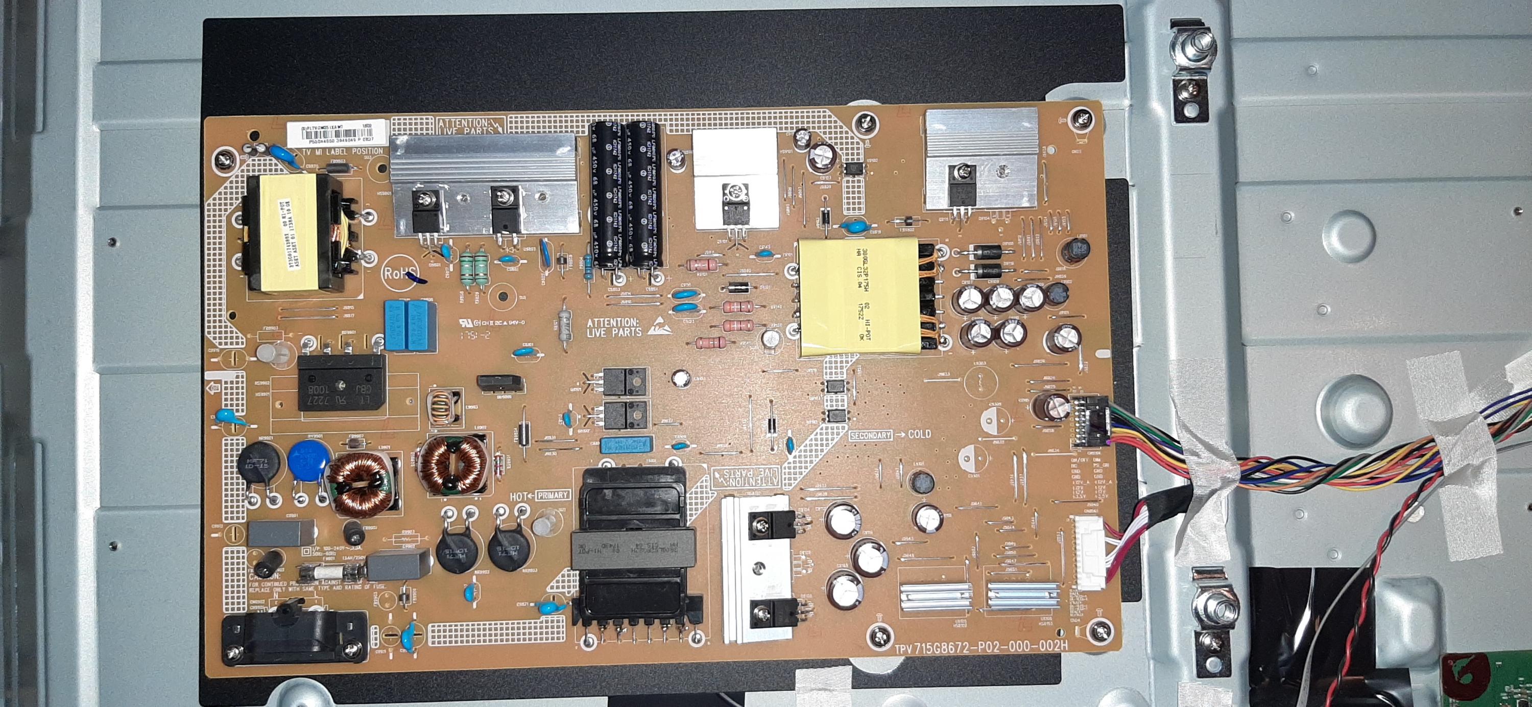

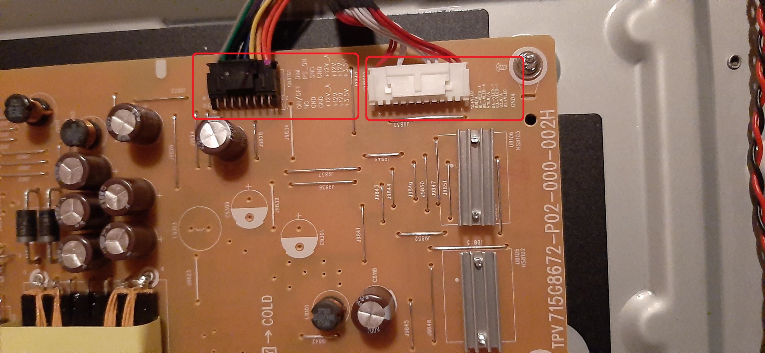

              Right, I've finally been able to measure a bit more and taken some pictures as well.
              I've focused on the black connector on the PS board which goes directly to the main board.
              The results are like this:
              Left row:
              On/Off: 3,25V
              NC: 2,95V
              GND: has contact with chassis
              +12V_A: 12,0V
              +12V: 12,0V
              +12V: 12,0V
              +3,5V: 0V
              Right row:
              DIM: 2,4V
              PS_ON: 3,0V
              +12V_A: 12,0V
              +12V: 12,0V
              +12V: 12,0V
              +3,5V: 0V

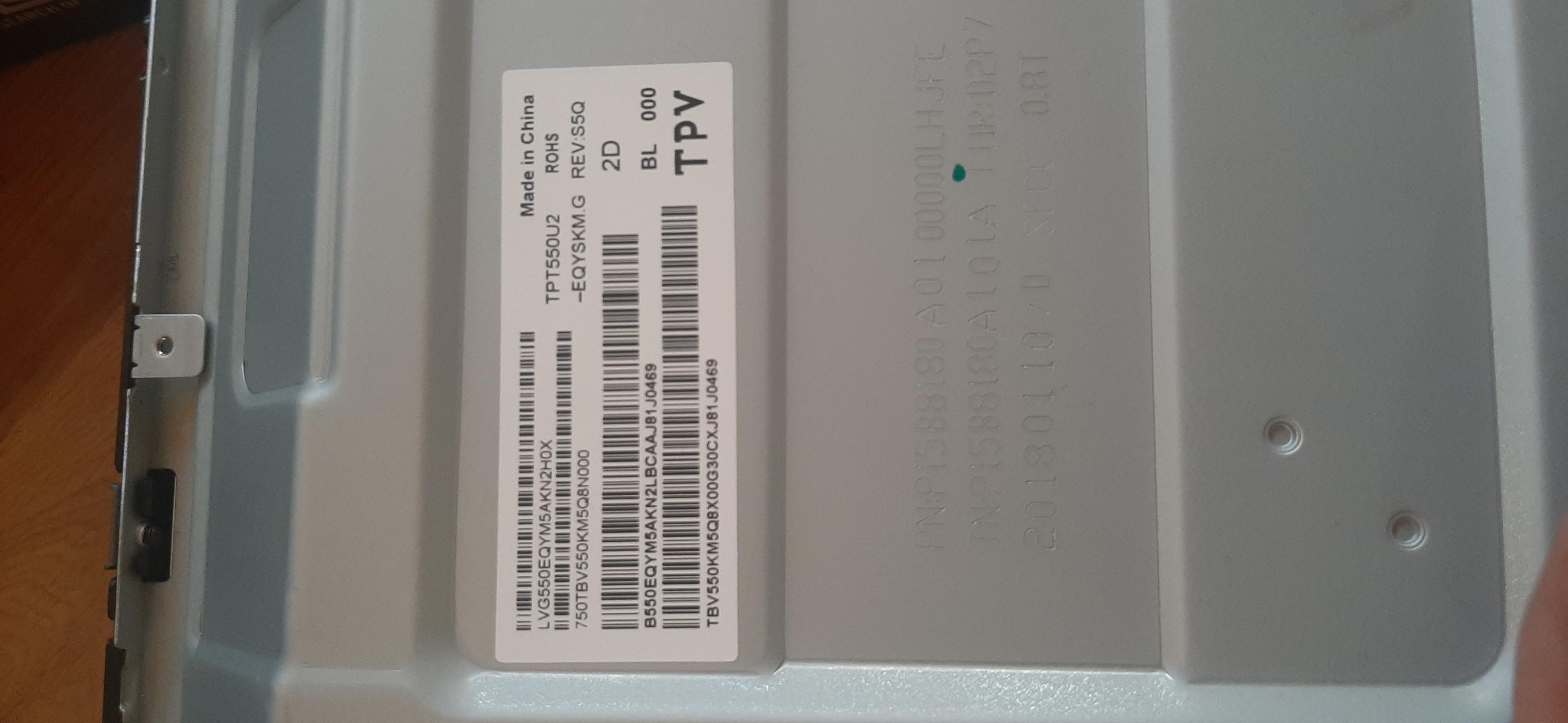

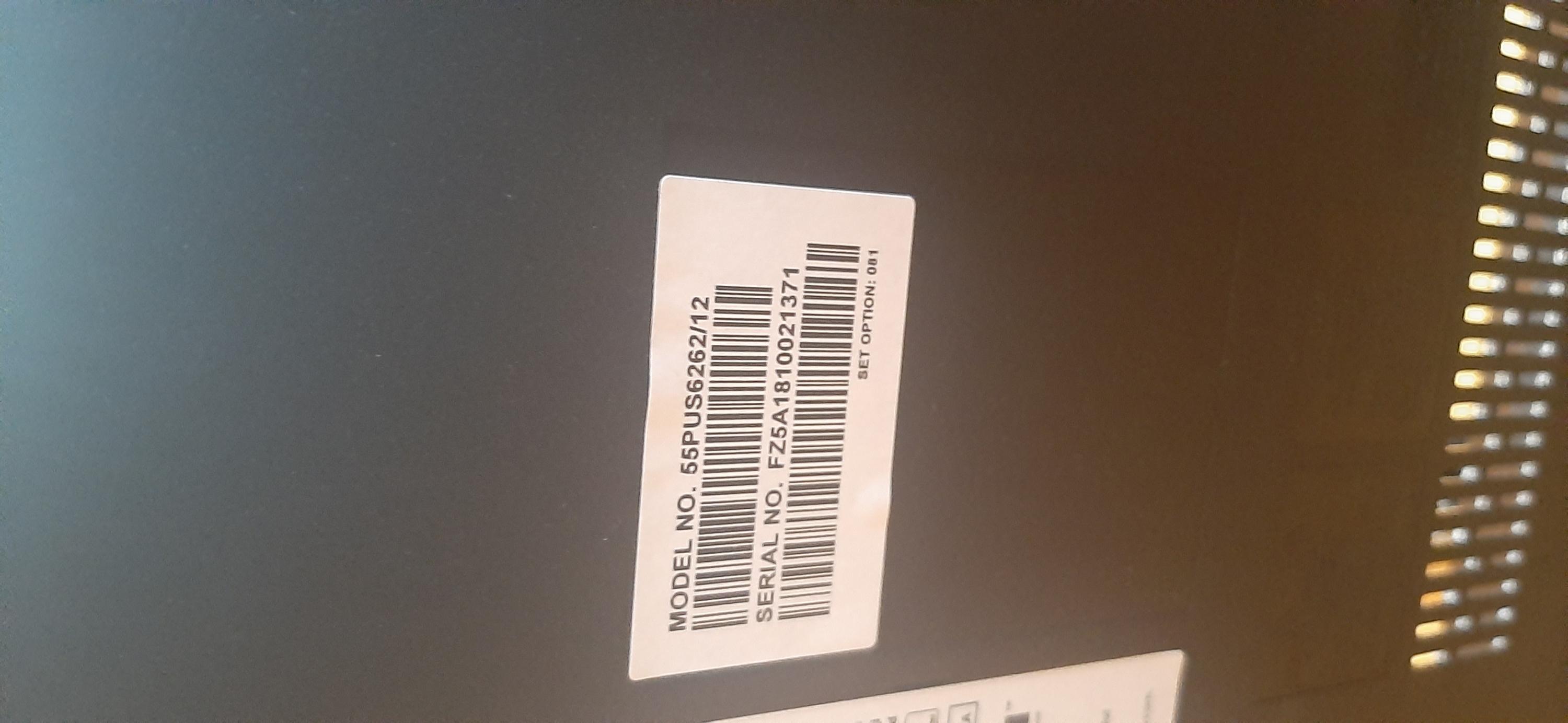

                These are the ones I've found, hope it helps
                • trunks81
                  • May 2020
                  • 265
                  • Nederland
                  its a TPM17.7E LA

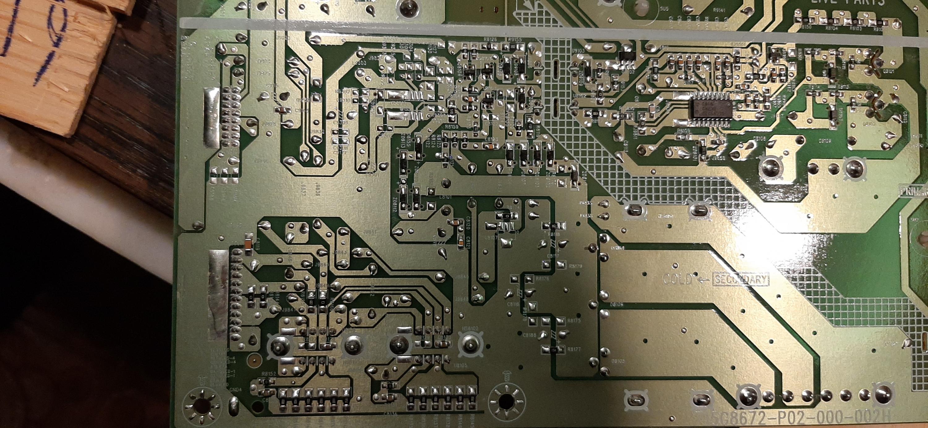

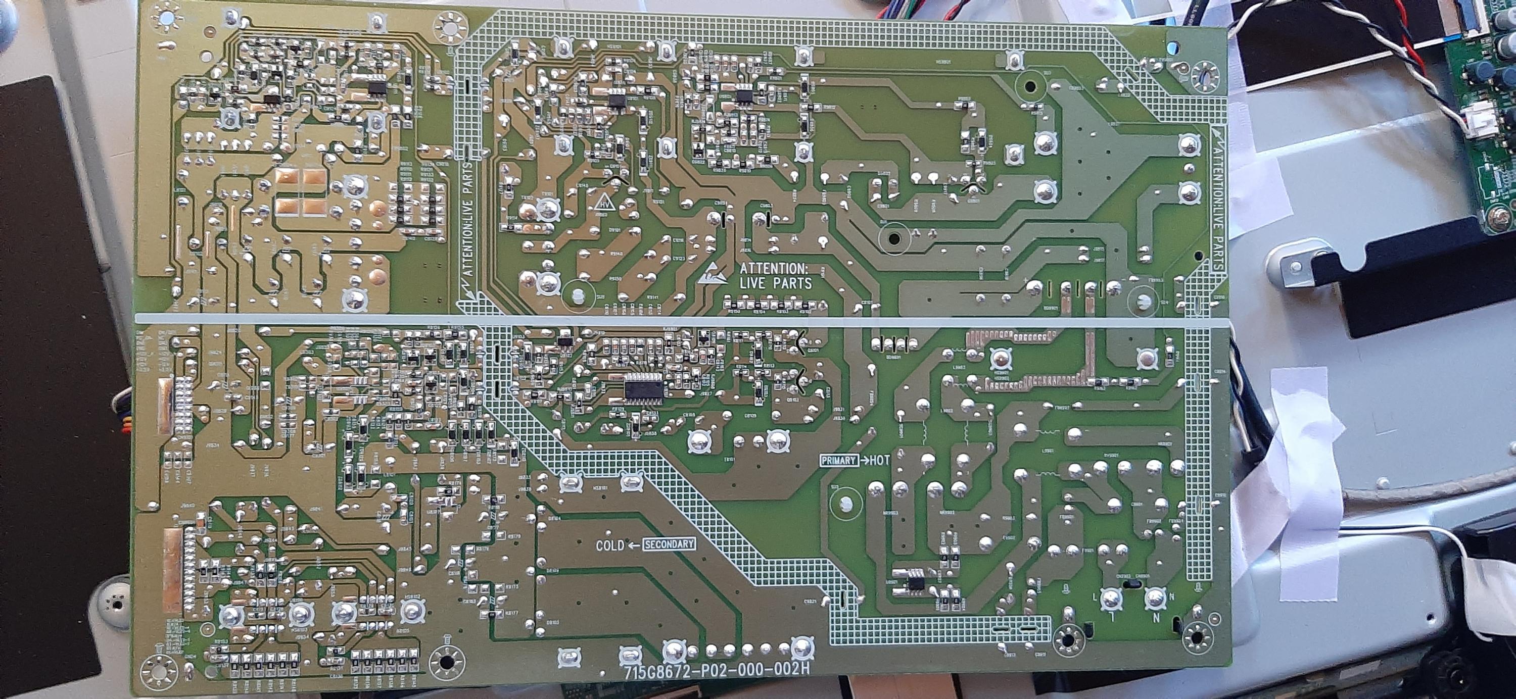

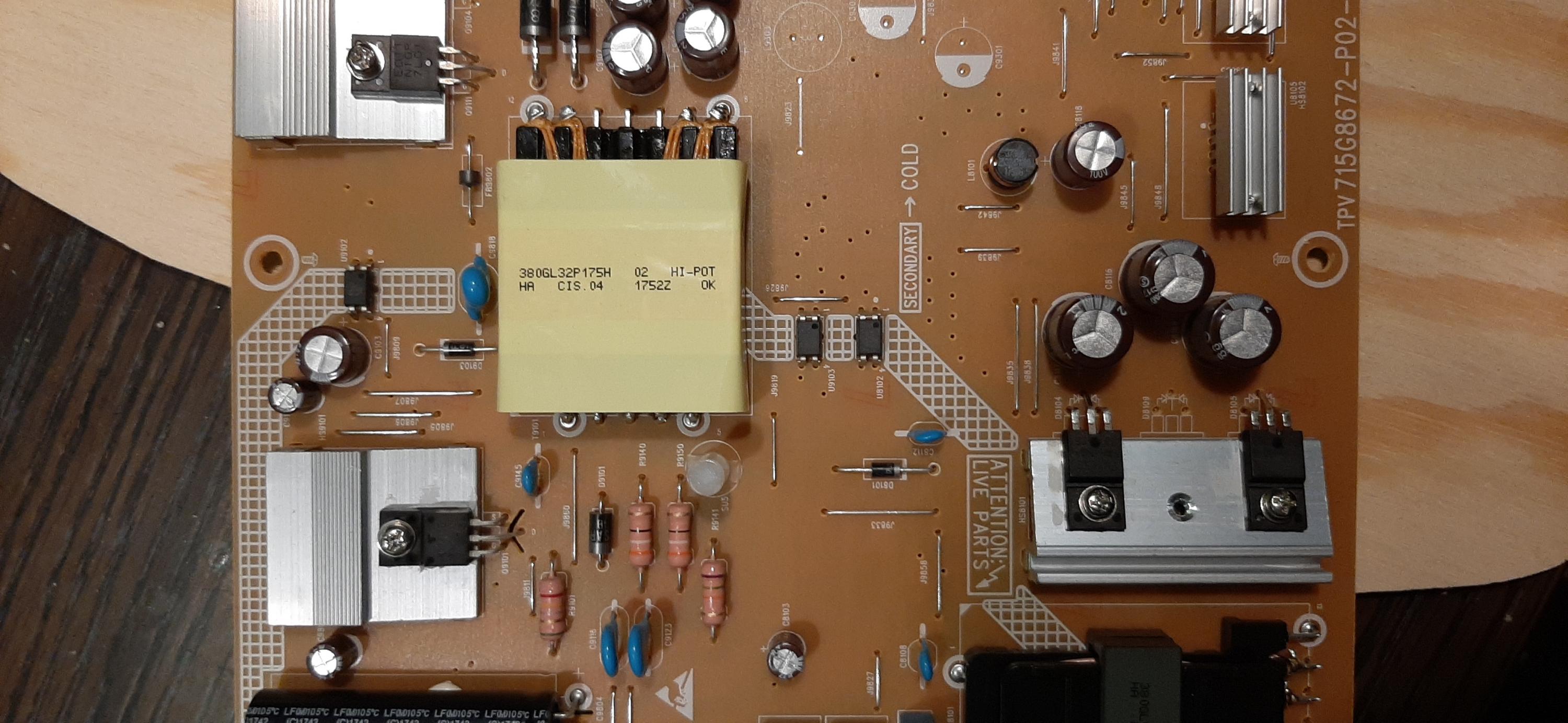

                    Can you post a photo of the underside of the power supply. Basically the reverse of the picture in your first post. Just want to check that the 3.5V is actually wired up on this board.
                    • tandkramstub
                      • Aug 2020
                      • 11
                      • Sweden
                      No problem, here's a picture of the whole PS and a close-up of the back of the terminal, the 3,5V is on the two pins just above the text "CN9101".

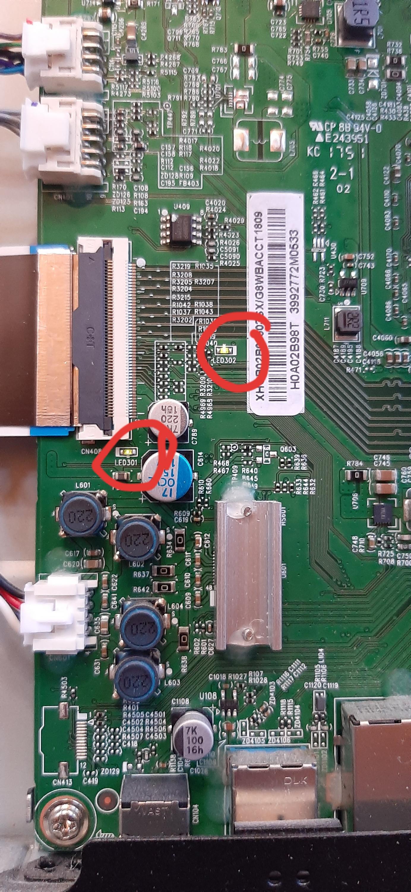

                        I don't know if it helps, but when the TV is on, two green LED's on the main board comes on and stays on the whole time. I don't know if they should, if they should blink or if there should be more of them.

                        • dick_barton
                          • Aug 2015
                          • 6643
                          • Wales

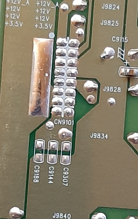

                          The 3.5V is connected to jumper J9834 but I cannot see where it goes from there since the picture is not large enough. It does look as though it may not be connected since there appears to be many components not mounted on the board very close by to it.
                          Can you trace where J9834 goes?
                          • tandkramstub
                            • Aug 2020
                            • 11
                            • Sweden

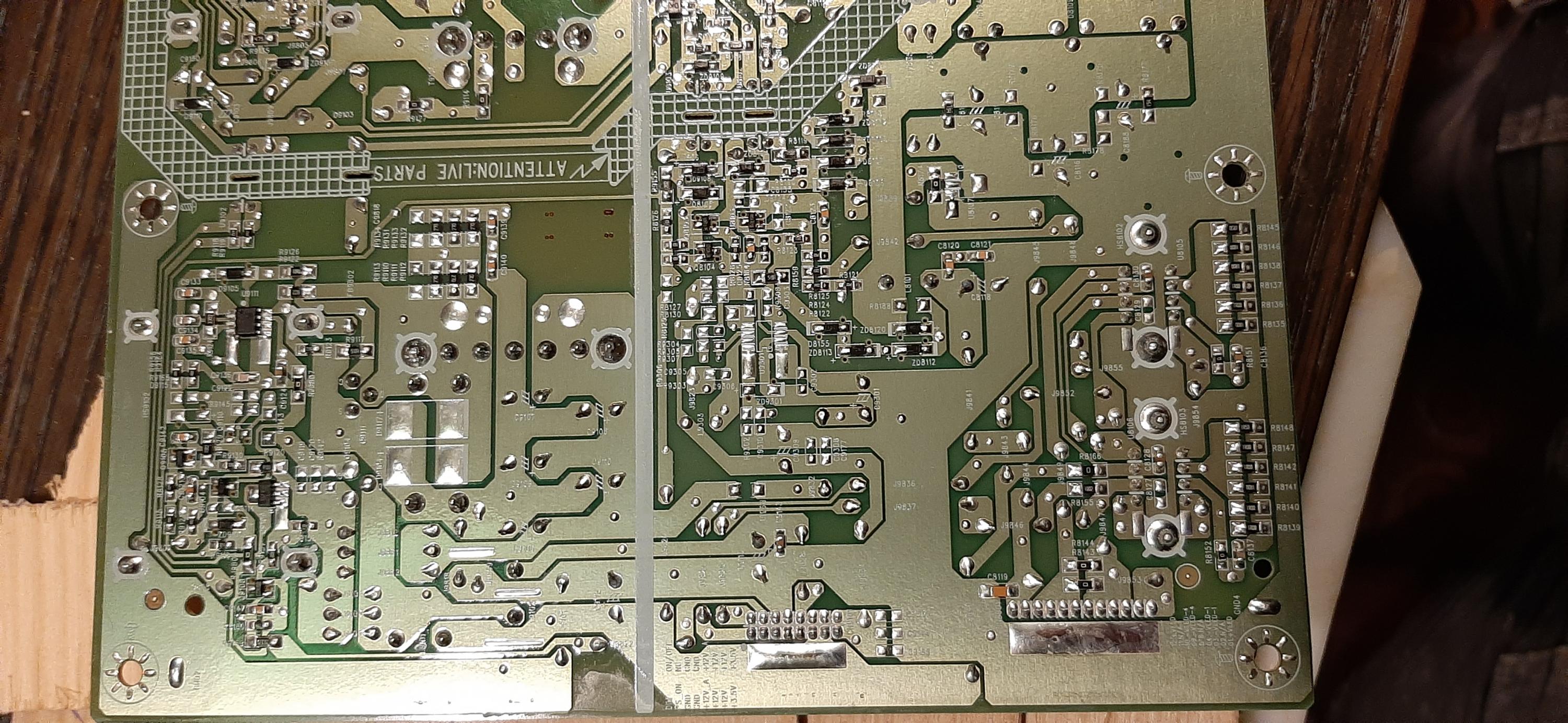

                            I've tried to take some better pictures now...
                            • dick_barton
                              • Aug 2015
                              • 6643
                              • Wales
                              It looks as though the 3.5v is not connected on this board.
                              • R_J
                                • Jun 2012
                                • 9623
                                The 3.5v is supplied via L9303 (which is not populated) I suspect U9301 is also missing (12v to 3.5v reg.)
                                    It is looking like a problem on the mainboard. If you disconnect the wifi module will it power up as normal?
