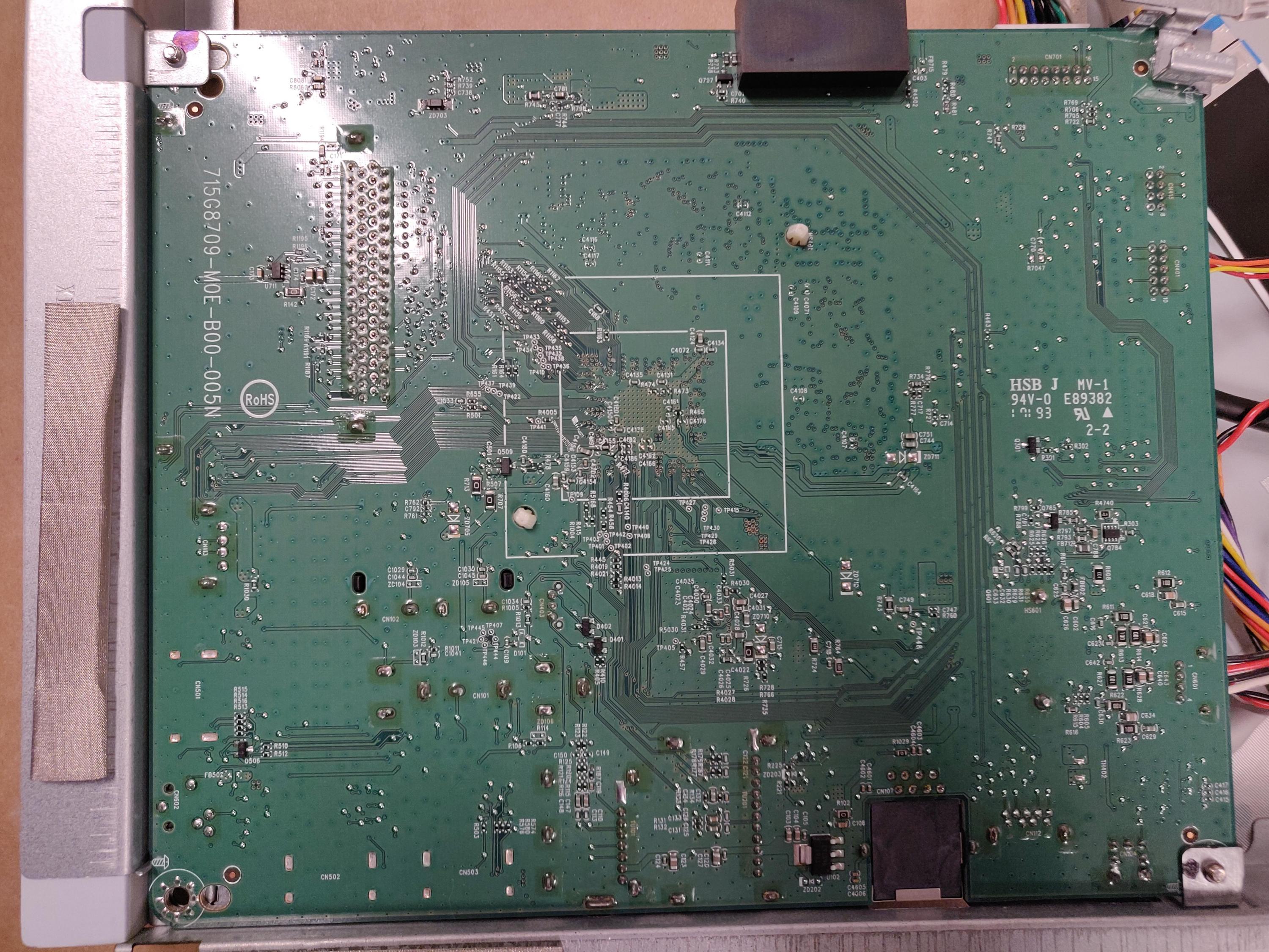

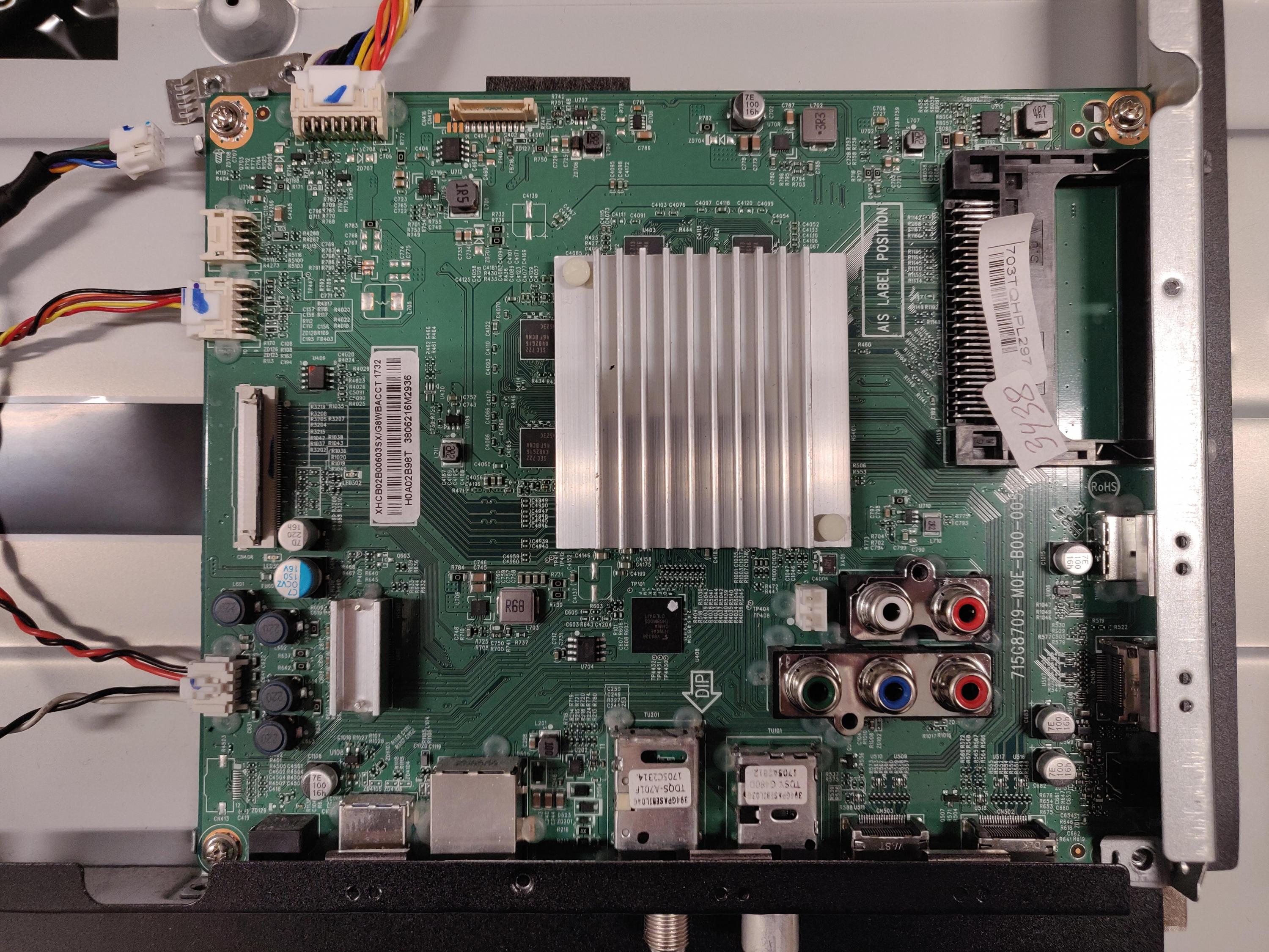

      Reviving this thread to hopefully get some insight on the same problem. I have the exact same TV and behavior.
      Things I have checked:
      -The power supply board, all the rails seem to be OK. Except for the missing 3.5V rail that's apparently just not connected on this board.
      -The T-Con board fuse is not blown.
      -I checked the voltages on the main board according to the service manual attached to trunks81's post, section 6.3.2.
      -C789 +12V PANEL
      -L701 +1.5V DDR
      -L704 +3.3V SB
      -L702 +5V_STB
      -L803 +5V
      -C105 TUNER_3.3V
      -R221 TUNER_LNB
      -R726 +1.8V EMMC
      Those are all OK.
      -The heatsink on the mainboard gets warm, so something is happening under it.
      So, the TV seems to be completely braindead. Turns on by itself and turns on the backlight when plugged in, remote and buttons do nothing, Windows does not detect the TV at all, can't even turn the TV off.
      I'd of course like to repair this faulty board and learn something in the process, but I also found it on eBay for 60 euros, so buying that wouldn't be too bad.
      I took a couple hopefully good pictures of the mainboard, in case someone gets something out of them.
      I'm assuming the panel is OK, because there are no lines or anything seemingly wrong with it, but any ideas whether I could somehow confirm this? Especially if I end up buying a new mainboard, it would kinda suck to realize that the panel was full of lines all along.
      Starting to wonder, could it be a flash/corrupted firmware problem?
      Is there something else I should check on the mainboard/somewhere else?
      Also, if I end up buying a new mainboard, how critical is it that it is the exact same model? I found two listings on eBay for 55PUS6262/12, but one had TPT550U2-D072.L as the panel and other TPT550U2-EQYSKM.G, the panel my TV has. They also specified a "Panel Code". What is this code, and would having a different panel code, although the same model, cause problems? Obviously I would buy the one with the same panel listed, but I couldn't find a panel code on my panel.
      The mainboard on eBay is a 715G8709-M0E-B00-005K. My mainboard is otherwise the exact same model and looks identical, but there is a N at the end of the part number instead of K.
      According to some Googling, both of these board are used in quite many slightly different models, so I'm assuming that if I bought the board that is listed for my exact TV, I should be good?

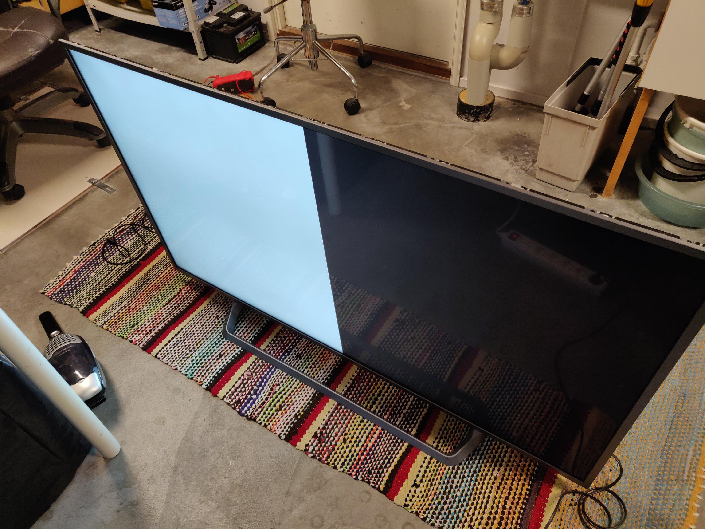

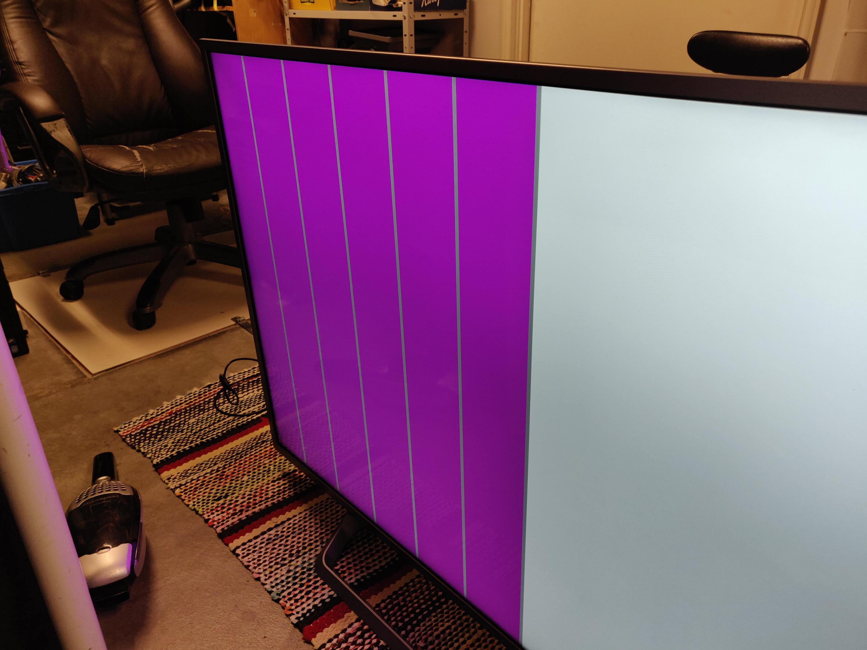

        Did some more testing. I wanted to know if something was wrong with the panel as well. I tried disconnecting the 2 ribbon cables going from the T-Con board to the panel one at a time.
        When I disconnected the ribbon that goes to the LEFT side of the panel, that side turned completely white, and the RIGHT side stayed black. Both sides stayed like that.
        When I disconnected the RIGHT side, that side turned white as well, but the LEFT side didn't stay black, but rather turned solid violet, with 6 vertical grey lines that are the same width and same distance from each other. After a while, the RIGHT side started fading to black/grey.
        Now, this looks kinda weird to me. Do the 2 ribbon cables not control each half of the panel independently? I was under that impression. But seeing as having only the left side connected causes something to happen on both sides, that does not seem to be the case. Also, the lines are perfectly systematic, that does not look like a problem where something randomly gave up to me.
        I also looked at the panel board. I checked the SMD capacitors for shorts and didn't find any.
        I really want to pull the trigger on a new main board, but I also wouldn't want to completely waste 60 euros if I obviously have a bad panel.
        Any advice?

          I don't think the colored parts of your panel has anything to do with the problem - it's quite normal for the LCD panels to turn funny colors when the drive signal is missing/weak.
