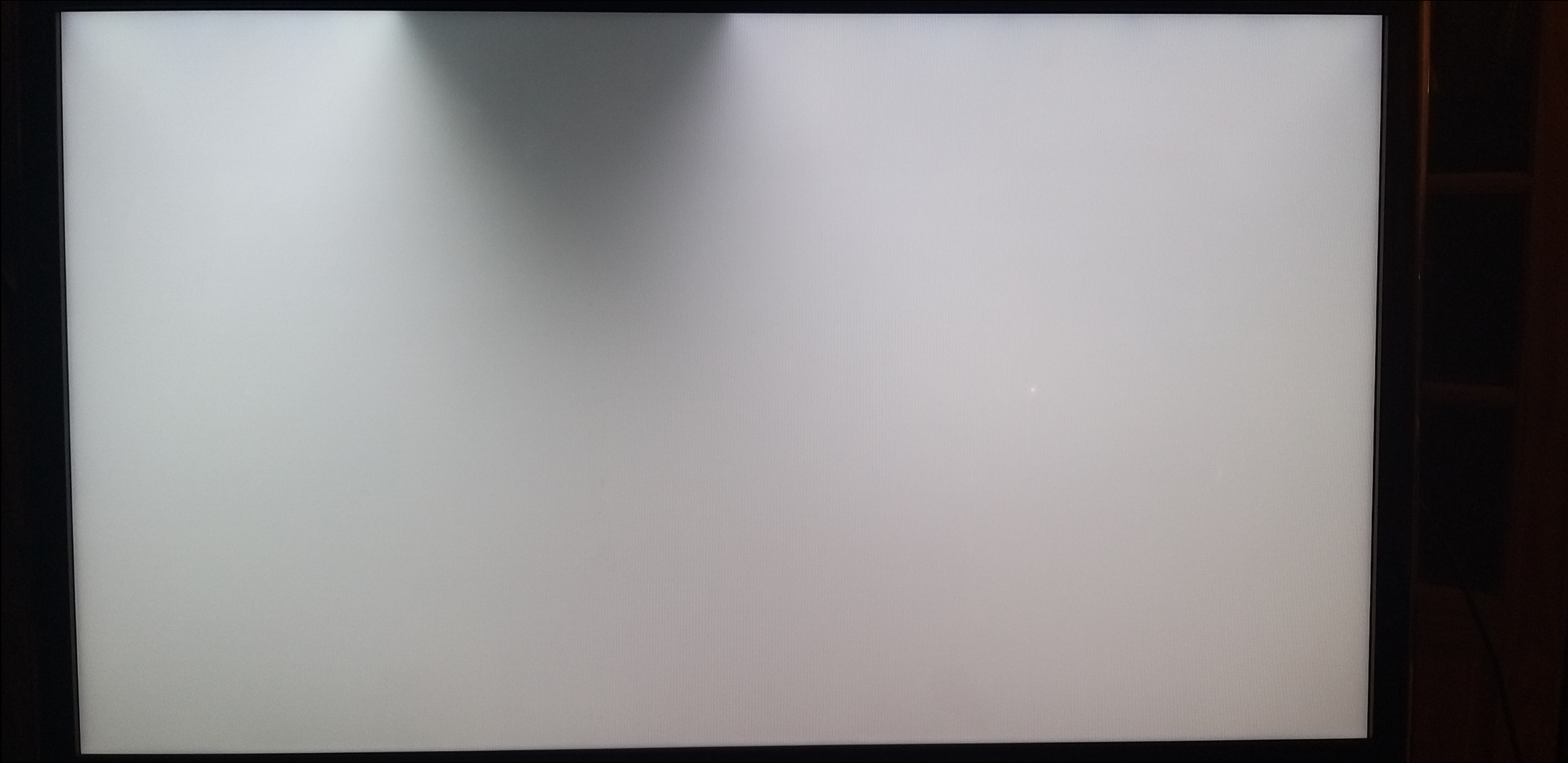

    The TV came to me with sound, no picture. When switched on it did show image but a couple of the top edge lit backlight leds were out, causing a black spot at the top middle. Didn't notice any screen issues at the time but could have been there already just didnt see it.

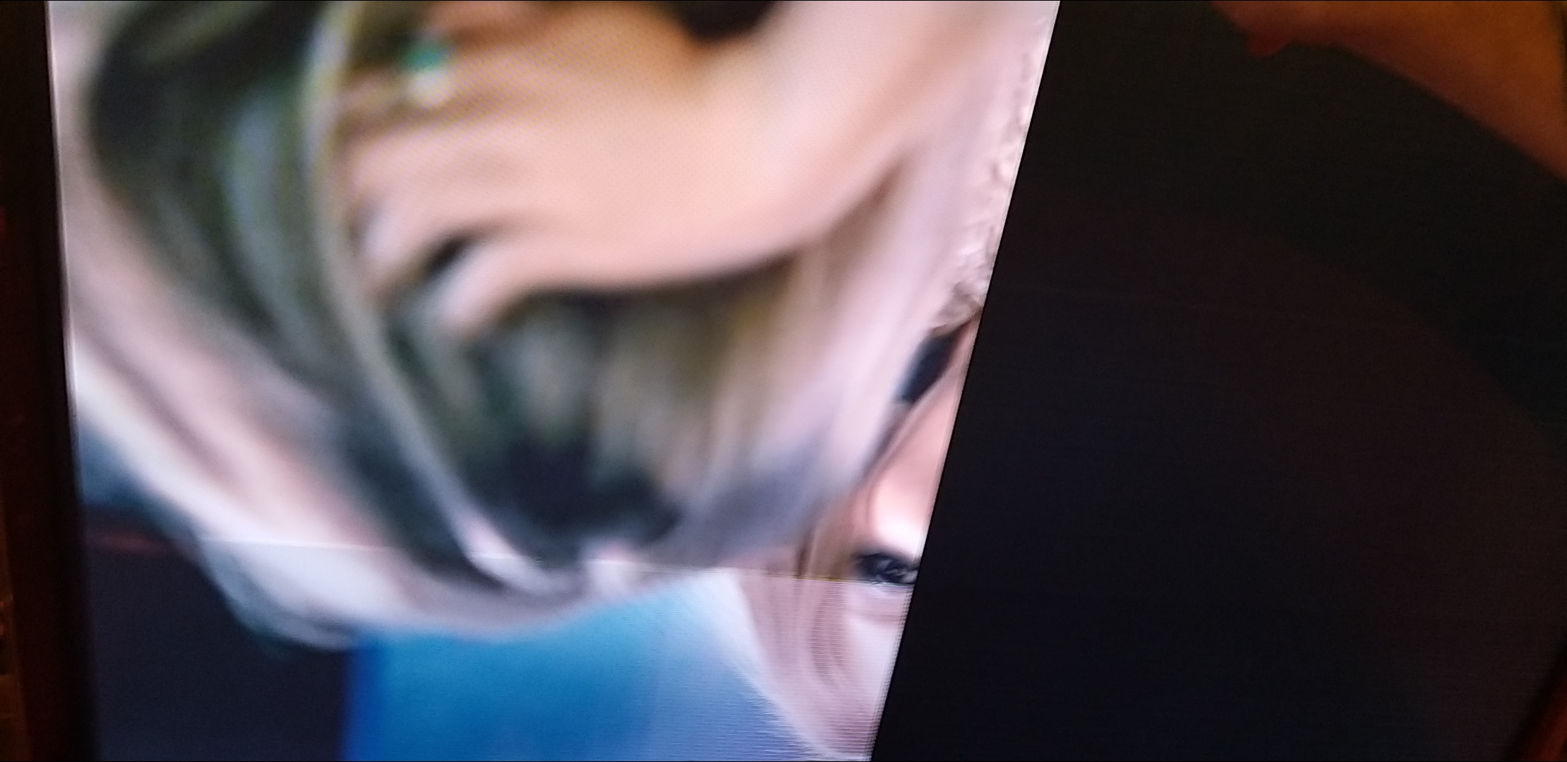

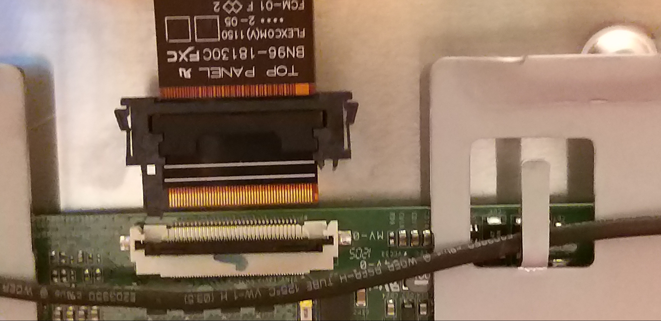

    The backlight strips were replaced which went smoothly but of course its possible I unknowingly damaged something, well actually I did, the main to t-con ribbon connector. Thought it was just a press-in side tabs and pull out, but there was a retaining flip out clip that needed releasing first, but not convinced this is the cause, again I could be wrong.

    Picture 1 - damaged t-con ribbon comnector
    Picture 2 - black spot. original known fault

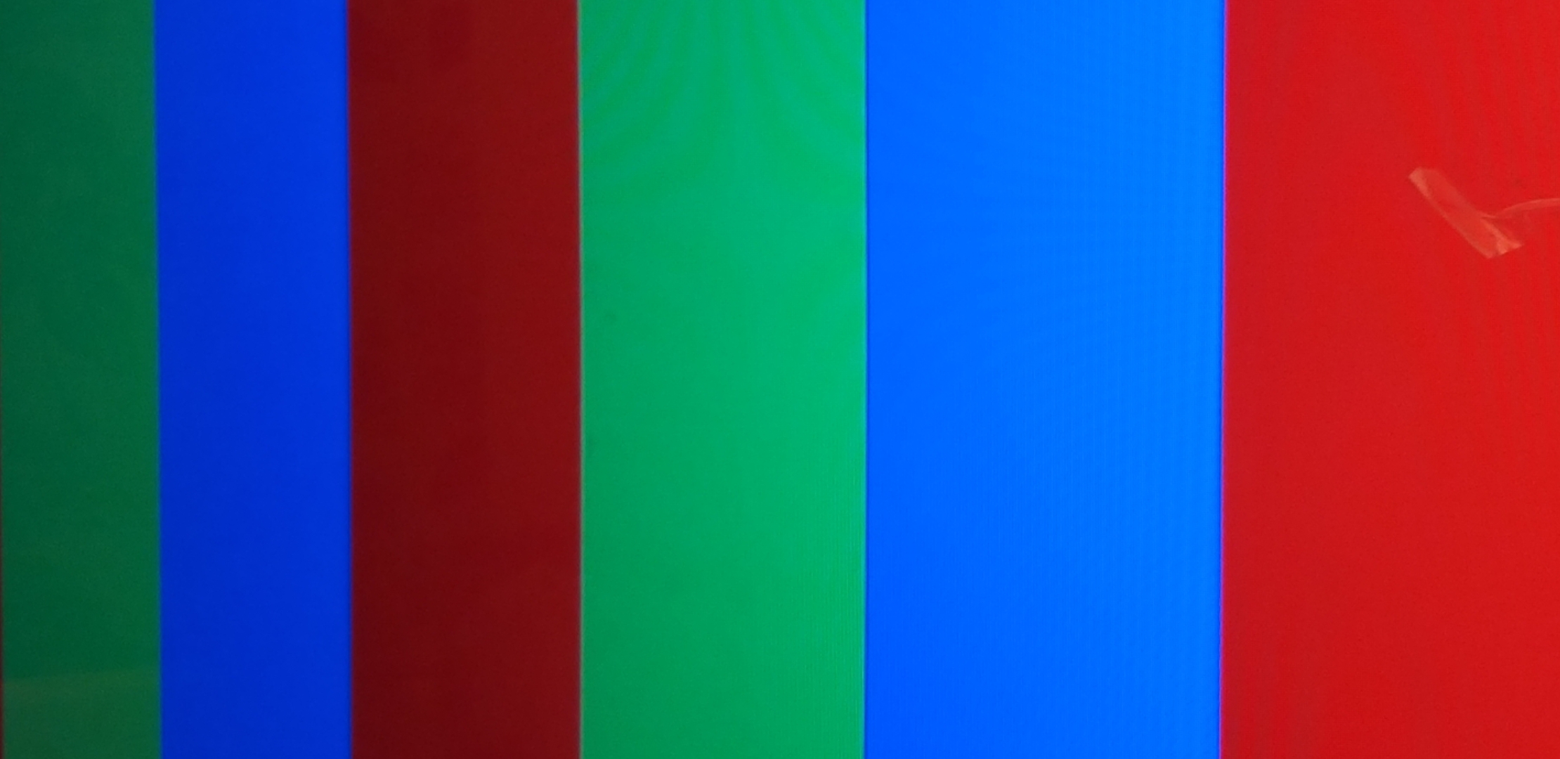

    Picture 3 - youtube vid of red, green, blue test screen - note there are NO horizontal lines showing!

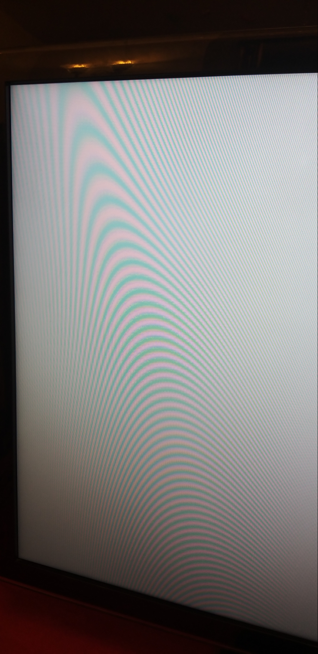

    Picture 4 - youtube white screen video - again no lines

      Re: Samsung UE46D6100 thin horizontal lines
      Thanks.
      This is what I get with just one side of the tcon connected at a time.
      • neilc6
        • Nov 2015
        • 1550
        Looks like both sides are causing problems. If you block the pins from the worse side, you will likely still have the display issues on the better side.
        • notallbad
          • Oct 2012
          • 1190
          Yh. just gonna strip it down for spares, can't be investing too much time into it only for the conclusion to be the same result.
          Thanks for your time, appreciate it!
