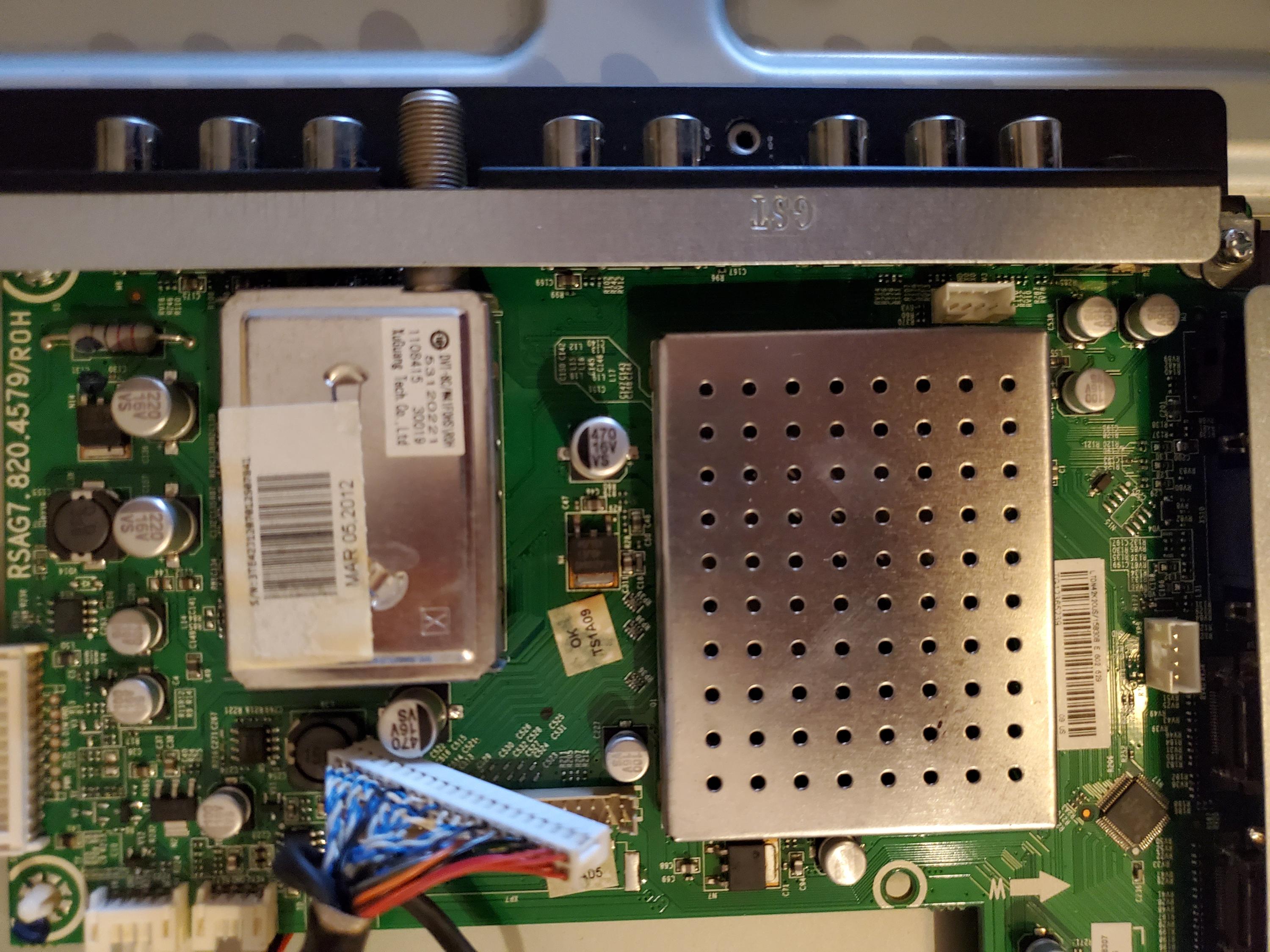

    I found a Hisense F42K20E in the trash. The picture works great, but there's static coming out of both speakers even with sound turned down to zero.

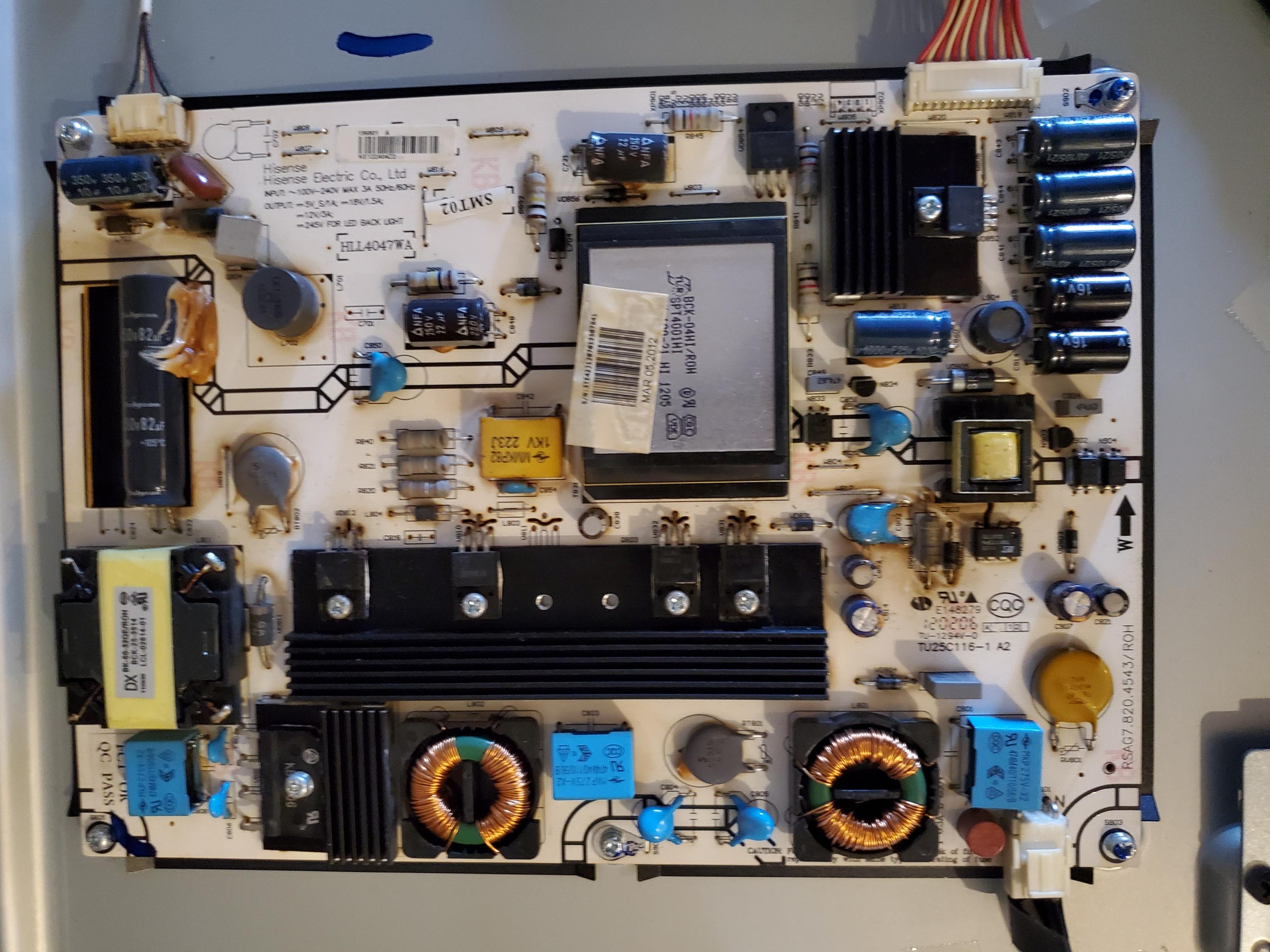

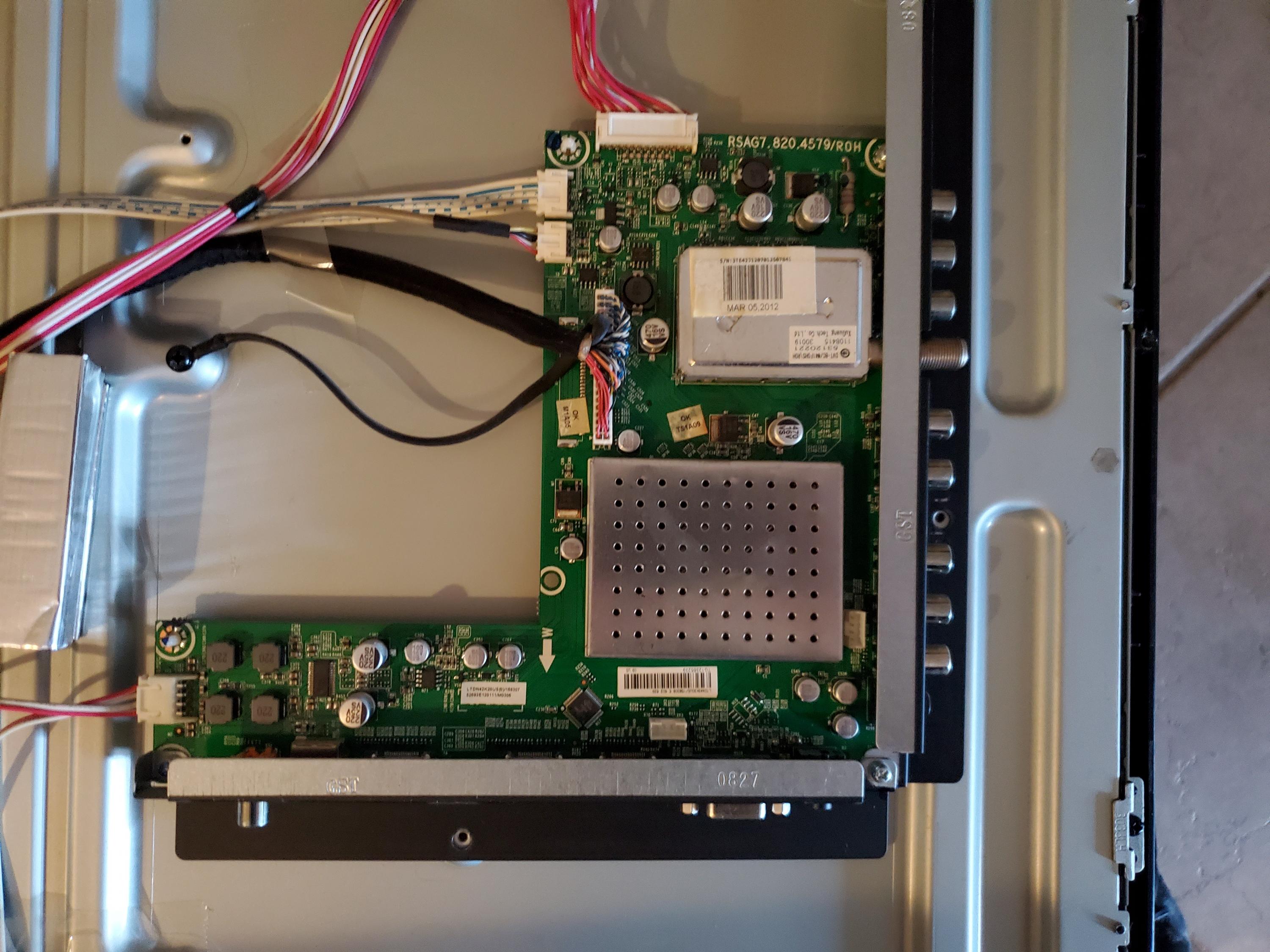

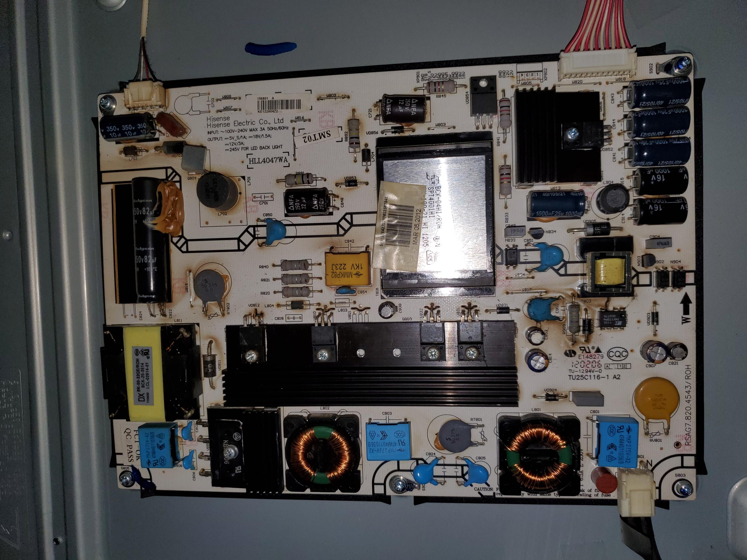

    I'm attaching some pics. I'm not sure what happend to the main power board, it looks like crap.

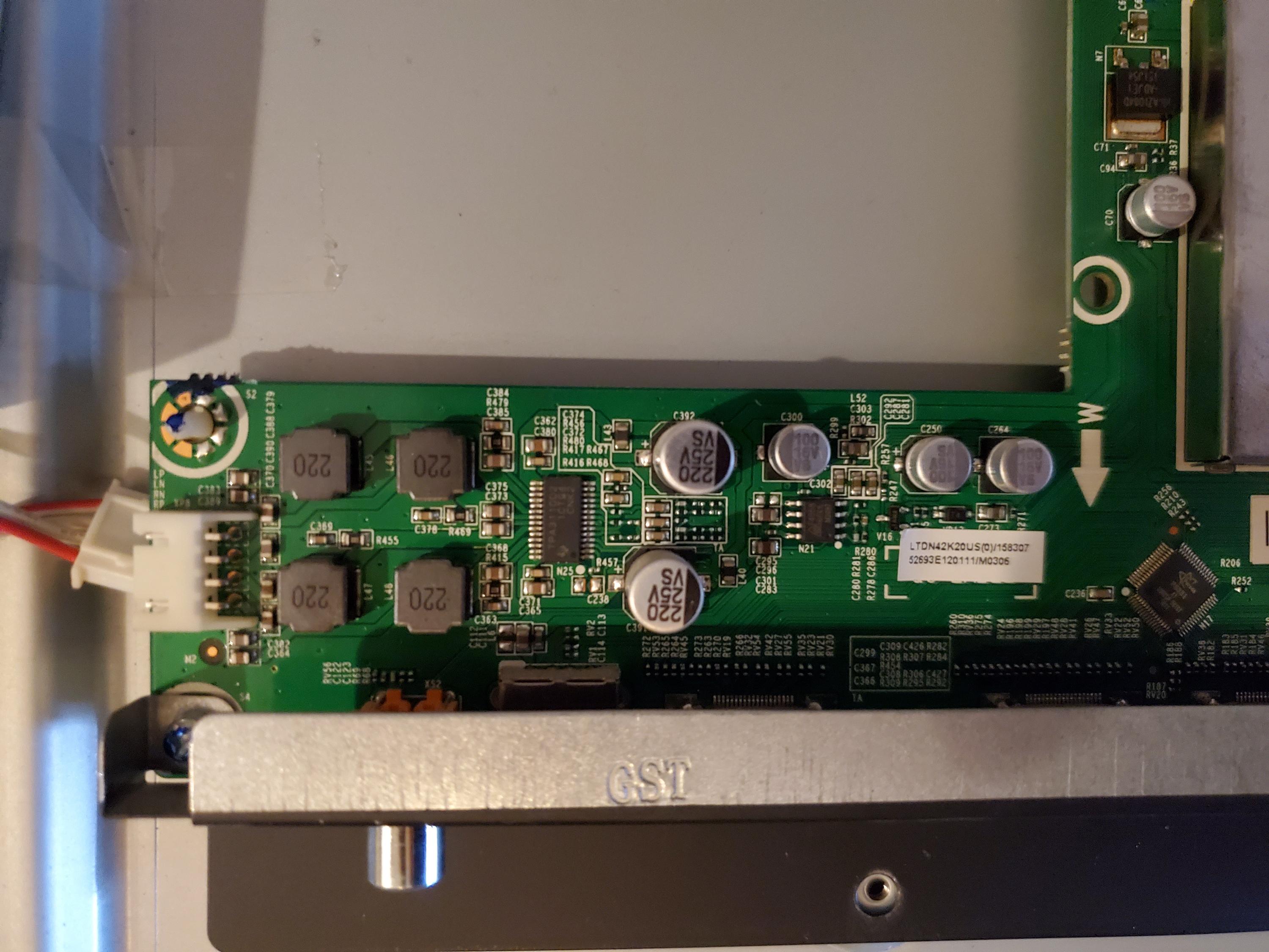

                  probably the main board since sound is made there... how ever it could be "dirty power" coming from the power but I doubt that because then you would like have other issues. If you post good medium close of the main board in and around where the speaker outputs are on the main (going to the internal speakers), someone may recognize some of the chips involved which may get you some "hints".
                    Re: Hisense F42K20E static out of speakers even with sound turned down
                    https://www.badcaps.net/forum/attach...4&d=1597787583
                    The Class D amplifier chip is in the bottom left of the board where the speakers connector is, you see 4 black round inductors to the left of the IC, and two Lytics caps to the right of the IC.
                    Does this TV have headphone output and if it does, do you get noise on the Headphone jack also?
                        Yes it has a headphone jack on the bottom of the right side and yes it produces the same static. Here are some closer pics.

                                  i am however thinking it could be a power supply issue .

                                    this noise are static . it may caused by the dust (dirt you have on all boards) .first you need to clean all boards up and down sides. panel tabs ..sockets... with high pressure air
