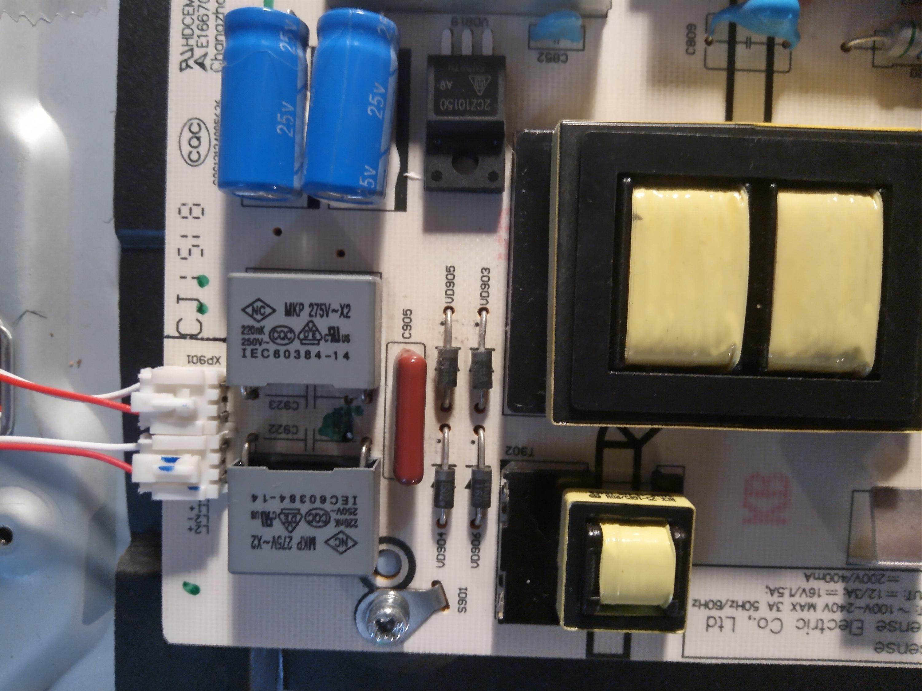

    What voltage do you have between the legs of either of the 68uF 450V capacitors
    The led voltage is given as 200V @ 400mA which appears to be missing.

                        Looks like the led is driven by an high frequency AC signal driven via T902 & T901 and rectified by diodes VD903 to VD906. Have you checked those diodes?
                        Do you have access to an oscilloscope?

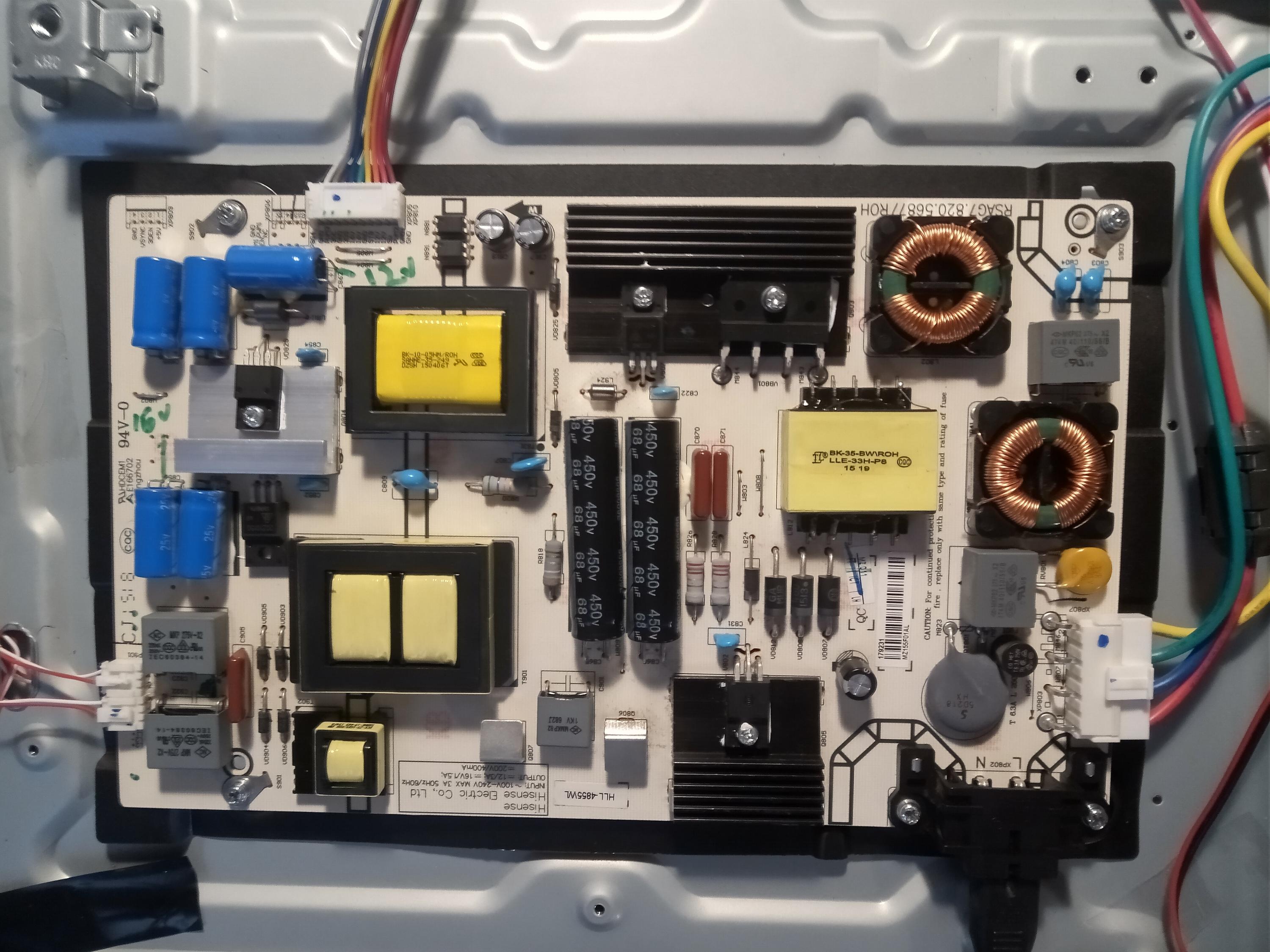

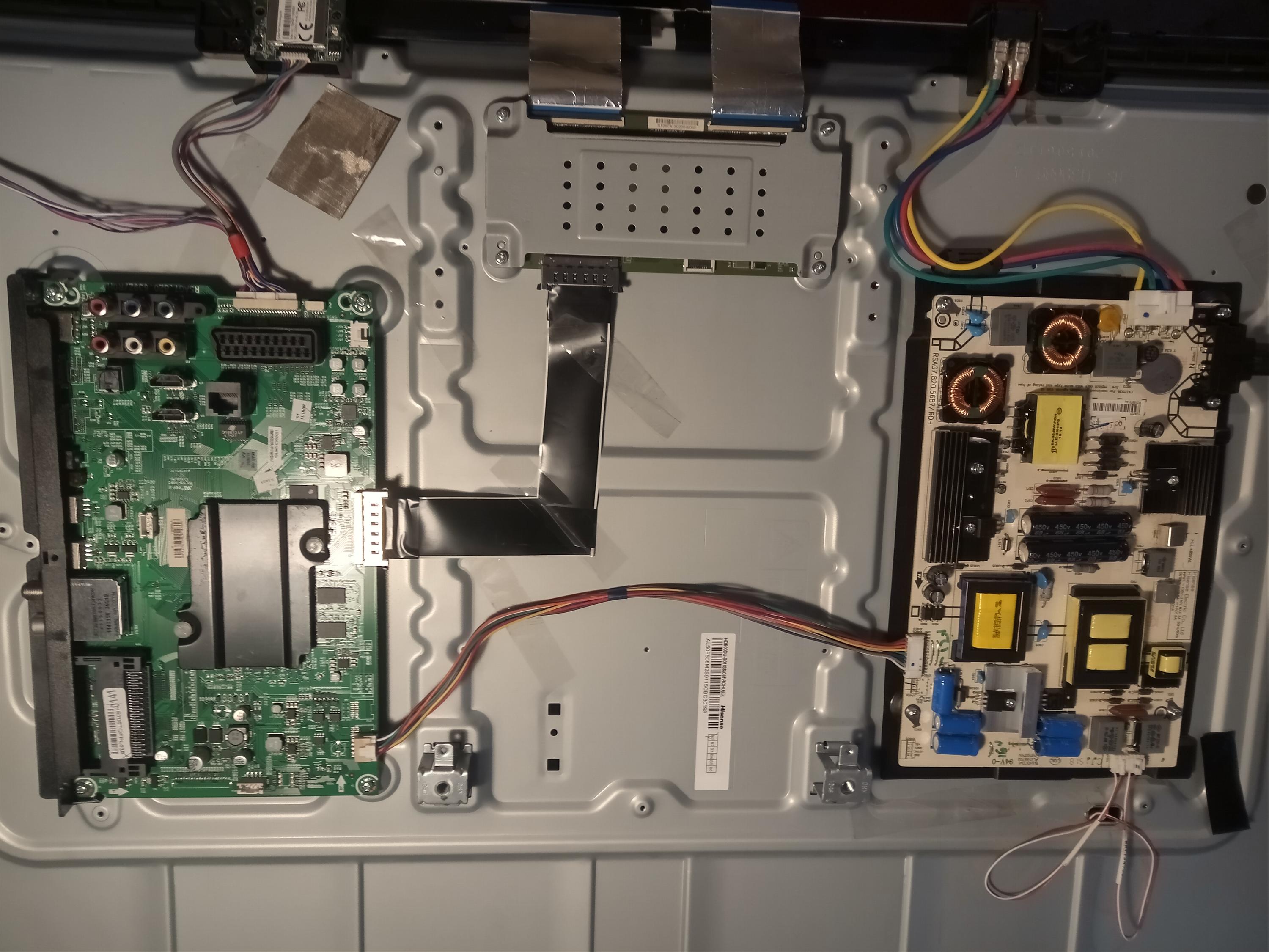

                              also please upload photo on whole the back side show how the boards connected..
                              if your panel integrated with T-CON, the set will not working if the panel out side the set.
                              also did you check before when you have sound to hear with torch light can see picture on the screen ??

                                the t con is separate from main board and the test with torch i couldnt see any pic info

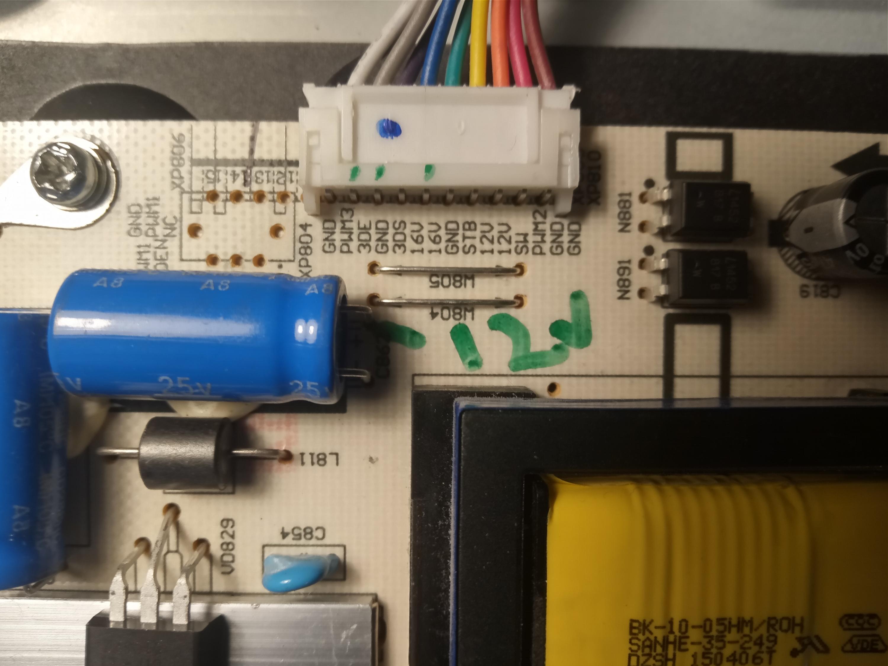

                                  open the metal shield of the T_CON post very clear close photo of it... also you have on it SMT fuse test it black probe on chassis if you have 12V. on both side of the fuse.
                                  BTW:
                                  if you confirmed there are 12V on both side of the T_CON fuse.. please put every things in place and turn on the TV, black probe on chassis and read all the voltage as they are listed over here
                                  PWM2 --
                                  SW ---
                                  12V ---
                                  STB ---
                                  16V ---
                                  3DS ---
                                  3DE ---
                                  PWM3 ---
