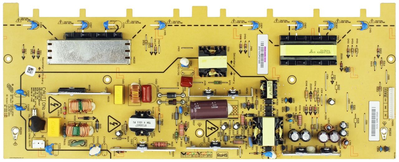

    hi
    i beleive issue is bad inverter section on the ps
    i power tv on and the vizio logo goes from orange to white and i can see startup the vizio logo show on the tv screen (no backlight)
    i have 12v and 5v and 3v blon at the ps
    after about 2 min of tv not connected to vidoe source it goes to standby and vizo goes to orange i believe this is notmal

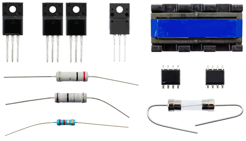

    doing a brief search brings up a repair kit for the ps/inverter obard on shop jimmy so i assume this is a common issue
    here are pics of the stock board and repair kit
    on my board R721 seems to be open and thats right before the transformer circuit..so it does seem that this could be related to issue.
    anyone have this same issue?
    Re: Vizio E320VL powers on but no backlight
    R721 is the fusible resistor for feeding B+ to the inverter circuit, you need to test MOSFET's Q701, Q702 to see if they are shorted out or not.
          update..as i expected it was a bad inverter board section of the ps
          i got a replacement board for only $20 shipped and issue resolved
          i was going to troubleshoot it at component level but not worth the headache...it was more sensible to buy the $20 replacement in my opinion..
