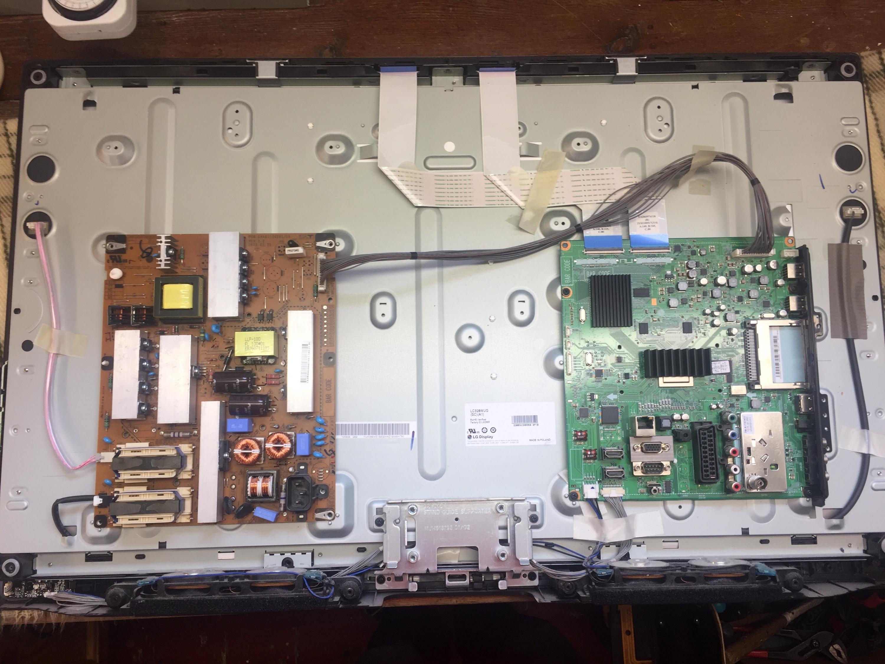

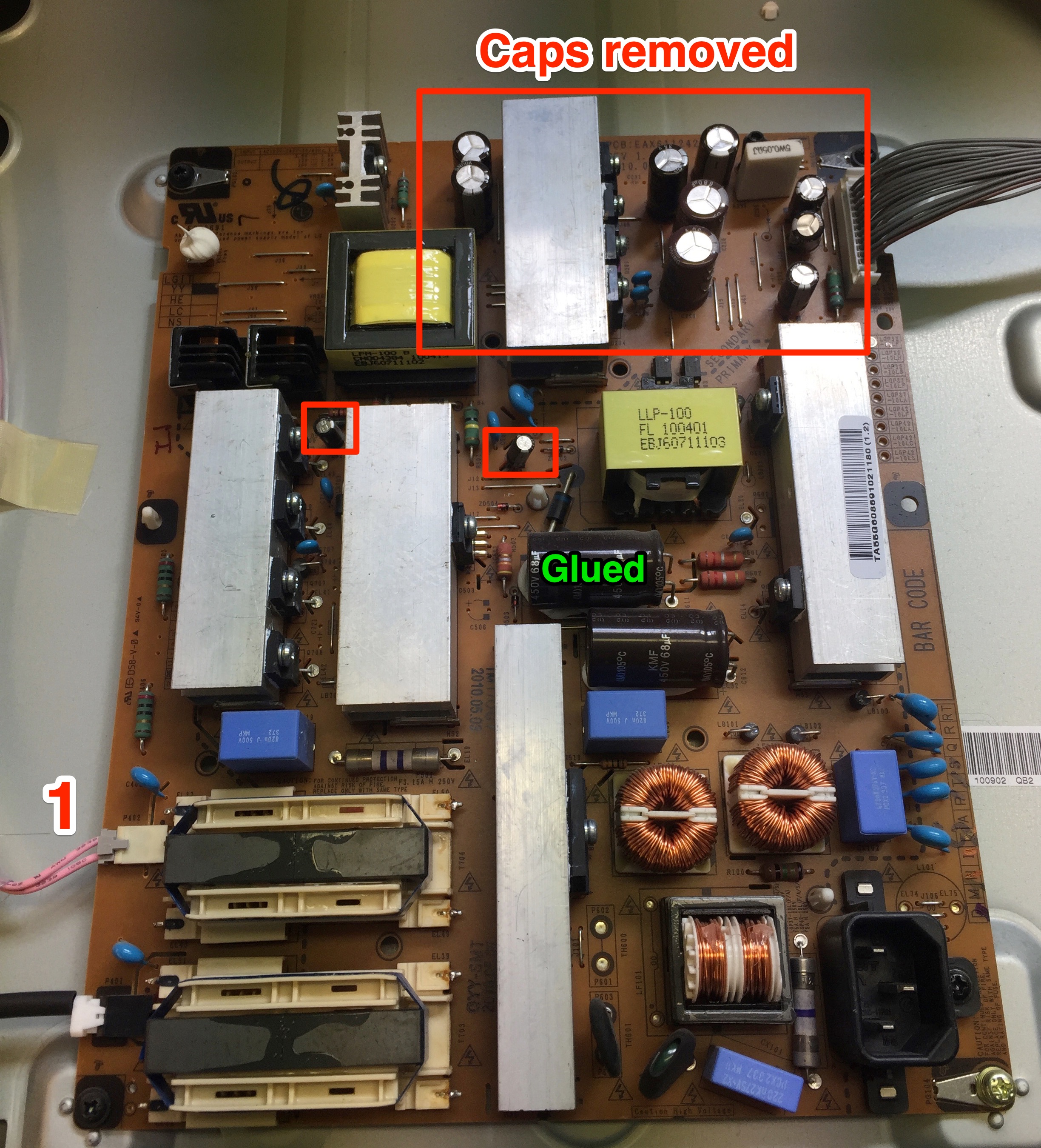

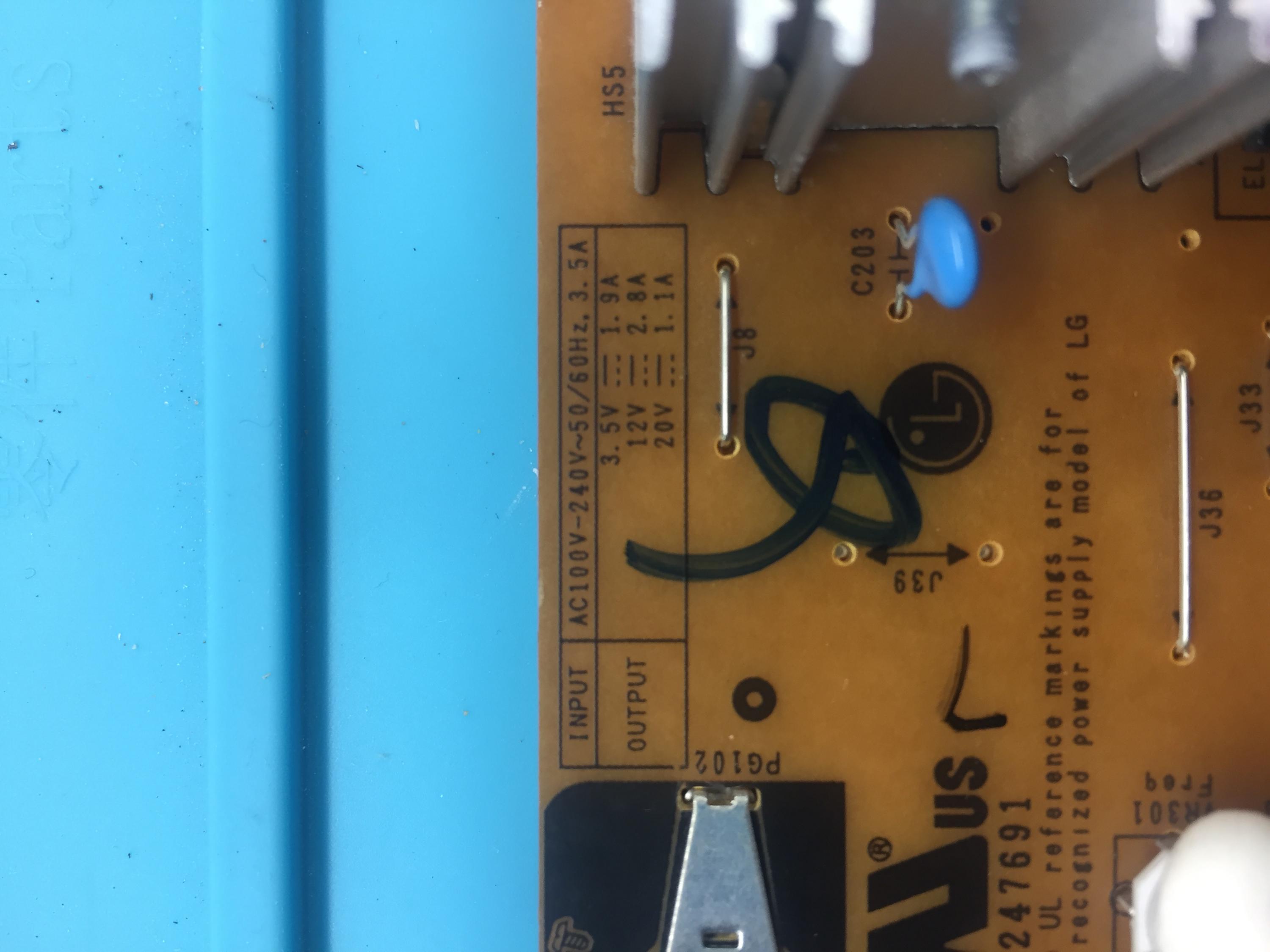

    I have an LG TV model 32LD650N. It's about 9 years old. The last year it has been slower and slower to turn on. When I power it on, the red LED flashes (normal during power on) but the screen stays off. After ~15 minutes turning if off and on again would make the screen go on. The TV would work fine from there.
    But now it just stays on the blinking power LED trying to turn on.
    What I have tried:
    I am very much a beginner when it comes to electronics repair. But I suspected a bad capacitor on the power-supply.
    After disassembly there was nothing to see during the visual inspection. All the caps look fine.
    The power-supply has 3 voltages (3.5v, 12v, 20v) and is connected to the 'signal board' with a 24 pin cable.
    The power-board has 2 fuses, both of which I measured and they are OK.
    The supply has 2 other connections going directly to the screen (marked with 1 on the annotated images).
    Measurements:
    When the supply is not connected to the signal board I can only measure 3.5v on the 24 pin jack.
    When the signal board is connected and the TV is trying to turn on, all 3 voltages are present on the 24 pin jack.
    Checking the caps:
    Next I de-soldered all of the electrolytic capacitors, one at a time. (Except 2 big ones on the primary side, they are glued down with some white adhesive).
    They all measured fine on my multimeter. 10% within the printed value. I can see nothing wrong with them.
    Since I was unable to de-solder the two big caps I have not been able to measure them. But they look fine...
    What's next?
    I have no idea what to try next so I'm posting here for some guidance.
    It's seems impossible to remove the big glued caps without damaging them. Any tips on removing the adhesive?
    Any ideas or advice on what to do next is very welcome.

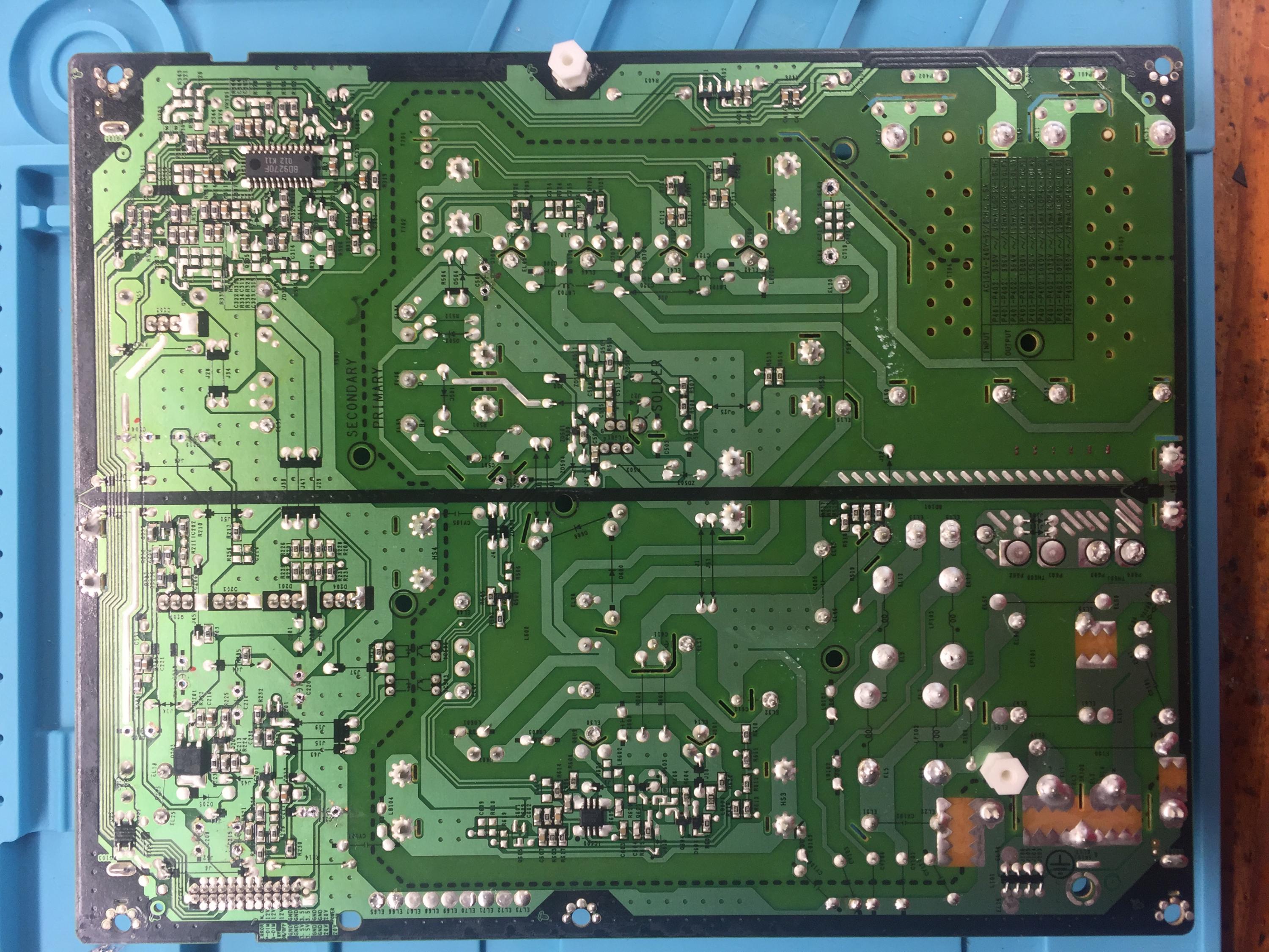

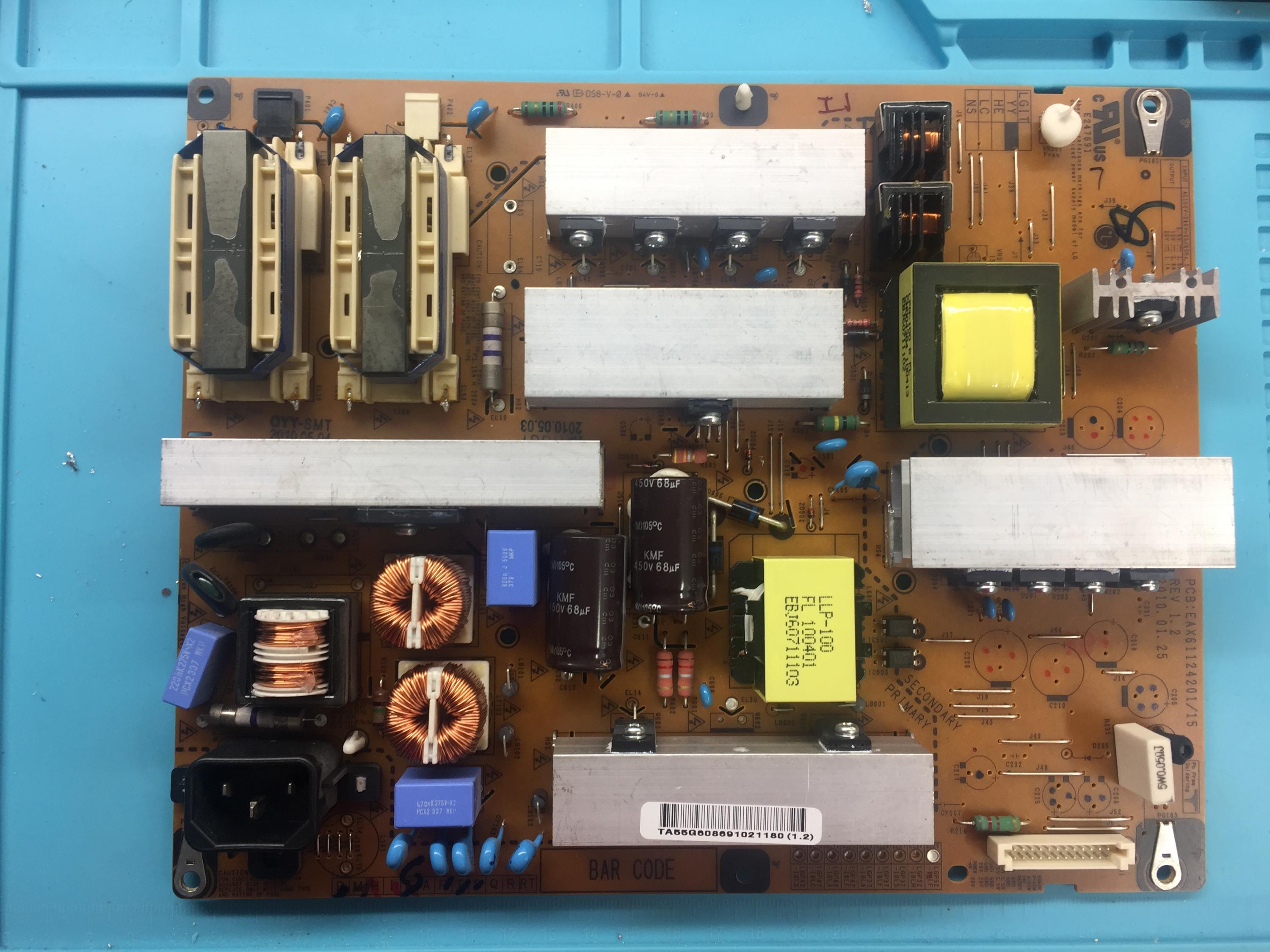

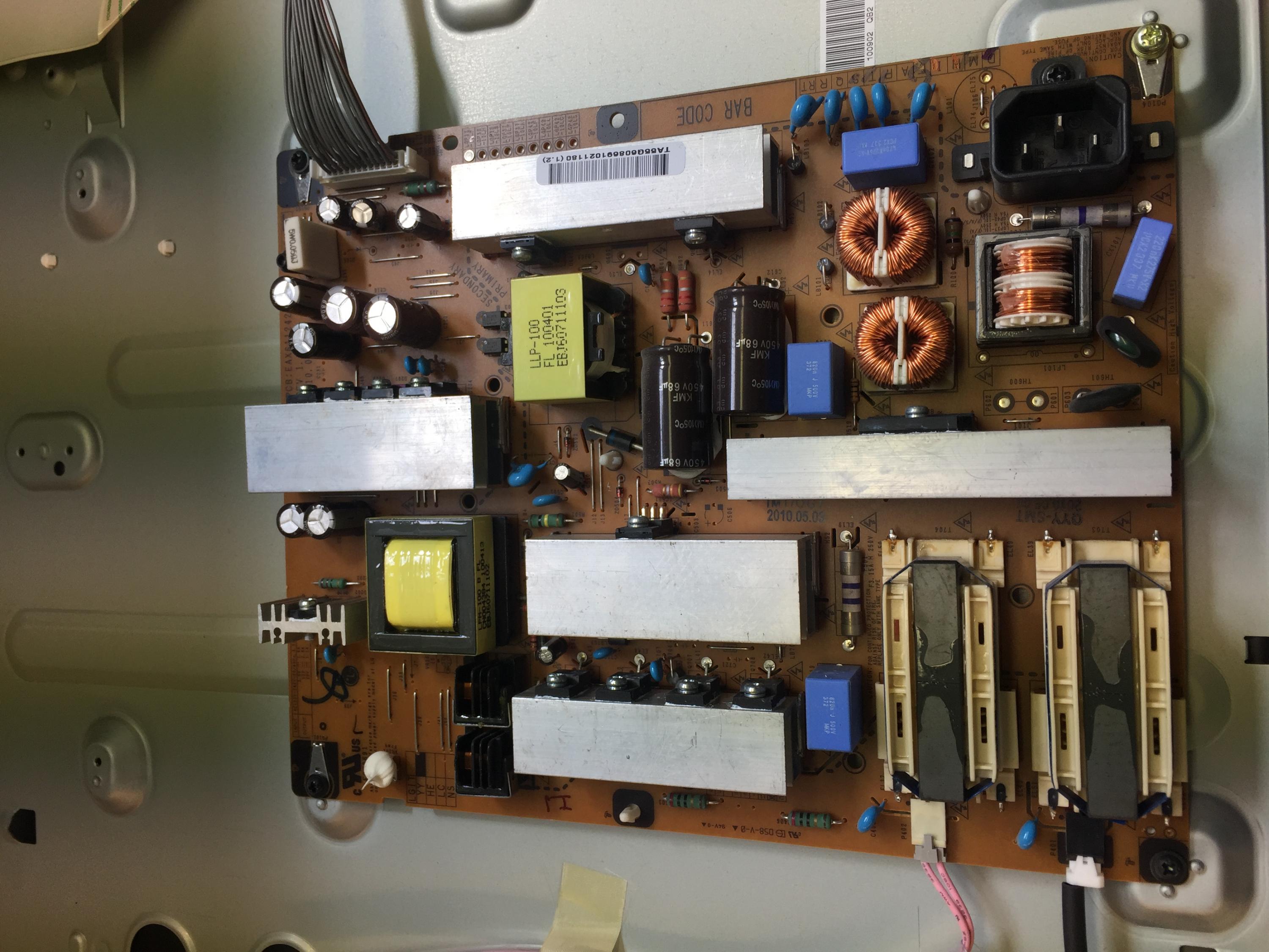

    1) Please provide the good clear straight shot pictures of the whole top and bottom side of the board.

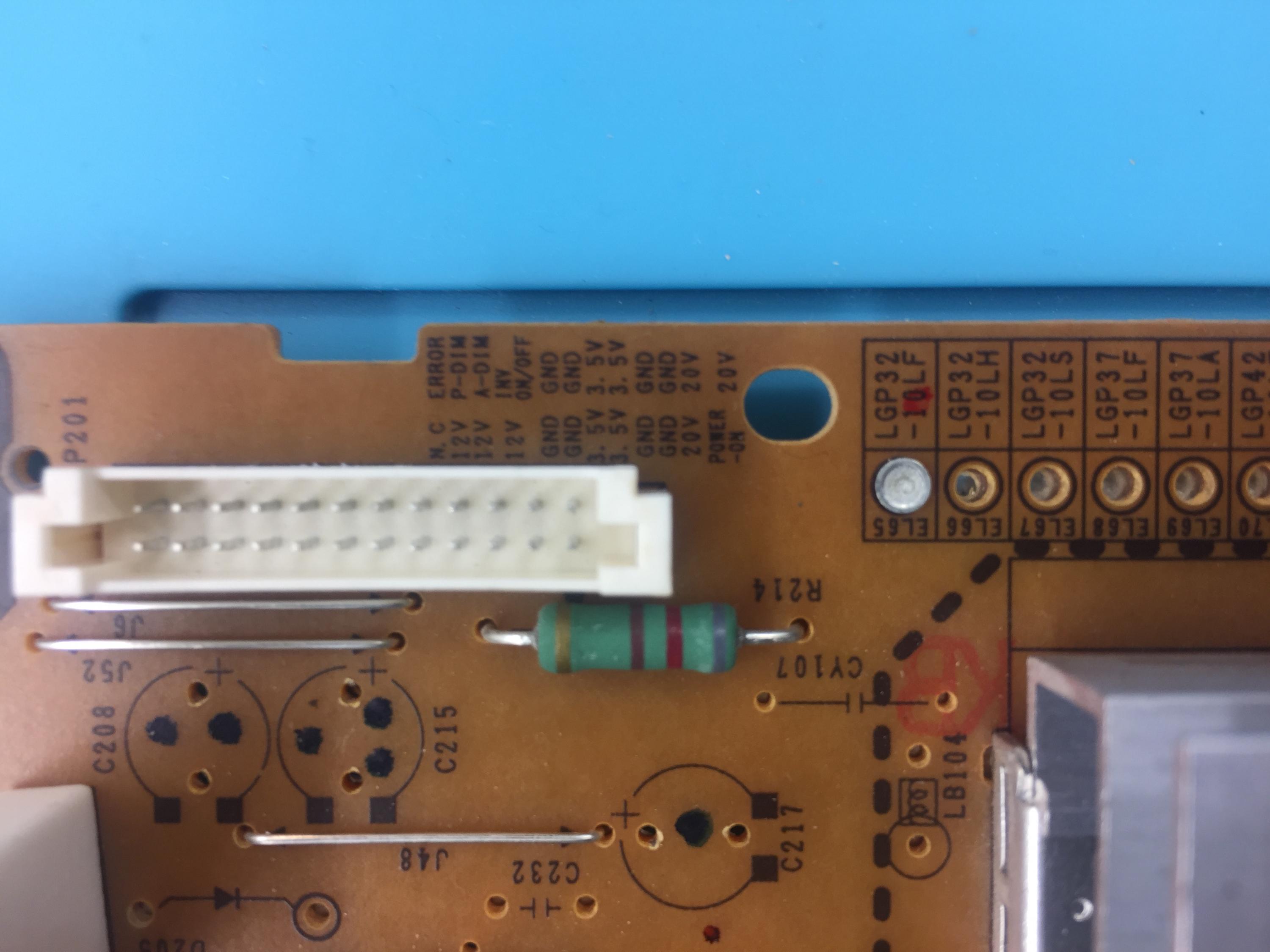

    2) The connector on the power supply board that goes to the main board. Are there pin labels printed by the connector or on the board some where? We need those pin labels so we can see what Voltage each pin has when TV is working and when it stops working.

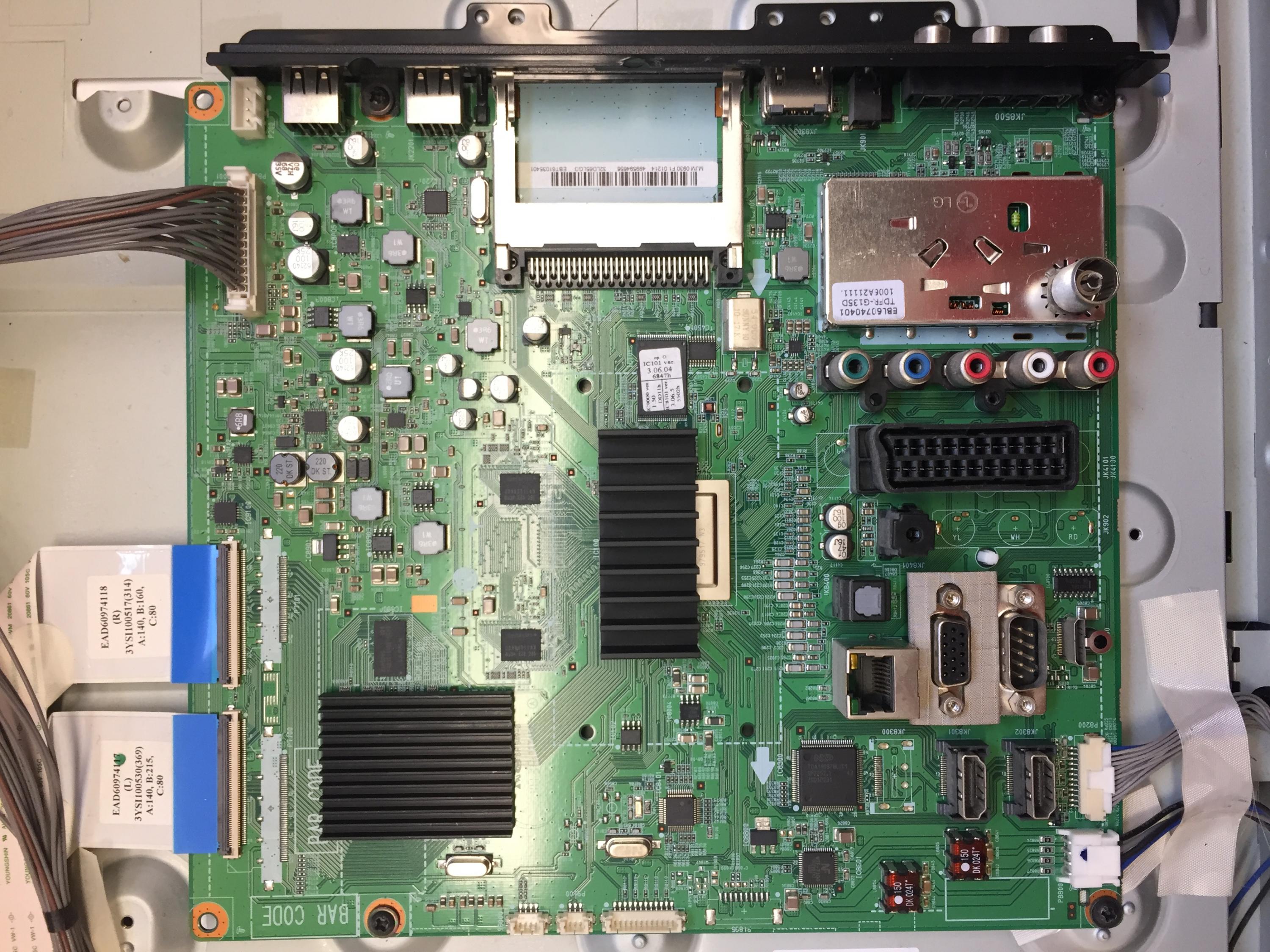

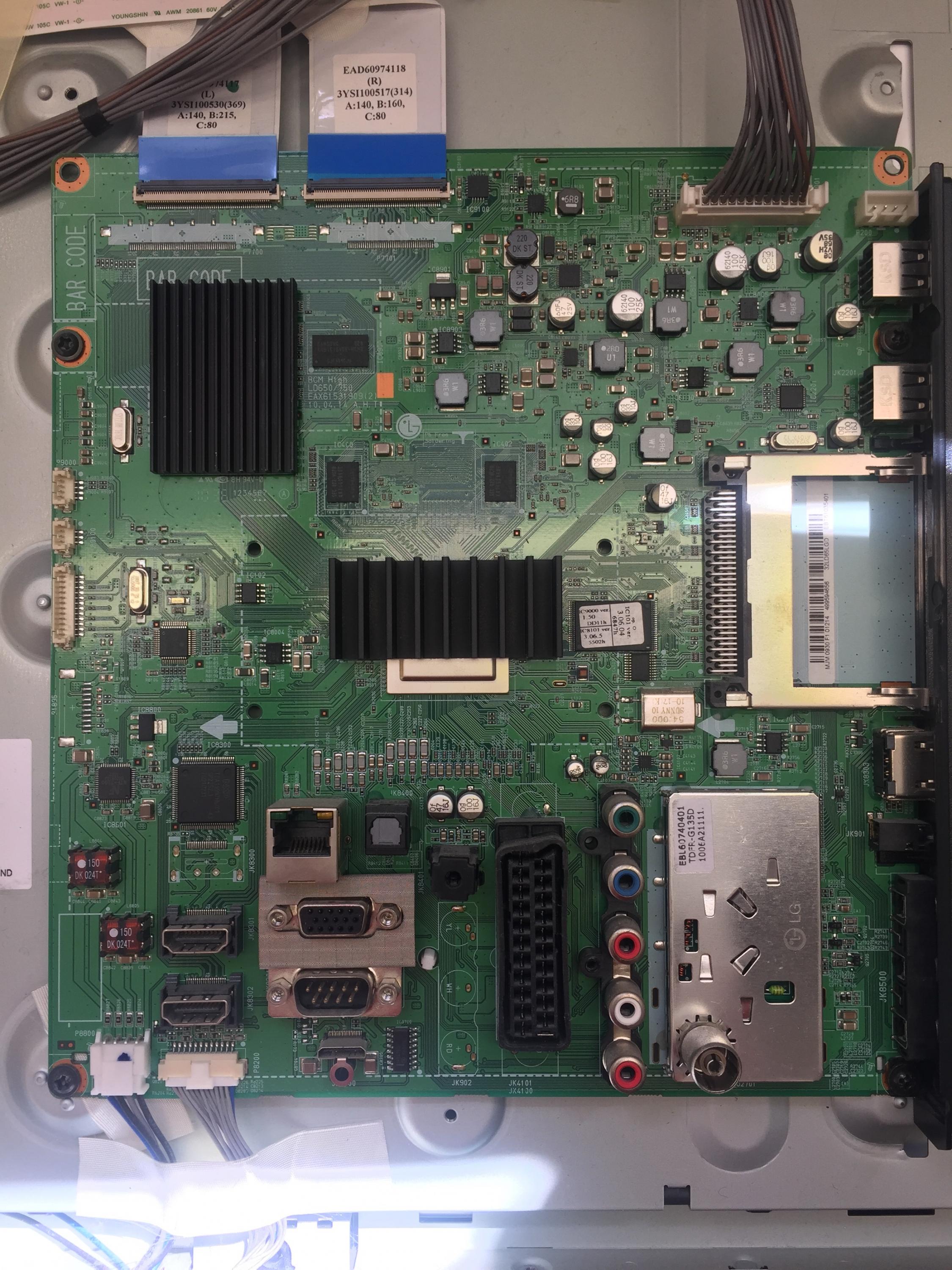

    3) Please also provide the pictures of the whole backside of the TV showing all the boards so we can see how the boards are connected together.

      1) Here are some new pictures of the power board. I only posted the other one, because it was the only one I had, before de-soldering the caps. This picture has the caps de-soldered. I hope that's okay.
      2) Uploaded a picture of the pin-out of the 24 pin connector.
      3) Also uploaded, showing the power and main board on the back of the tv. The two multi-cables at the bottom of the main board goes to the speakers(the left one). And the side-panel buttons and the standby LED (the right one)

      5) Let me try to clarify.
      When the TV worked properly the following would happen: Solid red LED was on when on standby. Pressing the power button the LED would flash 1-2 seconds. Then the screen would come on, displaying the time and an LG logo. Then it switched to live TV with sound.
      Gradually it got slower and slower and would stay in the blinked LED phase. Until it was "warm" (after 5-15 minutes, getting slower all the time) then if you pressed the power button to turn it off and on again the clock and the LG logo would appear (sometimes after a few tries). From there it would work fine.
      Now when it's connected to power the red standby LED is on (as normal). When I try to power it on the red LED starts flashing, but nothing else is happening. No sound and I'm 95% sure there is no backlight. But I can re-solder the caps and check to make sure. Trying the "trick" of powering it off and on no longer works.
      I appreciate you taking the time to reply. I'm really taking this as an opportunity to learn. If I forgot any information please let me know. And sorry about the picture quality, my phone is getting old. The image rotation changes when I upload, but I hope you can see it alright.

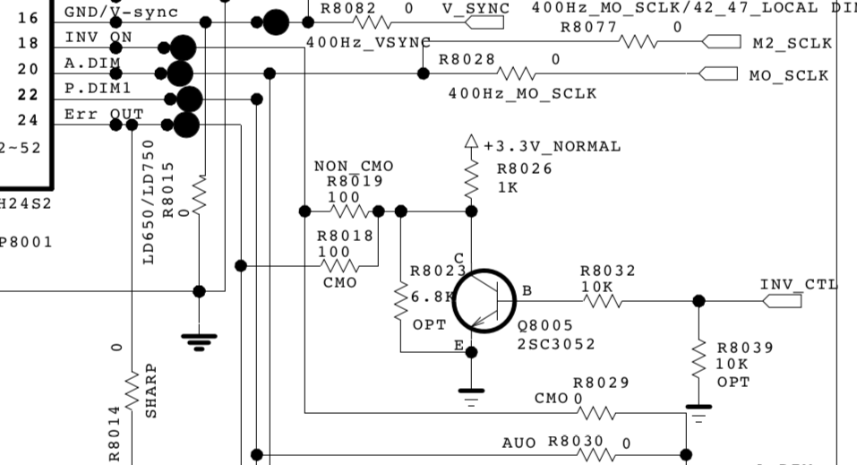

        Possible schematic for your power supply.

          Can you post all the voltages on connector P201 Pins 1 - 24 giving Pin No, Pin Name and voltage when you first power up waiting for it to start.

              Okay, I got all the caps soldered back in.
              After I pressed the power button, the red LED is blinking and there is no backlight. Here are the voltages i measured when the TV is in that state.
              Code:
              | Pin #  | Pin Name | Volt |
              | 1    | Power-on  | 3.2 |
              | 2-4   | 20v    | 22.8 |
              | 5-8   | GND    |  0 |
              | 9-12   | 3.5v    | 3.4 |
              | 13-16  | GND    |  0 |
              | 17,19,21 | 12v    | 12.3 |
              | 18    | Inv on/off |  0 |
              | 20    | A-dim   | 0,06 |
              | 22    | P-dim   | 2,6 |
              | 23    | N.C    |  0 |
              | 24    | Error   | 0,7 |

                Re: LG TV 32LD650N - Slow to turn on. No display
                The inverter ON/Off signal is missing. You could check this voltage again once the set finally come on.
                I suspect this signal comes from the mainboard. This may well be indicative of failure of the BGA of the main IC on the mainboard.

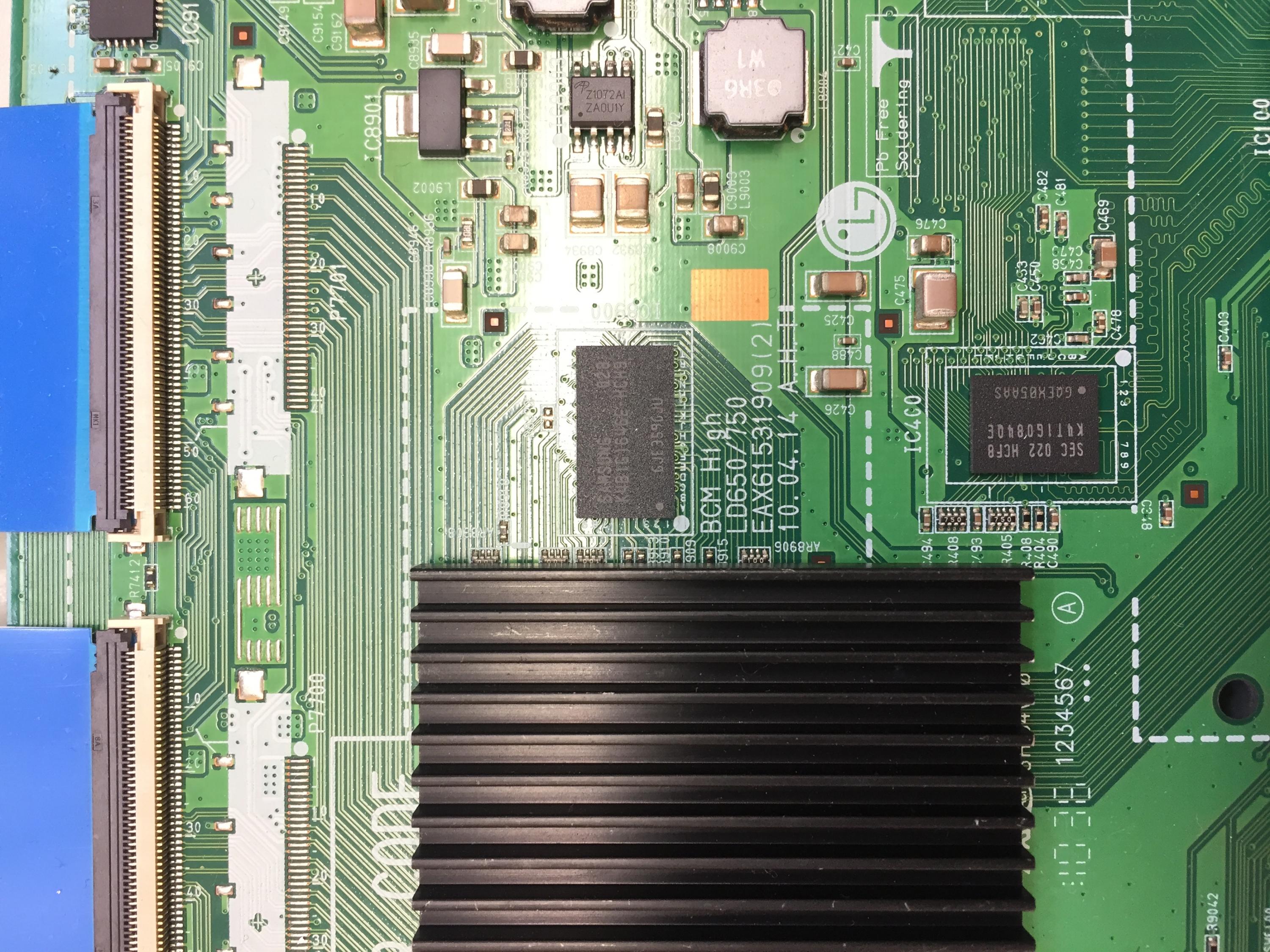

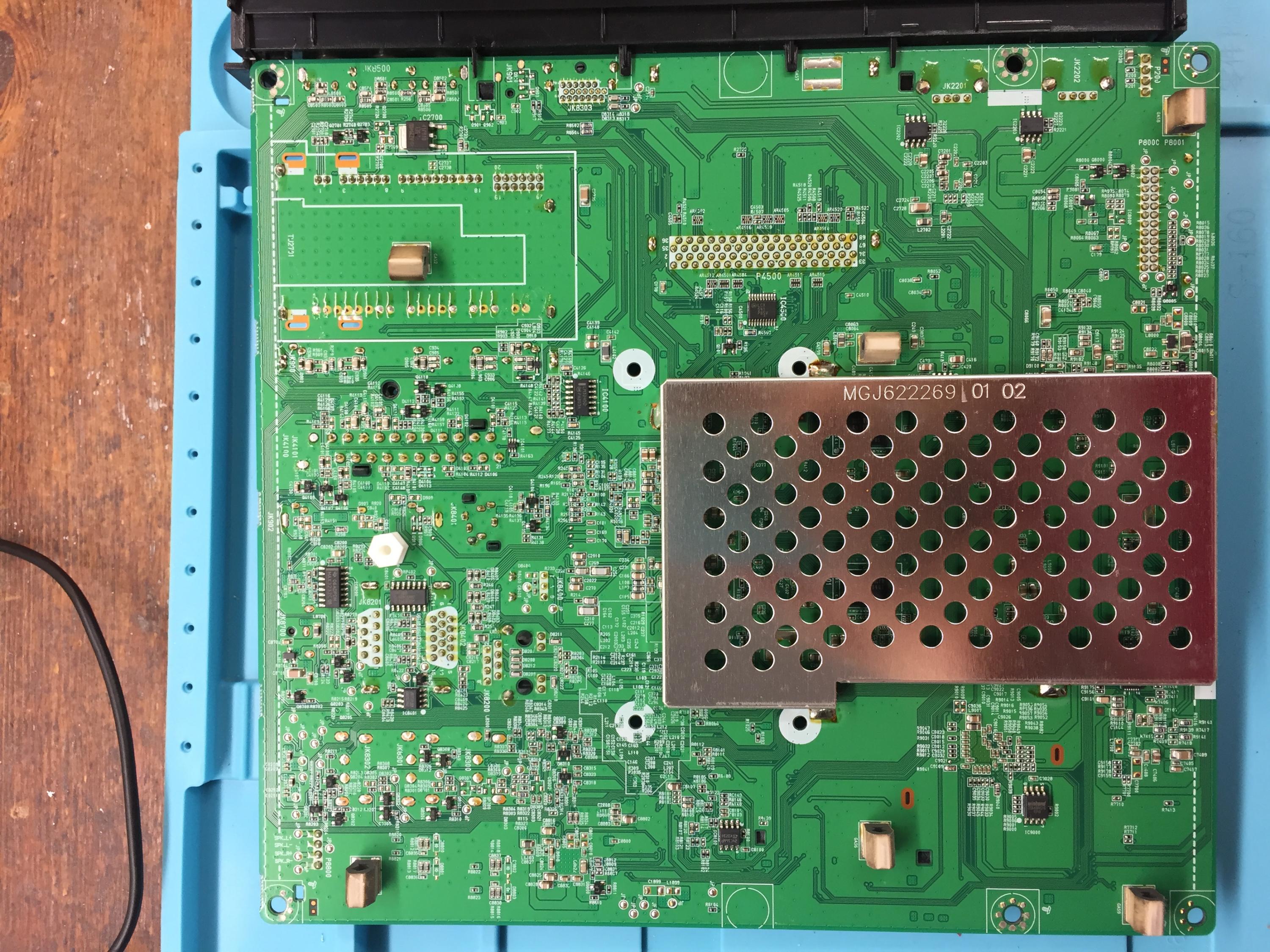

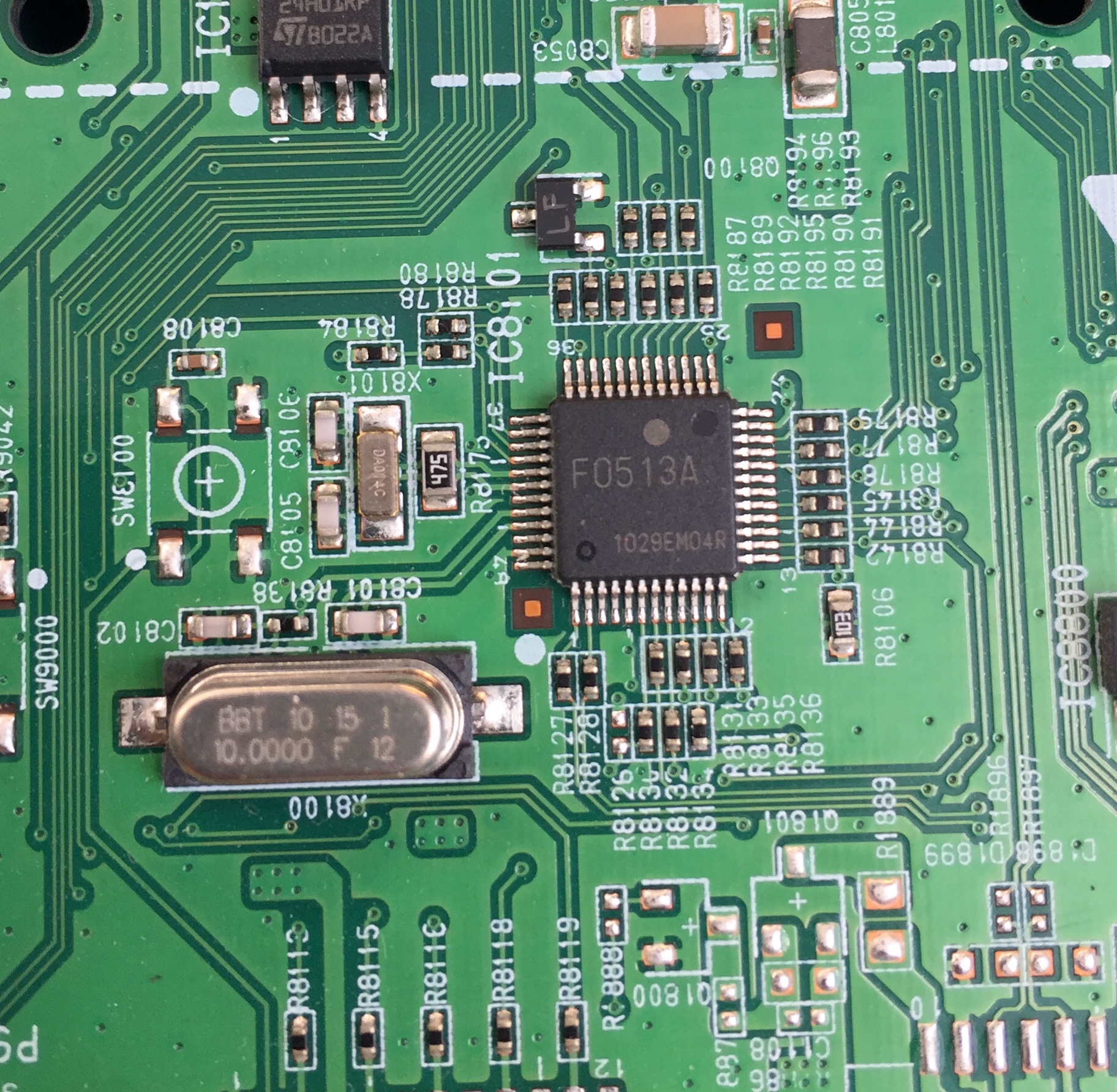

                  Since it might be the main-board at fault I have uploaded a closer picture. I also looked around for a schematic but was unable to find one. I did find the service manual for the 55ld650n which is the 32 inch version I have. I have attached it. Maybe the block diagram can be useful. I also found a full pdf with the power-board(EAX61124201) schematic.

                    INV_ON/OFF is controlled by IC8101 which switches transistor Q8005. Check the voltages on the 3 pins of Q8005.
                    You could try heating up IC8101 and see if the backlights come on quicker.
                    I'm suspecting that IC8101 has problems with its solder joints (BGA)

                      The IC8101 (not a BGA, but a 48 pin LFQFP package, see image) pulls the base of transistor q8005 high to turn OFF the INV On/Off.
                      So when I turn on the tv and the LED is blinking, but there is no backlight. I measure 0.7 on the base of Q8005 (0v on the collector and emitter) this pulls INV on/off to 0v/GND. Otherwise the 3.3V_NORMAL line would make it high. And that is exactly what happens when I get the backlight to turn on using the on/off trick.
                      Then the voltage on the base is 0, and the collector is 3.0 going to the Inv on/off line.
                      I also checked the 3.3V_NORMAL regulator. It's gets it's enable signal also from IC8101 (POWER_ON/OFF2_2) and that is present as soon as I press the power button. So that seems to work as expected converting 12v to 3.3v.
                      I have no experience, but maybe IC8101 is waiting for a signal from elsewhere before allowing the Inv on/off the be enabled. But there is a ton of signals going to and from that chip, so I have no idea how to narrow it down.
                      I have not tried heating IC8101 up to see what that does, because it's operations seems to working. But I can try with an old hairdryer just to see what happens.
