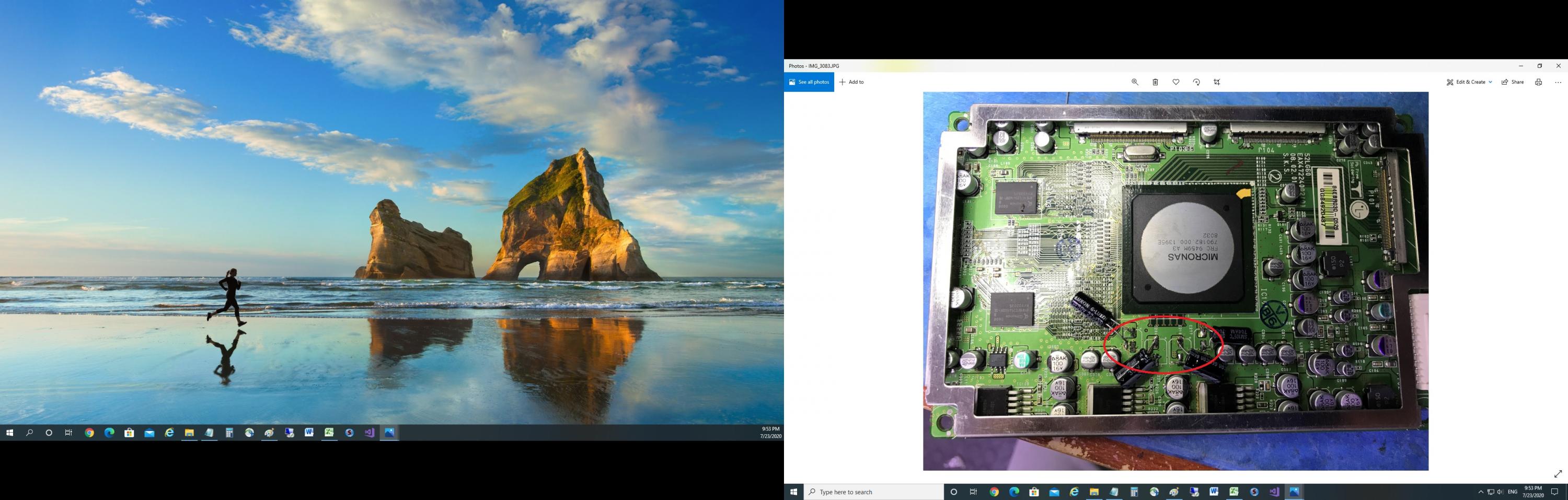

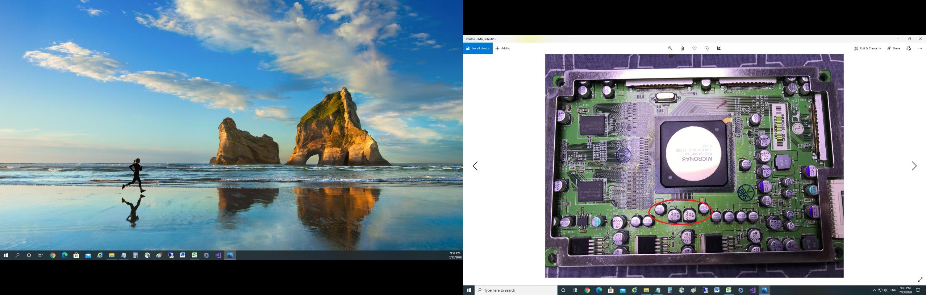

I didn't capture the screenshots, but I got 2 TVS same model same issues, I believe this is the common problem.
I had no idea which capacitor, use heat gun to blew the caps picture came to normal, but after a while problem came back.
Some one posted a video in youtube, mine is even worse then hos:
Re: LG 52LG60 LCD screen full of lines or dots repair
When you heat up the caps, the ESR will go down so the circuit will function again, when ESR goes up then the circuit become unstable. It may work for now using general purpose caps but I would replace them with low ESR type.
