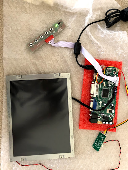

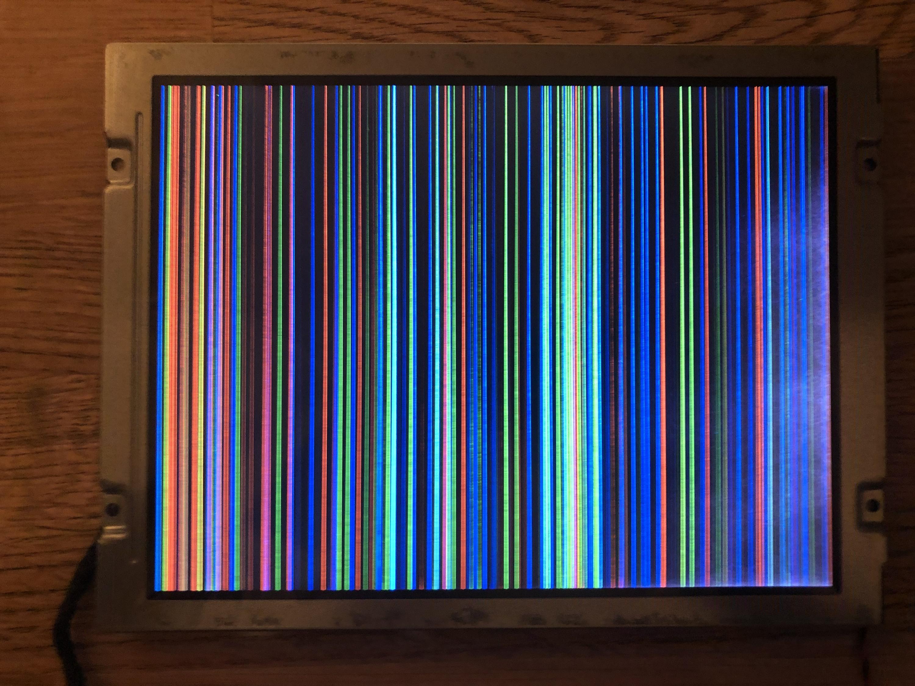

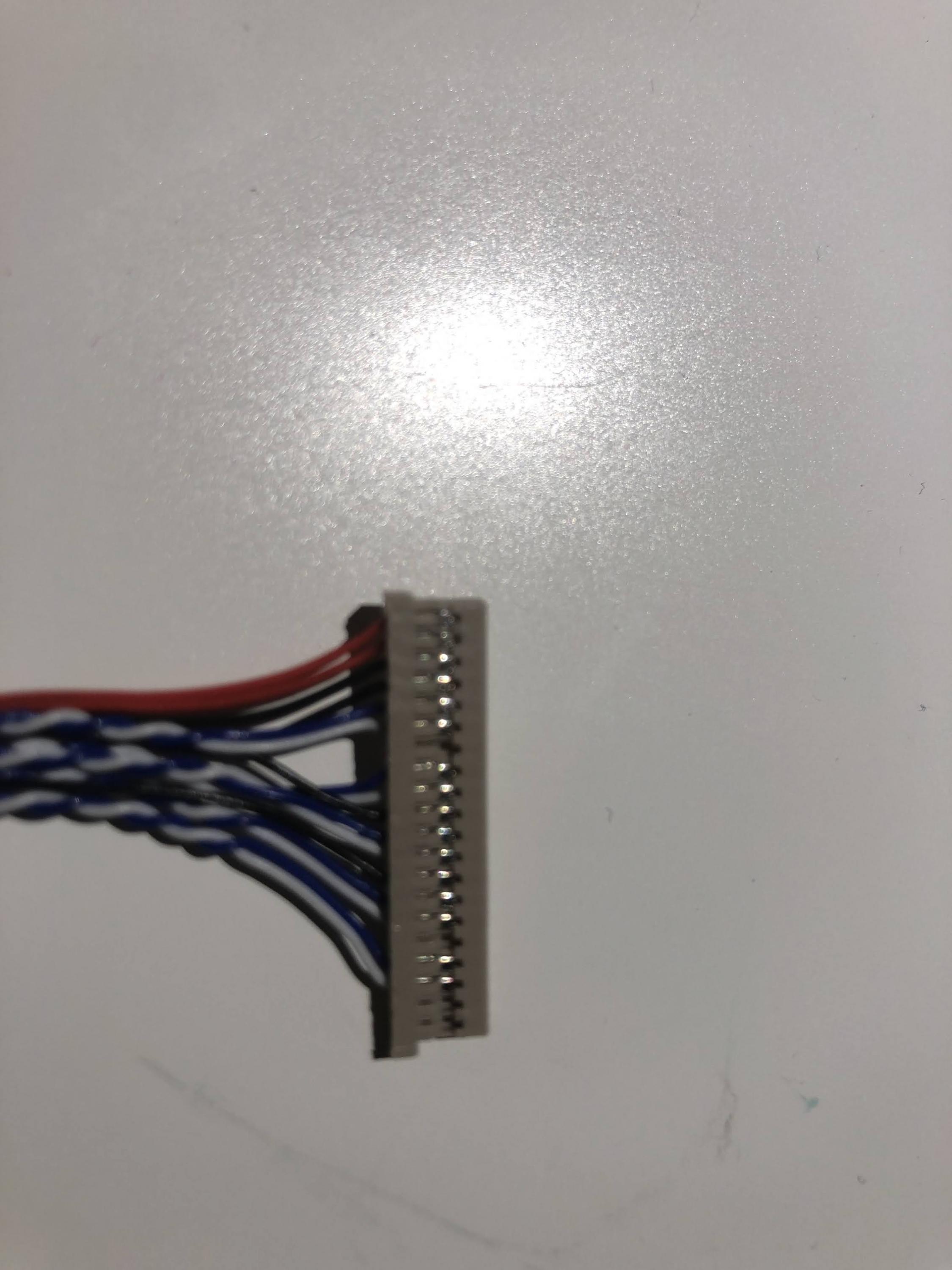

    I have two identical LCD displays from Mitsubishi/OPTREX, reference AA084XB01 and I've bought off ebay an LVDS board for it.
    Connecting the board to either display gives me vertical coloured stripes.
    The seller sent me another board and the same happens.
    I am thinking that either the wrong firmware was used or the pinout is, somehow, wrong and the cables are wrongly connected.
    Please take a look at the pictures attached.
    Thanks in advance.
    Best regards,
    Pedro

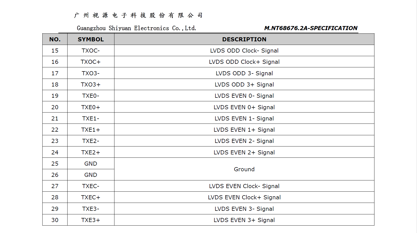

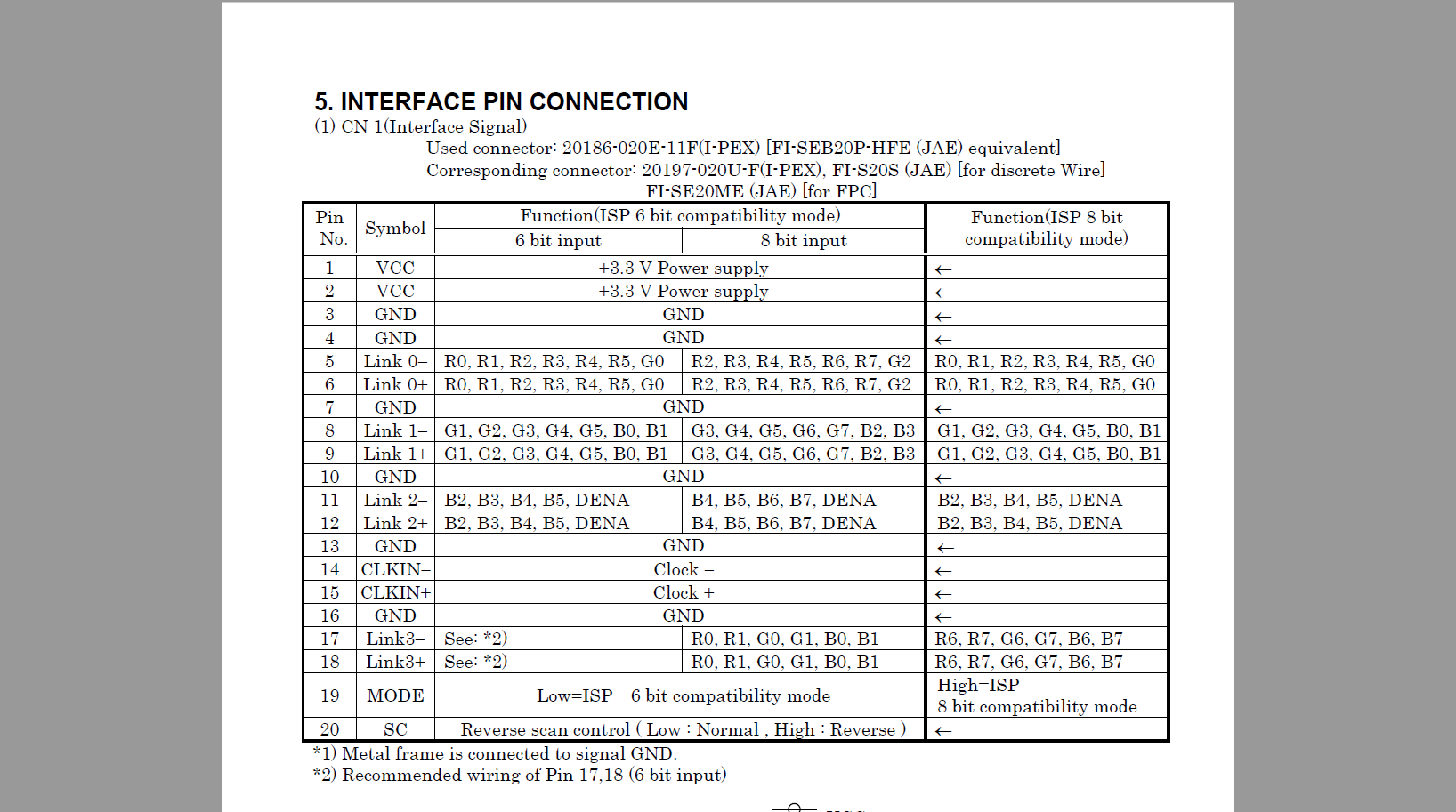

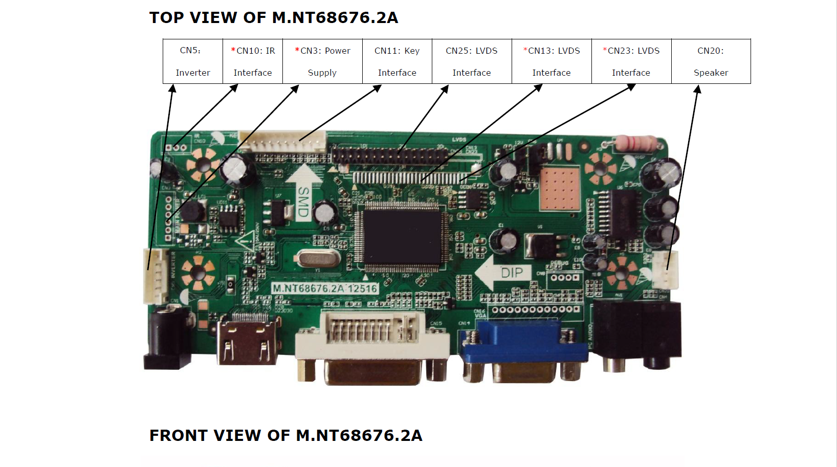

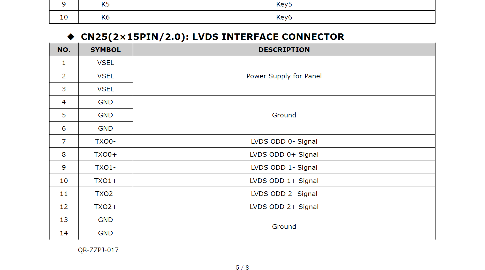

            Today I've taken a look at the datasheets of, both, the LCD panel and the controller board.
            Attached, you will find screenshots of the pinout for both devices (LCD and controller), taken from each datasheet.
            I've noticed that the cable which connects to the LVDS on the panel side, doesn't have two pins connected, which should be ground. Is that important, maybe not, since there are other pins which are ground.
            I have one doubt regarding the contoller's datasheet. What does it mean ODD and EVEN in each LVDS link - and +?
            Cheers,
            Pedro

                    I have been through both datasheets and tested the connections with a multimeter.
                    Everything seems to be correctly wired except for 2 pins, which should be GND/VSS but they are not connected. Actually, the pins don't exist in the connectors on both sides.
                    Please check the datasheets attached to this post. Maybe I have missed something.
                    Pedro

                      what are you talking about ?? if you follow the data sheet of both yours Panel can be connected to ODD pins..
                      don't use EVEN

                        What I was referring to can be seen on the picture attached. There are 2 pins missing in the connector and those pins are ground on the LCD side.
                        I am using ODD pinout, but still no working. I cannot see what can be wrong from the wiring point of view. :-(
                        Pedro

                          pins 7 / 19 / 20 no need
                          if the firmware match the lcd should display

                                The LCD only displays those vertical stripes shown on my first post.

                                      I have just tested the LCD again.
                                      1. Auto mode - nothing happens (vertical stripes visible)
                                      2. Entering factory mode - nothing happens
                                      3. Voltage in pins 1 and 2 of the lvds connector 3.3V ? - yes
                                      4. Connect computer to the board - computer detects display correctly
                                      When I connect the computer it is recognised with the correct resolution and I can even move the mouse out of my laptop's screen to the external monitor, but I cannot see the mouse pointer due to the stripes.
                                      The manual says that I should use a 12V and 3A power supply. However, I am using a 1A power supply. Nevertheless, for such a small monitor it should be more than enough. This board can be attached to 15'' display, so the 3A should apply to larger displays only.
                                      In summary, the display is detected by the computer, 3.3V are present and no matter what I do only coloured vertical lines are displayed.
                                      Tomorrow, I will put some LEDs in a breadboard to test the LVDS wiring.
                                      Let's see what I can find.
