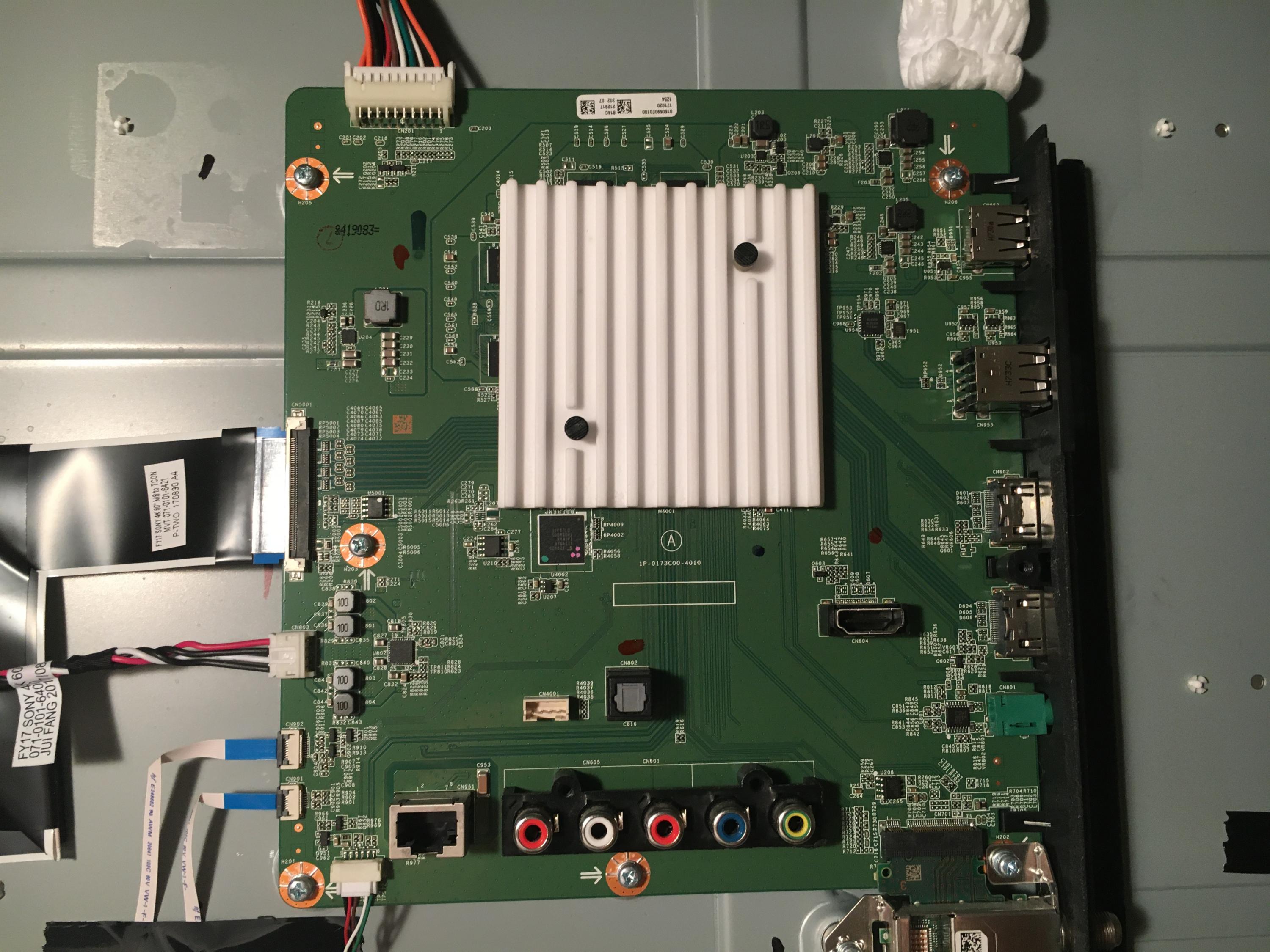

    I got an issue with 2 blinks on model KD-60X690E. Does anyone have the service manual?

    Re: KD-60X690E 2 Blinks
    2 blinks is usually a power supply fault.
        I replaced the main board and it fixed it. It was really odd because the service manual said it was the power supply

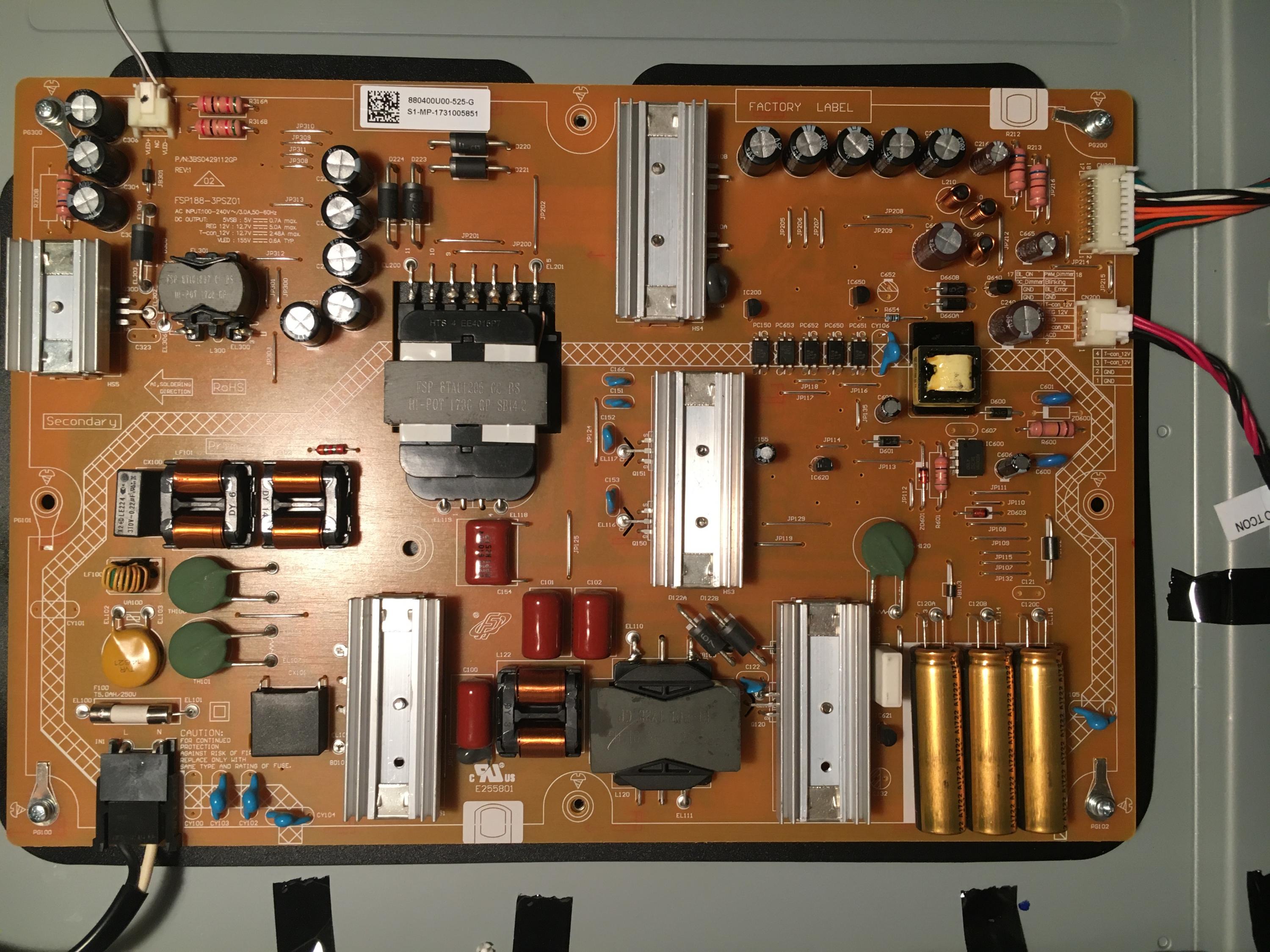

          HI I have the same problem with 2 blinks on model KD-60X690E. Does anyone have the power board schematic. no power to black light led. led ok
            What voltage do you have at BL_ON at connector CN200
            Do you have all the other supplies 5V and 12.7V
            What voltage do you have on the pins of CN306 as you power up. The voltage may shoot up and drop just as quickly.

                    Hi dick_barton Thank You for the quick reply. I have 5 volts standby on Cn201. Everything else did not have voltage; even the Acd on the set. I bypassed standby votage to Ps on and T/con on and Bl on with jumper wirers. Then I got 12 volts on T con Cn200 and all the 12 volt on Cn201. No voltage on Cn300 for back light and I have power on C306, C304 and C303 CAP. So what should be the volatage on ACd?
                      If you are testing the power supply them disconnect it from the mainboard. Use a 1K resistor and connect between the 5V standby and PS_On and a second 1K resistor between 5V standby and BL_On and see if the backlights come up
                      What voltage on C306, C304, C303 ?
                        i have 118dc on my meter. but nothing on cn300
                          What's the voltage rating on those 3 capacitors.
                            Also
                            I see that the positive connection of those 3 capacitors connect to CN300 so I don't understand why you say you have no voltage at CN300
                            The backlight is made up of 10 strips (5 type A and 5 Type B) each having 5 leds per strip so a total of 50 leds
                            If the leds are 3V type then the 155V @ 0.5A as written on the power supply would indicate they are all connected in series (50 * 3.1V = 155V)
                            The 118V that you measure would seem to indicate that the BL_ON has not been activated to boost the supply up to the required 155V
                            or that you have an issue around the led driver or an led fault.
                                the cn300 is control by q301 on the ground side i dont have gate volt on q301 118v is low I will check on that supply tonight. i need schematic. do you know where can i buy or download it.
                                  There could be no gate voltage for a number of reasons.
                                  Faulty mosfet, faulty led driver IC, or led driver IC not enabled ie no BL_On asserted.
                                    I got a main board from ebay fixed the problem nothing wrong with the power board
                                      Well you got there in the end which is good.
                                      I wonder if your original main board was not sending the backlight enable signal to the backlight control / led driver circuit.
