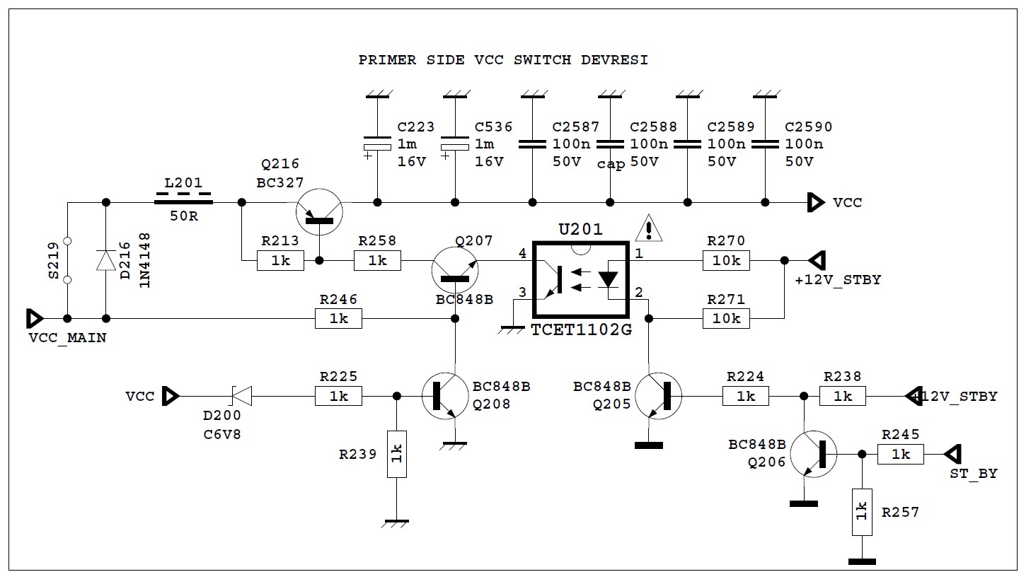

    Re: Toshiba 48L3451DB dead 17IPS20 Rev6 psu
    Sorry, I mixed up two threads.
    If the supplies come up when pin 1 & 2 of the opto U201 are lifted then I would check the voltages on Q205 and Q206.
    Something is turning on the Opto-isolator when it should be off.

      Theres 12v at R270/271 and 12v at R238 (briefly before they drop out) , nothing on R245 St_by.
      Q205 E 0v, B 0.6v, C 0.06v
      Q206 E 0v, B 0v, C 6v

        Can you connect a 1K resistor between ST_BY and +5V_STBY and then do the same test again

            I've just been looking back through this thread. Earlier you said that you did not have the +5V_STBy. Is this still correct?
            Q212 should have +12VCC on the collector and something like 6.8V on the base and 5V on the emitter. Can you check the voltages are there.

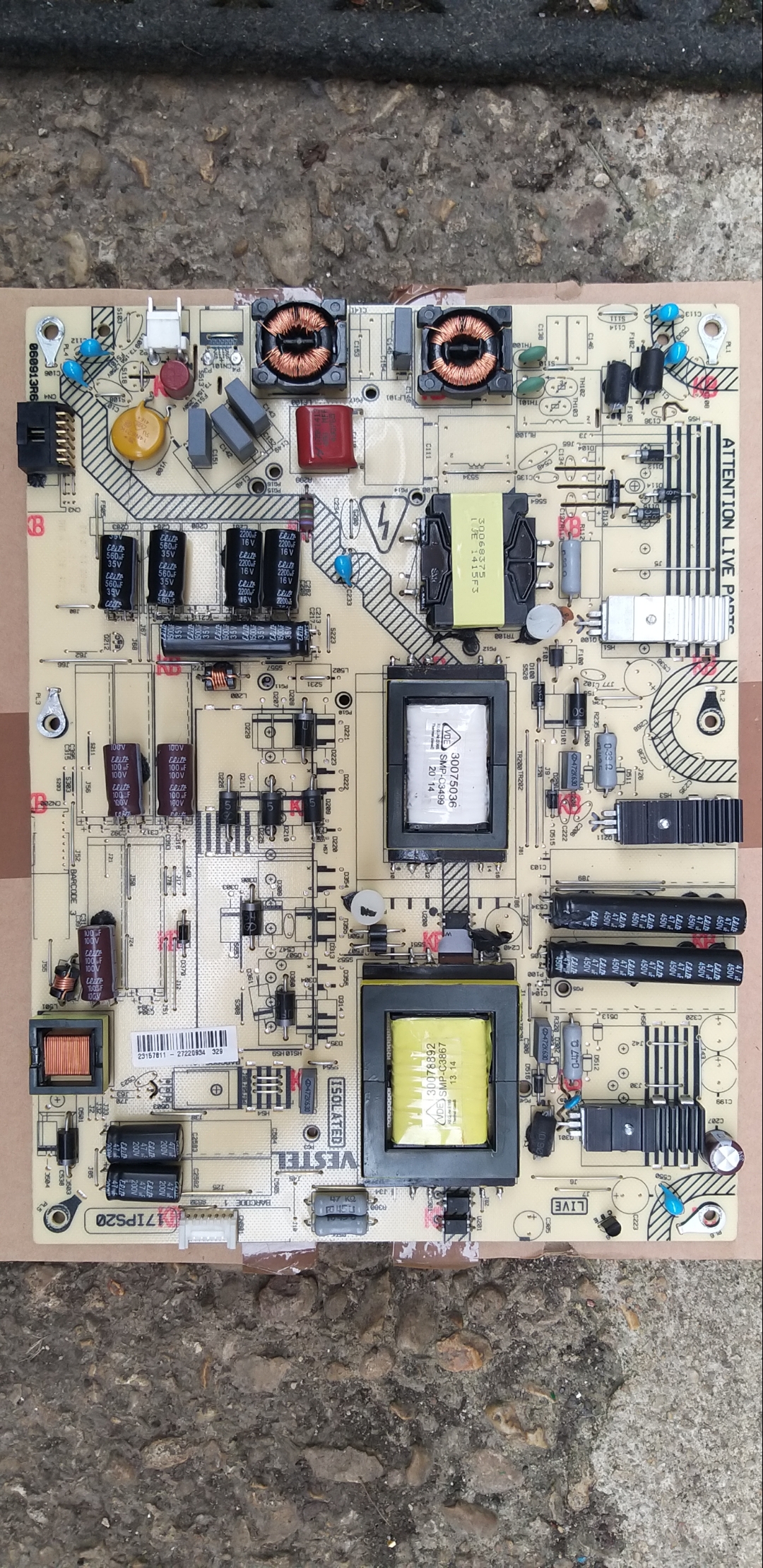

                      Can I see good clear hi-res straight shots of the whole top and bottom side of the board? Your pictures in post #1 are cutoff.
                      BTW, the schematic is the master schematic for making blank PCB, so some of the parts may not be installed for your PCB Assembly.

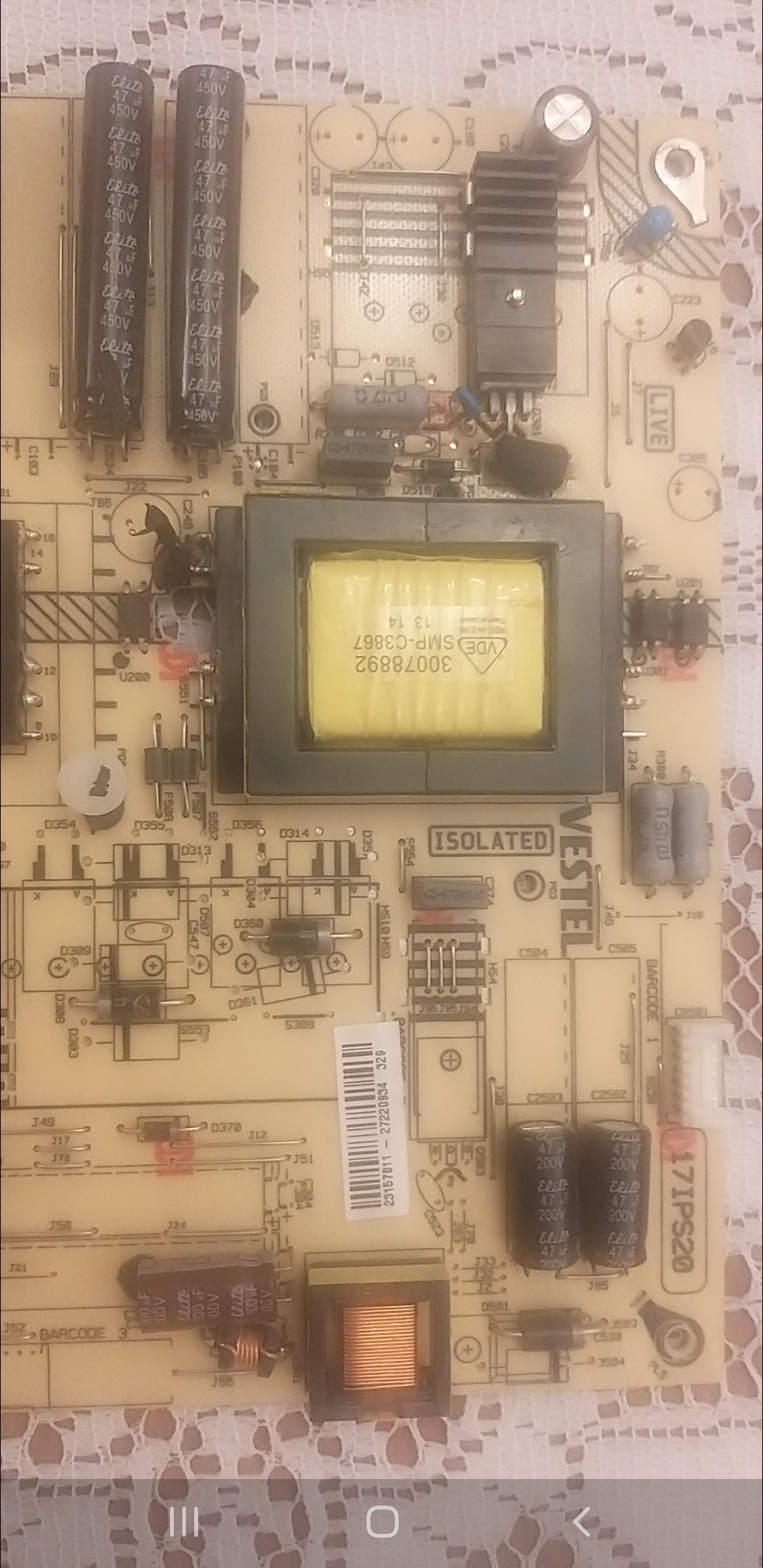

                        #31
                        Poor lighting at the moment but hopefully are good enough.

                          My post #30: "Can I see good clear hi-res straight shots of the whole top and bottom side of the board? Your pictures in post #1 are cutoff."
                          This in post #1 shows full top side of the board but too blur to read the part designators.
                          https://www.badcaps.net/forum/attach...2&d=1593464768

                              BTW, if you look at the schematic, you will see that the ST_BY (PS-ON) is active low not active high.
                              Bad part about Vestel board is that we need to find out what parts are installed and not installed to compared it to the schematic.

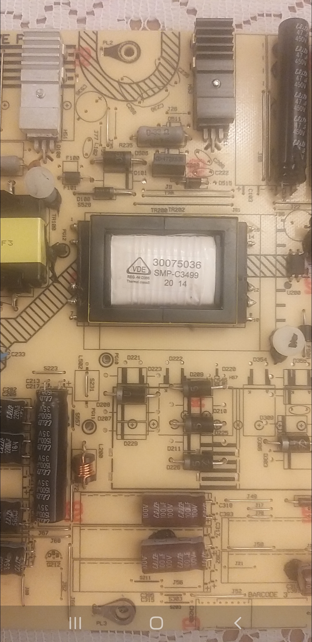

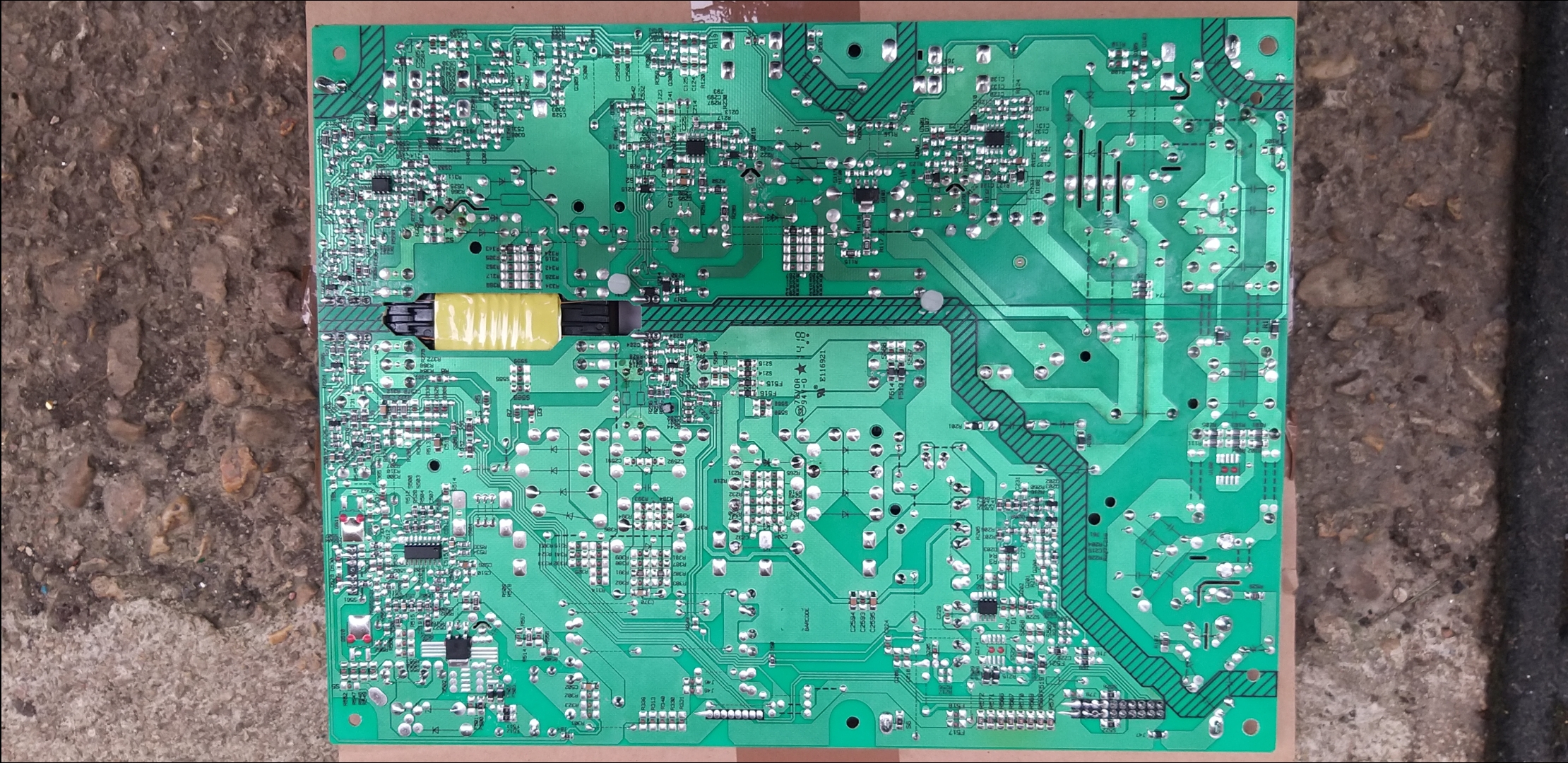

                                #35
                                Hope these are better.
                                  The problem here is that with pins 1 & 2 opto-isolator (U201) lifted the the 12V and 24V supply come up (post #16).
                                  This would indicate that the opto-isolator led must be off for this to happen and therefore Q205 must be switched off to achieve this. Taking ST_BY high switches on Q206 which removes the base drive voltage for Q205.
                                  What's confusing is that this appears to contradict what others say.
                                    Ok, just to confirm.
                                    With U201 opto Pin 1 & 2 lifted out of circuit there is def a steady 12 & 24v rail.
                                    This is with the main and backlight removed.
                                    With just the backlight connected the 12 & 24v rails remain, no backlight.
                                    With just the main connected the 12 & 24v rails drop in and out again.
                                      I cannot see how that PNP Q216 is turned on if U201 LED side is lifted since the Base current for Q216 needs to flow through R258 (1K), Q207, and U201 (pin 4 -3) to ground.
                                      If the VCC output is too high then the Zener diode D200 will conduct and turns on Q208 which will turn off Q207 in which turns off Q216 and repeat in cycle as long as ST_BY is low.
                                      I wonder if the schematic matched your board.

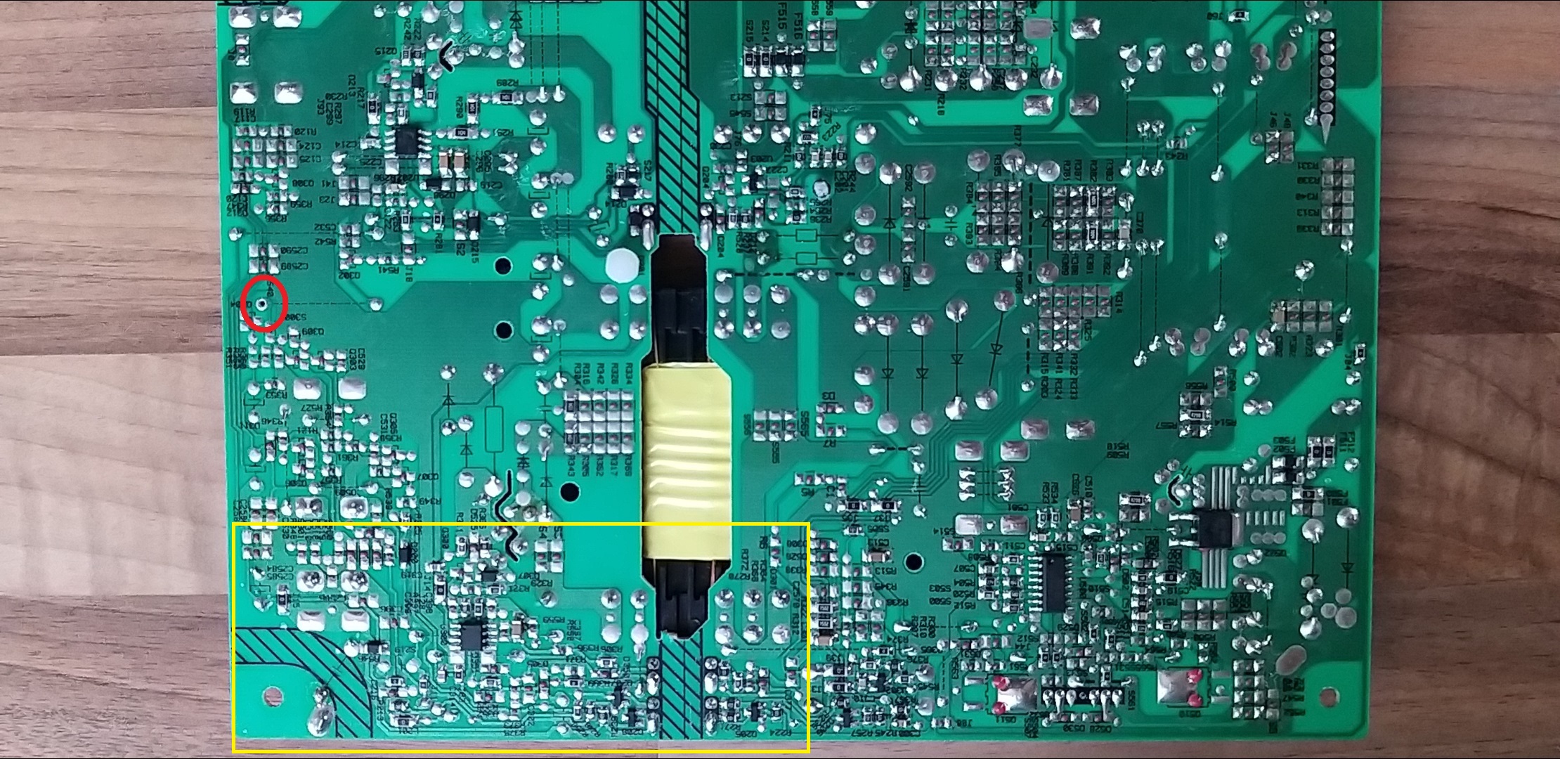

                                          Is there a link unsoldered or missing (Red circle) ???
                                          Could you post a photo of the circuit within the yellow box in focus.
