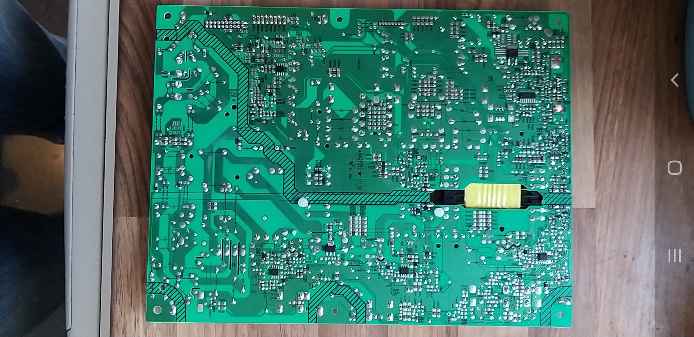

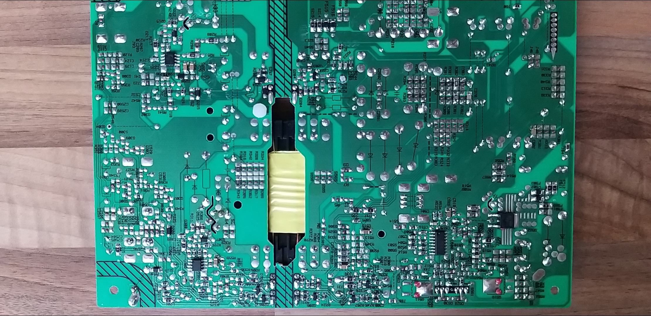

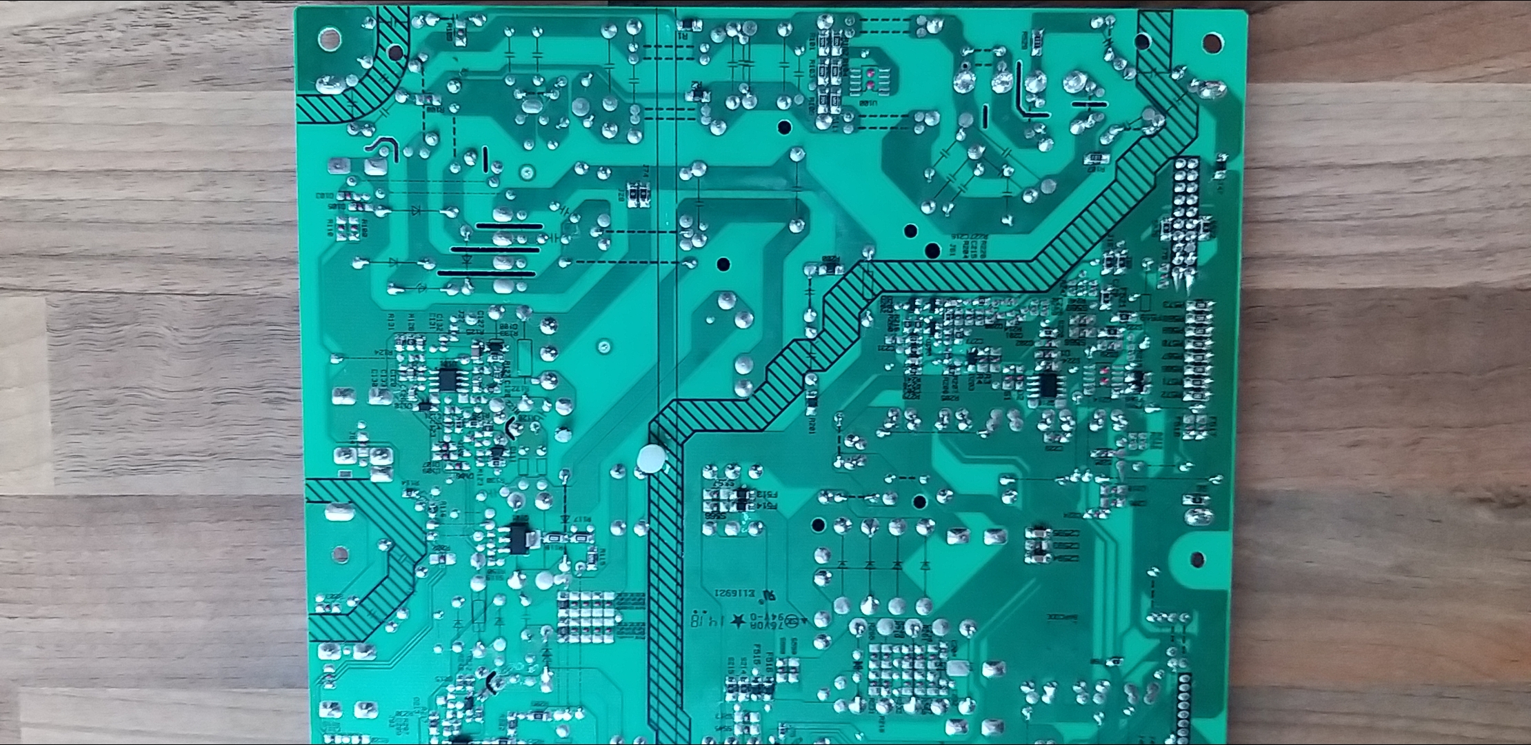

    Toshiba 48L3451DB dead 17IPS20 Rev6 psu
    No front stby light.
    With backlight and main bd disconnected only getting fluctuating voltages that drop out almost straight away on CN4, none appear to ramp up to the correct voltage, drop out almost straight away. It seems to be a 6 second constant restart loop.
    U300 & U202 Fan6300A
    U101 FAN7529
    Not sure these are related to my problem but thought I would mention them.
    340v across C110 goes up and down a little.
    Not getting the constant 12v or 24v.
    Checked all the 0 ohm resistors, all ok.
    Checked diodes, seem ok but a couple need double checking as reading same both ways.

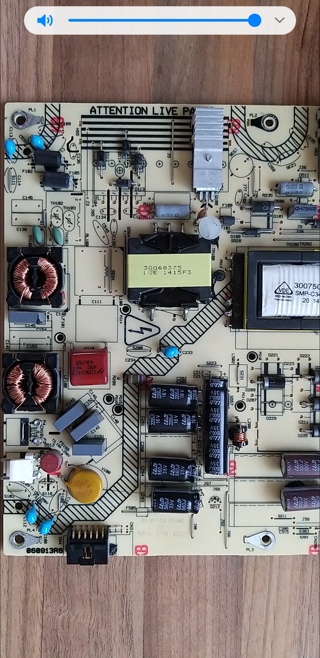

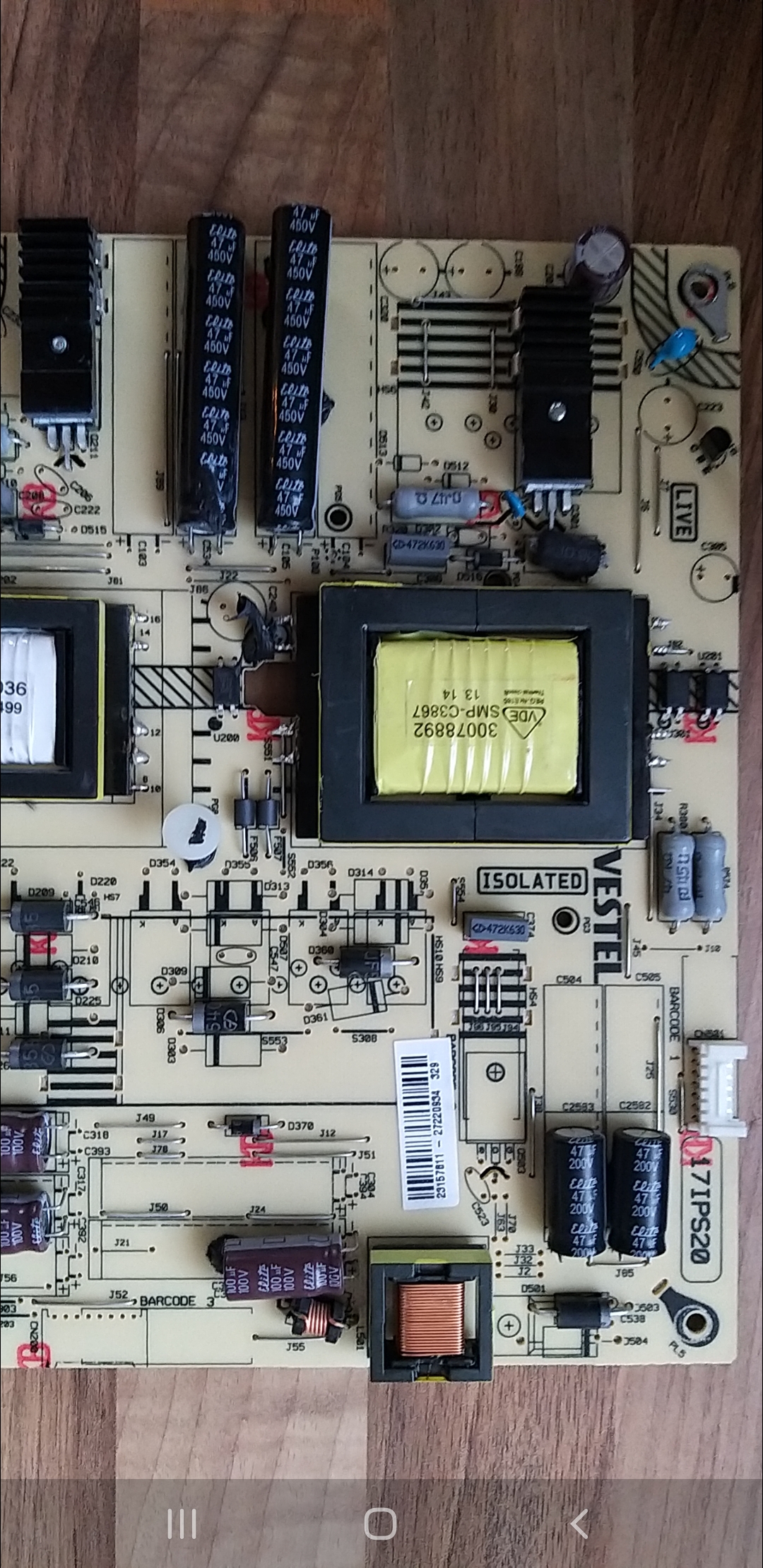

    Re: Toshiba 48L3451DB dead 17IPS20 Rev6 psu
    What voltage do you have across the legs of C105?
    Do you have the +5V_STBY ?
            C105 is one of the two large capacitors side by side.

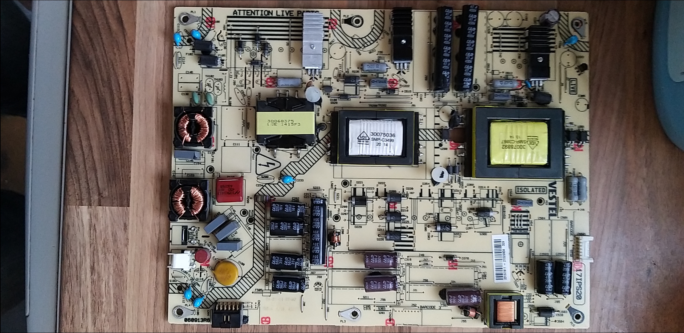

                                      I've been searching the forum for this power supply and I think that this is an "always on" power supply so with U201 replaced it may well now be working. Remove the 1K jumper resistor and check for 12 & 24V supplies.
                                      • notallbad
                                        • Oct 2012
                                        • 1190
                                        Replaced U201 and tried back in tv but still nothing.
                                        Can't find the 1k res, the board is different to the sch provided above. Some differences as I'm sure your aware with these boards and schemas.
