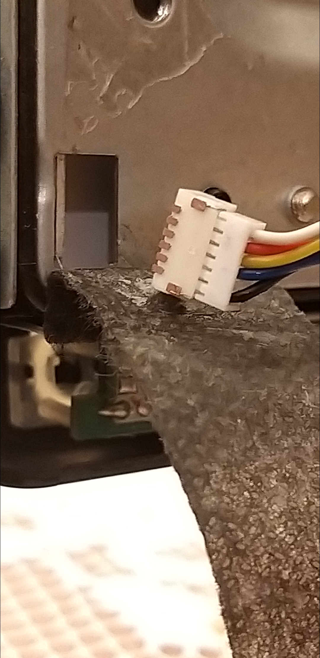

              So, this is new!
              Peeled back the tape to discover the led connector broken off so looks like the panel needs to be disassembled to solder the socket back on for starters.
              At a guess black - common gnd
              blue,yellow, red & white - vcc

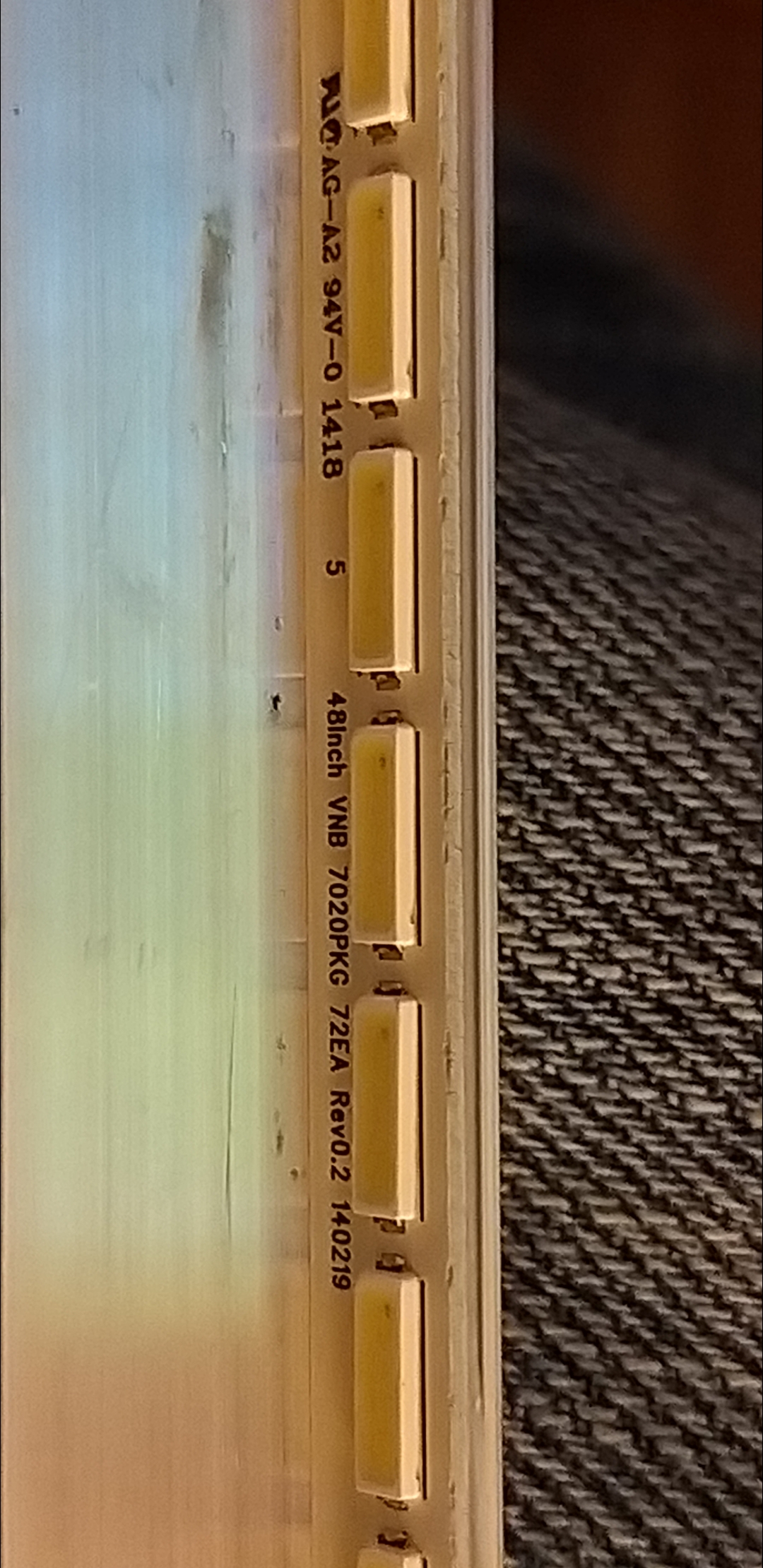

                • notallbad
                  • Oct 2012
                  • 1190
                  #88
                  Re: Toshiba 48L3451DB dead 17IPS20 Rev6 psu
                  72 led edge lit panel
                  Black is (+)
                  blue, yellow, red & white are (-)

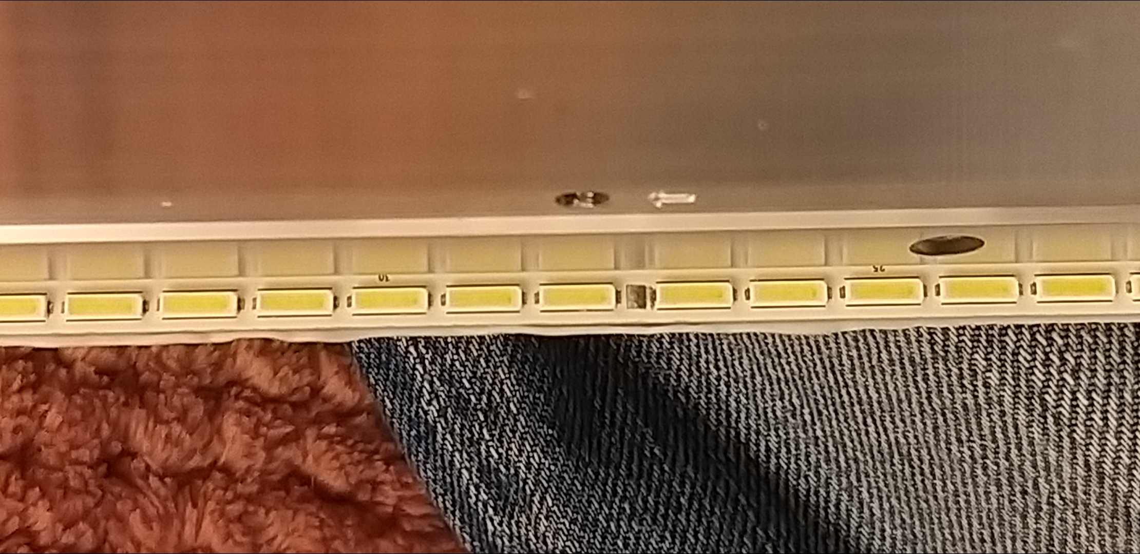

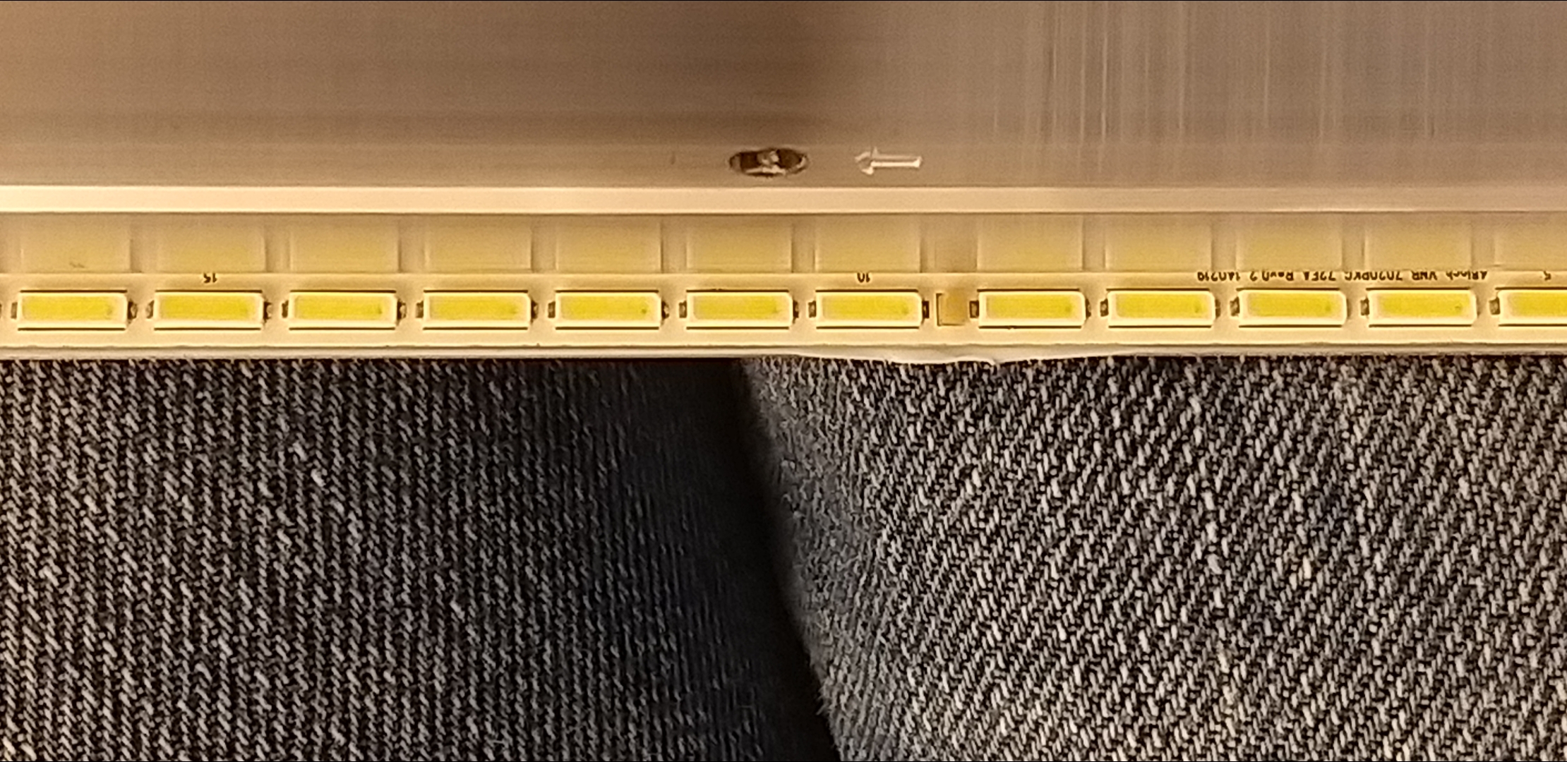

                      beginning to wonder now if its going to be worth it, obviously this has been stripped down before, signs of mistreatment, rounded off screw heads, broken plastic trims etc...
                      thanks, I'll try and get leds sorted first and go from there, perhaps revert back to the original power bd.
                      Meanwhile, what are the separating 'components' between the leds, light sensors?one has fallen off.
                      Each line drives 18 leds. 102v reading on led tester on all 4 banks. So 6v leds.
                      • diif
                        • Feb 2014
                        • 6978
                        • England
                        #91
                        It's a rubber spacer to stop the big plastic panel crushing the LEDs.
                        • notallbad
                          • Oct 2012
                          • 1190
                          #92
                          doesnt feel like rubber and its soldered on
                          • diif
                            • Feb 2014
                            • 6978
                            • England
                            #93
                            My mistake, hard plastic.
                            • notallbad
                              • Oct 2012
                              • 1190
                              #94
                              Sorry, I didn't mean to question/doubt you, just odd that its soldered on. The tab its soldered too does not appear to be connected to anything. And it is a single tab on closer inspection.
                              thank-you
                              • diif
                                • Feb 2014
                                • 6978
                                • England
                                #95
                                Its a single pad that's not connected to anything it can't think of anything else it can be.
                                The other one looks flush to the PCB, are there any more ?

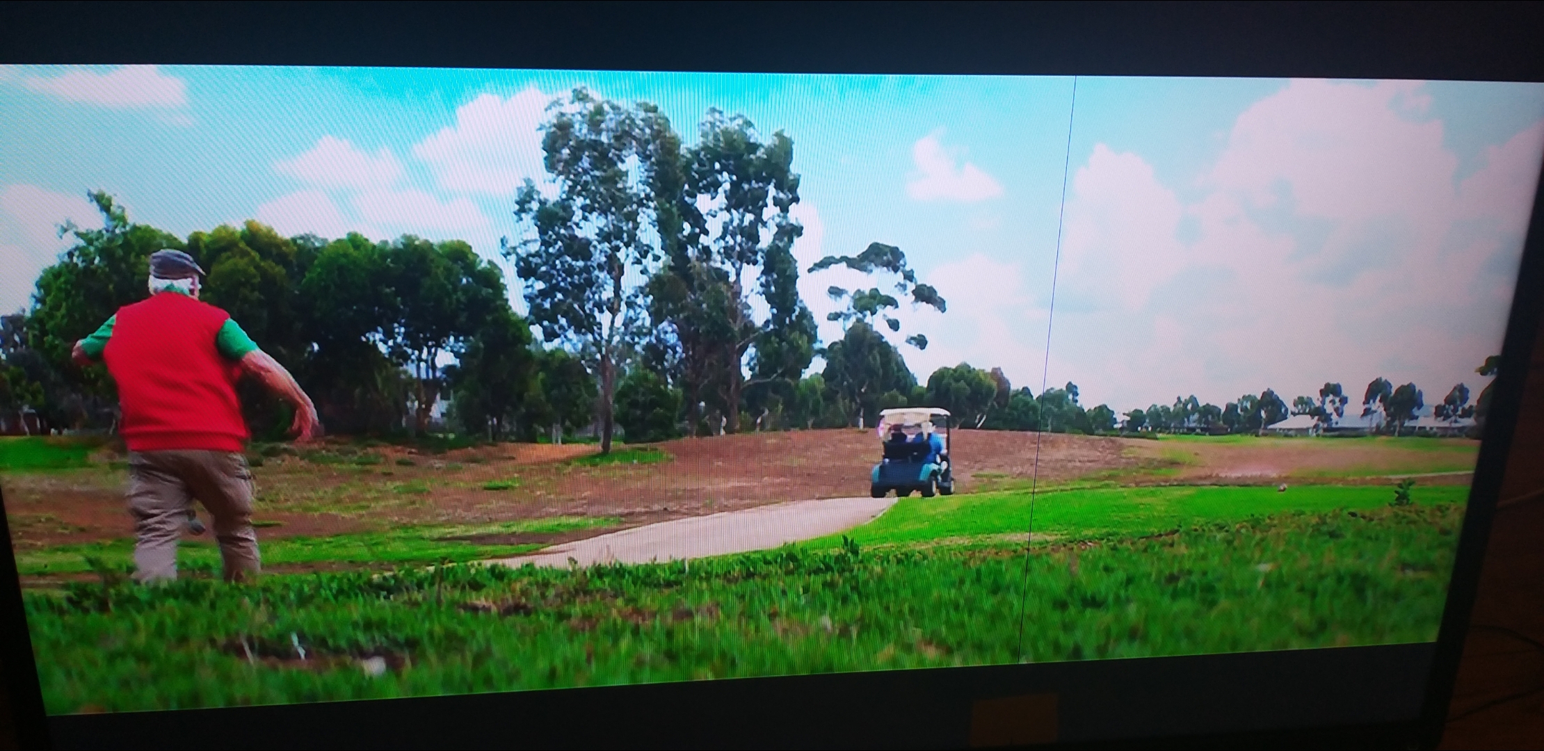

                                          Update:
                                          replacement backlights ordered, received and fitted
                                          TV now working but bugger me theres now a thin blue line down the screen! wot a nightmare this tv has been.
                                          Any helpful suggestions?
                                          Its going to be another strip down and part out job I think.
