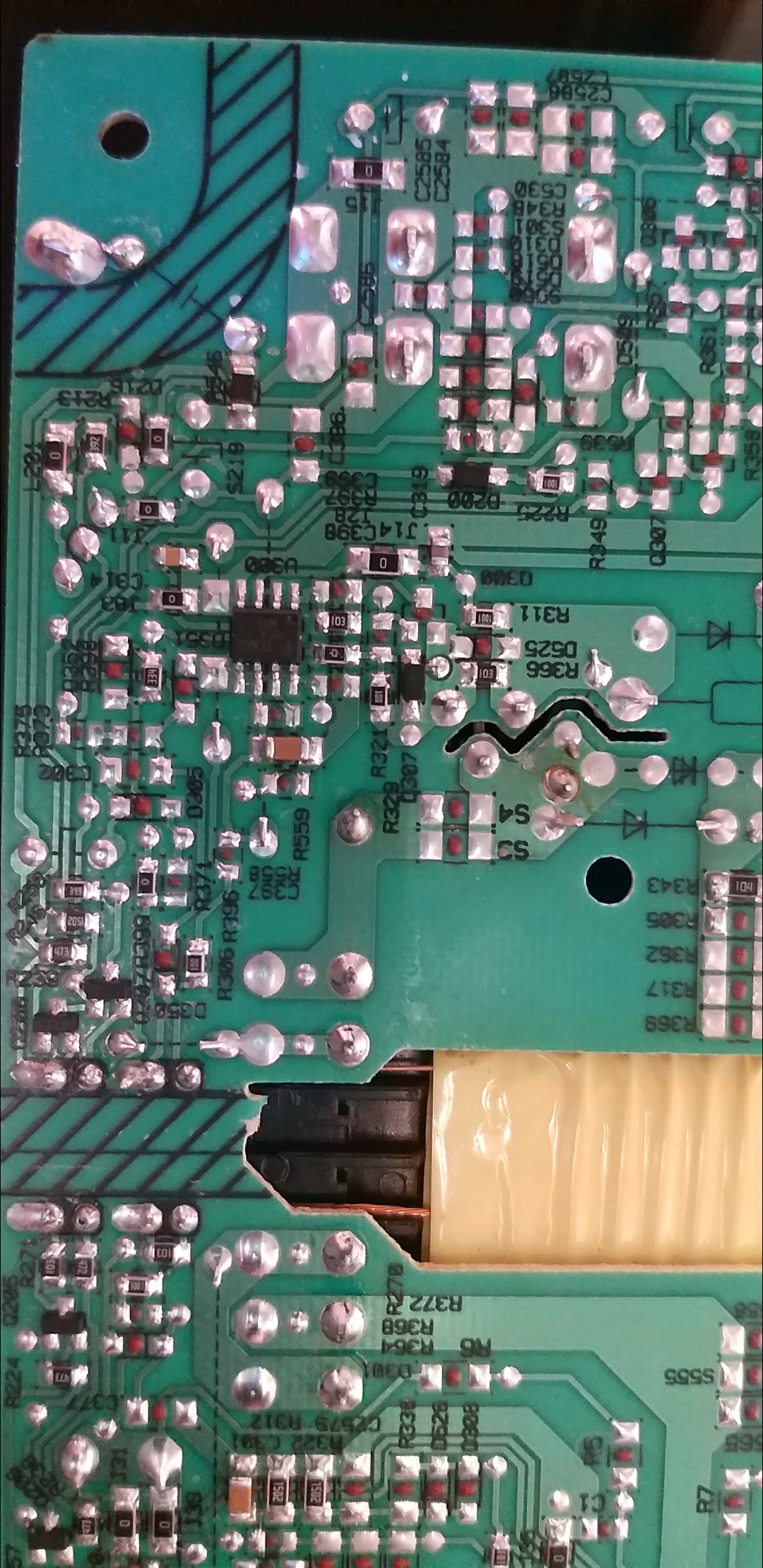

    here you go!
    • notallbad
      • Oct 2012
      • 1190
      #42
      Re: Toshiba 48L3451DB dead 17IPS20 Rev6 psu
      Correct, no J19 jumper. red circle.

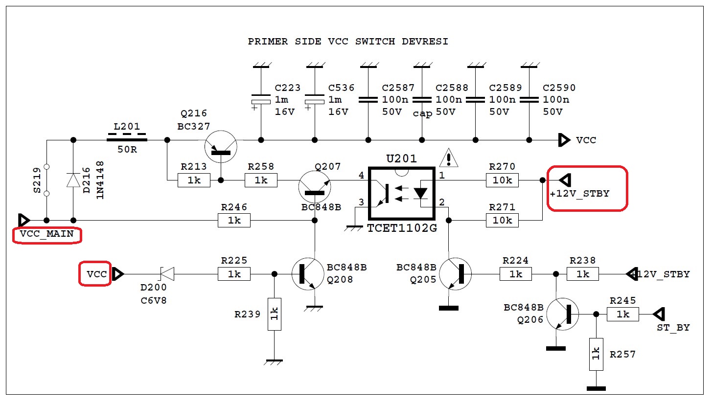

        Although the component values do not match the schematic the layout looks identical.
        Budm was quite correct that the power supply should power up when disconnected from the main board i.e the 24V and 12V should be available at the connector without the need to provide any other signal. Just like Budm I cannot see how the supplies come up when pins 1& 2 are lifted.
        I have run a simulation of the circuit and the opto led definately needs to be switched on for Vcc to become available.
        With the power supply still disconnected from the main board and the opto in place what VCC_Main, +12VCC and VCC do you have. Pin1 of U201 looks like it's not quite soldered back in place.

          Opto soldered back in.
          Psu disconnected.
          VCC_Main at R246 - around 9v goes up to about 16v and drops
          +12VCC at R270/1 - goes up to about 12v but drops
          VCC at D200 - around 9v, goes up and down to about 12-14v
