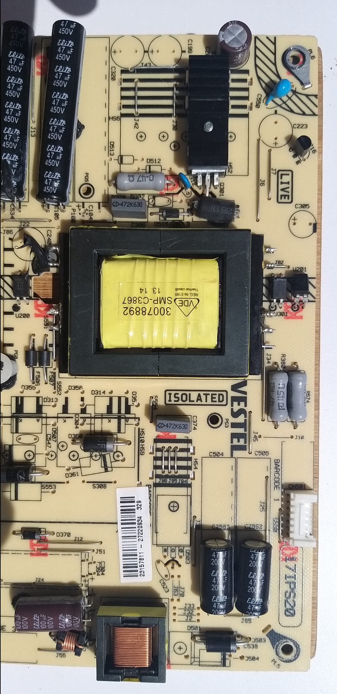

Toshiba 48L3451DB dead 17IPS20 Rev6 psu

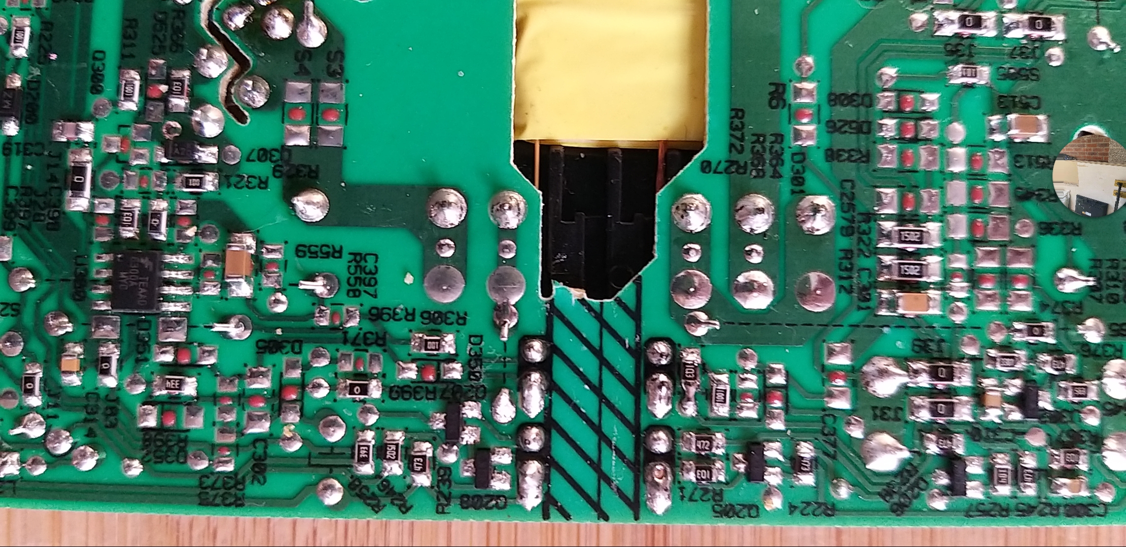

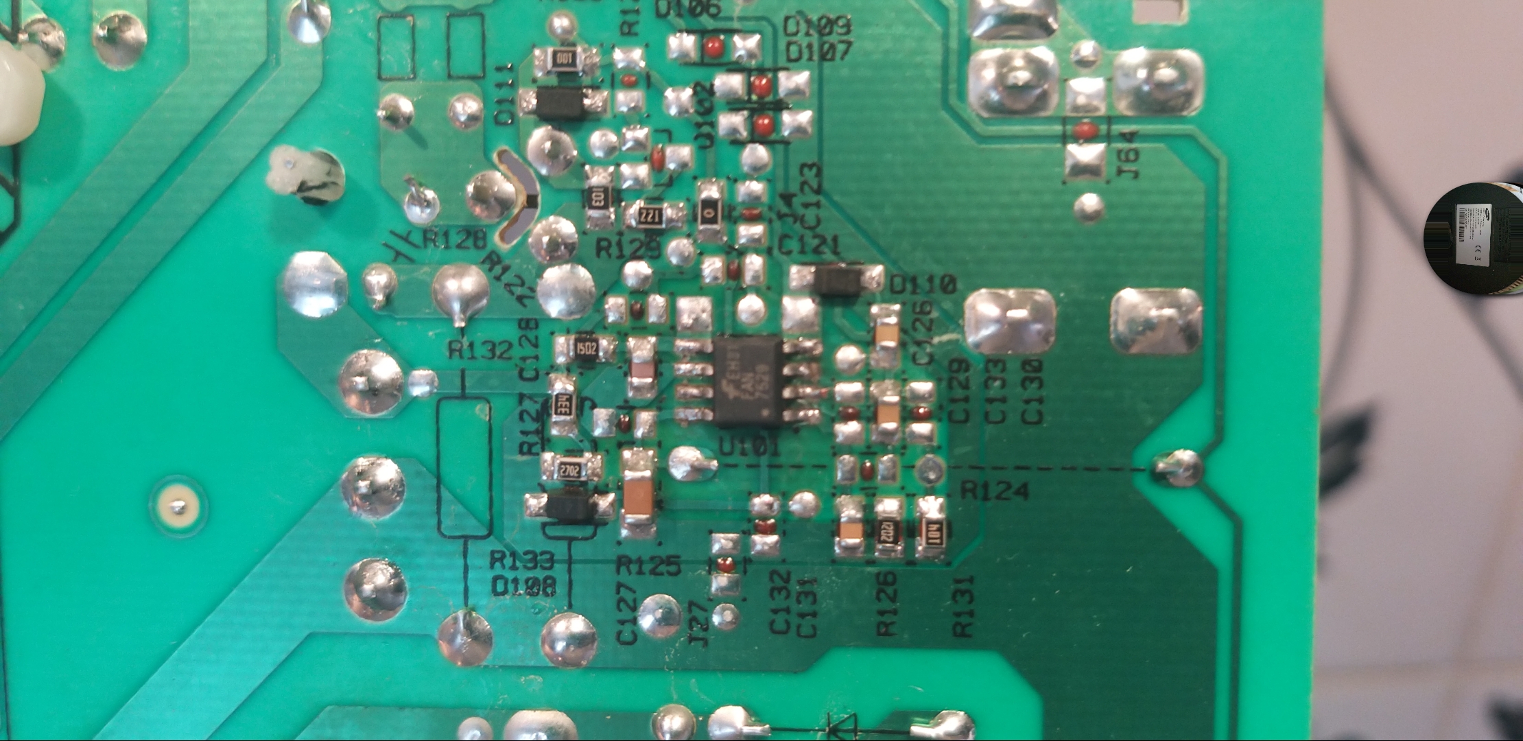

    Replaced the Fan7529 ic but still just getting the 5v, 12v and 24v ramping up then dropping out.
    Reading across the main cap C110 just sits at 335/6v.
    It's C105 you need to check the PFC voltage across.
    Can you post a picture of the solder side area around the Fan7529

        Again it's attempting to but failing to start. Can you check the solder joint on pin 8.
        I would double check all the solder joints in that area since you did get it up and running the first time you changed the IC so I'm suspecting a poor joint.

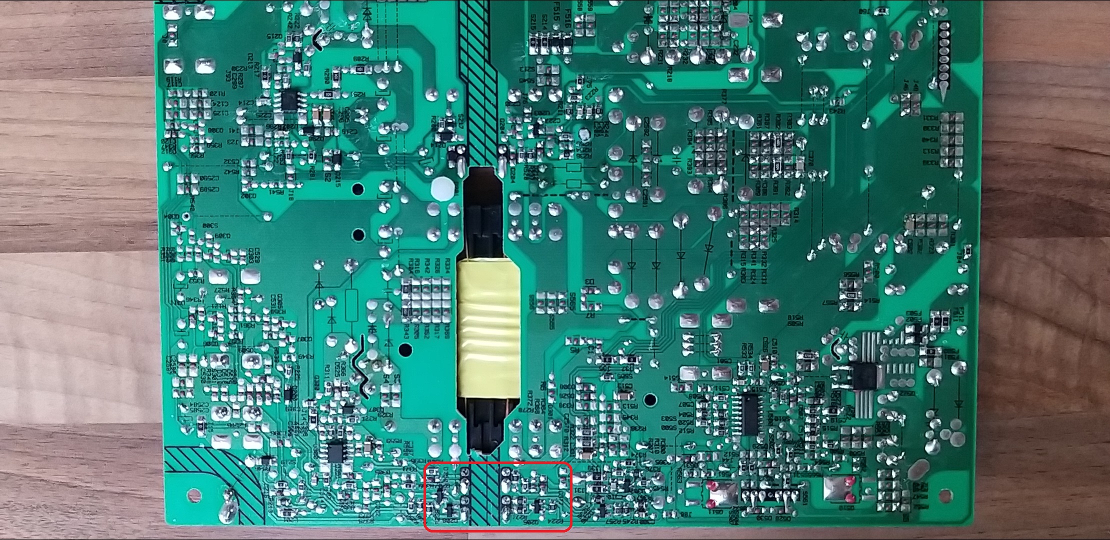

                Can you post a photo of the area around U201 topside and bottom
                Edit,
                I remember you already have posted a photo of the underside but it's a little difficult to follow the tracks so if you can get a sharper image would be good.

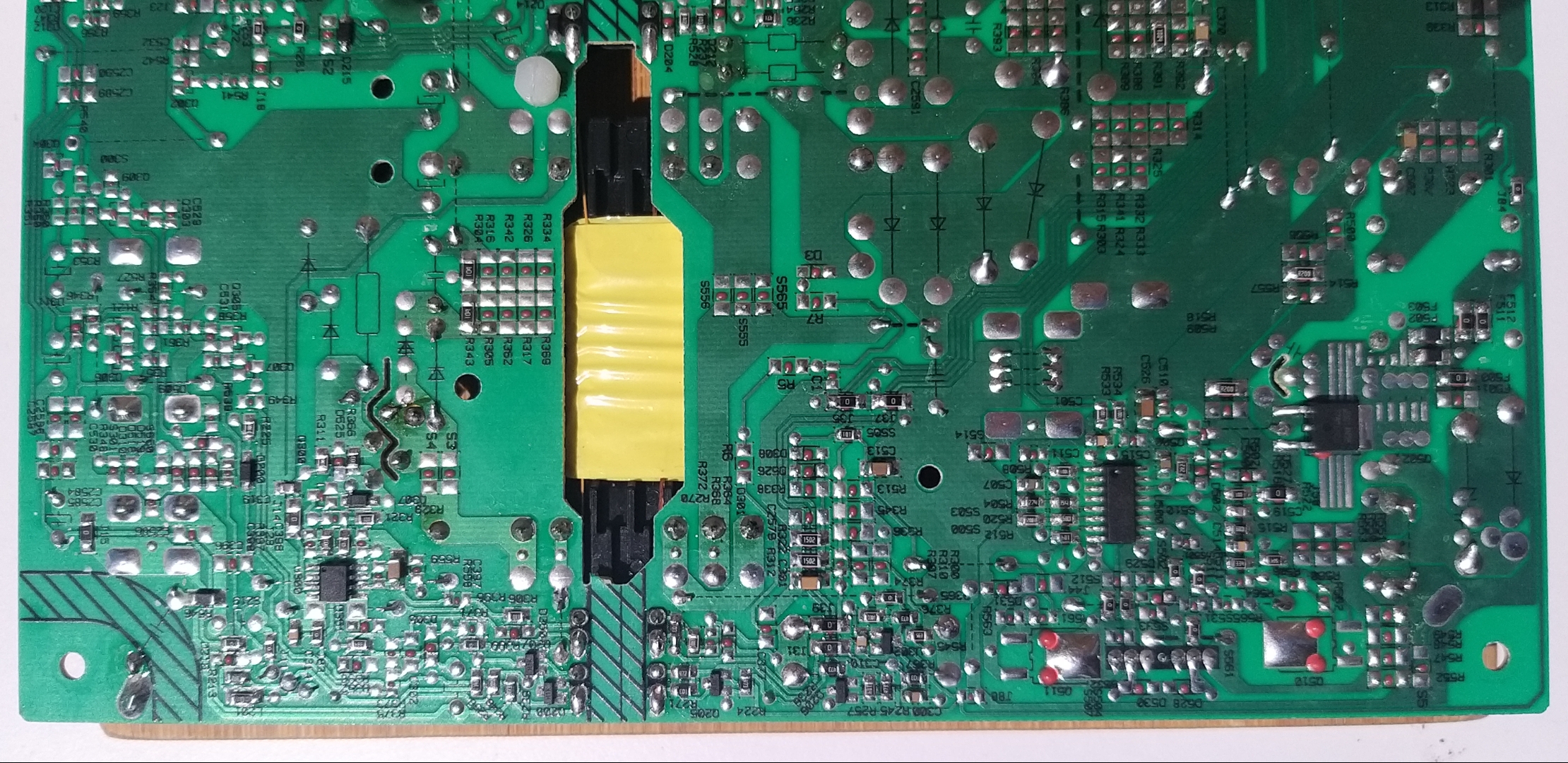

                  #68
                  Re: Toshiba 48L3451DB dead 17IPS20 Rev6 psu
                  Hopefully these are better.
                  • dick_barton
                    • Aug 2015
                    • 6643
                    • Wales
                    #69
                    Can you focus more on the area in the red box.
