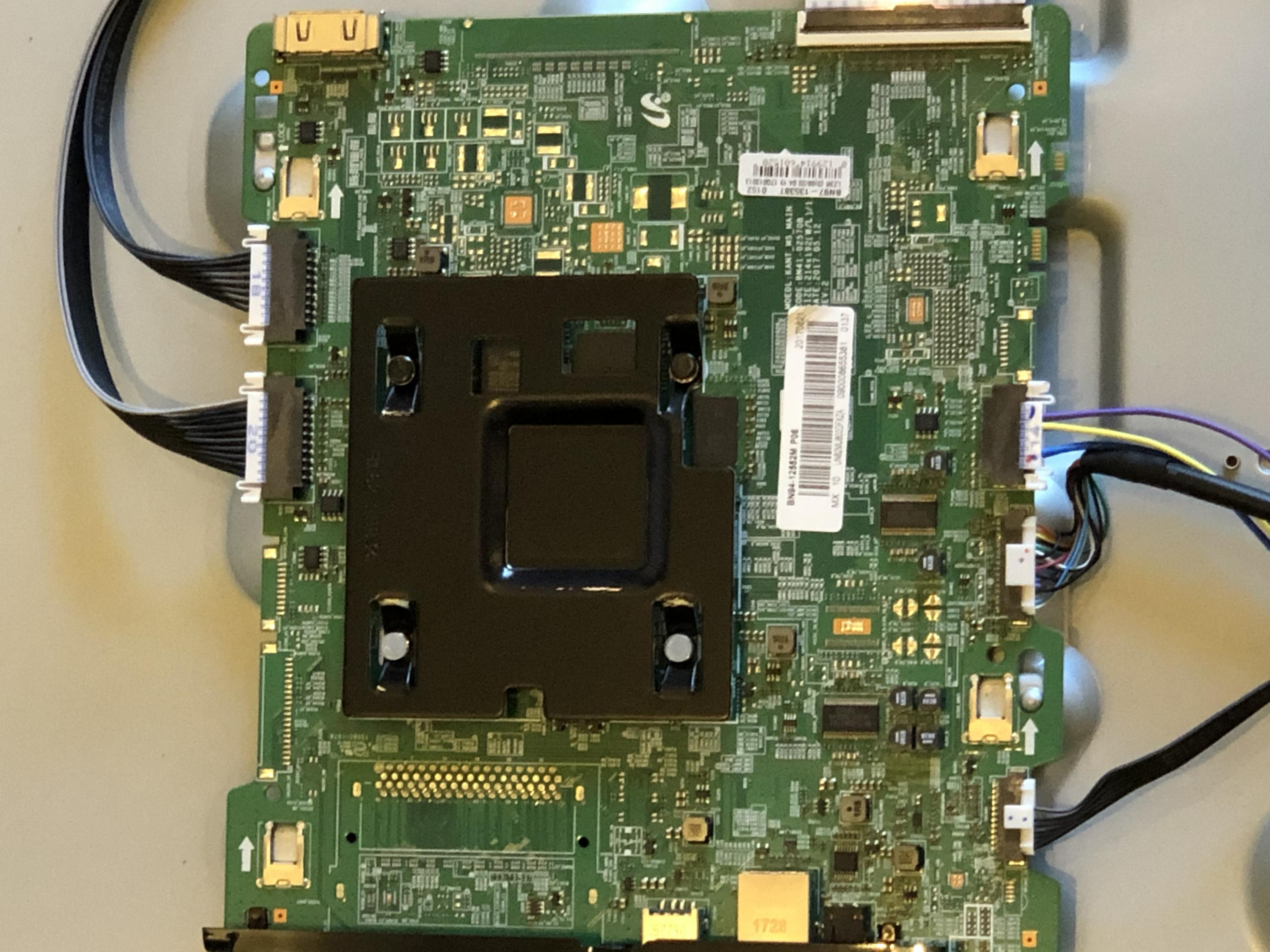

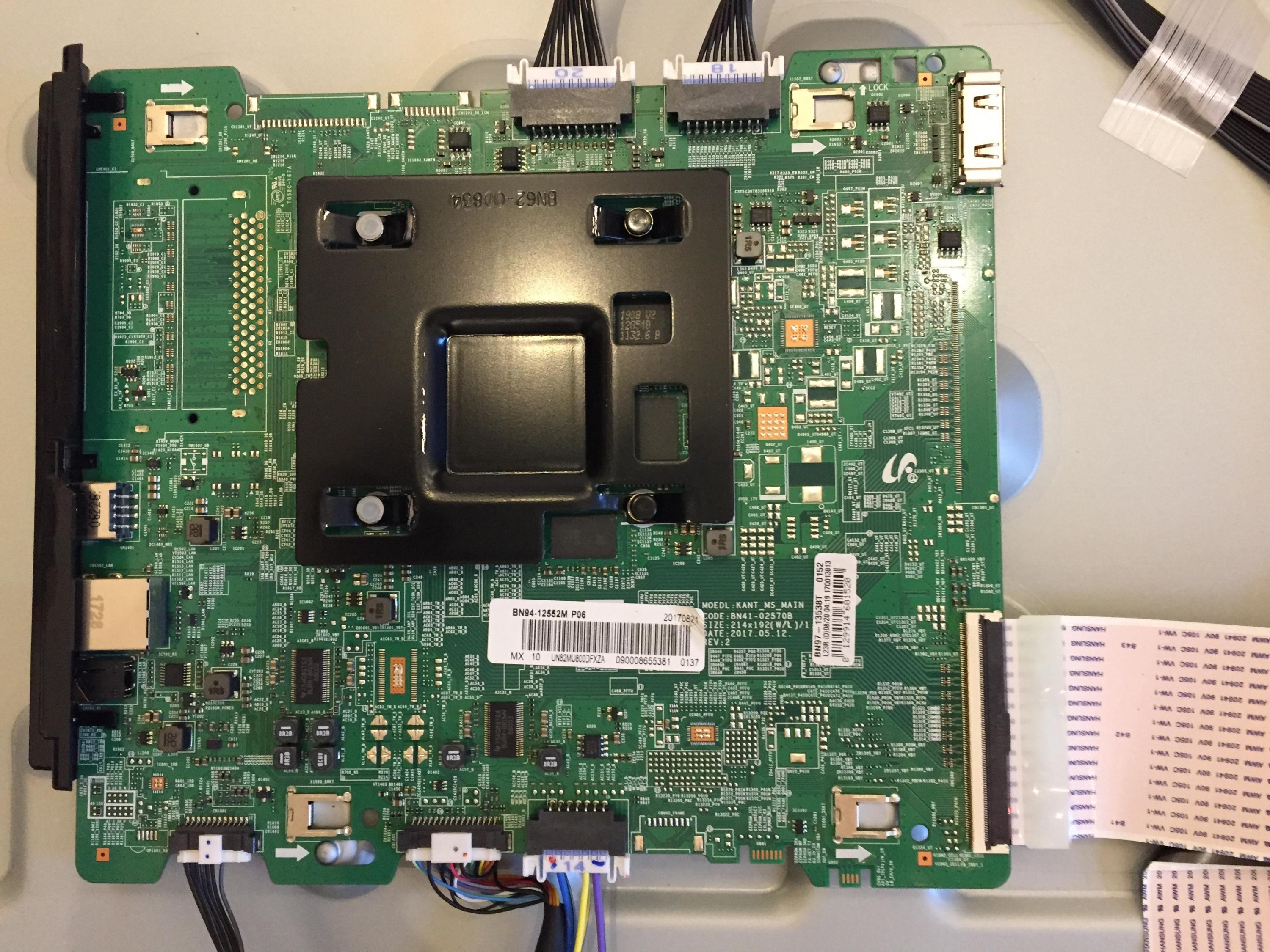

    Hey Everyone!
    I am a newb when it comes to fixing televisions. Please forgive me if I don't include all the details necessary.
    I have a Samsung UN82MU800DFXZA television. I have taken off the back of the tv and can see that the lights are in fact on producing a white light, but front of the tv shows a solid black/bluish color. Did a flashlight test and see nothing. The sound is crystal clear when I put on a station.

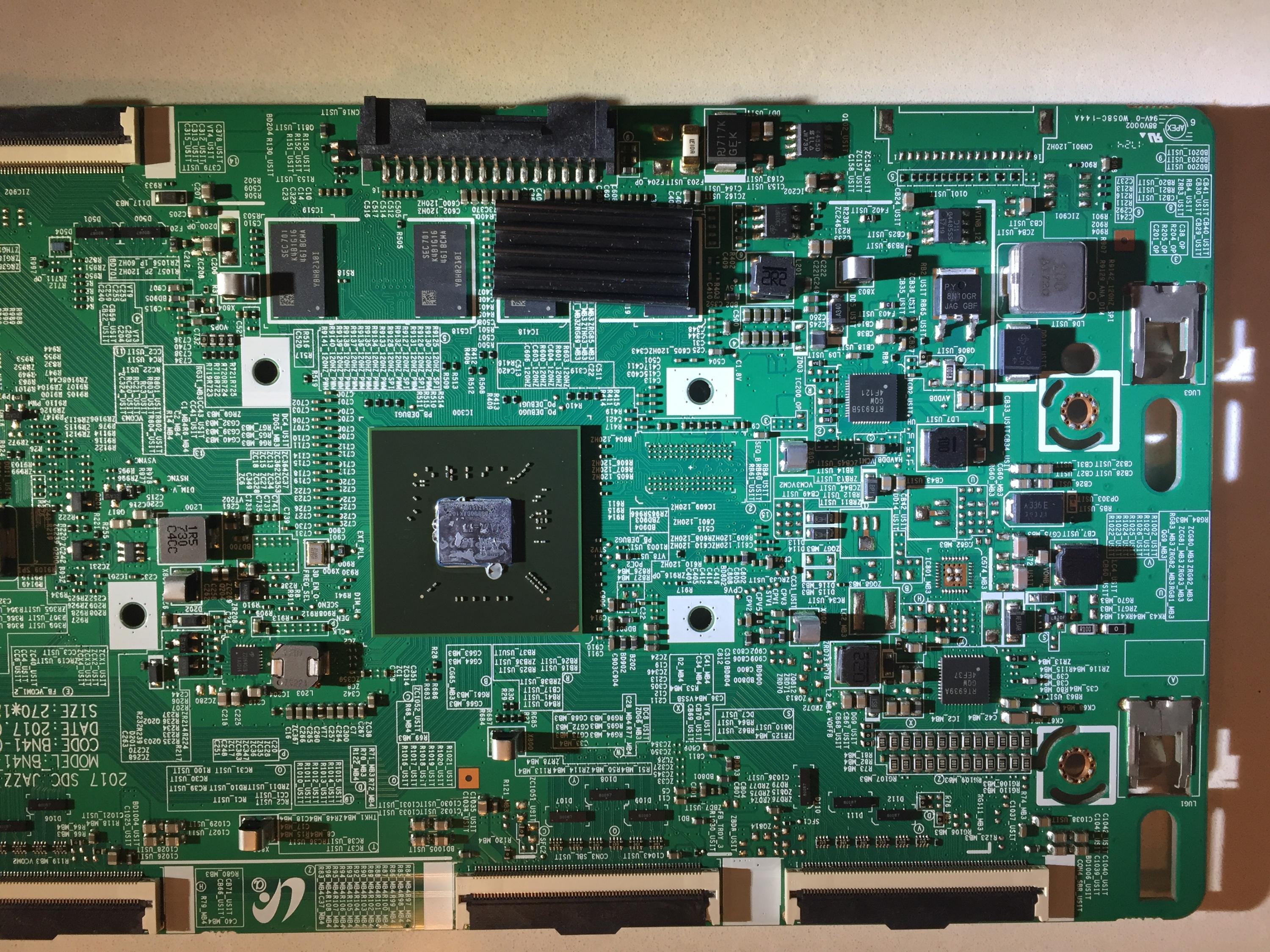

    After watching a few videos I figured I would order and replace the TCON board. This didn't fix the issue. At the same time, the board I bought maybe bad. I am very new to testing and diagnosing a tv and not entire sure on how to use a multimeter (when to switch it to which icon), but I'm attempting to learn as this TV was costly. Plus the more you know! Right?
    Any diagnosing help would be greatly appreciated. I want to rule out the 3 components, but I am not sure how to tell if the T-Conn unit I bought is even functioning properly.
    Thank you

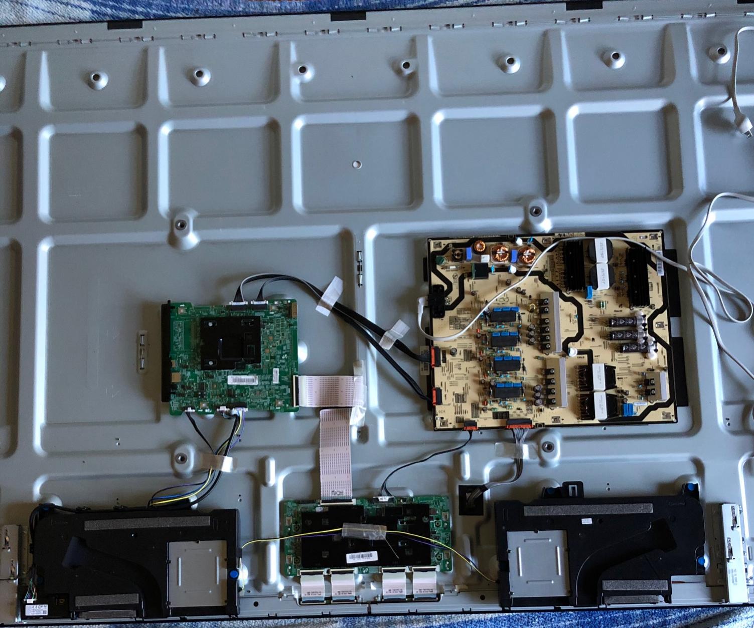

    1) Please attach good clear pictures of the whole back side of the TV showing all the boards using 'GO ADVANCED'.
    2) Did you verify that you do have 12V DC at both ends of the T-CON fuse with ref. to chassis ground?

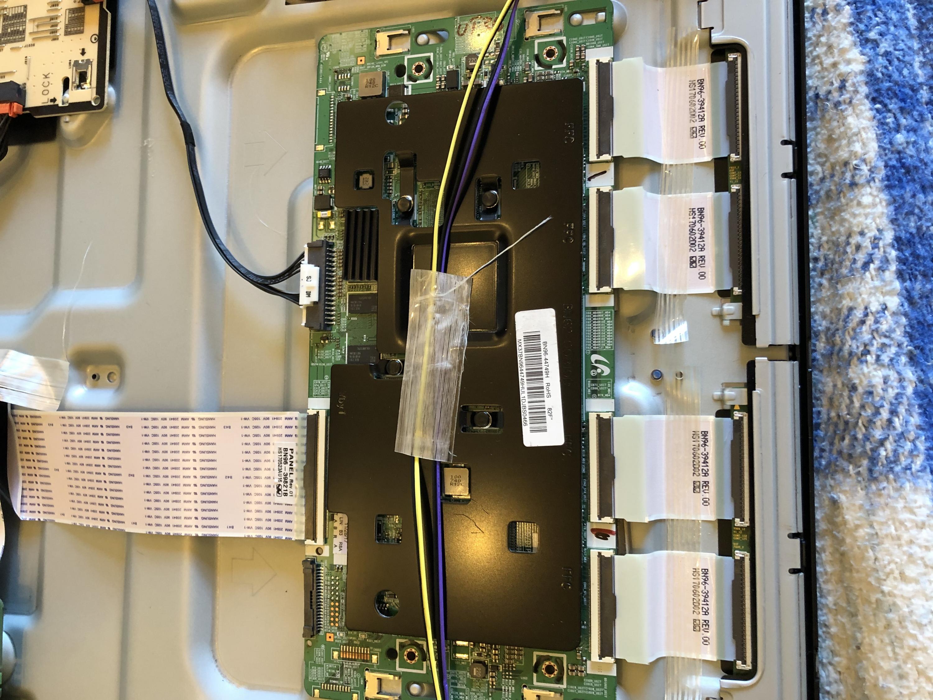

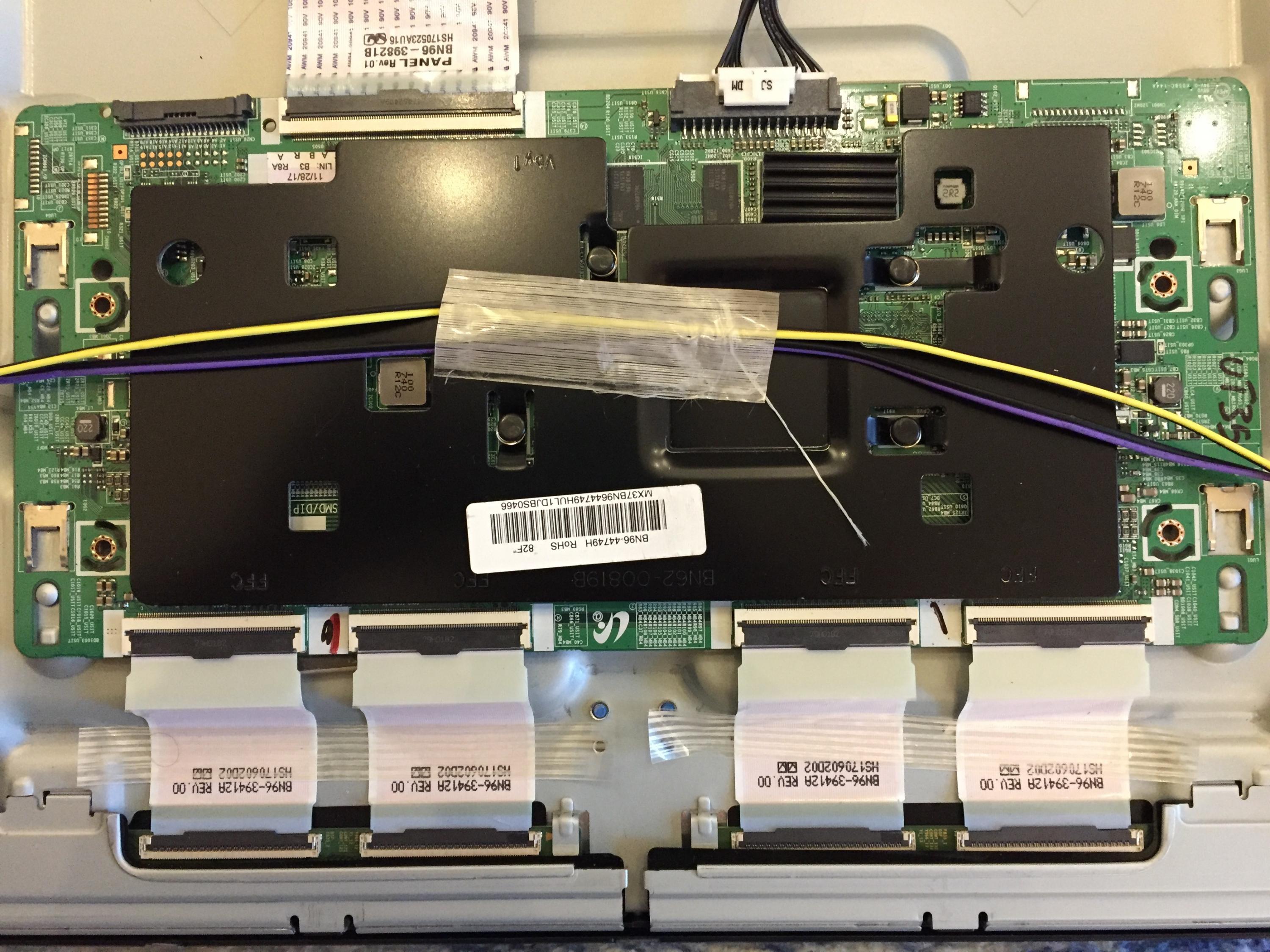

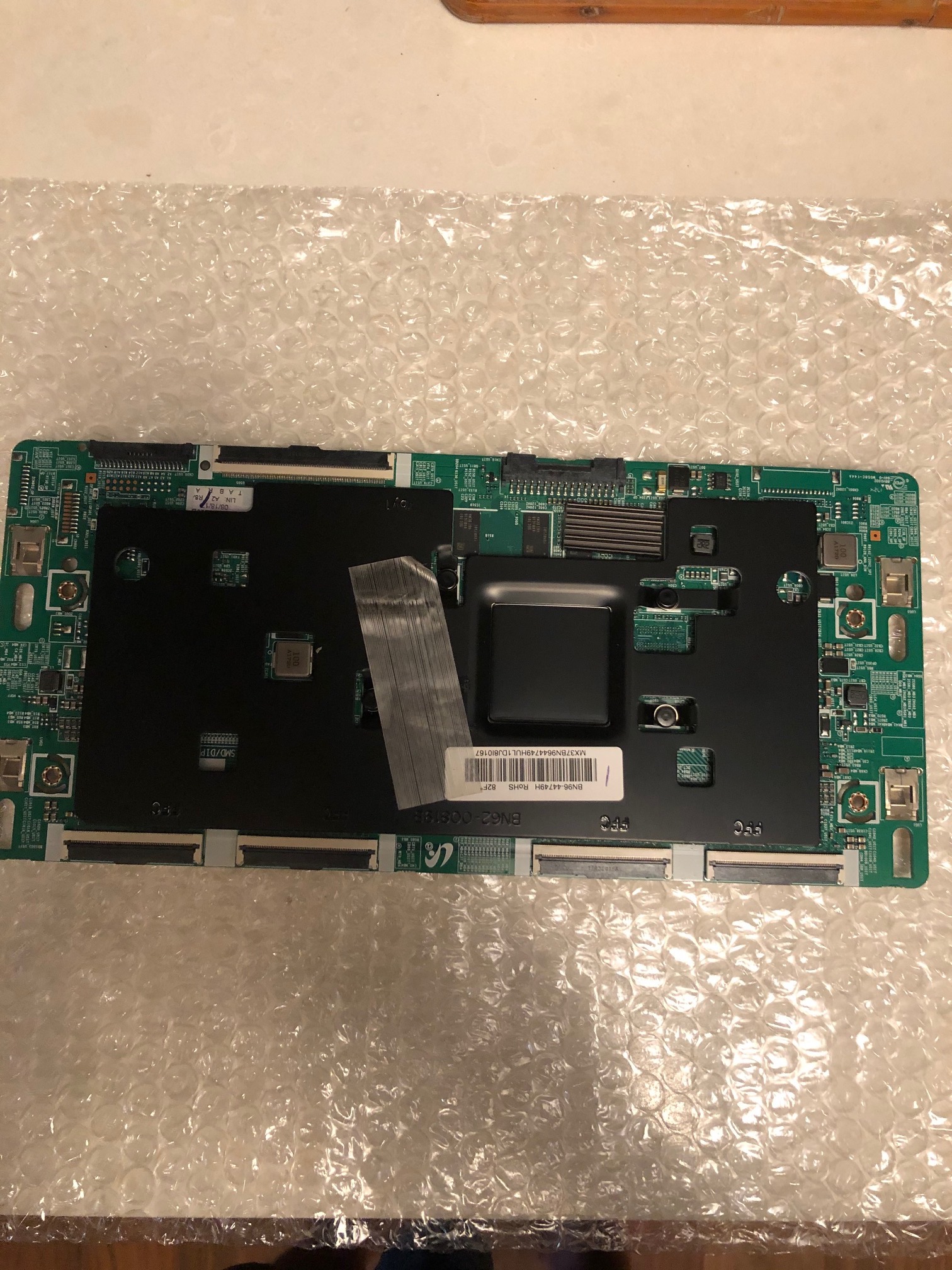

      Attaching photos of board. Let me know if these are clear enough. Including the old tconn board (2nd to last photo) as well.
      I am not sure. I am assuming I need to use the multimeter to check this?

          Re: Samsung UN82MU800DFXZA - Black screen+Sound works
          Look at the long white stickers on both tcons, what are the top numbers on both?

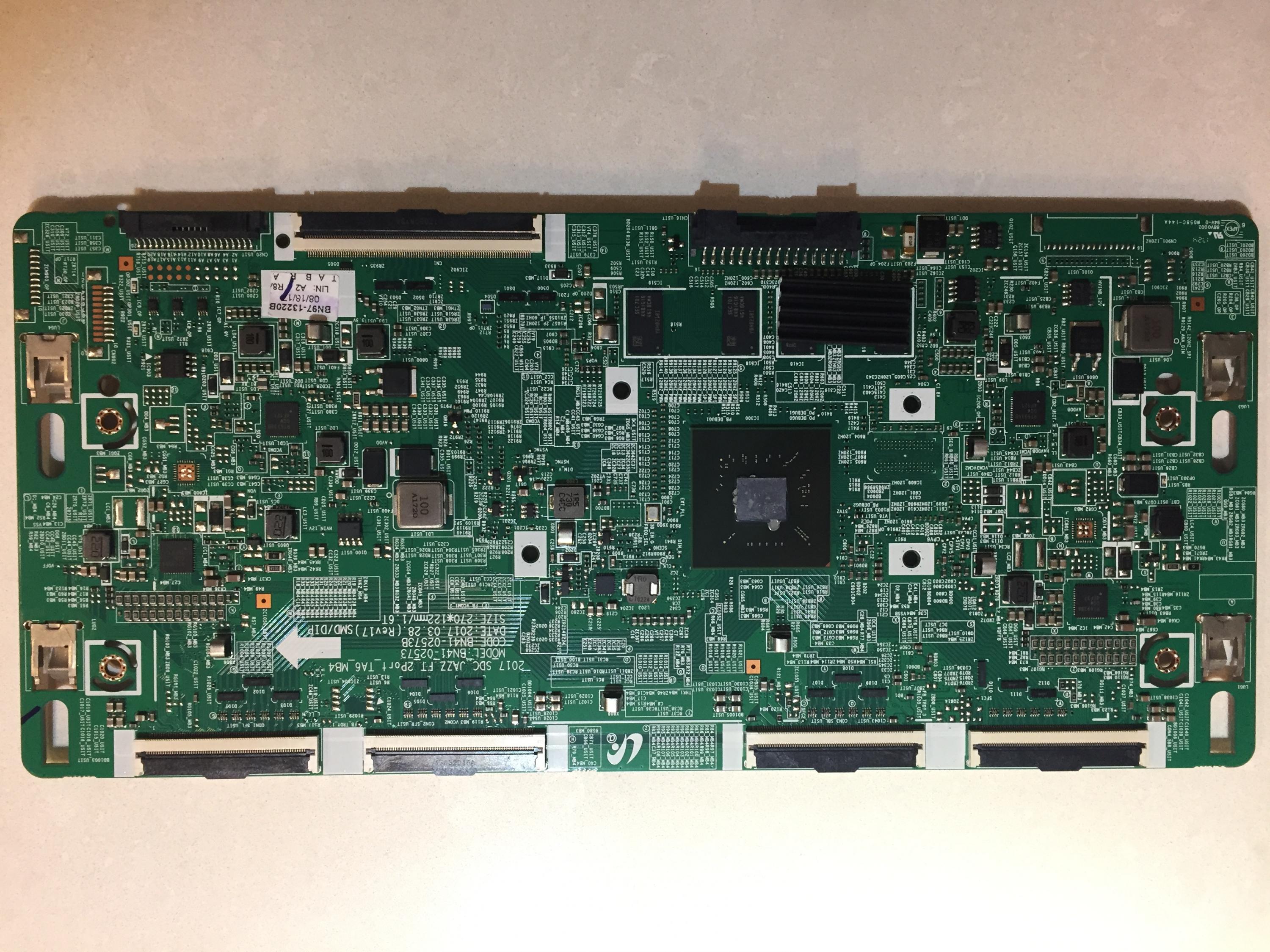

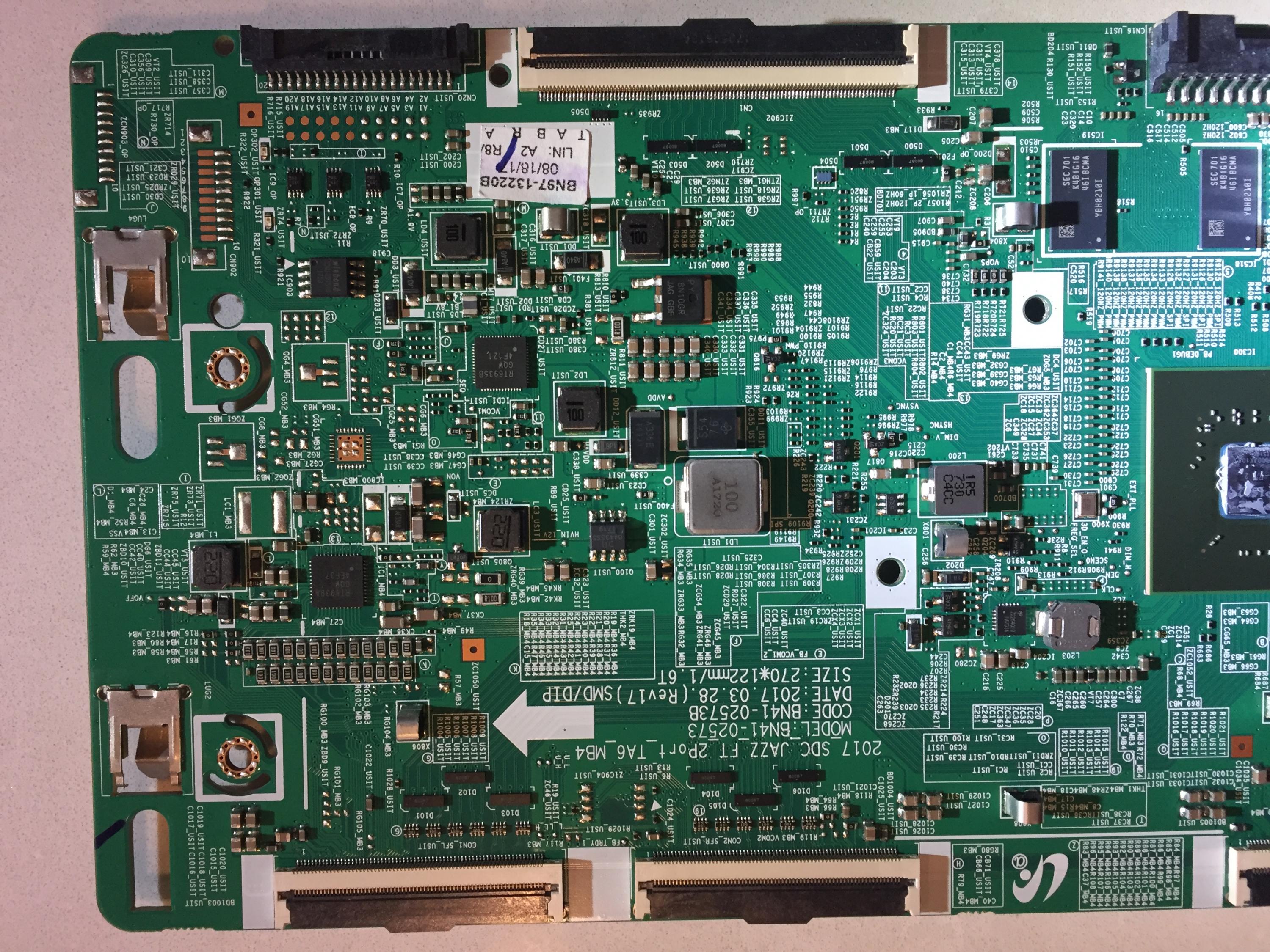

            Old Unit : BN96-44749H RoHS 82F
            New Unit :BN96-44749H RoHS 82F
            Old Unit sku : MX37BN9644749HUL1DJ810167
            New Unit sku :MX37BN9644749HUL1DJBSO466
            • nomoresonys
              • Jan 2013
              • 12331
              • U.S.

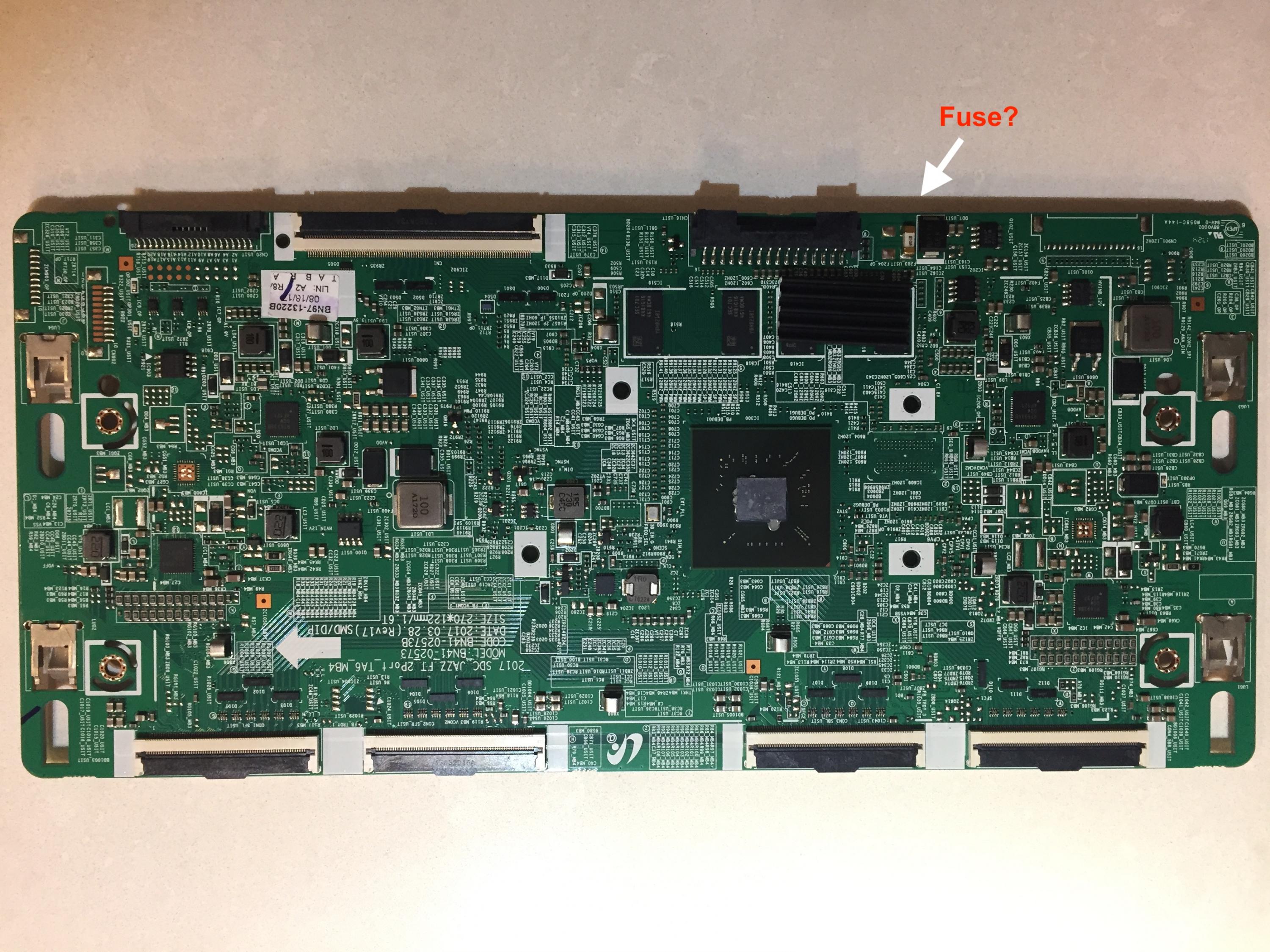

              Ok, that's surely a match, should test the fuse on tcon as suggested, I looked but couldn't find the fuse, do you see anything with label starting with F on the tcon?

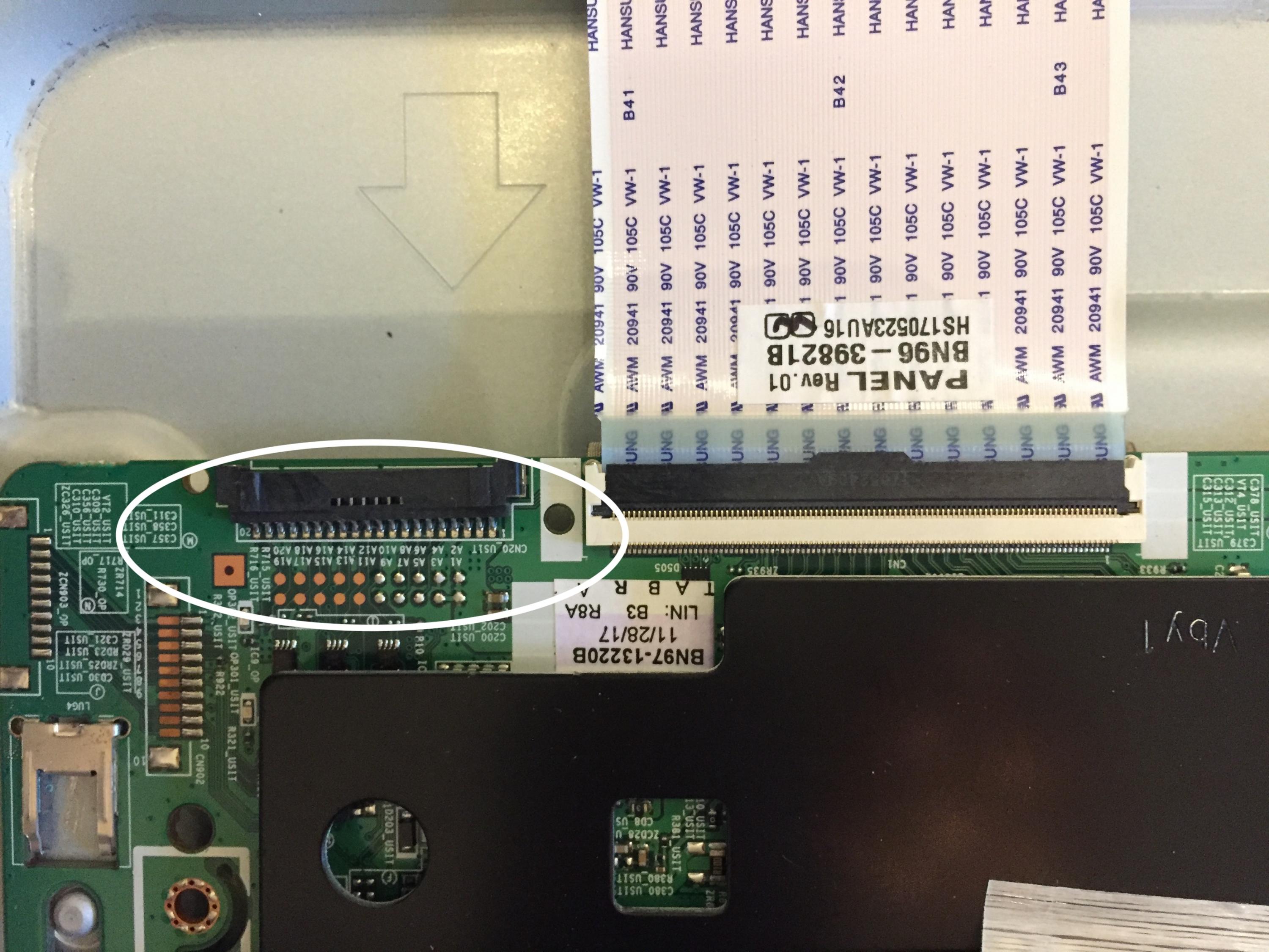

                How would I test the fuse? What are the settings I should put on the multimeter?
                  Set it to 20 vdc, black negative probe on tv metal chassis, red positive prob on each side of fuse.

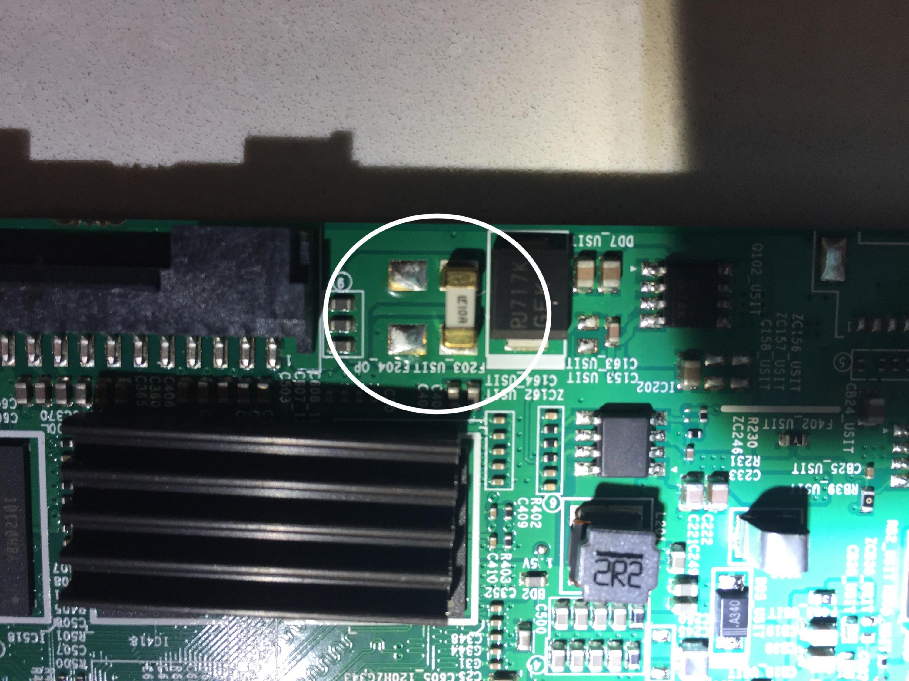

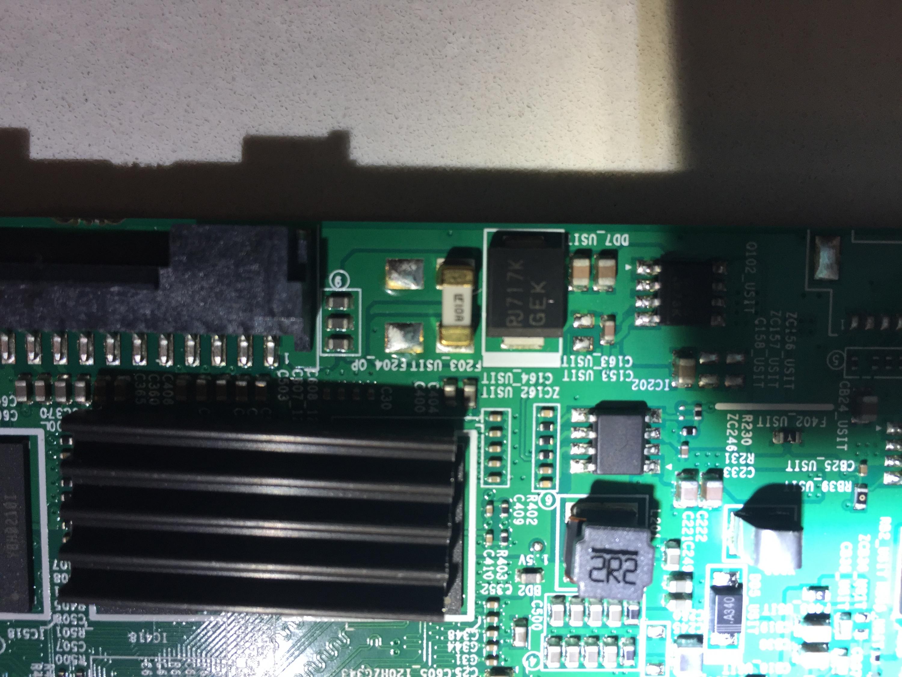

                      Apologies for the delay.
                      I tested the fuse in the image below. I couldn't find another area with an F on it. Should there be more than 1 fuse on this board?
                      Measured at 12.77V
                      I also acquired another main board to swap out with the board I have. Same issue persists. Front of screen is a blueish solid color throughout.

                        I tried to unplug one side of the TCONN (2 cables) and turned the tv back on. Nothing changed. Same with the other side. No change. Same solid bluish color throughout the front.

                          Could try the "cut tape" method, just for fun, see what happens, sometimes you have to play with the size of the tape to get it just right: https://www.youtube.com/watch?v=7TT8QYeN1s8

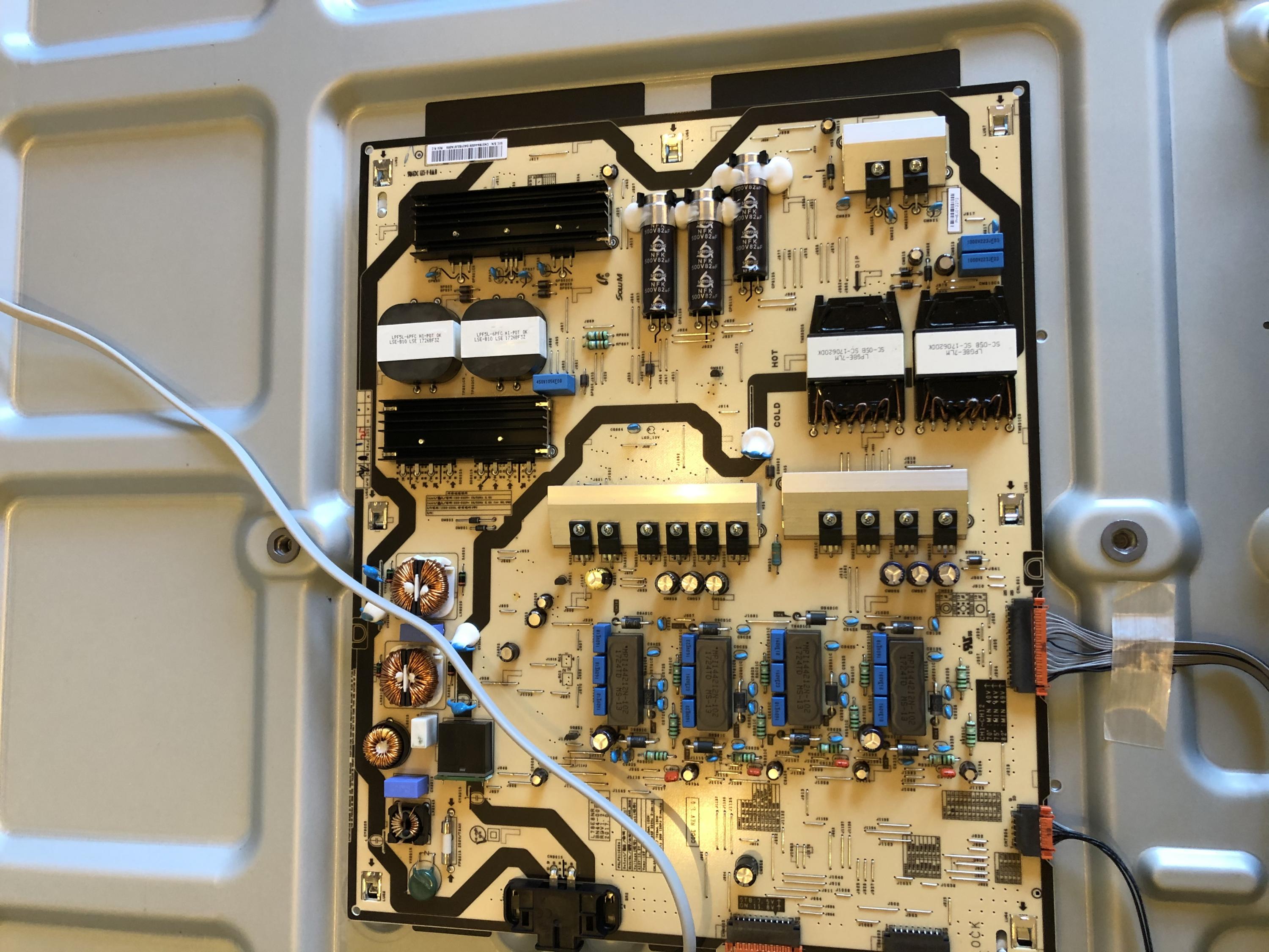

                            Maybe take a good look at the cable from powerboard to mainboard, see if anything looks burnt or brown around the terminals and such.

                                Well then, maybe they sold you a bad tcon or it got borked in shipping.

                                  that would appear to indicate that some of the voltages moving from the tcon to the panel are not there. It is likely the tcon has issues. It might be confirmed with some measuring of voltages at the board (look for the labels / points). It sounds like you should be heading towards a replacement card.

                                    The issue we are having was very sudden. Out of nowhere the TV stopped working. Went to black. Now when we turn it on it just has a solid bluish tint to it. There is no signal of anything else (tried the flashlight test)
                                    We have tried the old and the new T-con board and neither have changed the results we are seeing. Can you pinpoint where I would have to heat or freeze to figure out if the boards are both bad?
                                    Other ways to discern if the board is bad? What are the multimeter settings to test the power going into the board? Set it to what exactly?
