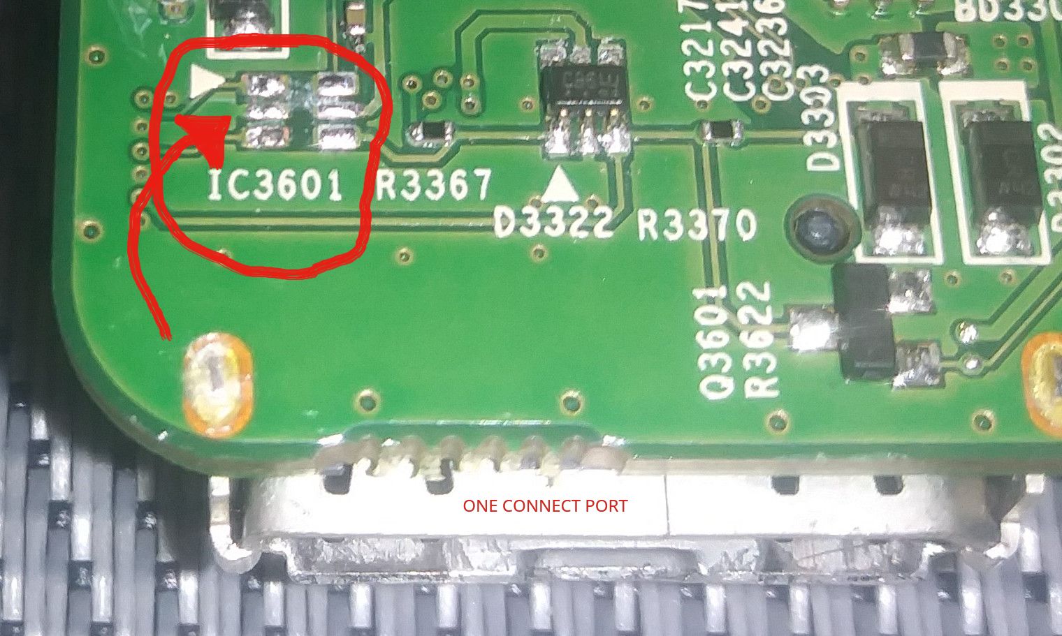

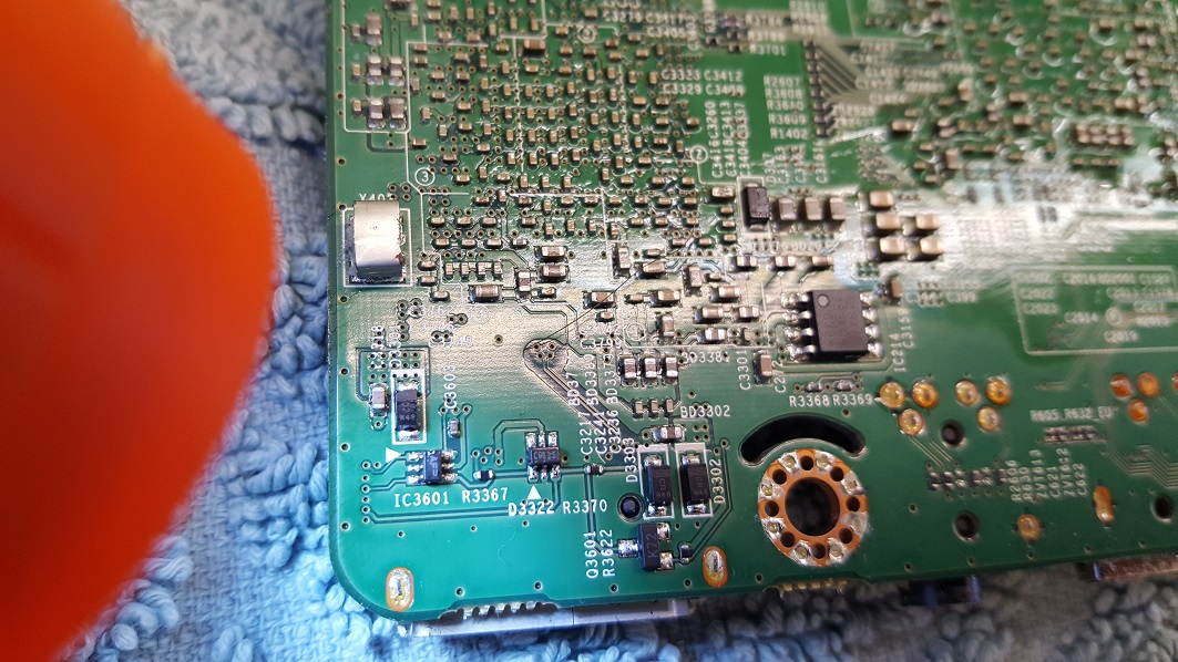

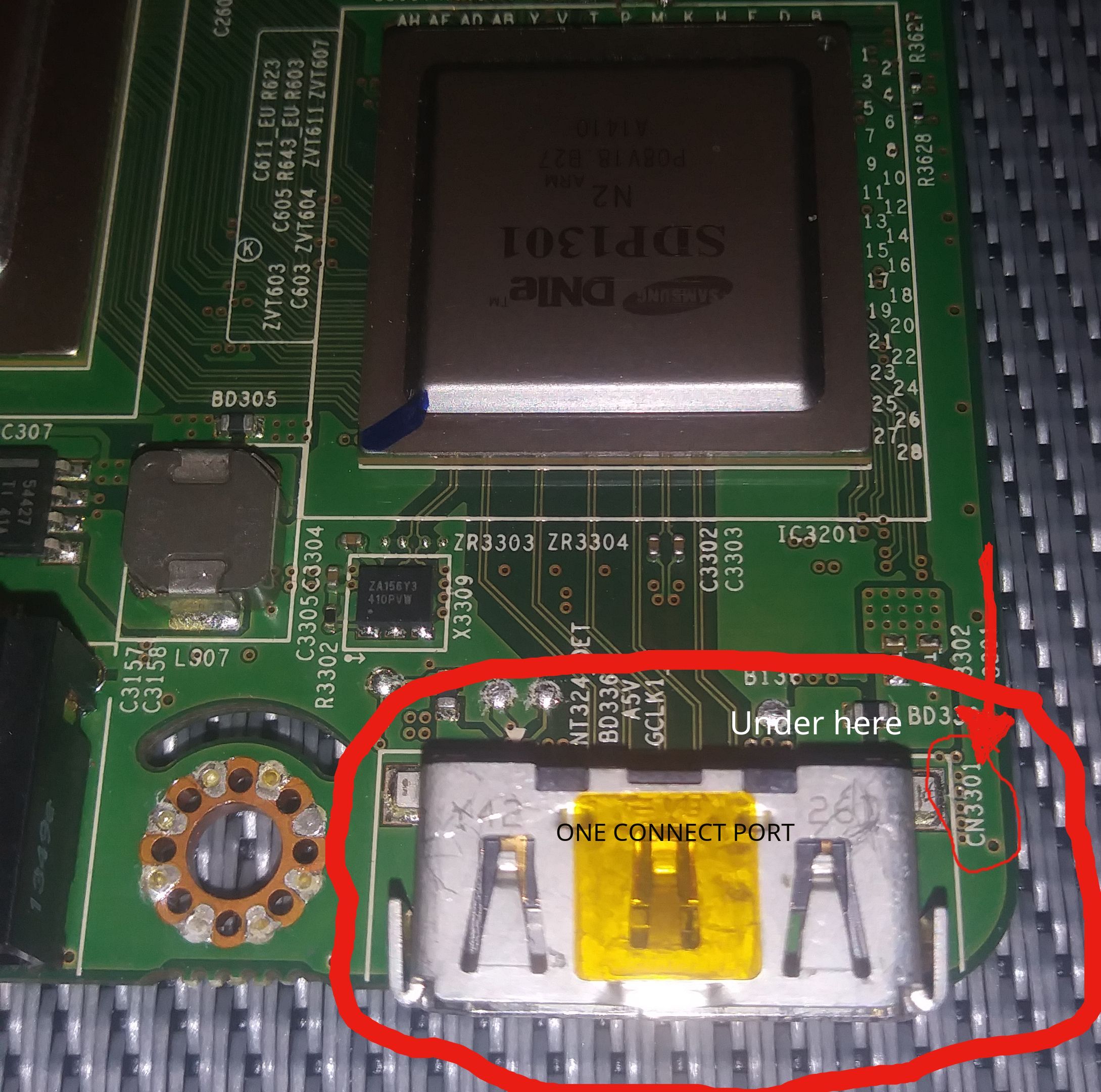

    OCB model BN94-07414Q, component location is IC3601, directly under OCB port(CN3301). Marking on chip was completely unrecognizable, so needed to ask here anyways, upon removal don't know where it fell. If anyone knows the identity of this IC, been Surfing the net for months now to find a picture close enough to see the marking but pictures posted are too blurry. Let me know of any info I left out that might help. Thank you.

    I've attached a photo of the part from one I've here, it seems to say AFD , the D looks more like a backwards C though.
    Sorry I can't get a better picture of it.
    Hope this helps.
