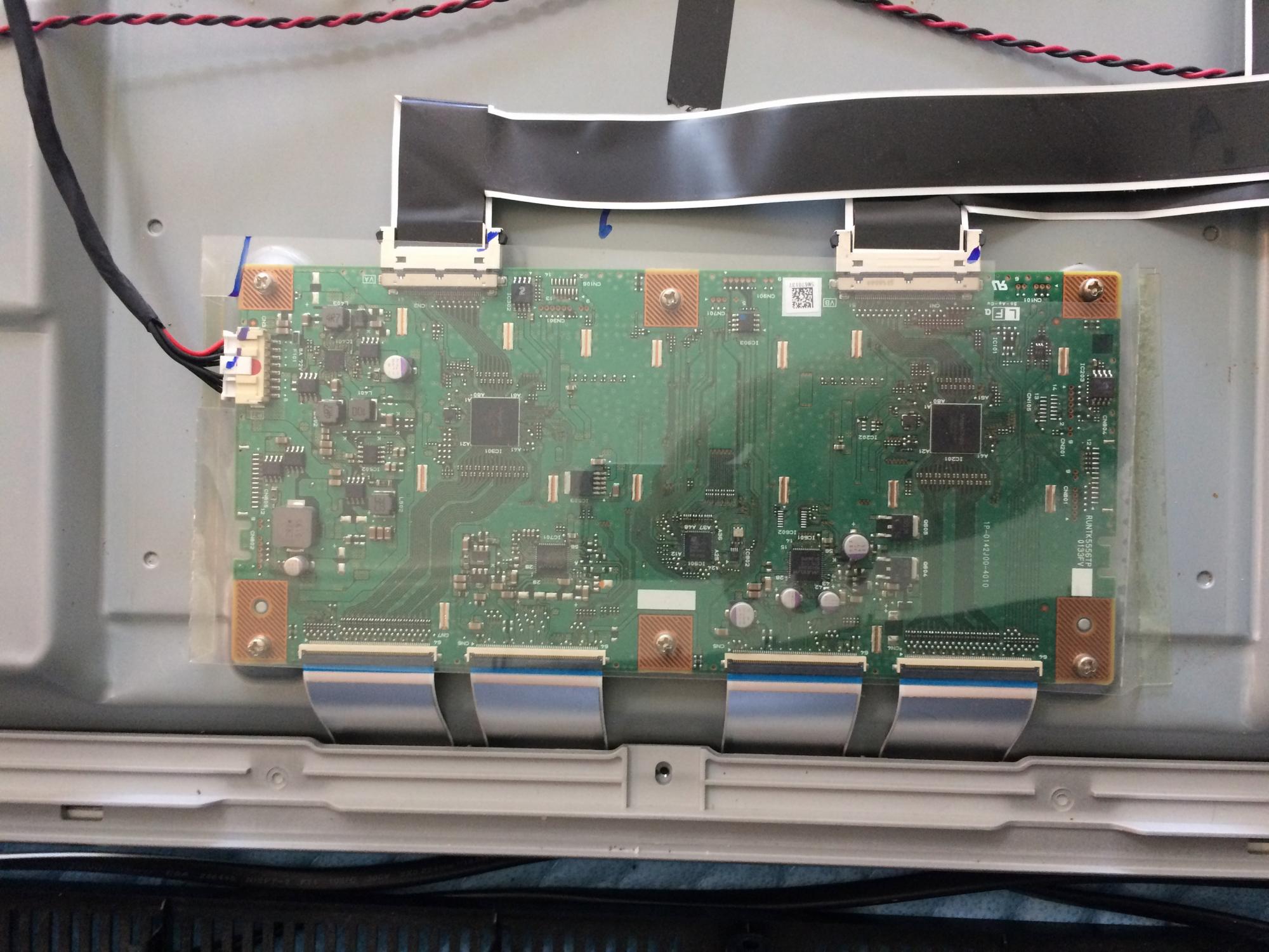

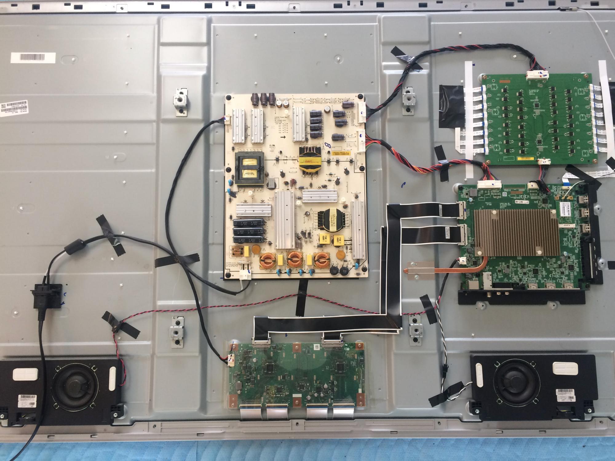

    Hi, I've been stalking the site trying to diagnose the problem with my Vizio M60-C3. When turned on, the screen remains black and there is no audio. There is nothing displayed on the screen using the flashlight test, but the status light does illuminate and the optical audio out port does illuminate. The symptoms are almost identical to https://www.badcaps.net/forum/showthread.php?t=51443.

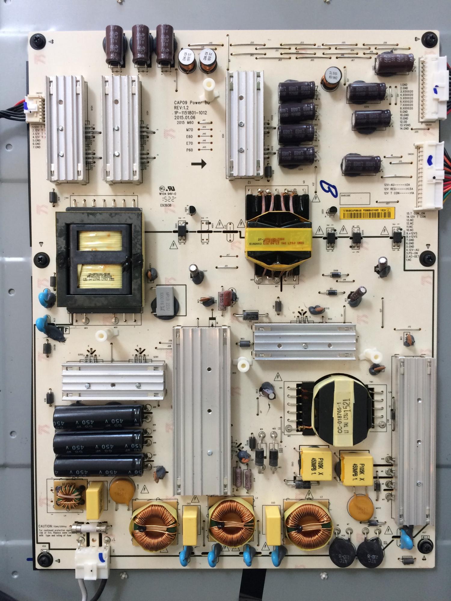

    On the power supply board (60CAP090), with the TV off, everything reads ~0V except for the two +12V rails (pins 8 & 9 on the connector the main board (CN201)), which read 12.57V, and the AC-DET (pin 12), which reads 3.79V.
    When I press the on switch, the status light illuminates and then starts to flash, indicating some kind of problem.

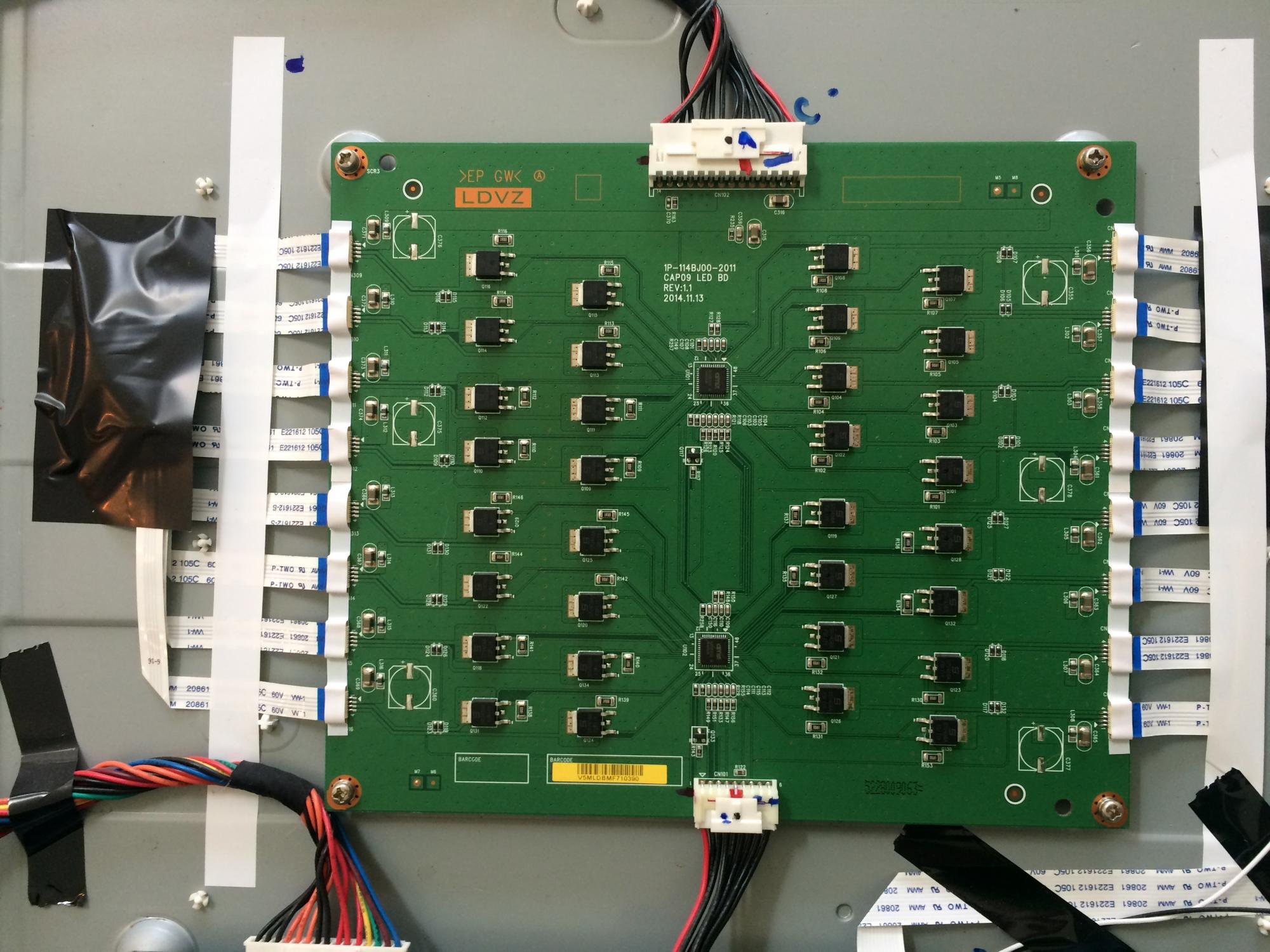

    On the connector to the LED driver board (CN301) top right connector on the power supply board), the X00020 pins (pins 3-8) read 26.48V, and the pin labeled VSNS changes from 0V to 2.45V. Pin 12 stays at 0V. So the power supply is providing 24V power to the drivers.
    On the connector to the main board (CN201), the T CON ON (pin 15) and 12V T CON (pin 14) both remain at 0. Likewise, the power supply provides 0V to the T CON board through pins 1-4 on the connector at the top left (CN202). The 12V rails (pins 8 & 9) remain ~12.55V. The 12V-AU (pin 4) gets activated to 12.55V, although no audio is produced. The PS-ON (pin 3) signal is provided from the main board at 5.12V, and the AC-DET (pin 2) stays at 3.77V.
    On the LED driver board, the power feeds in at 26V through CN102. All of the pins for the CN101, which I believe from reading through the other posts is the BL-ON signal, read 0V.
    There aren't any obviously blown connections, FETs, or capacitors on any of the boards.
    I'm guessing this is a main board problem because there isn't a signal telling the T CON and BL to activate. Am I correct? Is there something else I should check before I try to hunt down a new main?

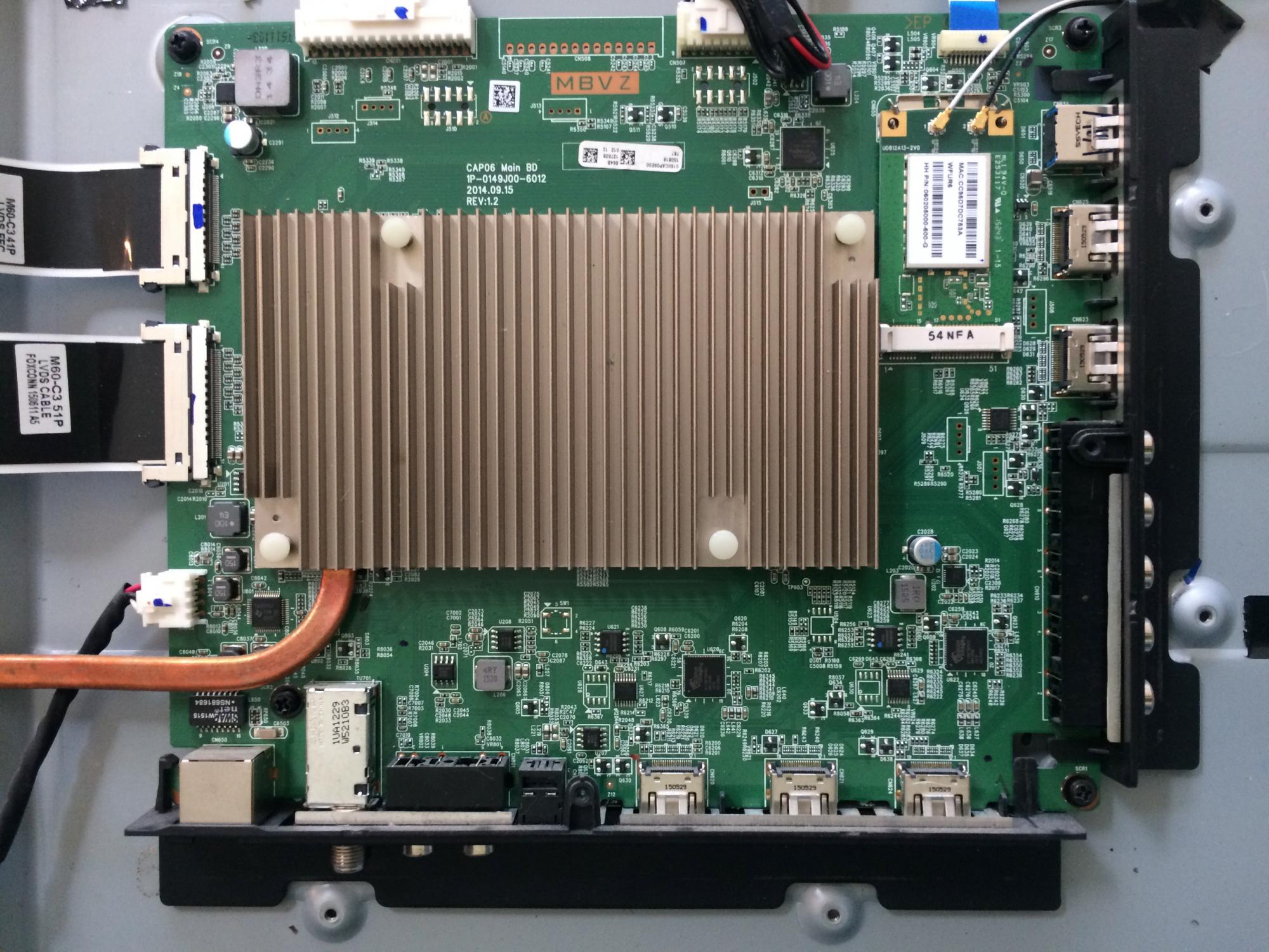

    Most likely bad bga connections on the processor of the main board. Symptom is ON/OFF or BL_ON pin not going high (>2.5V) when the tv is turned on. A few threads if you search your model or M43-C1

          For anyone else with similar problems, neilc6 nailed it: the main logic board was bad. I replaced that board, and now everything works as expected.

                  For what it is worth, i had exactly the same issue on a M60-C3 i picked up cheap.
                  Symptom: standby light comes on, then fades out + optical port lights up. No backlight, no sound. after a few moments the standby light goes off and after pressing power again, the standby light flashes 16 times without powering on.
                  Assessment: Verified PSU was providing 12v and 5V (PSon) but was not delivering 5v to the LED board.
                  Diagnosis - Bad BGA contacts under the chips on the main board. my paricular set showed some heat discoloration on the heat pipe and also around the heatsink itself so clearly this thing had gotten HOT.
                  Repair - I attempted a repair using a heat gun reflow (Without flux) and it got the TV working for about 20 minutes - At least long enough to verify the problem. I am going to try reflowing it again with flux and a IR temp gun to verify i get the solder molten before buying another board (They cost $100+ at the moment). either way i will probably wire in a 12v fan to run on the heatsink to keep temps down going forward.

                            If one side of the screen is not displaying correctly is still the mainboard. You have 2 BGA chips under the heatsink. I recommend you reflow both, if you still have issues you may have to replace or re-ball one of the chips.
                            I have a video on the repair of that exact problem. It's not always a replacement, sometimes you can get away with reflow or re-ball so if it doesn't work you may not have reflowed the board properly and I would suggest you try again.
