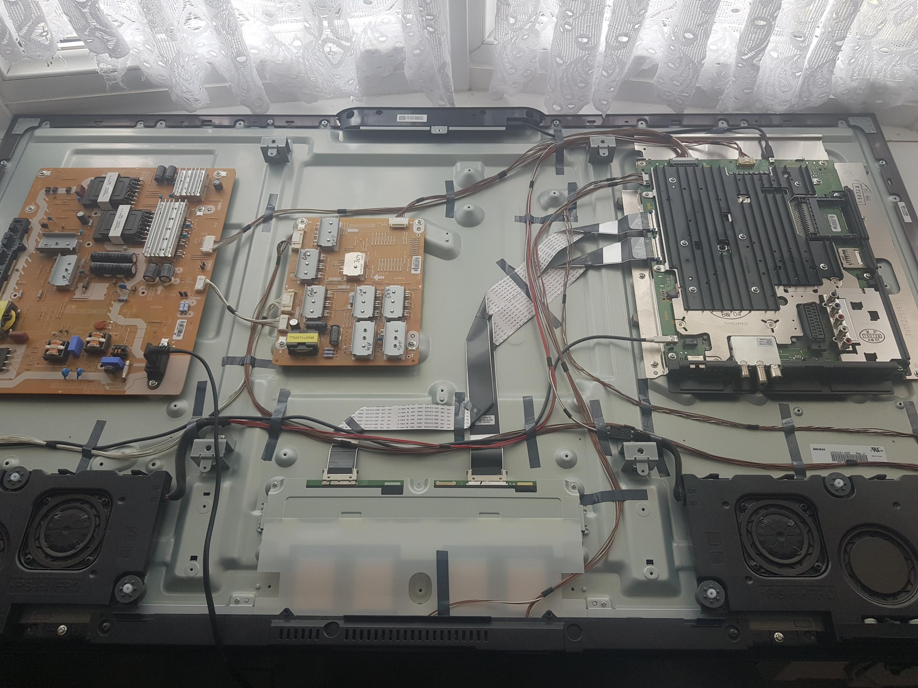

    Hi
    Bit stumped with this tv
    Backlights come on and have sound but no picture
    I have even removed each tcon ribbon just to eliminate the screen but nothing

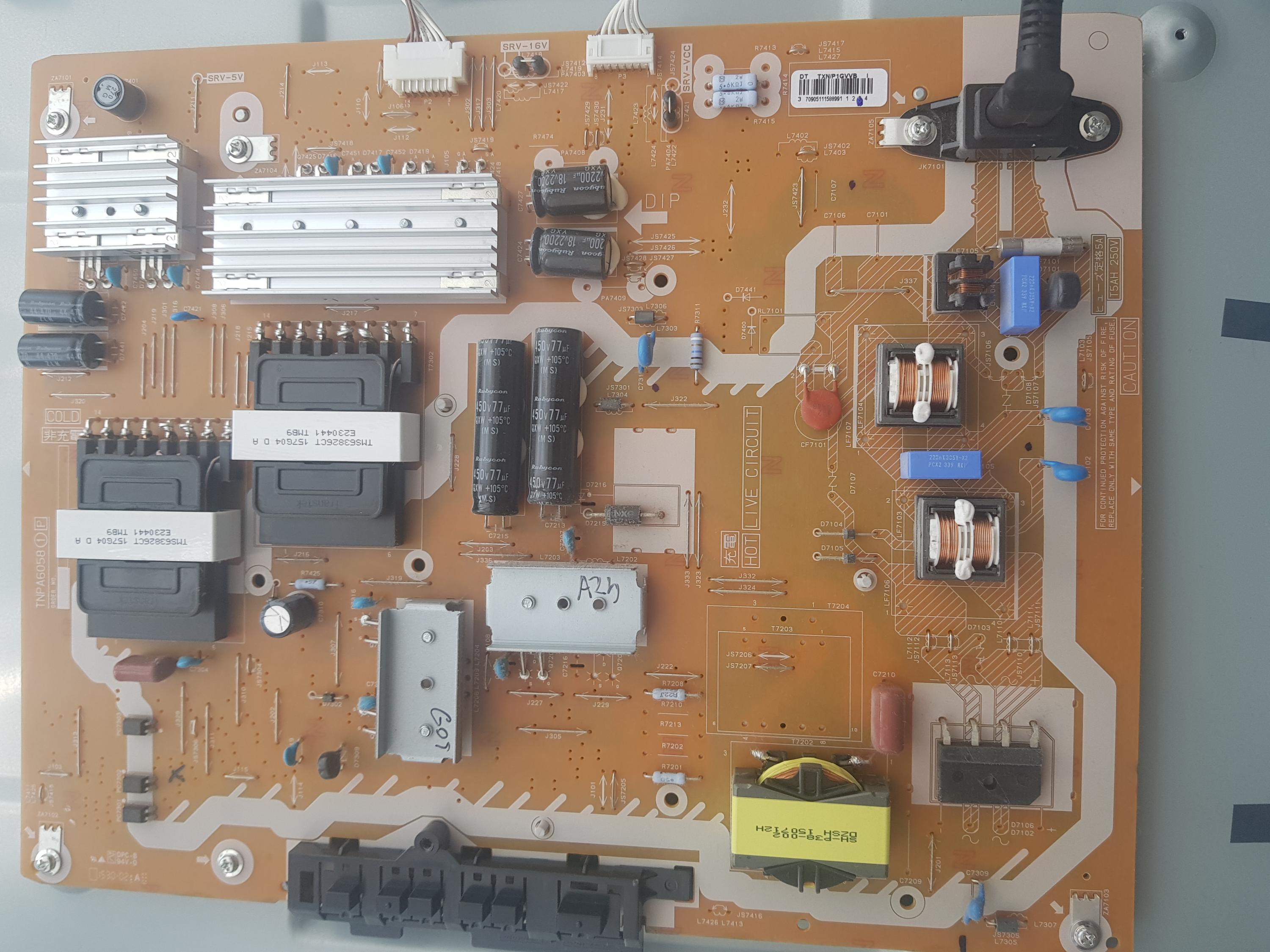

    Tcon fuse 12v both sides
    Psu
    Srv-16v =15.3v
    Srv-5v = 5.0v
    Srv-vcc= 27.6v

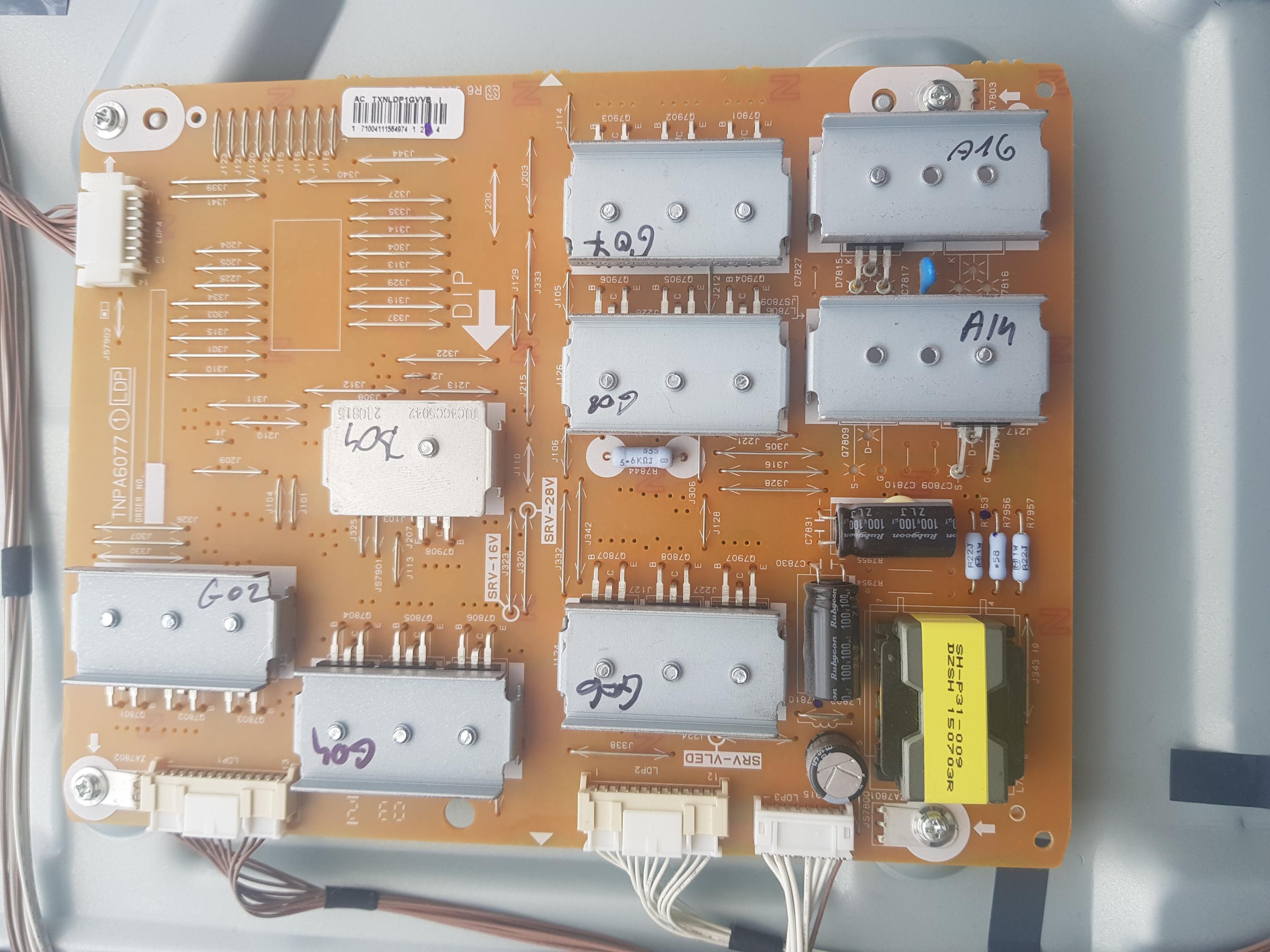

    Driver board
    Srv-led =40.7v
    Srv-16v=15v
    Srv-28v=27.4v

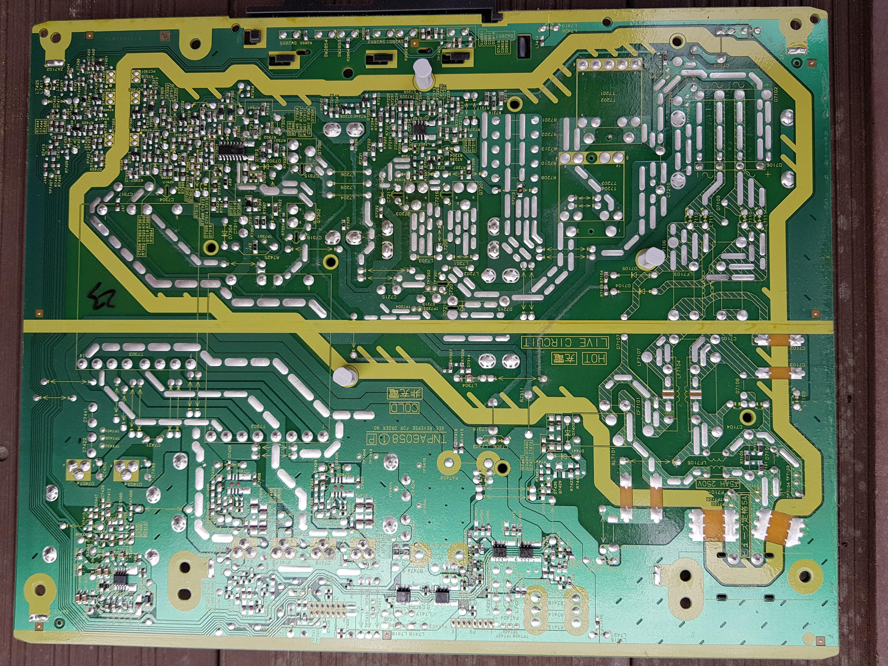

    Re: Panasonic tx-50cx802b backlight and sound but no picture
    More pics of underside of the psu

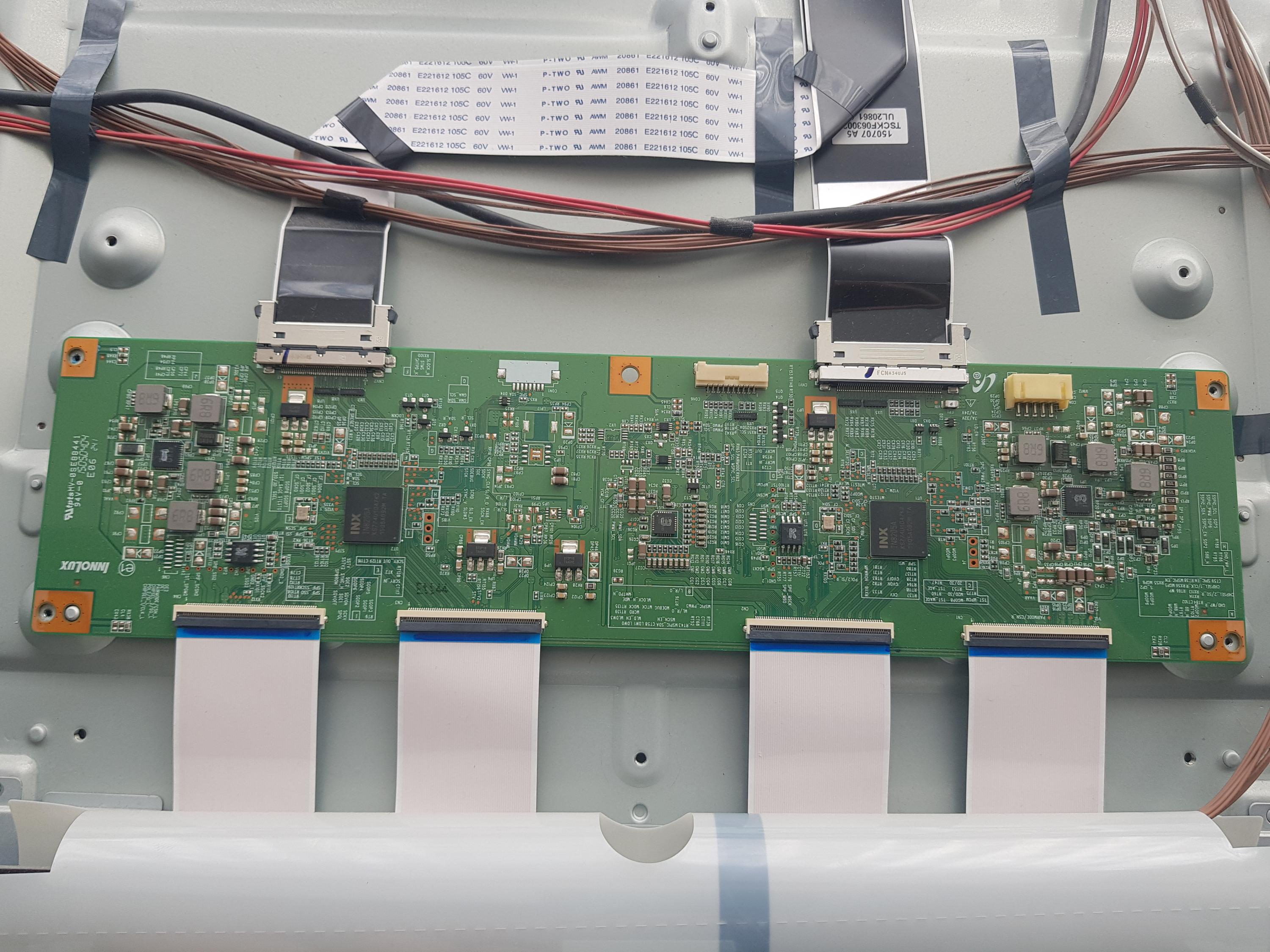

        • sordids999
          • May 2013
          • 2149
          • uk
          Picture uploaded of tcon board
          I have tried removing two ribbons at a time but still nothing shows up on the screen
          thanks
              Check
              Vgl
              Vgh
              V33
              V12
                  This is all I could find on the tcon
                  Vgl 0.35v
                  Vghp 0.00v
                  V12m 0.00v
                  V33dr 0.58v
                  Main tcon fuse 12v
                  • Hamie
                    • Apr 2014
                    • 1383
                    Looks like the tcon may be faulty.
                    Test those voltages again but with the 4 connections to the panel removed.

                        So do you get the same Voltage readings without all 4 cables between T-CON and the LCD panel?
                            Sorry for the late reply but with all 4 ribbons disconnected it's the same readings
                            • Hamie
                              • Apr 2014
                              • 1383
                              At a guess say UP1 has failed.
                              I know these boards are pretty cheap but would be interesting to know what actually failed.
                              Off chance that the panel may have killed the board so I'd test the new tcon without the panel connected when you first install it.
