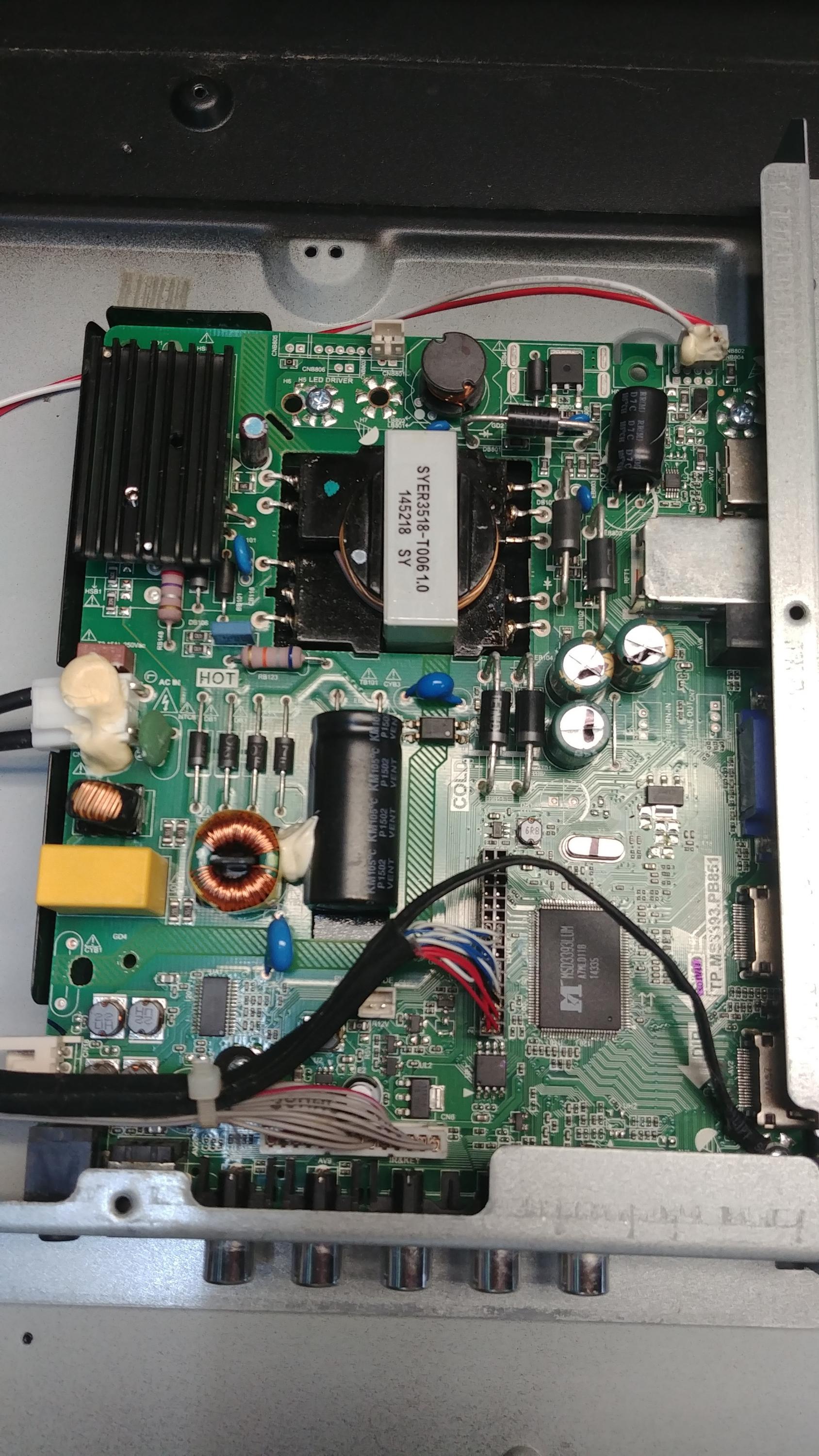

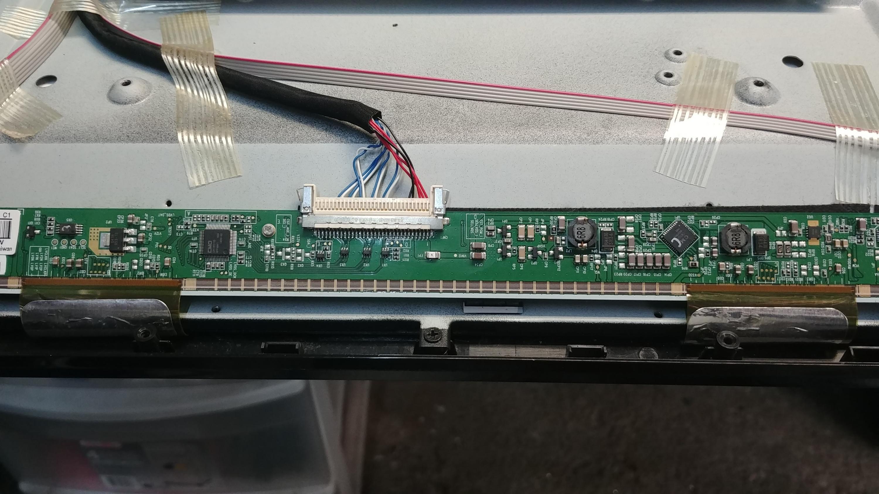

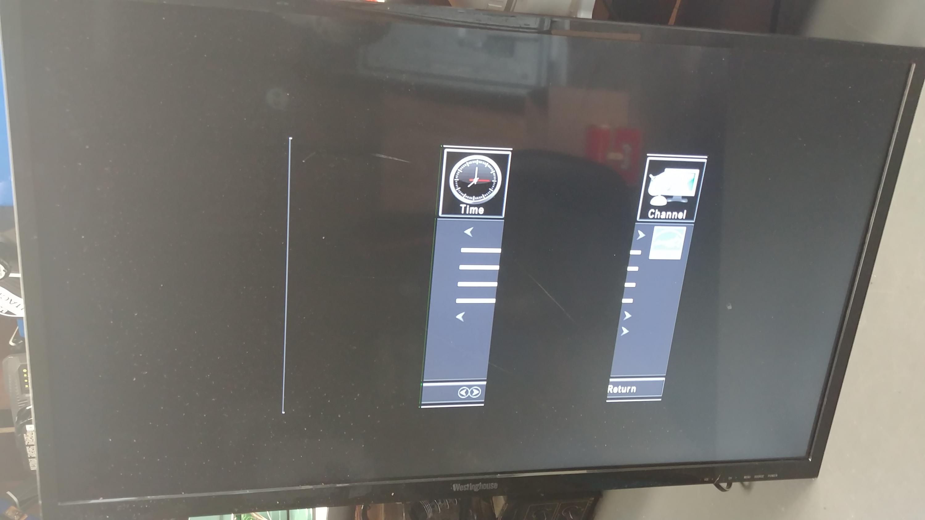

    See pics. Screen shows only that. Power supply is fine. Voltages show up all across the integrated Tcon. Panel ribbons seem bonded fine. no components getting hot.
    I have 2 of these, same model, other one image is fine (shows complete display but white washed). Just chalk it up to bad panels with this model?

    Can we see larger pictures showing all the brown flex PCB between LCD glass (you show only two) and the integrated T-CON board? Do they all look OK?

      When I see this it usually means someone cleaned the screen and the liquid ran down and damaged the panel..
        I will need to open it again, but they did look like the same as the 2 shown. Didn't appear separated. I put light pressure on them while watching the screen, no change. Is that where I should be focusing?

          one has a tab bond problem or a damaged panel and the other (white wash) a tcon problem.
