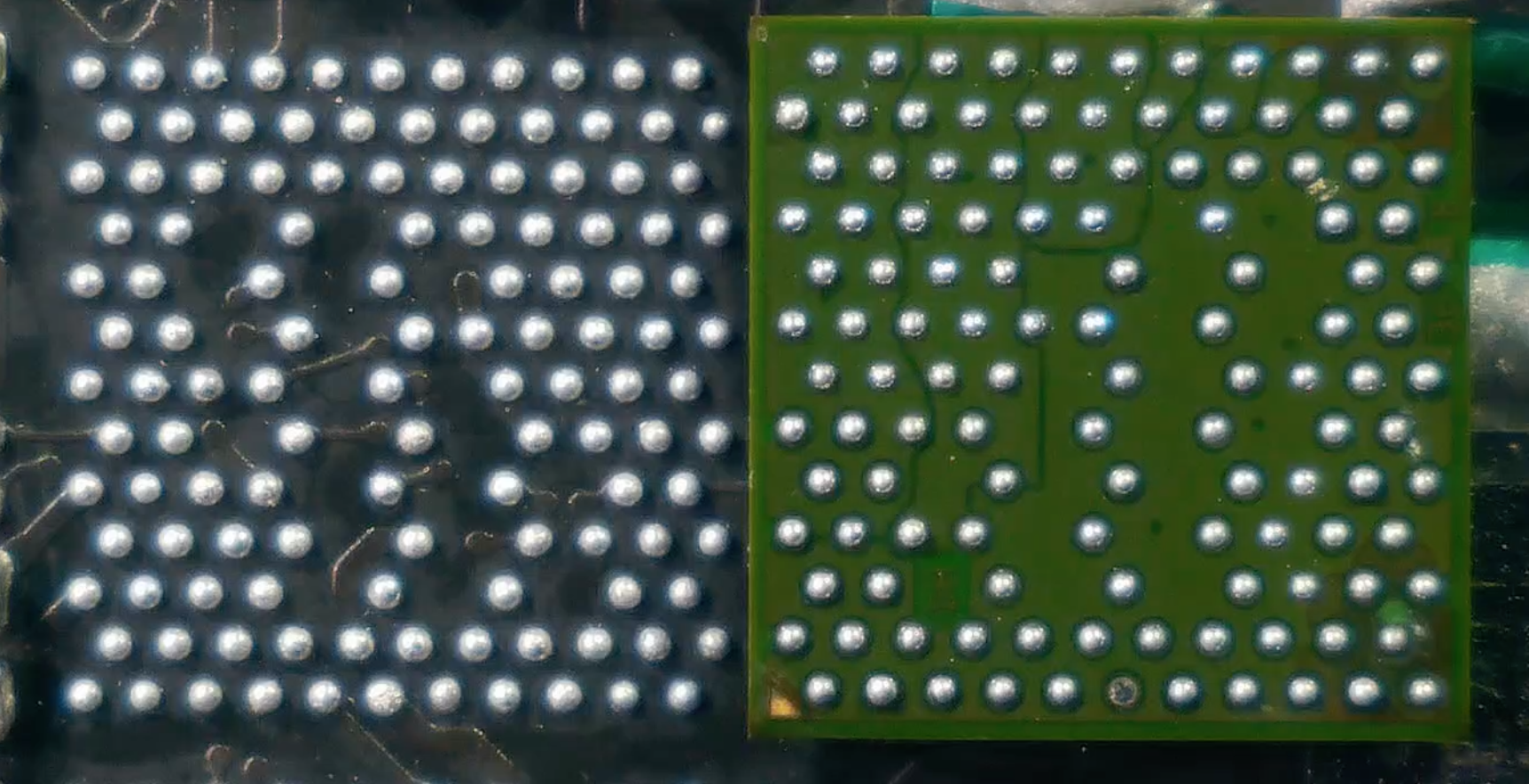

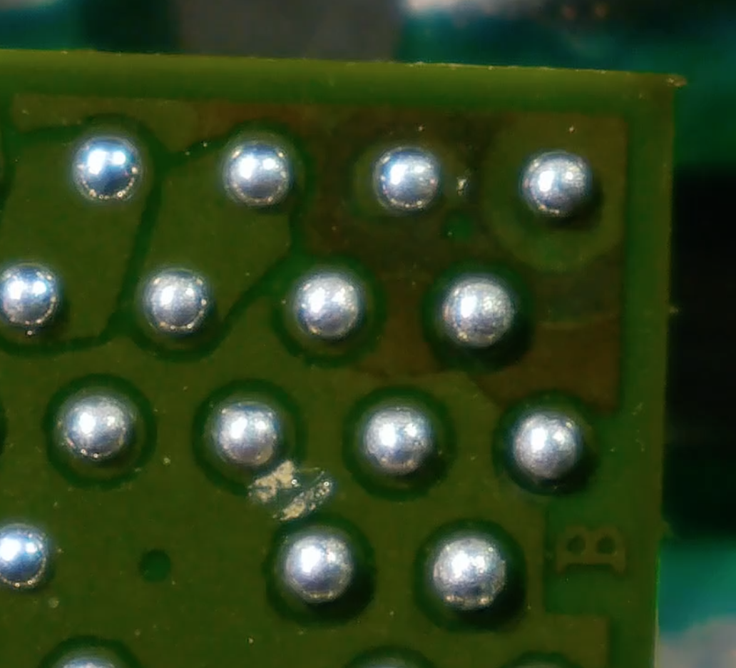

          Click image for larger version  Name:	image.png Views:	0 Size:	411.7 KB ID:	3713746

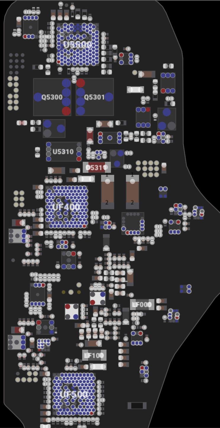

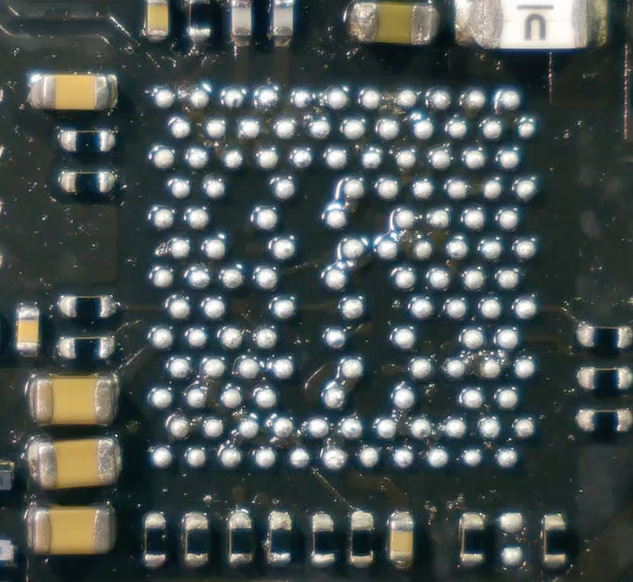

          U5500 CD3218 was not replaced but all small components around it checked all good
          UF400 got more area damaged around than UF500 which somewhat explains it is stuck on 5v
          any other measurements i could provide?

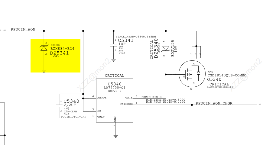

            Measure the voltage to ground of PPDCIN_AON.
            If this voltage is truly > 24v then the zener @ DZ5341 will trigger. Confirm this voltage.

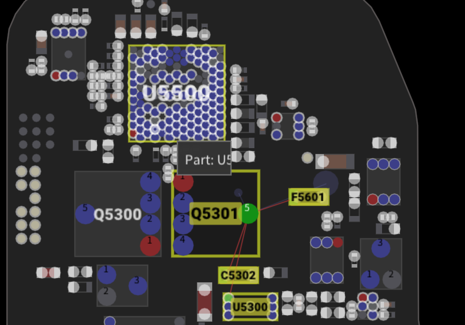

                    Flux and remove DZ5341. Note that the 24v clamping feature will be lost but it appears that this is not working anyways.
                    Best to replace this part to test again with a 24v zener in place. When working, this line should not exceed 24v but should be present and not tanking to 0v.
                    Respectively, IF this part is removed, then the PPDCIN_AON rail will be hit with the peak adapter voltage so concerned here. Apple has this 24v zener in place for a reason and it is to keep this rail at 24v or UNDER.

                      Here is an idea - flux and remove U5350 and also the mosfet @ Q5340. This will protect the downstream rails through isolation.
                      Now experiment. Do you see 24v at the zener when the adapter is at 28v? If not, the zener is defective.

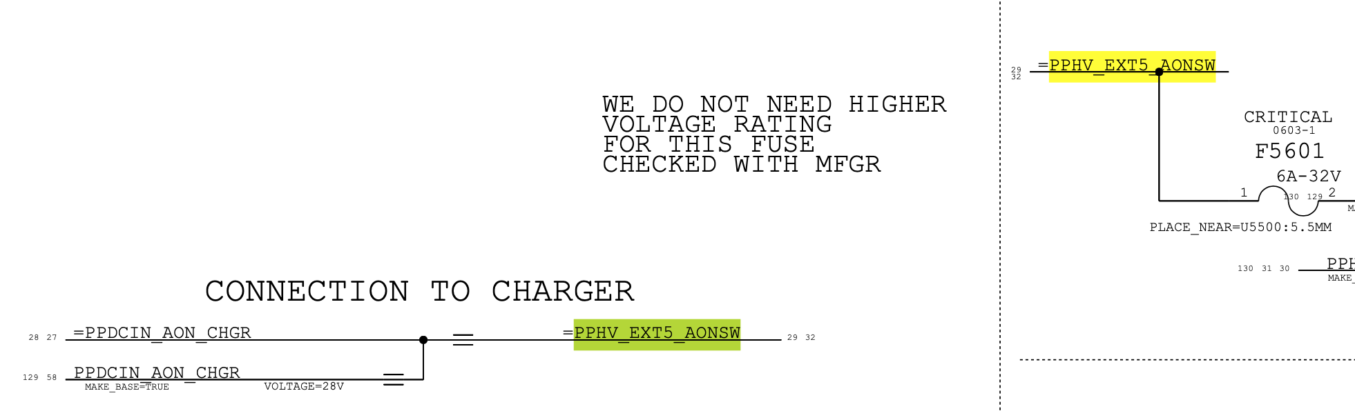

                        can you explain the theory here? i am a bit reluctant to touch absolutely clean areas of the board to not mess up everything at once without validating it first.
                        PPDCIN_AON rail comes only from USBCs not magsafe so 24v zener actually makes sense because this is definitely 20v rail.
                        since you were asking about magsafe scenario there was 0v.
                        now to confirm that i can run this scenario:
                        connected to right single usbc
                        machine off - meter 5v 1A. both PPDCIN_AON and PPDCIN_AON_CHGR = 4.85v .
                        in case of magsafe it doesn't use this U5340 circuit (although mentioned on magsafe schematics page) it just pumps output voltage straight into PPDCIN_AON_CHGR​ through two big mosfets and F5601 fuse

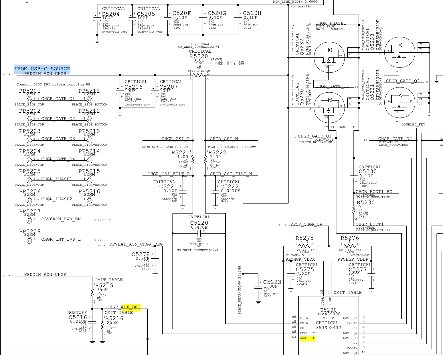

                        Click image for larger version  Name:	image.png Views:	0 Size:	200.9 KB ID:	3713864Click image for larger version  Name:	image.png Views:	0 Size:	84.8 KB ID:	3713866​​

                          Remove all power. Meter in resistance mode.
                          Measure the resistance across C5220. We are testing the full path resistance for the incoming current sense circuit. What is the exact resistance?
                          What voltages do you measure @ DCIN_VSENSE?

                            2.7 Ohms. multimeter might be not super precise tho
                            • mon2
                              • Dec 2019
                              • 14369
                              Looks ok. You can short / touch your meter probes together to get the baseline for your meter = '0R ohms'. Subtract this from your measurements to get a fairly accurate reading.
                              What is the voltage to ground of CHGR_AUX_DET?
                              • flusher

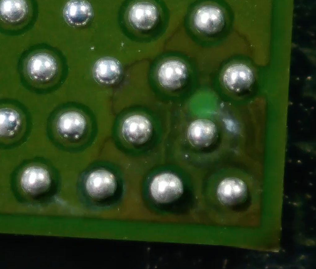

                                i did found UF115 had only 2.4v output instead of 3.3v and when desoldered input pin was corroded so i restored all this and now good 3.3v out but nothing else improved, long shot we might get usb data communication back on this port as it seem to be related only to that.
                                now puzzling what prevents upper CD3217 from giving that 5v output as basically all the rest do
