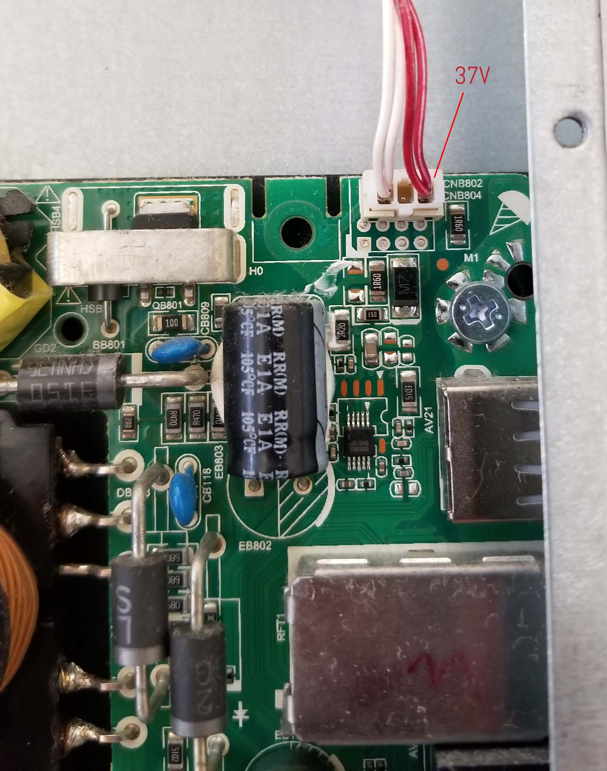

    I opened it up to get the voltage reading in the back light led connector. I'm getting 37 volts. There is no information printed on the board front or back regarding normal voltage ranges.
    I don't know if this should be the correct voltage, I tried looking for a service manual or schematics to no avail.
    How may I proceed with this?

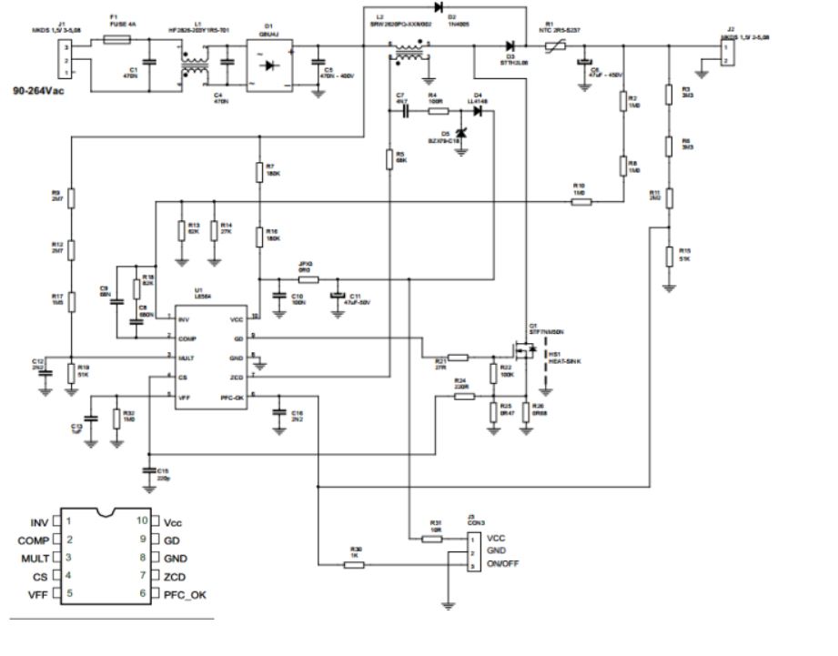

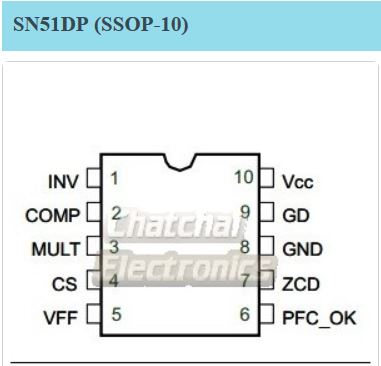

    The SN51DP is the led driver chip which should be driving the gate of a mosfet which I cannot see but could be on the underside of the board. Can you post a clear sharply focused picture of the underside of the board.
    If you could measure the voltages on the pins 1 to 10 would be usefull.

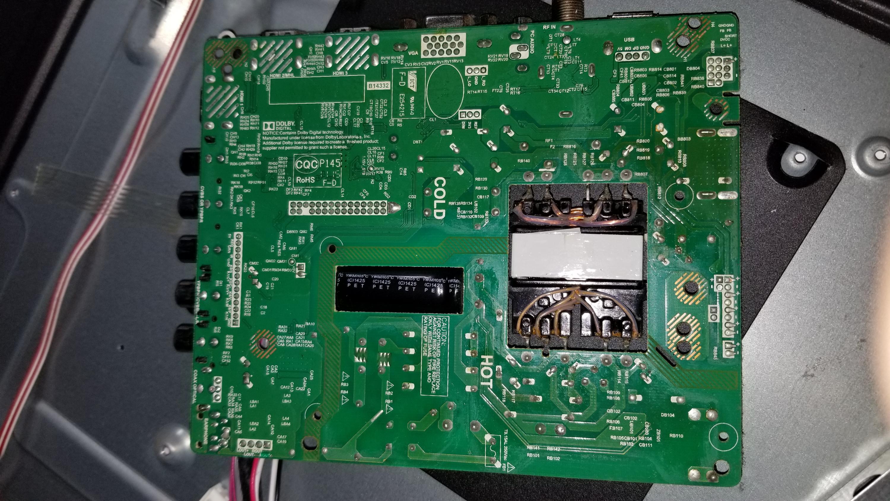

      If you could measure the voltages on the pins 1 to 10 would be useful.
      Thank you for taking the time to reply and try to help.
      Regarding the measure of the led driver chip, unfortunately I don't have the appropriate tools yet to do that without shorting the chip (magnifying glass, and super thin testing probes), but working on it.
      I have attached a new picture of the back of the board as requested.
      Also while measuring the voltages again in the let connector and the TV is off (stand by) the voltage is 37.4, then pressing the power button the voltage goes up to 100 and slowly decrease and stabilize in 47v.
      Even during this voltage spike I never see the led to light up.
      Is it possible that the led stripes are bad?

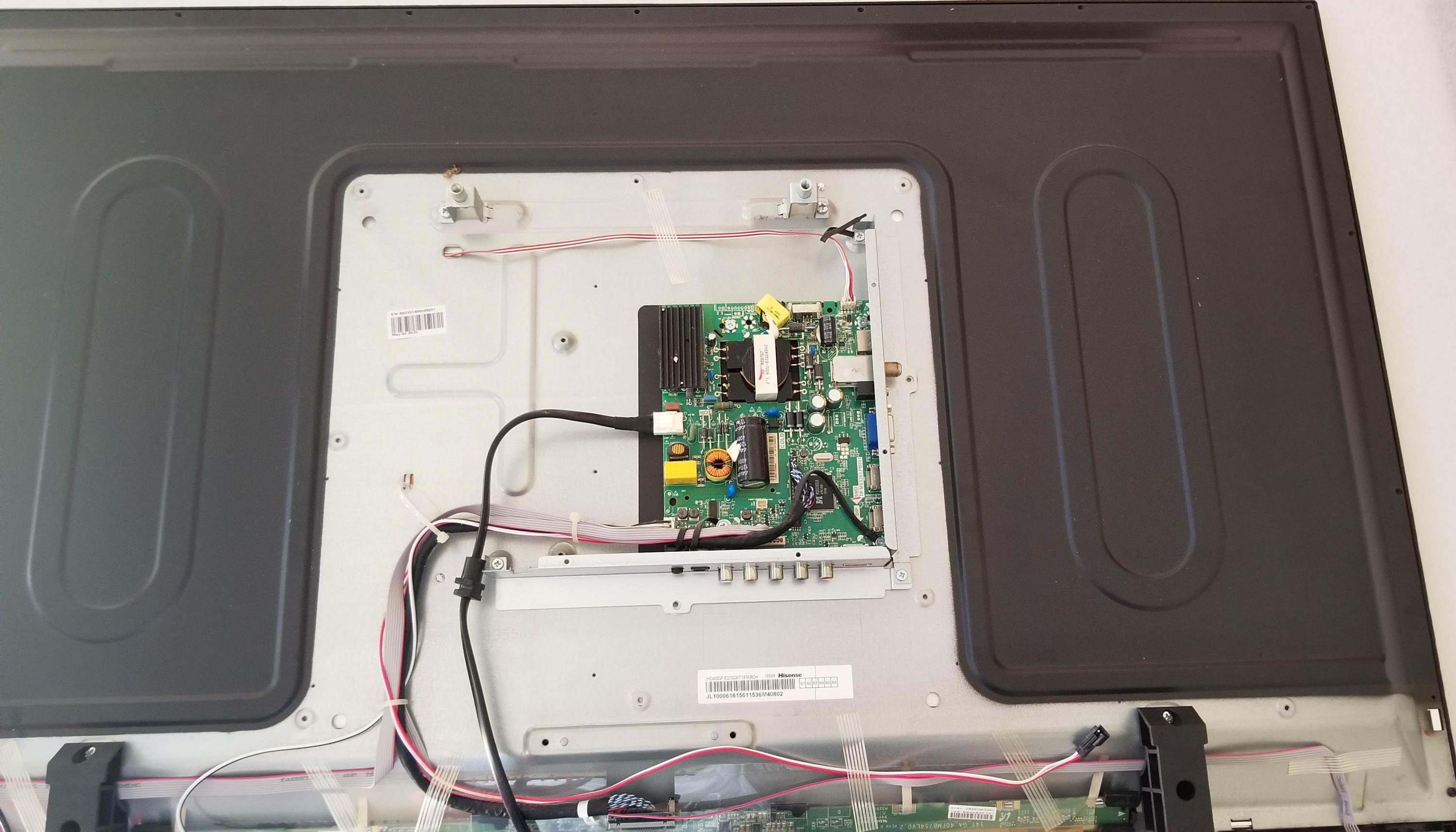

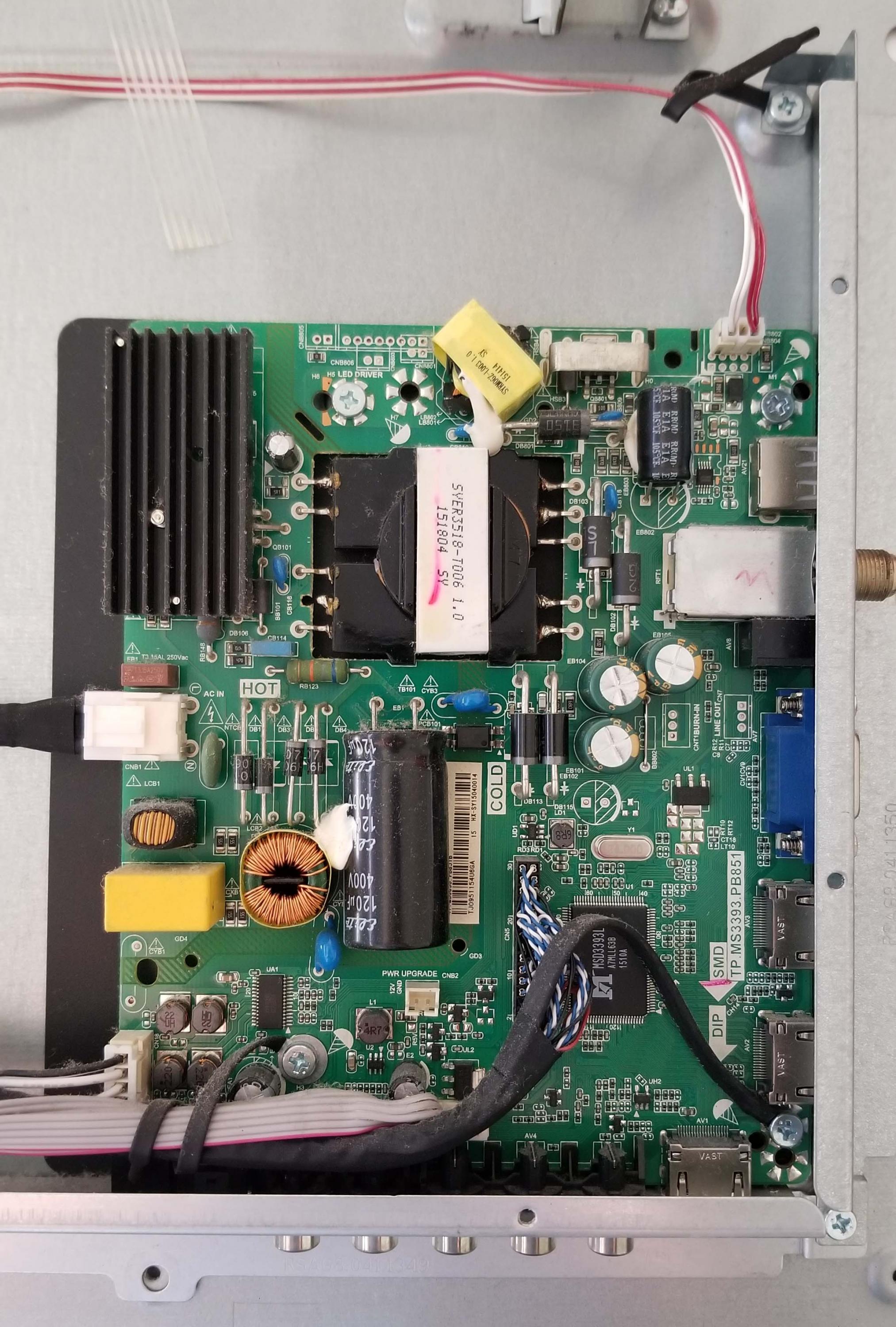

                I finally managed to get 2 suction cups to properly remove the panel. I have access to the leds now.
                Connectors seems to be fine.
                These are the voltages on every led strip from too to bottom when the TV is on :
                15.4v
                16.4v
                23v
                17.4v
                I have also recorded a video when I press the power button here is the link:
                https://youtu.be/NacRDqu4Ckk
                  Re: Hisense 40H3E No backlight
                  At least two pf the strips have shorted LED's, you can see some of the LEDs are not lit up on two of the strips. The other two strips that do not light up at all probably due to open circuit, I.E. open LED's in the LED strip.
