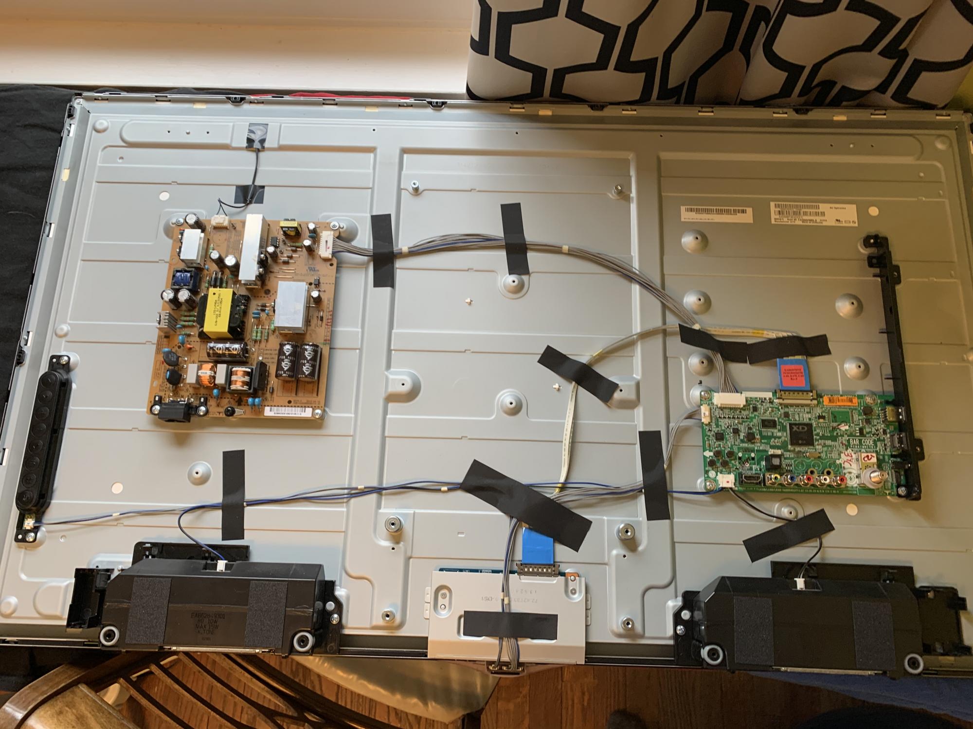

LG 42ln5300-UB won’t turn on and only has standby voltage
  • NickIsFluffy
    • Apr 2020
    • 23
    Sorry for the multiple threads in different forums, I didn't quite know which forum to post this in, but I got some help, once again im really sorry about the multiple posts. But back to the title;
    I have this LG 42ln5300-UB tv, but it won't turn on, there's only 3.3v standby but its supposed to have 3.5v on the power supply board. We already replaced the main board and the power supply board, but it didn't make a difference, I still only had that 3.3v standby. We are missing the remote for the tv, if that makes a difference. How can I fix this issue, I've already gone through all the trouble to buy a new part so i'm determined to fix the issue.

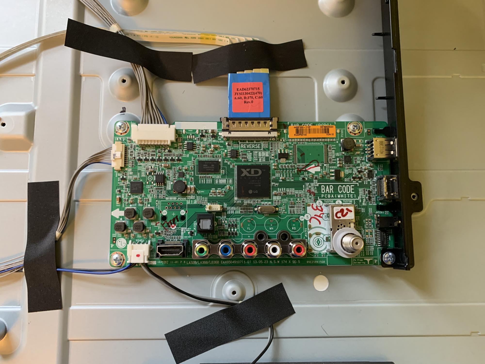

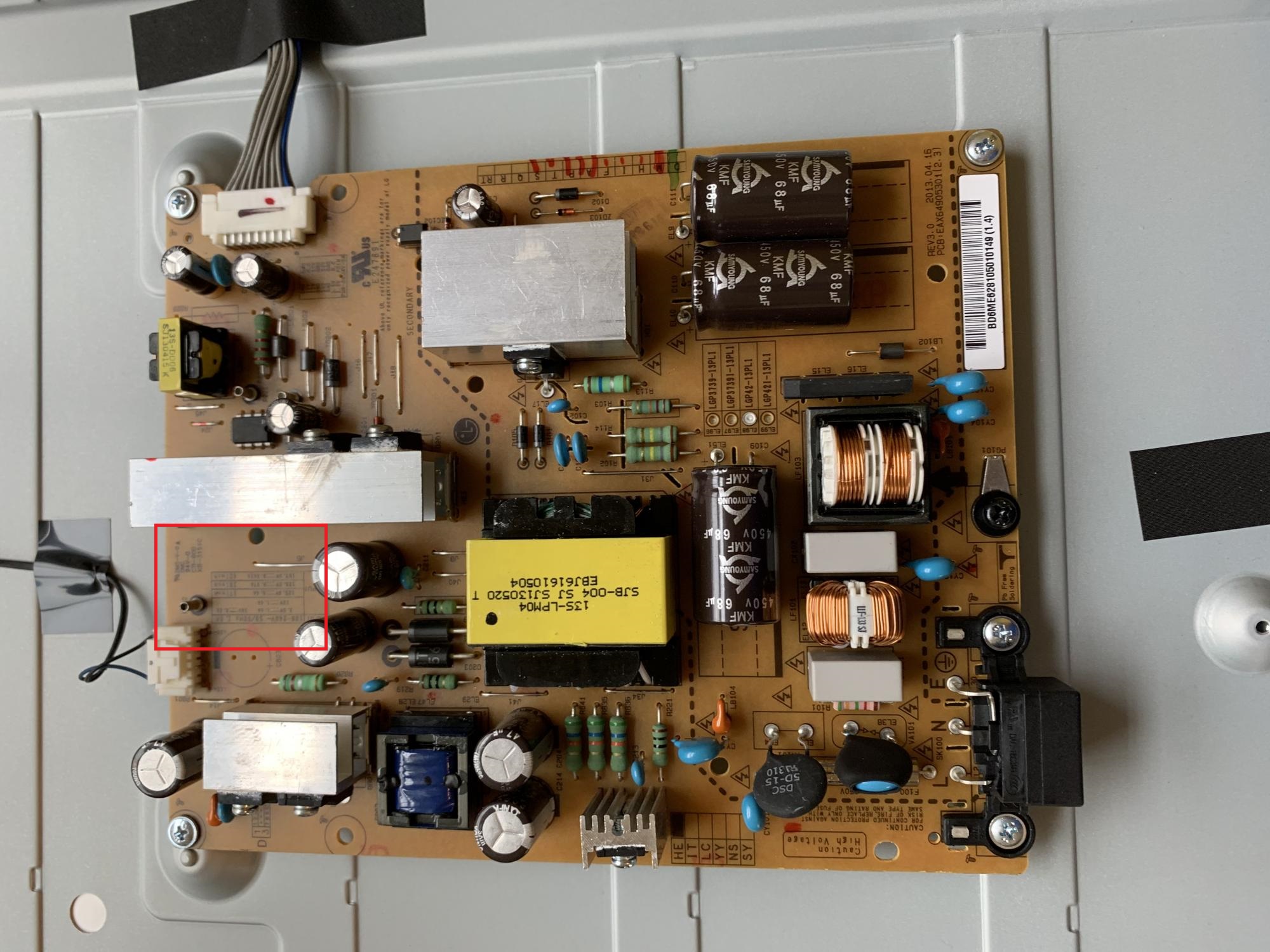

    Re: LG 42ln5300-UB won't turn on and only has standby voltage
    Post some good clear straight on pictures of each board and one of the whole back so we can see how they are connected, for pictures just hit go advanced and manage attachments, try test number 3 below, report voltages.
    • NickIsFluffy
      • Apr 2020
      • 23
      I already said that I replaced the Main board AND the Power Supply board, but was still getting only a standby voltage, the red light at the bottom doesnt show anything, when I plug the tv in, it just stands there, not light, no picture, no sound, no nothing.

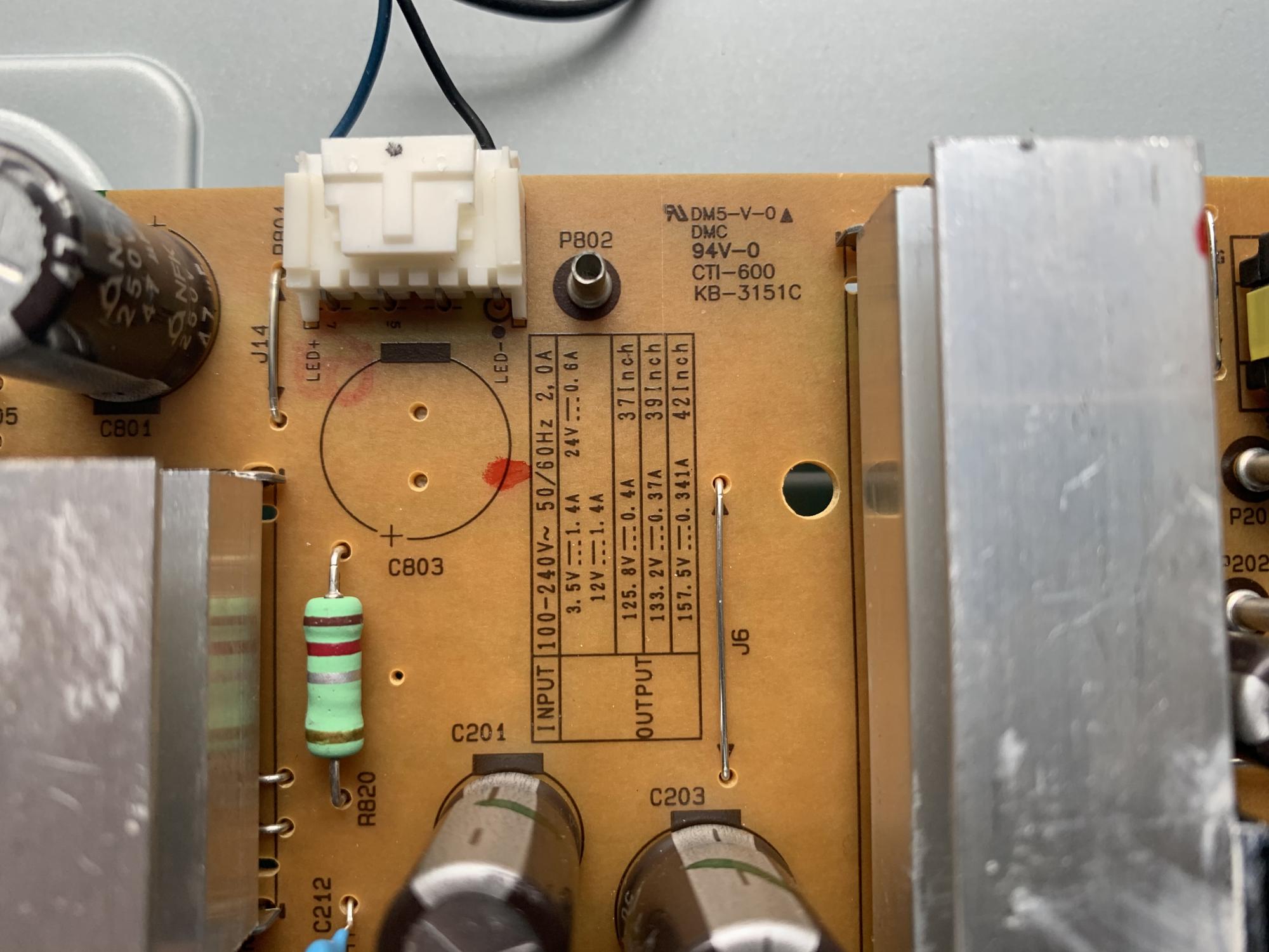

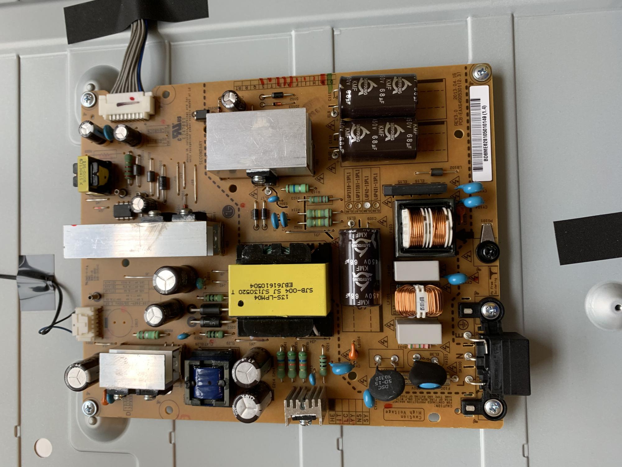

                  • dick_barton
                    • Aug 2015
                    • 6643
                    • Wales
                    Can you post a picture of this box. If you have 200V at the led, then I suspect you probably have a led problem.
                    • R_J
                      • Jun 2012
                      • 9566
                      The board outputs for a (42") 157.5v/ 341ma I agree he has an open led string.
                      how do I know that the On/Off is responsive
                      You use a meter to check the voltage on the PWR-ON pin when you push the power switch.
                          Yeah I attached it
                                        You said in an earlier post that the led voltage was 200V. The photo you posted shows that a 42 inch set has a led voltage of 157.5V.
                                        It looks as though you have an open circuit led(s) which is why the set appears not to be powering up. The over voltage protection is probably kicking in and powering down the power supply.
