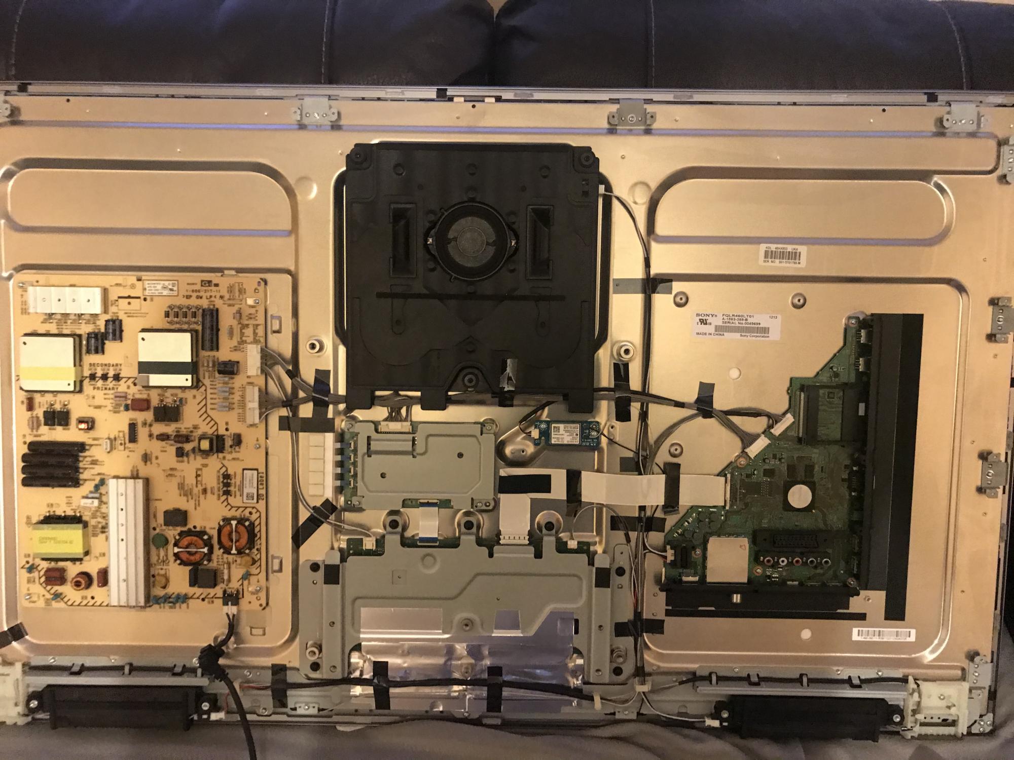

        Show us good clear pictures of the whole backside of the TV showing all the boards so we can see what we are dealing with.

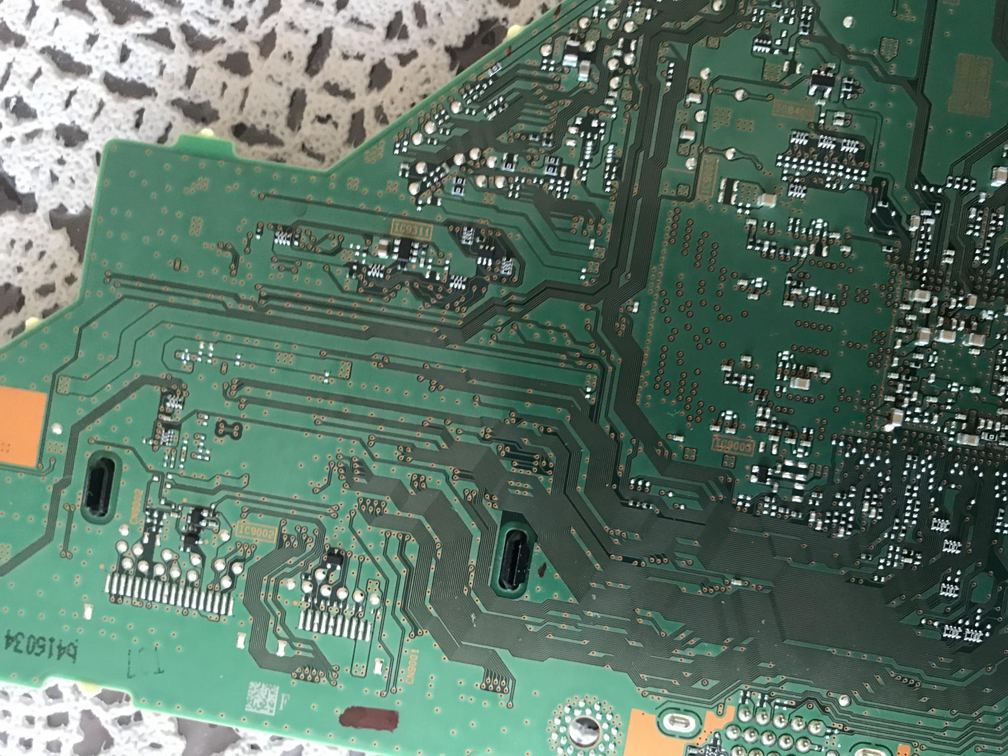

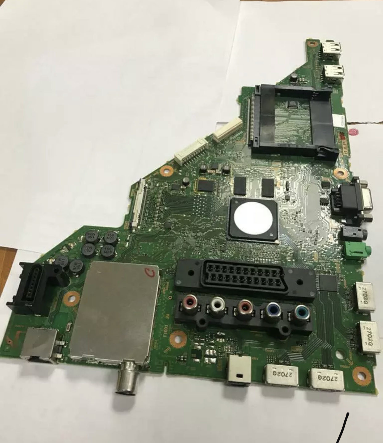

          Here’s picture of main board , I’ve checked voltages in power supply and they are all present, I got similar board I can salvage parts from, just need help to figure out what part has failed on main board as I don’t have schematic
          None of the 4 smd fuses on the main board are blown

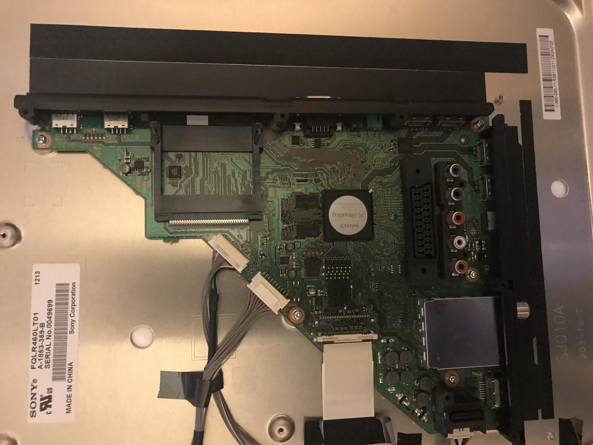

              Yes I never took pictures of the whole back if tv as I don’t have access to it yet but I will do

                      I understand the main board I showed you is the main board from my tv but the main board I got which is similar I just want it to salvage the parts from as all the smd components are the same with the same smd part numbers , only difference is the audio connector, I'll check that video you sent and report back

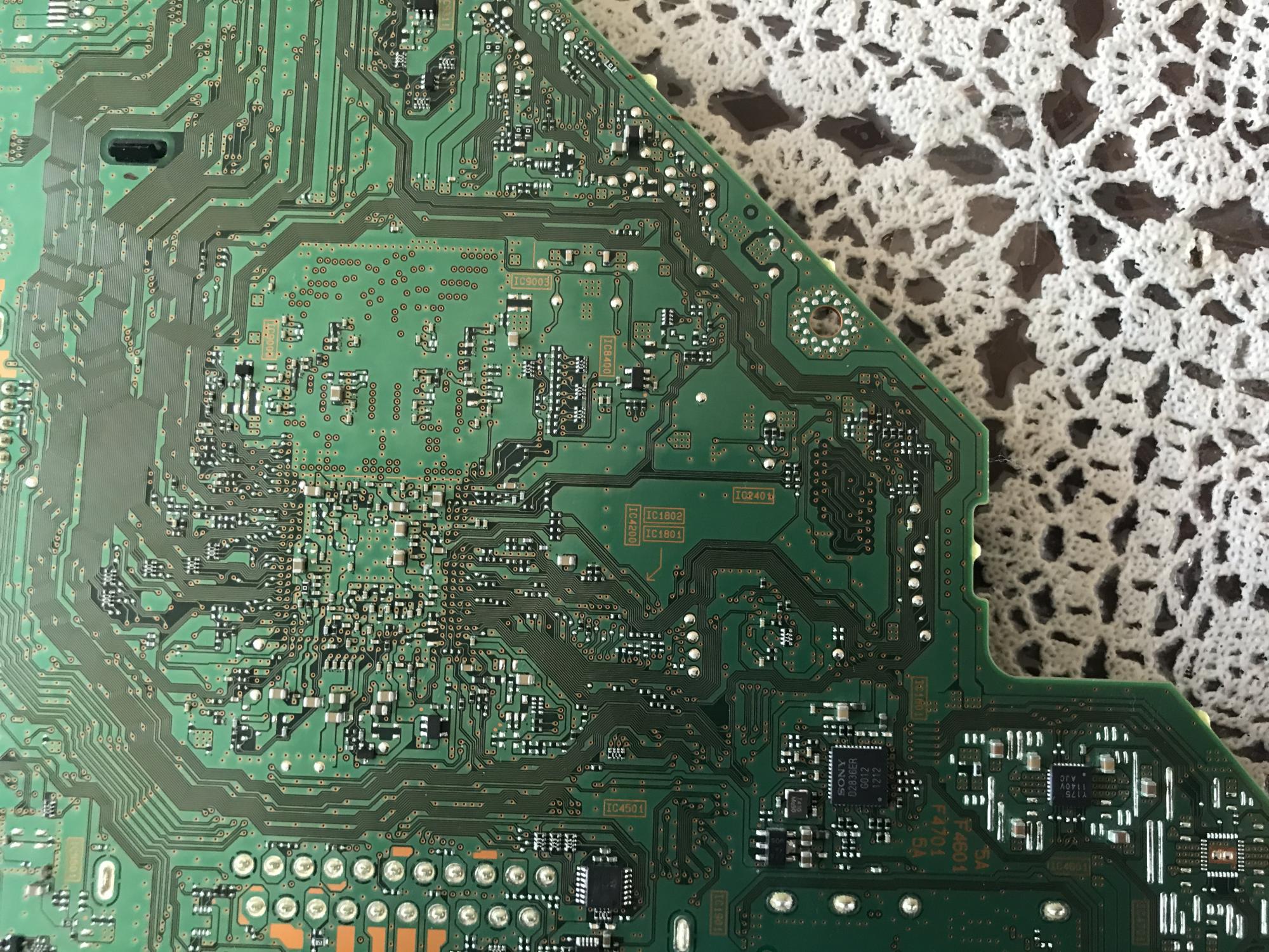

                            There's no regulators on the main board like in the video you told me to watch but here's close up pictures of the main board , I was thinking maybe it's a fault with a dc converter as there's no standby light but I got no schematic

                                When I plugged in the other main board I got , the standby light comes on so I'm presuming it's the main board that's faulty as with the original main board no standby light, I got backlight tester and I just need to figure out what the voltages should be in the first place, I got the pictures but if the main board was not faulty then I would have got blink code as it's a Sony and service manual says if there's standby voltage on pin 10 on main board which there is, it says it's the main board that's faulty so everything is telling me it's the main board
