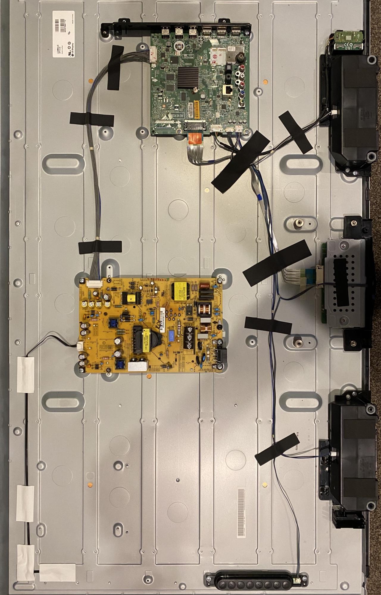

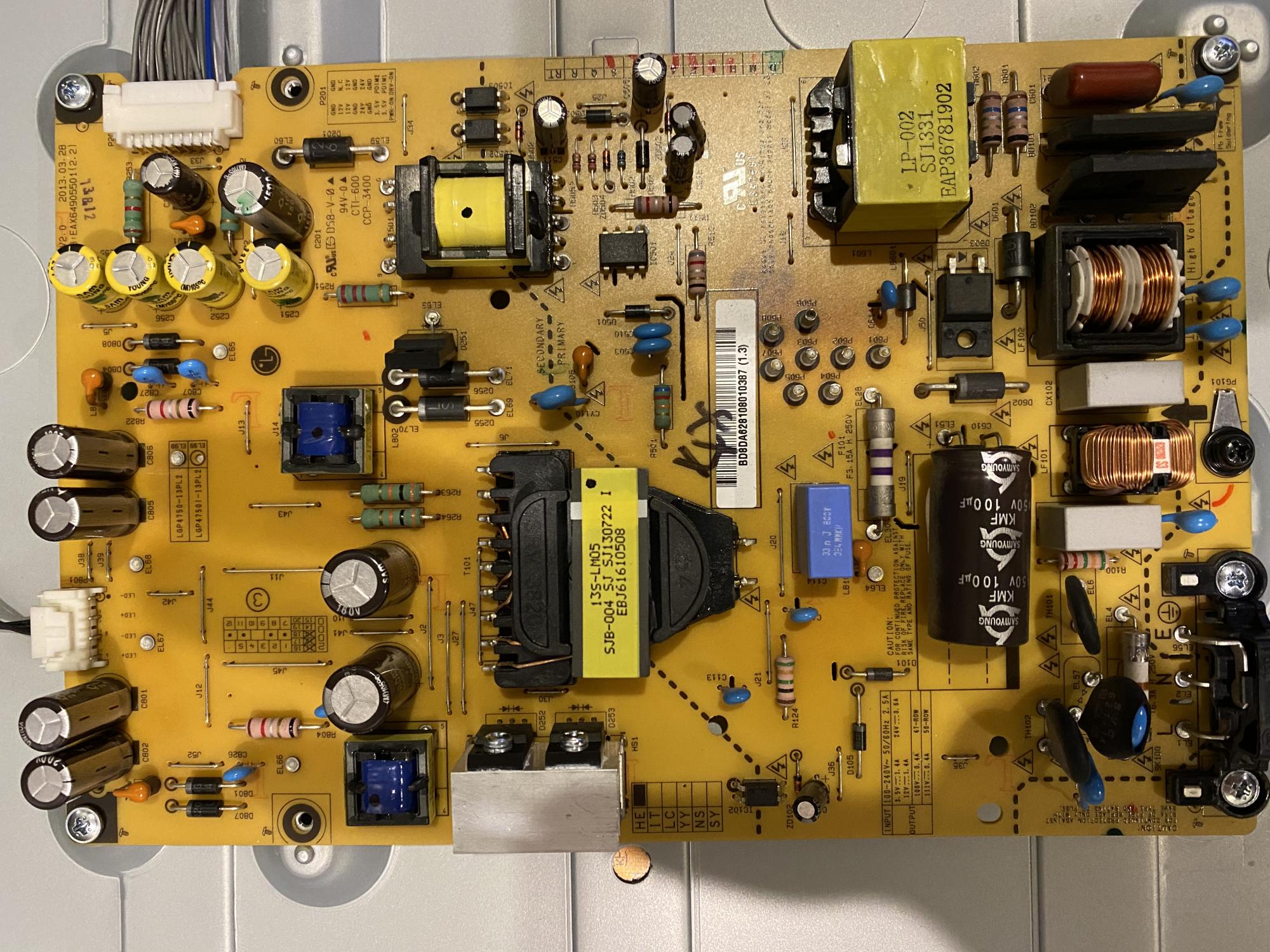

      Can we at least see the pictures of the backside of the TV showing all the boards?
      What is the power supply board P/N?

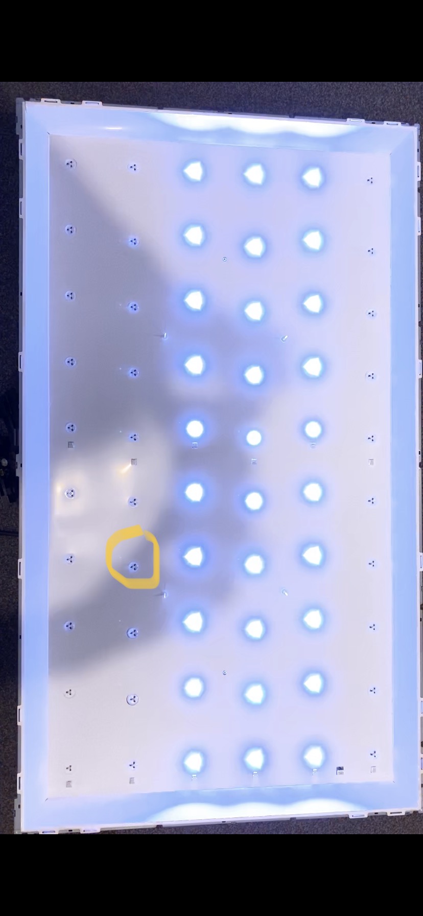

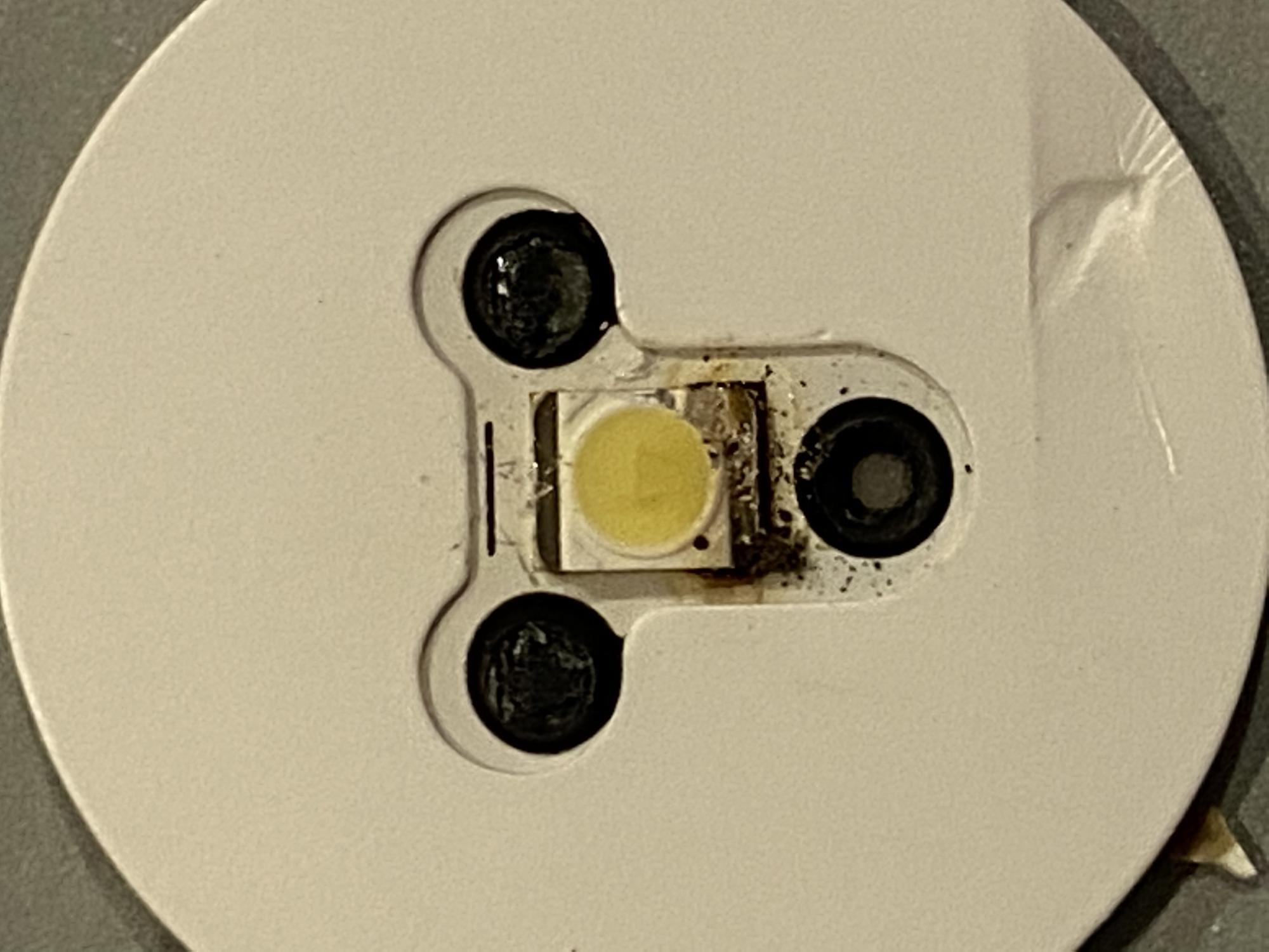

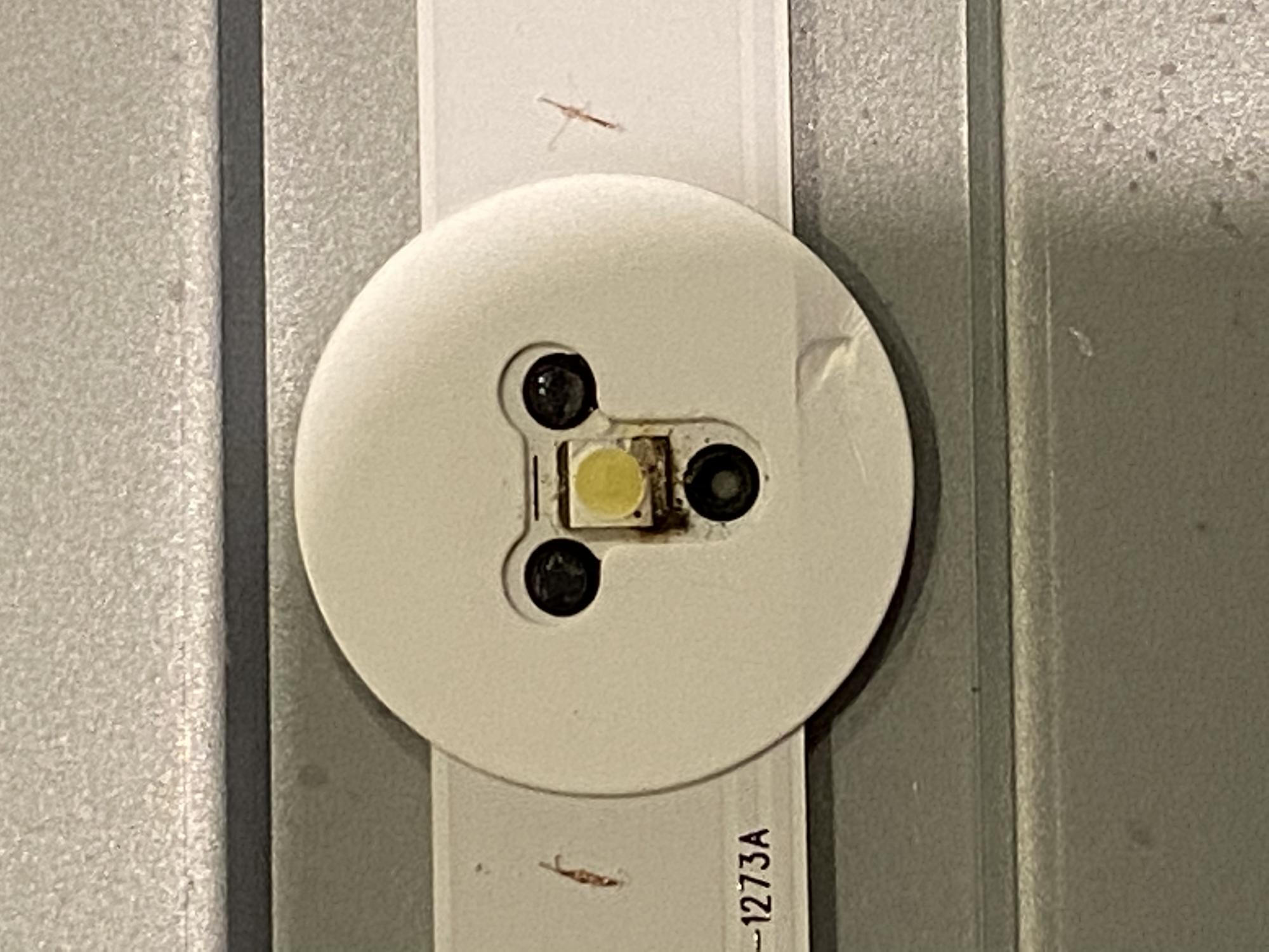

        So I think I found the led with the issue. 3 strips not lighting up all on the same circuit. One Led looked a bit different to the others so popped the diffuser off and found this! When I tested the led on diode mode with the multimeter it was ok though? Was I doing it wrong?
        Is it better to replace all the strips in that series or just the one with the blown led?
          Re: LG 50la6230 backlight issue
          Better to replace the whole set of strips.
