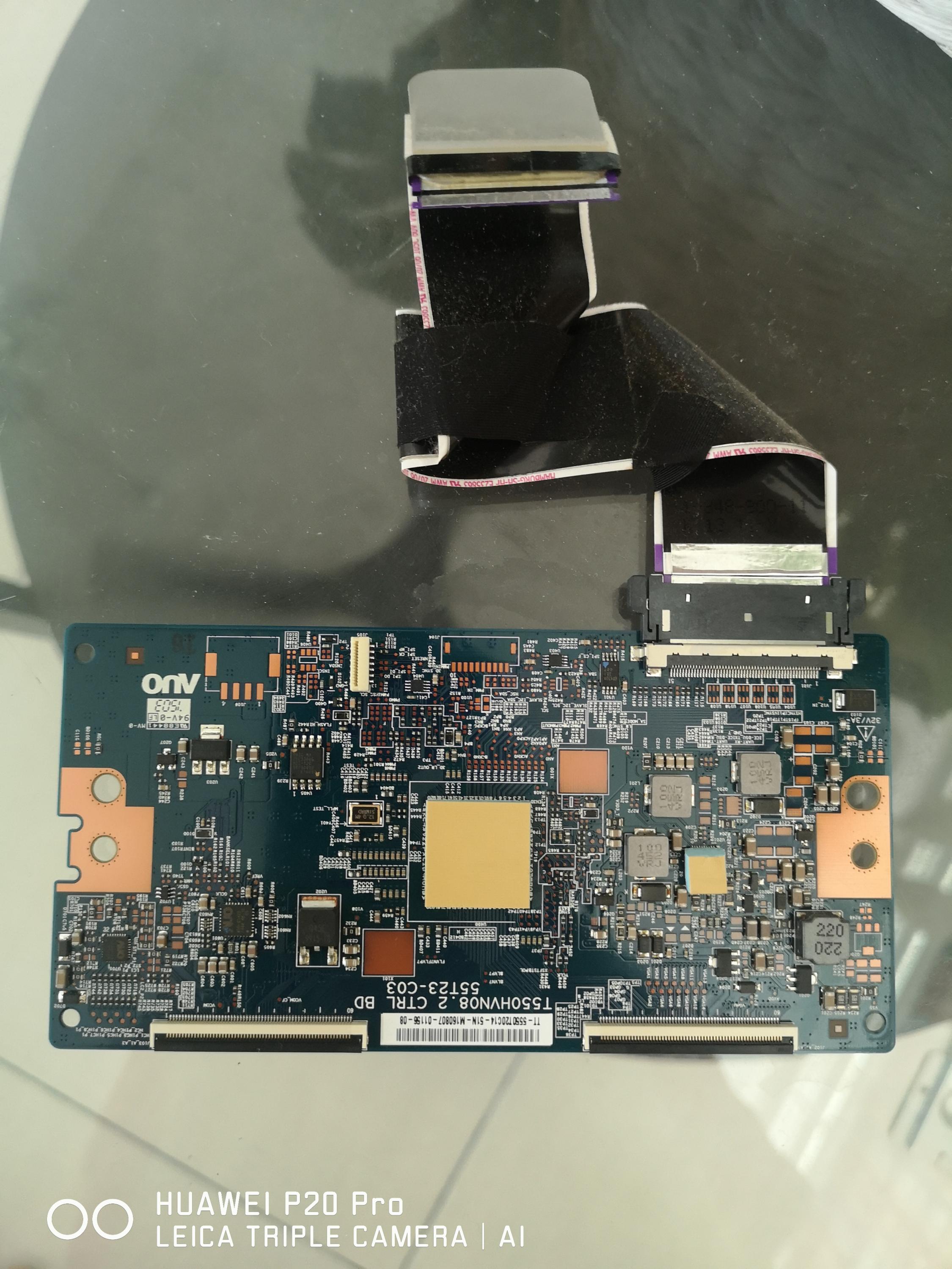

    Masta please help. I got problem with sony KDL-50W800C.
    BLINKING 5 times. Suspected tcon board . Bord tcon no is T550HVN08.2 CTRL BD. Anybody exp with this tcon. Maybe can advice . Flash fimware will solve? Coz n short on board

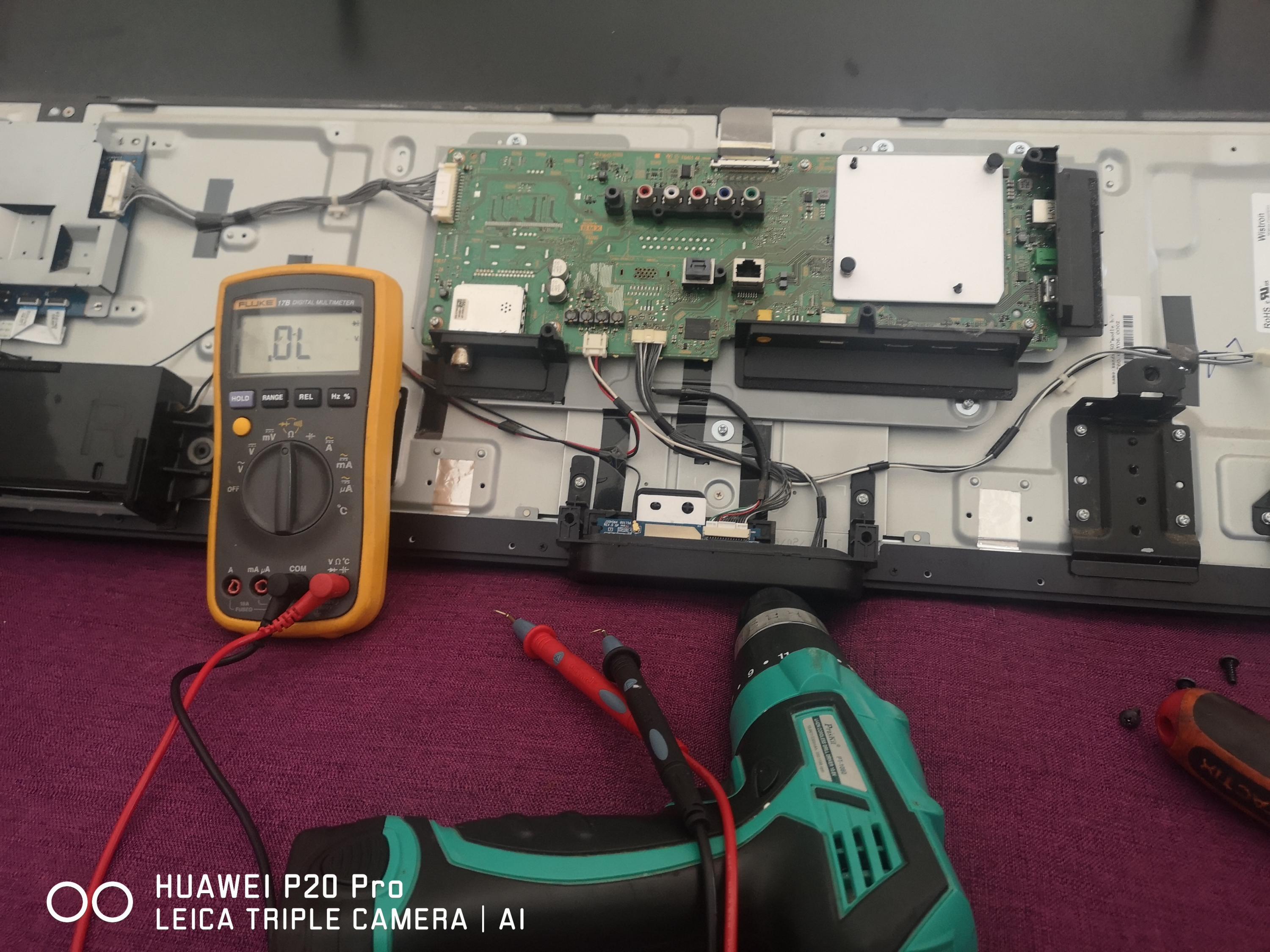

    If 5 blinks is the tcon, check for voltage on both sides of the fuse. I see it marked 32V/3A. Second test is to power up the tv with only one side connected at a time from the tcon and see if you get a picture one side.

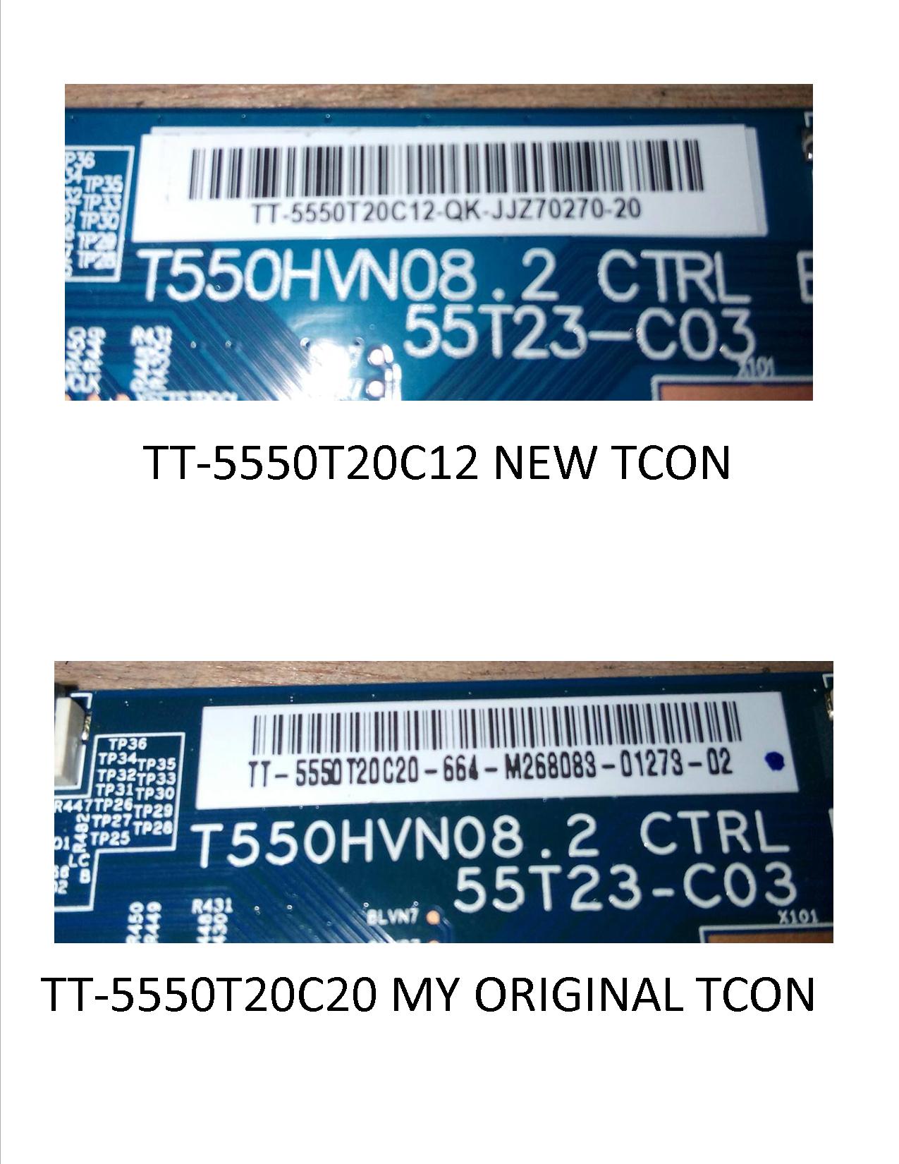

      Also "T550HVN08.2 CTRL BD" is the P/N of the Blank PCB not PCB assembly, you need to match the P/N as printed on the bar code sticker.

        Re: Sony KDL-50W800C BLInk 5 times
        Hye masta. Before i say thanks to both of sifoo. What i do is. I read back bios eprom on tcon. I put on my programmer. Then i backup and i place back bios ic. After that i pwr on with only one tcon. And i got display half. I pwr off then place both tcon cable. Wow display come back. Thanks u all
              Originally posted by budm
              What happen if you do not have ribbon cables between T-CON and the LCD panel connected, and if you have it connected one at a time?
              tcon is not compatible with my unit.. i already return the new tcon and replaced it with original tcon serial number and it works .. thanks for the time..really appreciate it..
                Thanks for the follow-up on the repair, I'm glad you get the correct T-CON.
                    I think he is saying that he got another new TC-ON board that match the barcode sticker numbers this time, that is what I understand.
                        yah i bought a new tcon similar to the serial number of my original tcon. its an eye opener for me not to lean only to the board number but to the serial number.. the two have the same board number but different serial number ...
                        Never stop LEARNING because life never stops TEACHING!
                          the number on the bar code is the PCBA (Printed Circuit Board Assembly) part number.
                          The T550XXXXXXX printed on the PCB is the Blank PCB that can be stuffed with many difference parts to make many required PCBA.
                              Indeed, you need to match up those numbers on the sticker, just going by model number is a no no.
