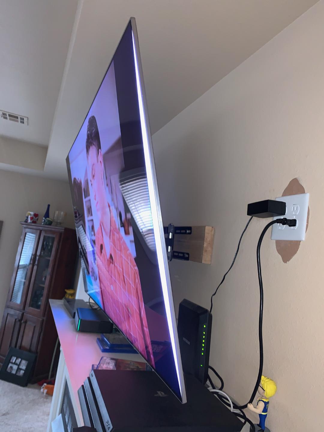

    We had to change our backlight repair policy to see if we can safely pull the new Samsung Qled panels with the Bezeless design due to the panel being held in with adhesive strips like Sony likes to do. The minute Yuppie Scum goes to mount that Tv over his FIREPLACE with a ambient temperature about 100 degree F or more he'll see that panel adhesive give way and start bowing like this fool. When I saw that I refused the repair and ran as fast as I could. We won't do backlight repairs on any Tv that does not have a bezel to hold the panel in. Look at the angle this fool had on this Tv and with that much heat I'm surprised the panel is not sitting on his floor by now. 2 year old Tv. I feel sorry for him cause Samsung wouldn't do anything for him. I suggested to put it back on the stand and find a different location. I never recommend putting any Tv over a fireplace. But that's the way Yuppie Scum is designing these new Preppy Homes nowadays. Pitiful

            Samsung quality has really gone down hill since the MU series and and the newer models are designed to fail prematurely and engineered to make it harder to repair even for seasoned technicians. Don't use the first video as a example on how to remove your panel. The second video is a panel repair facility with very expensive panel repair laser soldering machines that are not at our disposal but it does give you a example on how panels can be repaired when tab bonds are damaged. On the bezeless designed tv's the bottom of the panel fits down into a thin bezel and the other 3 sides use a wide strip of 3M two way adhesive to hold the panel down to the chassis. Even though it looks nice it's a recipe for disaster. Welcome to the world of todays Samsung engineering. MU series=bad panels...NU series=could be a array of poor quality problems. RU and TU series=usually bad backlights or poor quality power supplies and mains, as well as more shorts on the panel driver boards. QN series use surge happy power supplies, mains, and more panel driver shorts. Heaven help you if you have any backlight problem on the new NEO led Tv's after your warranty is up. And now they are admitting to the use of a Tv Blocker App secretly embedded onto your software where they can remotely brick your tv whenever they want. Do you really trust them to use it responsibly? A look at Samsung's reputation for being corrupt is a hint. Buyer beware and for all those that have newer Samsung's keep Auto Update off on software version updates. It's a shame because they have nice picture quality but designed to fail in 2 to 3 years now. Shameful.
