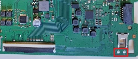

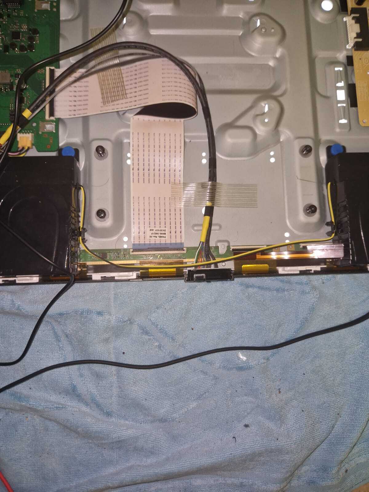

                  connect this 2 points together.... and then on the Panel buffer boards you have links and right ribbon cable disconnect one a time check there are no reboot and to see which side of the screen defect.

                    Yes, the backlight works with the "extension" to the right buffer board disconnected. But I am still only getting backlight and no picture whatsoever...

                      post photo here... of yours panel buffer boards left and right... dont use external site,, you can upload here
                      • Batata
                        • Oct 2024
                        • 11
                        • Deutschland
                        Sry for the speakers standing in the way.

                          did you put the jumper i asked you between the 2 point?
                          did you remove the masking you did before?

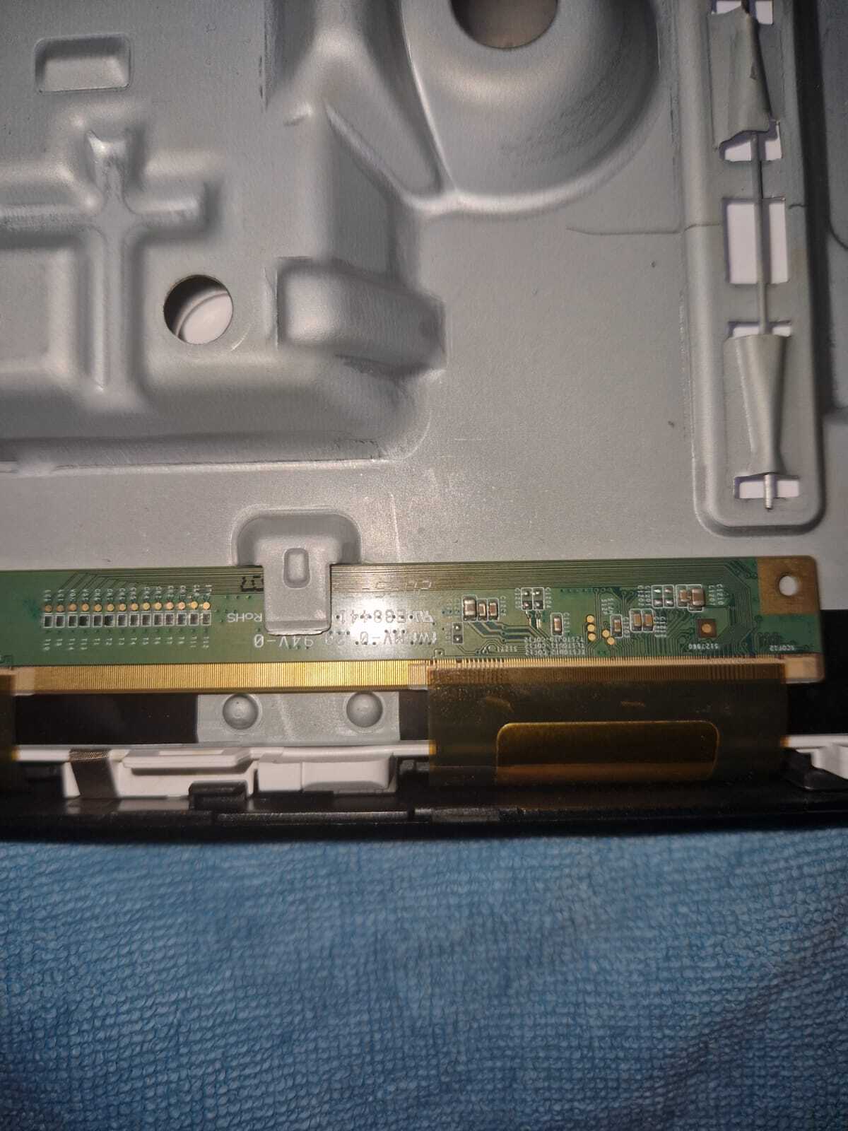

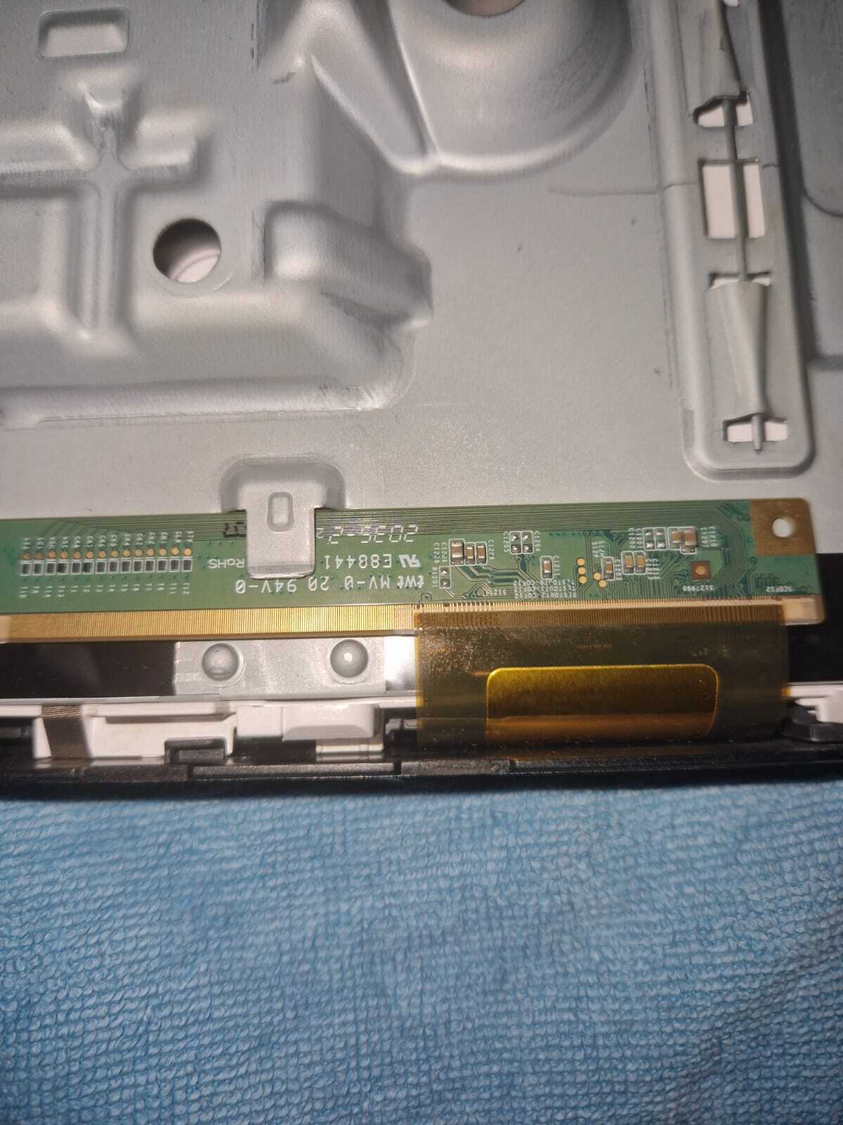

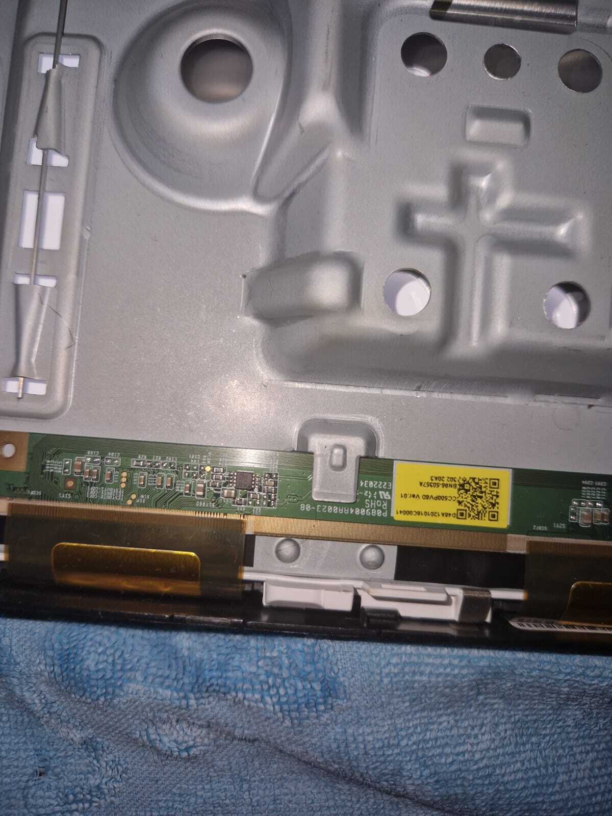

                          post close photo of the last 10 cm at the end of the panel buffer boards which you disconnected..
                          • Batata
                            • Oct 2024
                            • 11
                            • Deutschland
                            Really appreciate the help. I can't pick which side I connect the motherboard with. The main ribbon leads to the left side, and a smaller (U-shaped) ribbon cable leads to the right side. By connecting the 2 points, it doesn't matter if the small ribbon is connected or not, the TV keeps turning on and off. Without the 2 points connected, the small ribbon has to be detached to keep the TV on. No more masking tape anywhere. (Probably irrelevant, the small ribbon has up to 3 Ohms on some wires. I don't know how this would affect anything, but maybe someone does...)
ID:	3483824Click image for larger version
ID:	3483825 Click image for larger version
ID:	3483826 Click image for larger version
