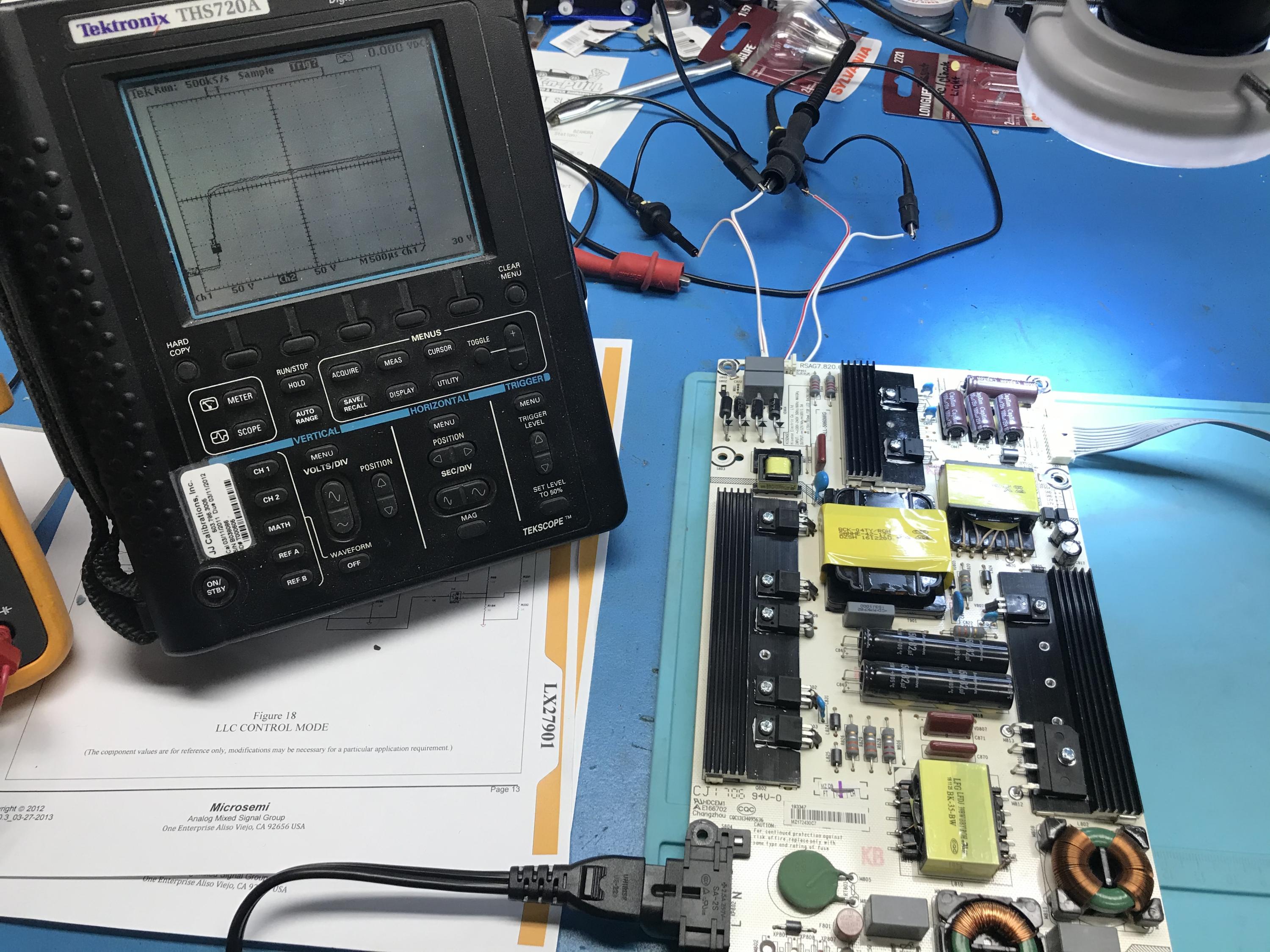

    Good morning bad caps -
    I have an Insignia NS55D510NA17 TV that I bought for $20. The there are 50 backlights in the TV and 48 or so are BLUE and this appears to be due to the yellow film/coating breaking down on each individual LED. (See picture; camera picks this up as purple... they are really blue). The LED itself looks to be an exposed die. There is no plastic package for them. I couldn't find much information about the LEDs or a direct discrete replacement either. These come from the LED strip - SVH550AC3_5LED_REV05_150410.
    Anyway, I would like to replace these LEDs with 1W (3.3V @ 300mA) Samsung LEDs that i have on hand. The power board is a Hisense RSAG7.820.6106/ROH. The output specs is 170V @ 700mA ( 3.4V @ 700 mA each == 2.4W).
    The LED backlight controller is a MSC LX27901ID. The datasheet is here from the Microsemi website. What i can't find is application information on how to reduce the output current to the LED string. The datasheet references the BRTA pin as the "terminal for programming the analog LED current setting. An analog signal is accepted from this pin to set the reference level for the LED current control loop" -- but there are no equations available in the datasheet that specifies the calculation. I was also hoping to drive the LEDs at a lower voltage, but the datasheet doesn't have a good equation for that.
    I'll do some component traces and share the circuit here today.
    Maybe i should file this under the "I could spend my time working on something else" projects. I could have just purchased a new set of LED strips for $65 or so from ShopJimmy... but I figure lets just mod the strips and the SMPS instead.
    Thank you,
    Thomas

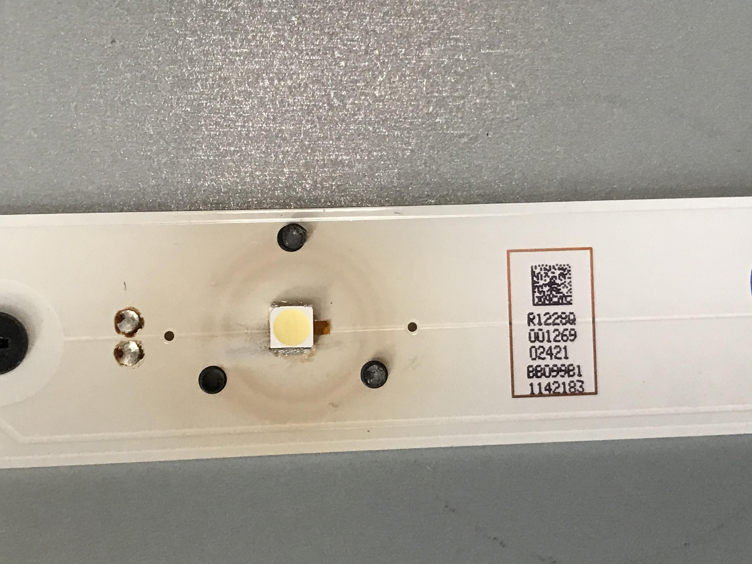

      The original LED is tiny - just a bare die with no plastic. There are no LEDs that i could find that match this - nor would i want to rework these small ones as-is. The pads were MAYBE just 1mm wide by 2mm.
      I removed the white soldermask from each LED location to expose the top side copper of the positive and negative. I put some Kapton tape in the middle to ensure the positive and negative sides of the target LED don't short out. I've done this before with other incompatible pads. This one won't be driven past 70% since I'm just going to use it as a second garage TV.

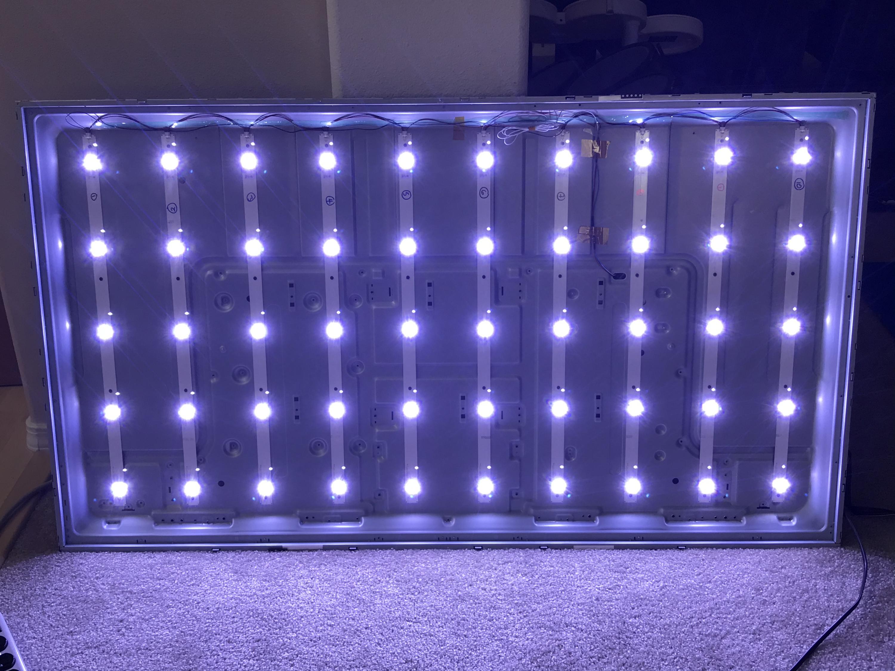

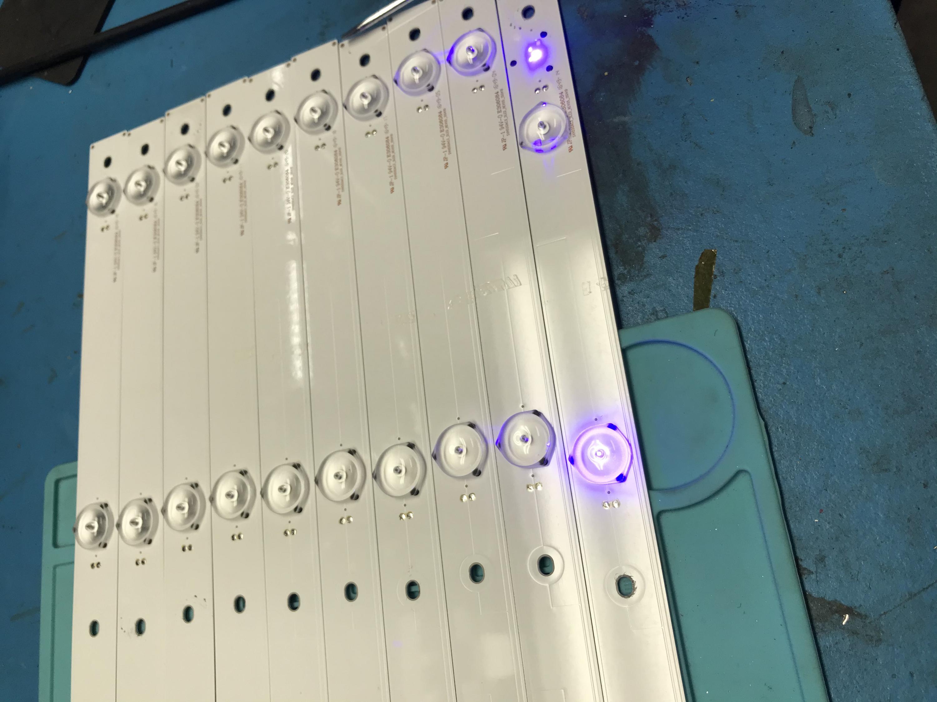

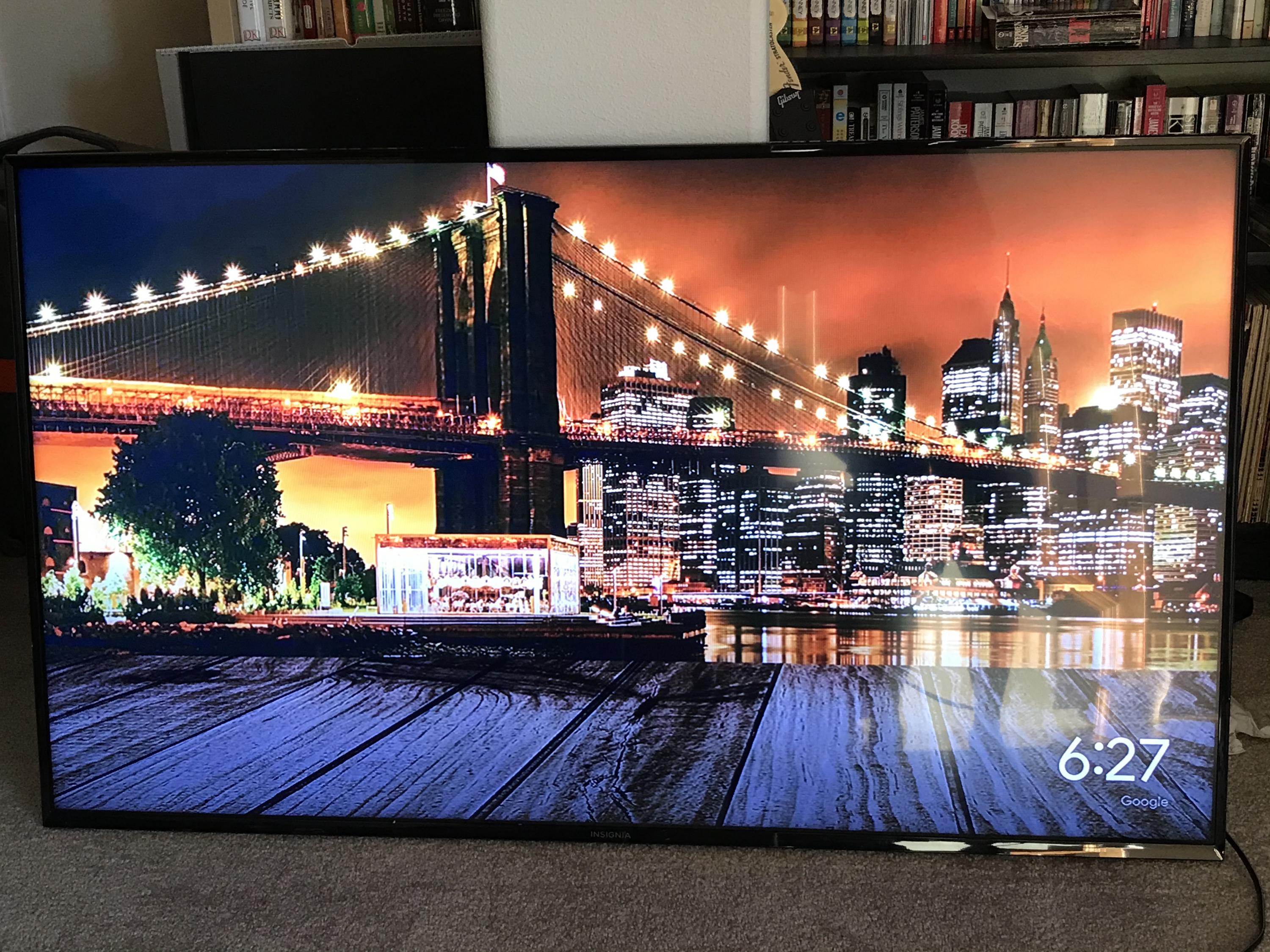

          Update: TV fixed.
          In post #3, I said that the SMPS has two outputs for two strings at 170mV and presumed the backlights were wired as two independent strings.
          In reality, the backlight is wired as a SINGLE string while the SMPS has two current balanced outputs.

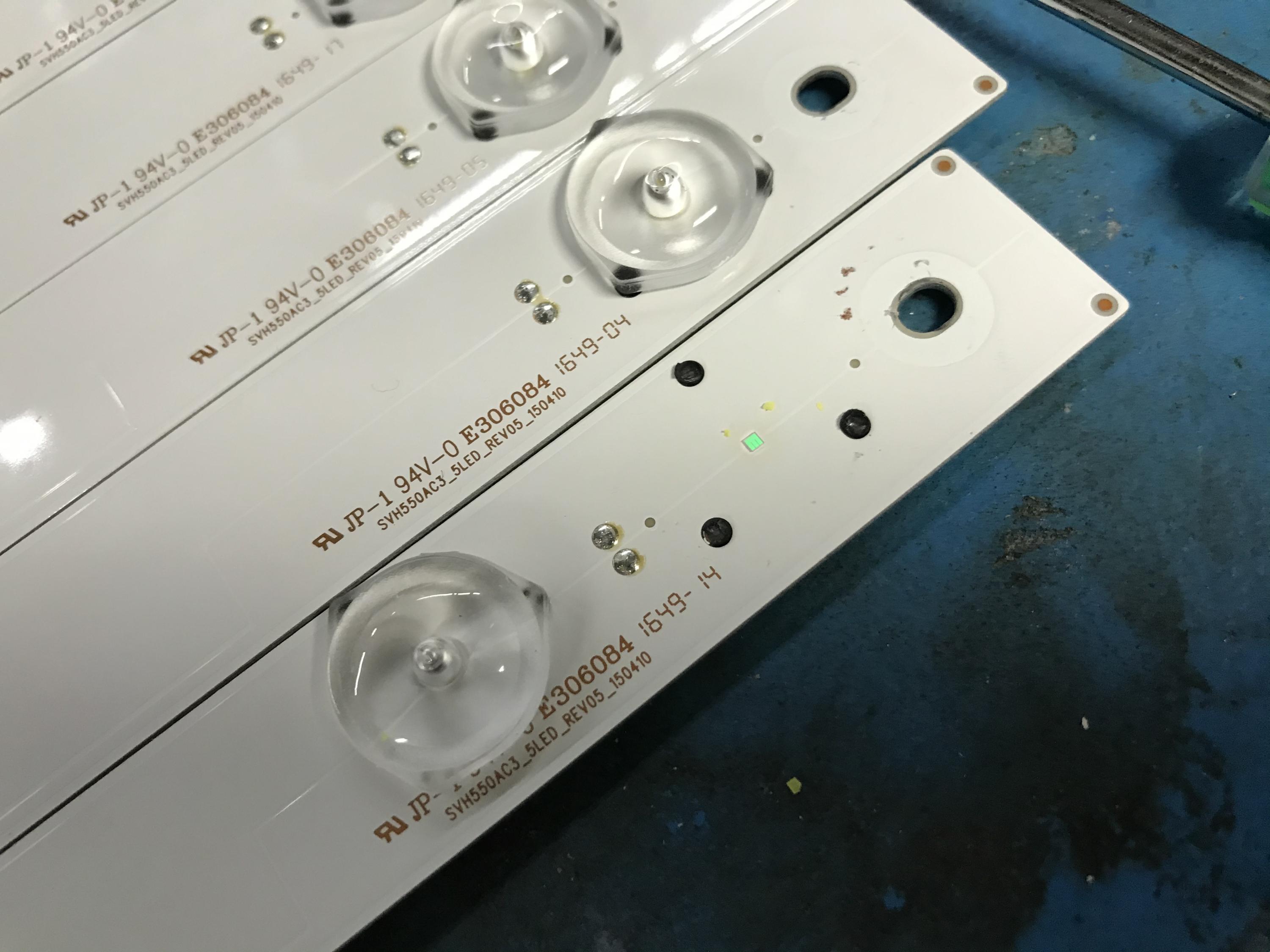

          As previously noted, the original LEDs are bare die and tiny. I found 6V LG LEDs that are substantially larger and modified the physical LED strip by removing white solder mask to expose more copper - i used a Dremal and a wire brush to make quick work of this. Kapton tape was added between the positive and negative legs to prevent a short. I added solder paste to the new "pads" and reflowed the LED with a heatgun from the bottom. After that, i checked both pads under a microscope to ensure there was sufficient solder fill. I added more solder paste and reflowed it again if there wasn't.
          I rewired the LED strips as two separate strings. 25 LEDs per string at ~6V per LED. Measured current is 350mA per string after I completed the modifications. The backlights completed an hour long burn in test. They worked fine at full brightness.
          The TV was reassembled and works fine. Looks like I have a second garage TV going up soon!

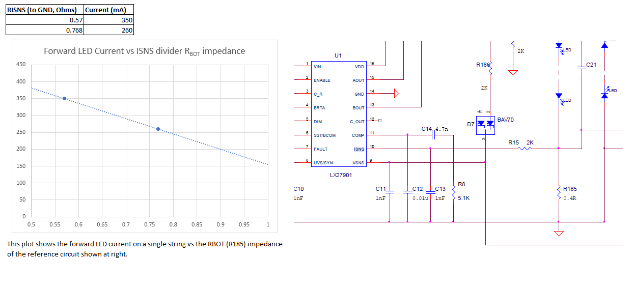

            As far as reducing LED current, read ISNS page 5 and 15 of the spec sheet, if you increase the value of the resistor (R100 in application circuit, it shows 0.40 Ohms but your board will be different) the LED current will decrease but it has to be above 100mV and below 600mV. See fig. 19 page 14.
            I would reduce the current down to around 200 ~ 250mA max.

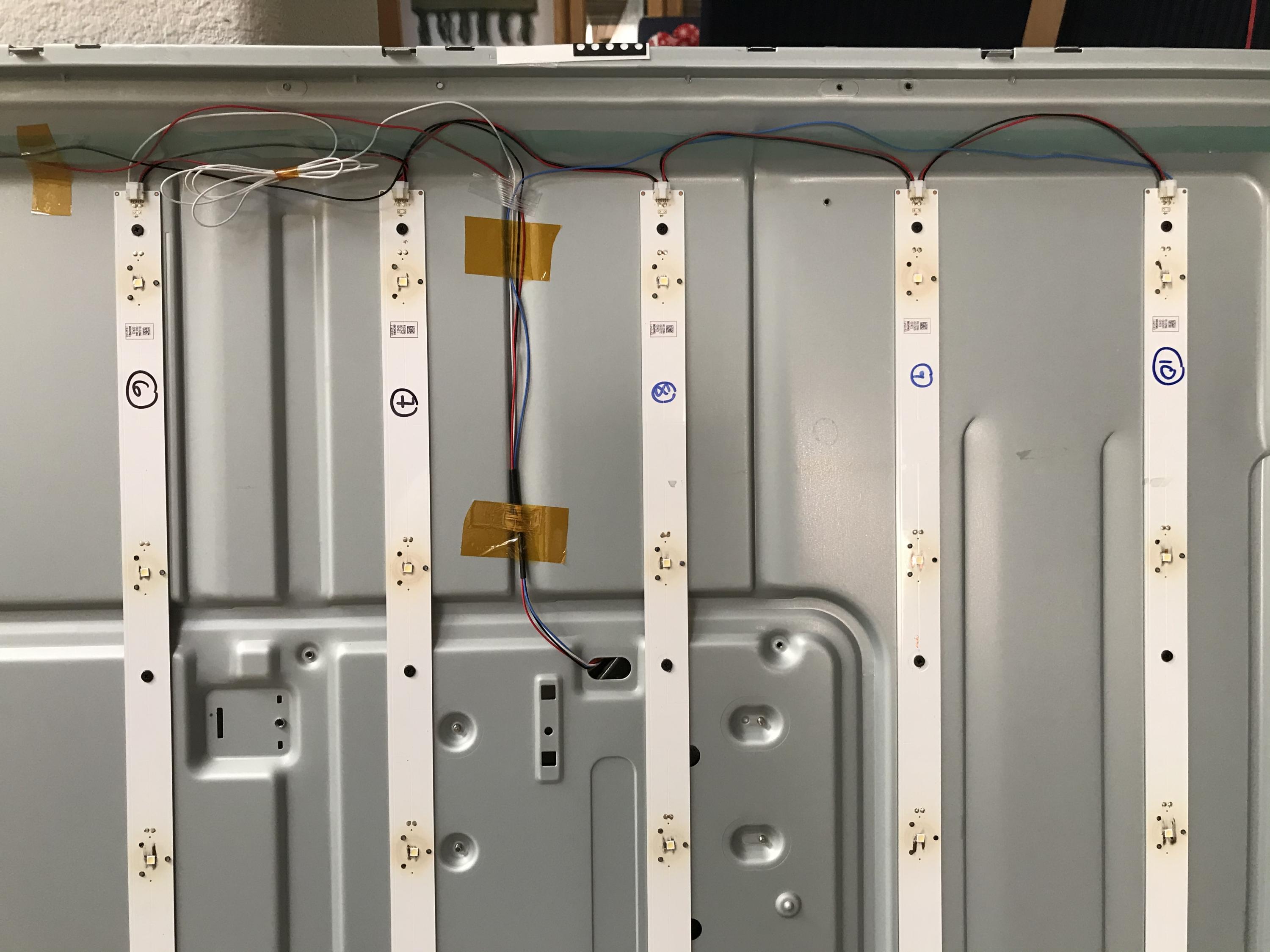

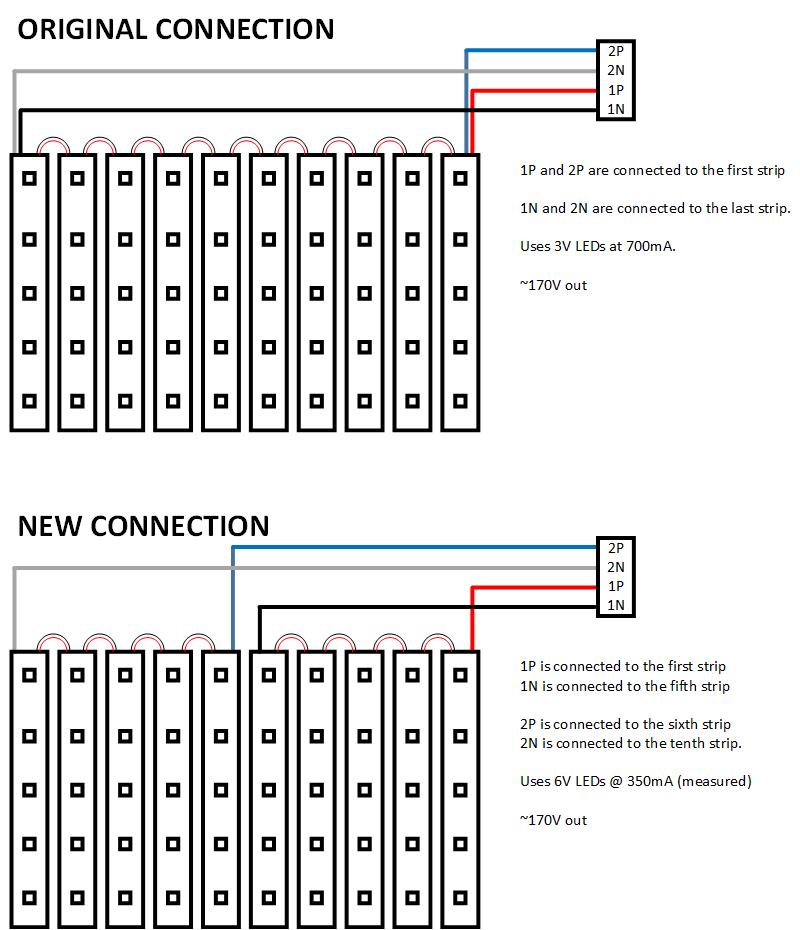

              Maybe a picture is worth a thousand words.
              The top half shows the physical LED topology from the factory. 50 LEDs as a single string. 170V output max and lets assume ~20V drop across the MOSFET (i didn't measure it though and the TV has been reassembled now). That would be 3V LEDs that were originally installed.
              Also in one of the earlier posts i said i didn't measure the LED voltage before popping them off the strip. Also, my original assumption was it was two physical strings but that was based on looking and measuring the output from the power SMPS only without looking at the physical connectivity of the backlights, by this time i had already replaced the LEDs with 6V LEDs.
              The bottom half of the image shows what i did to the physical LED string connections after installing the 6V LEDS -- I made it as two separate strings - 2 strings of 25 @ approx 6V each. The measured current through each string -- approximately 350mA.
              -Thomas

                But if you look at the board connector the 1N (Cathode of #1 string) and 2N (Cathdode of #2 string) are connected together, the 1P and 2P are not connected together but connected to separated drive circuits which you can see there are two grey caps (C922/923) one for each string.
                350mA is still way to high.
                What is the spec of the 6V LED? That will be power dissipation of around 2.1W @ 350mA! I doubt that your LED is rated that high.

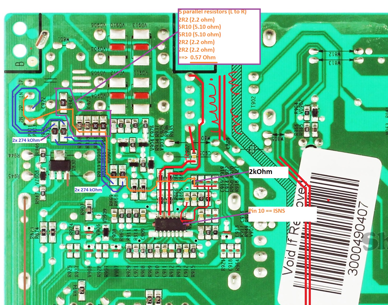

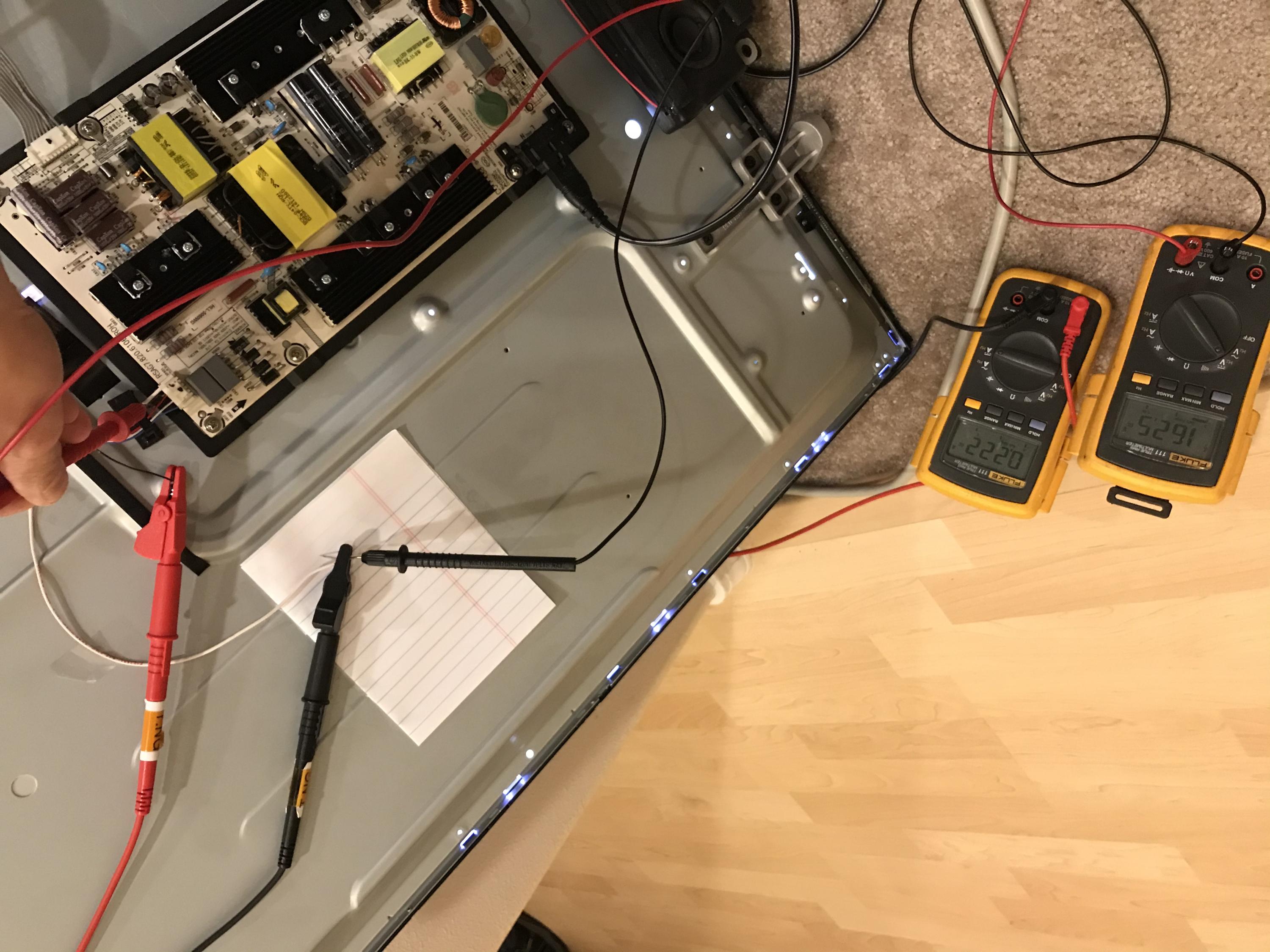

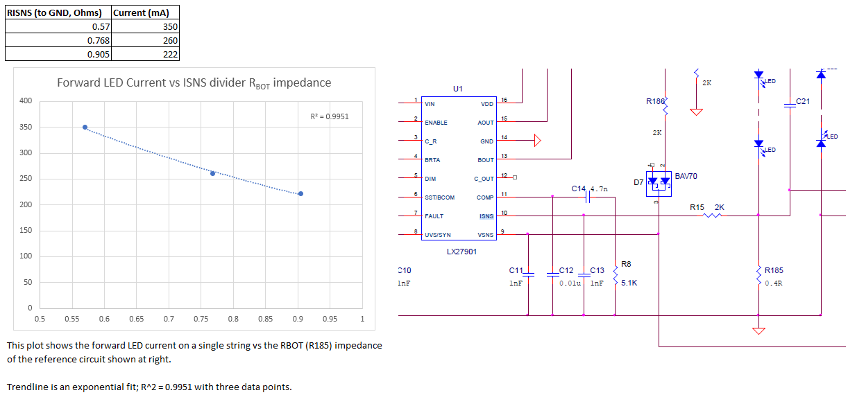

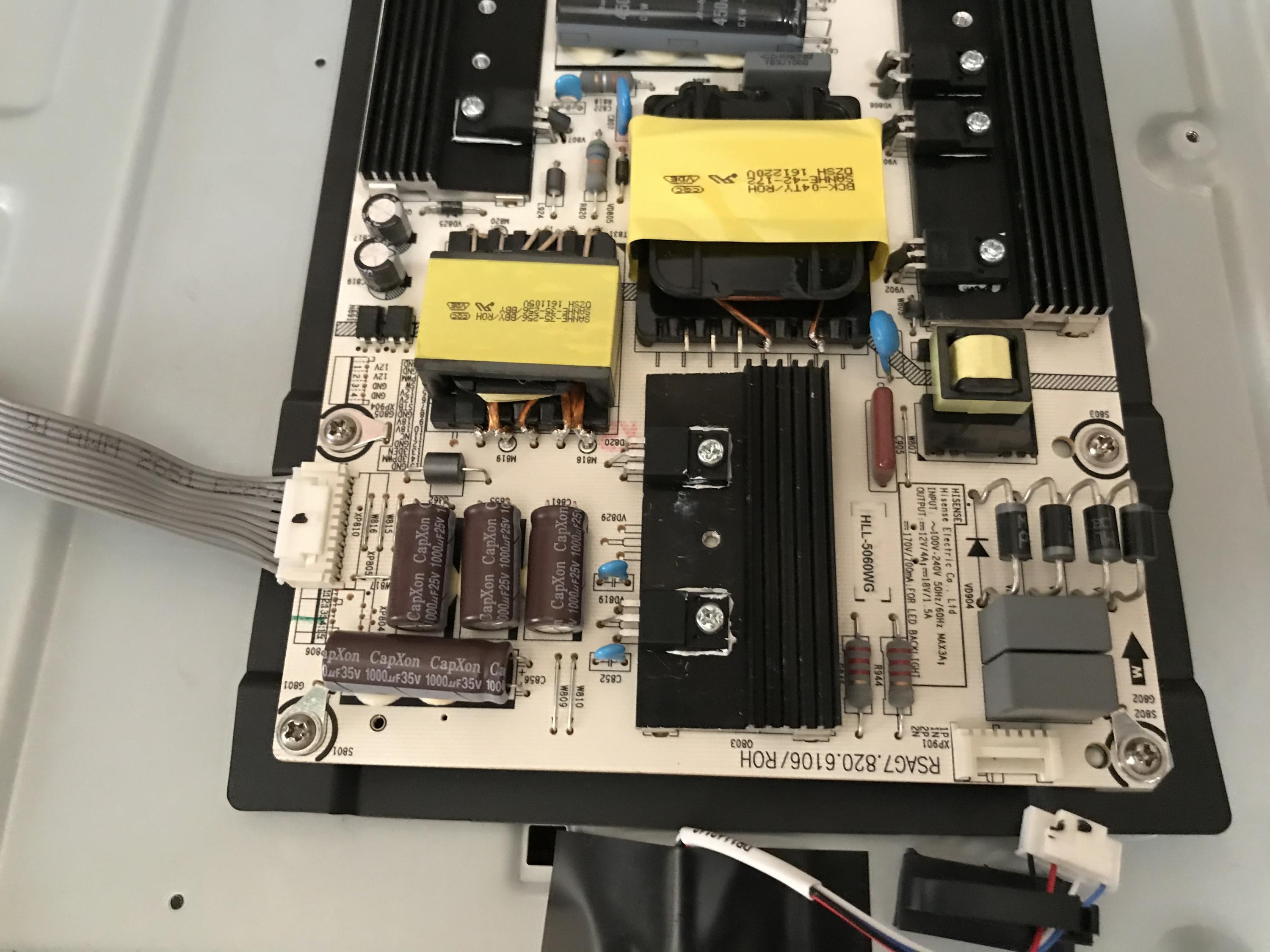

                      Alright, i think i have this mostly traced out and have a working solution
                      The first image shows the bottom side of the board markup. I tried to find the ISNS components from Pin 10 of the IC. I used Figure 18 in the datasheet as a reference for this portion.
                      Starting at pin 10, I found a cap immediately "north.". There is also a trace that goes under the backlight IC and veers off to the right, through a 0-ohm resistor then has four pads for resistors. Only the left most pad is populated - a 2kOhm resistor with SMD marking "2001" on top.
                      If you follow the orange line to the left, there are five parallel resistors. From left to right it's 2.2 Ohm, 5.1 Ohm, 5.1 Ohm, 2.2 Ohm and 2.2 Ohm... 0.57 Ohm equivalent resistance. With this circuit as-is, i measured 350mA across a string of 25 LEDs. ~170V across all 25.
                      I removed the left most 2.2 ohm resistor (R942). The new equiv resistance is ~0.768 Ohm. At full brightness, the measured forward current is 260 mA, ~166V for the string ==> 6.64V per LED or 1.73W each.
                      I think this is much more in the comfort range. I'll bump it down a little more. With the linear trend line, i should be able to hit 225mA or so around 0.85 Ohm.
                      This may be a tomorrow thing. With COVID-19 and the order to stay at home, we're taking advantage of the time for family game night.

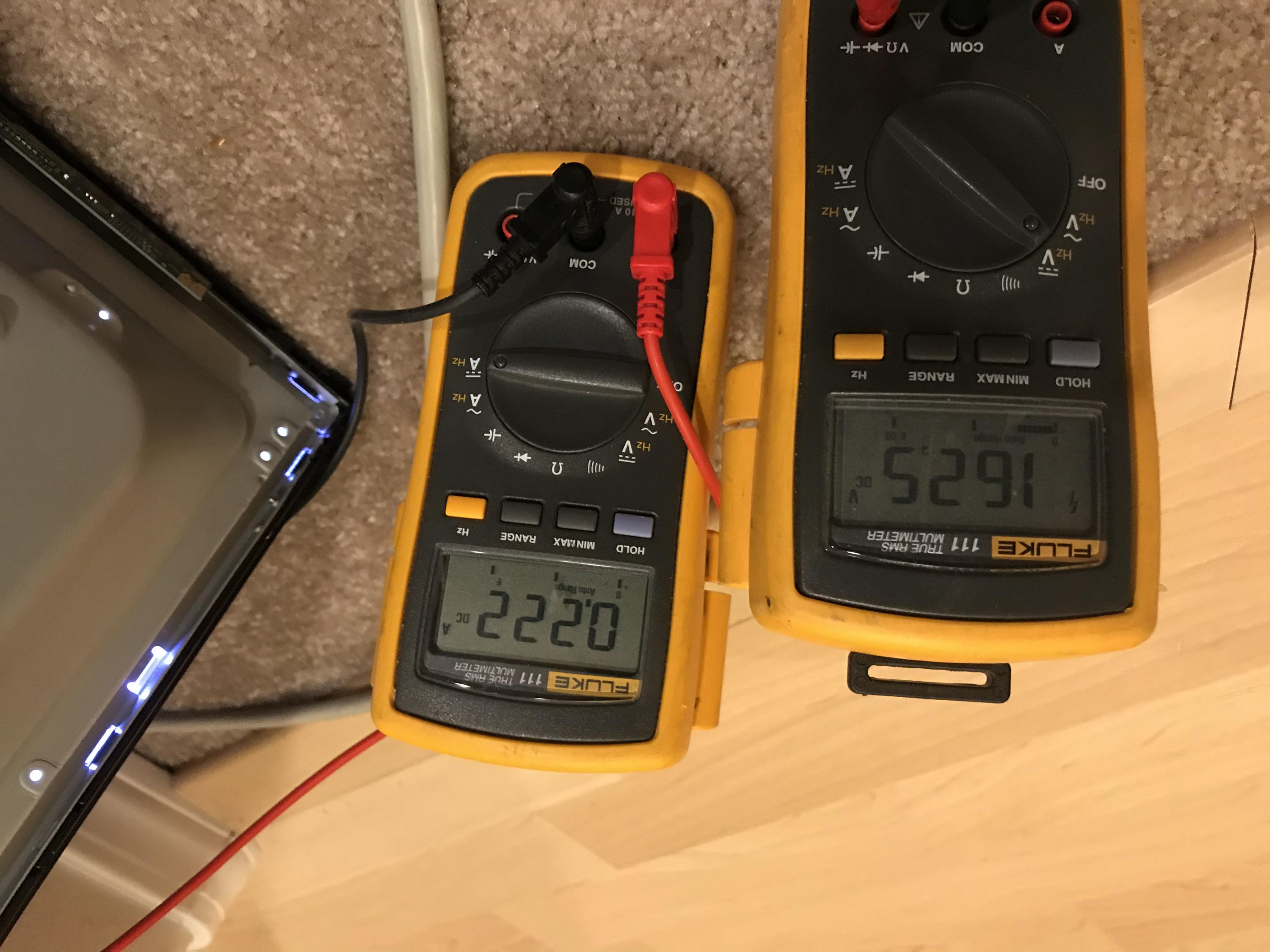

                        Re: Modifying Insignia NS-55D510NA17 SMPS for lower current LEDs

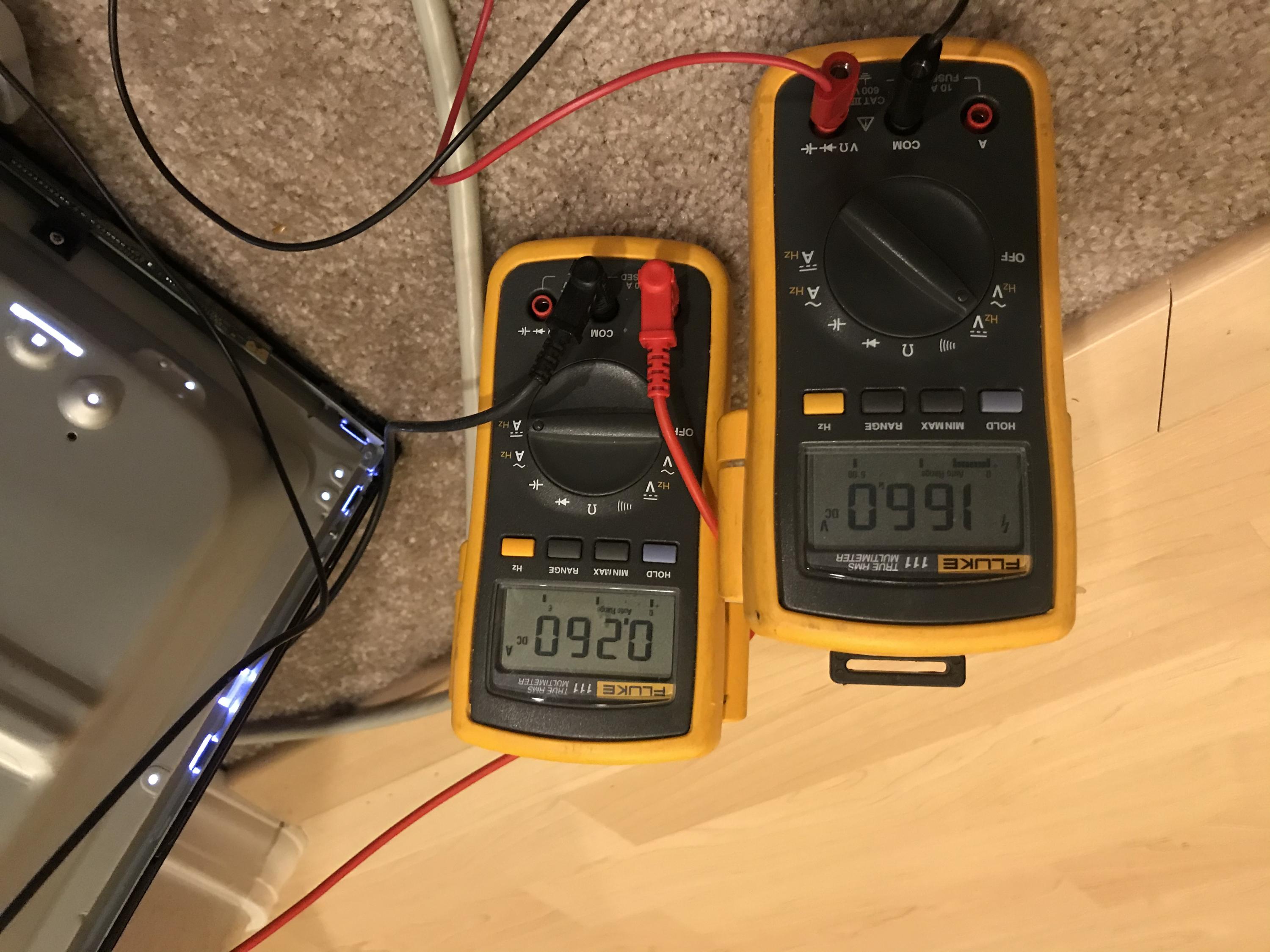

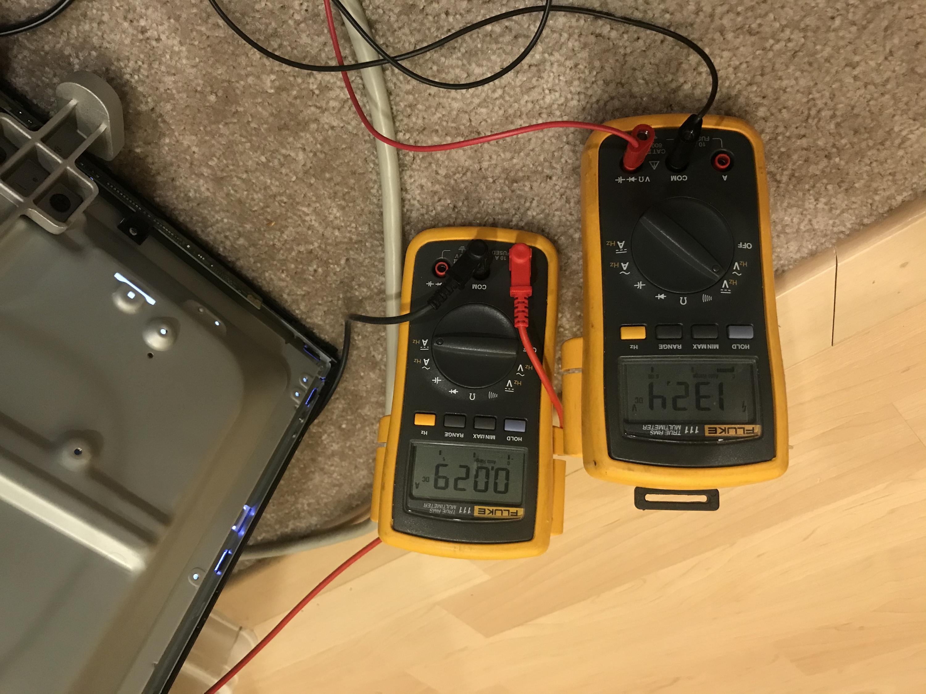

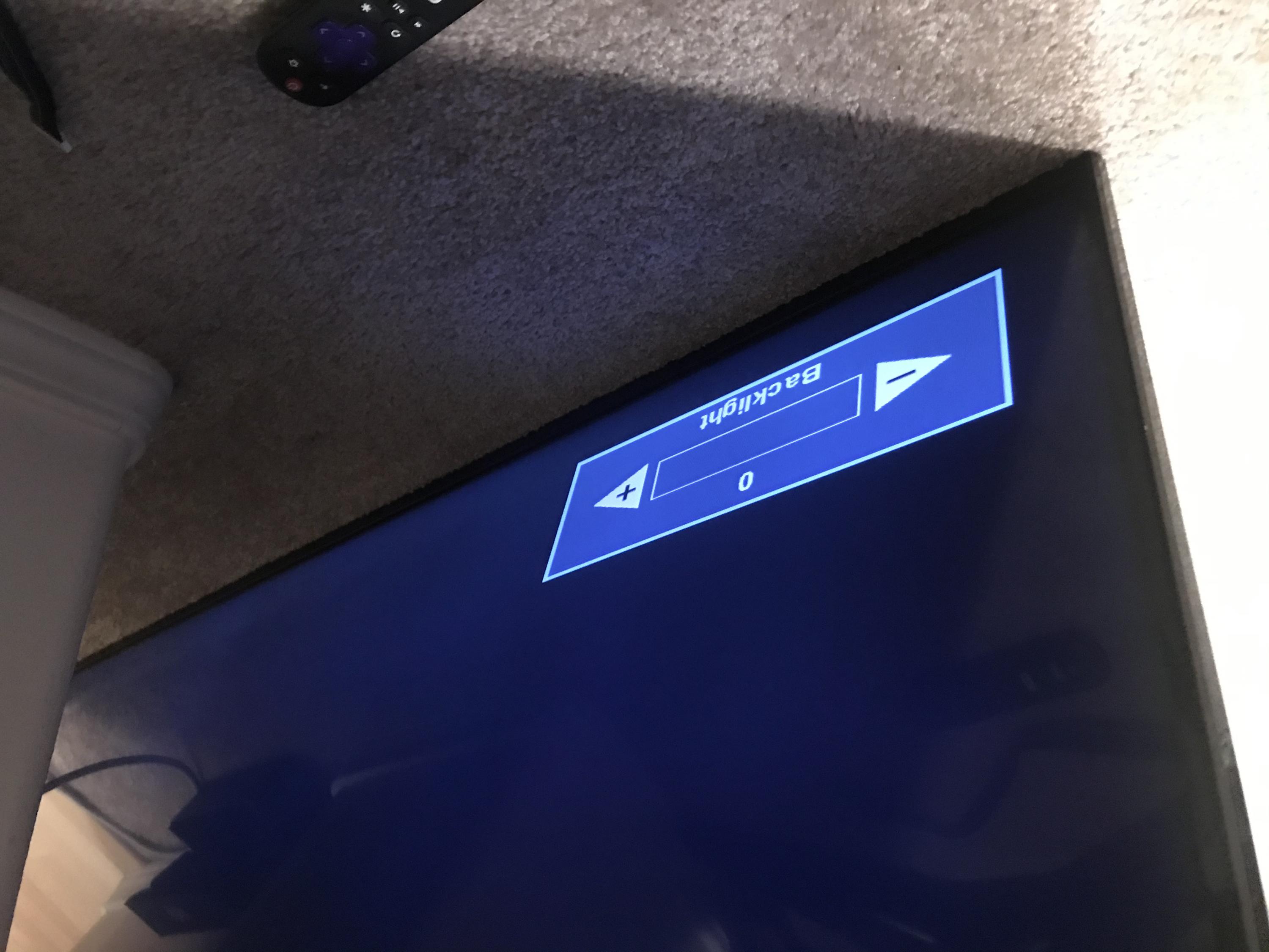

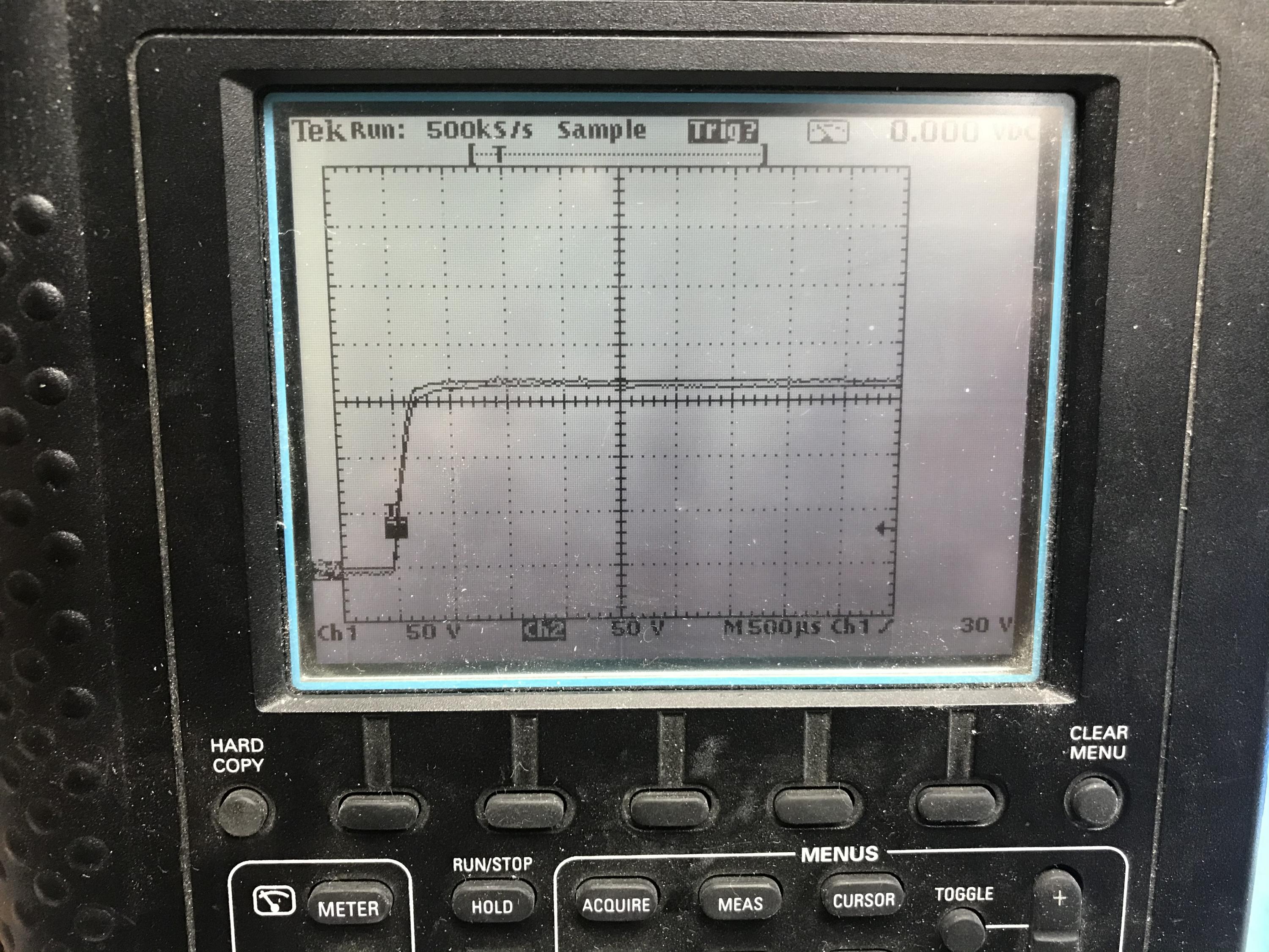

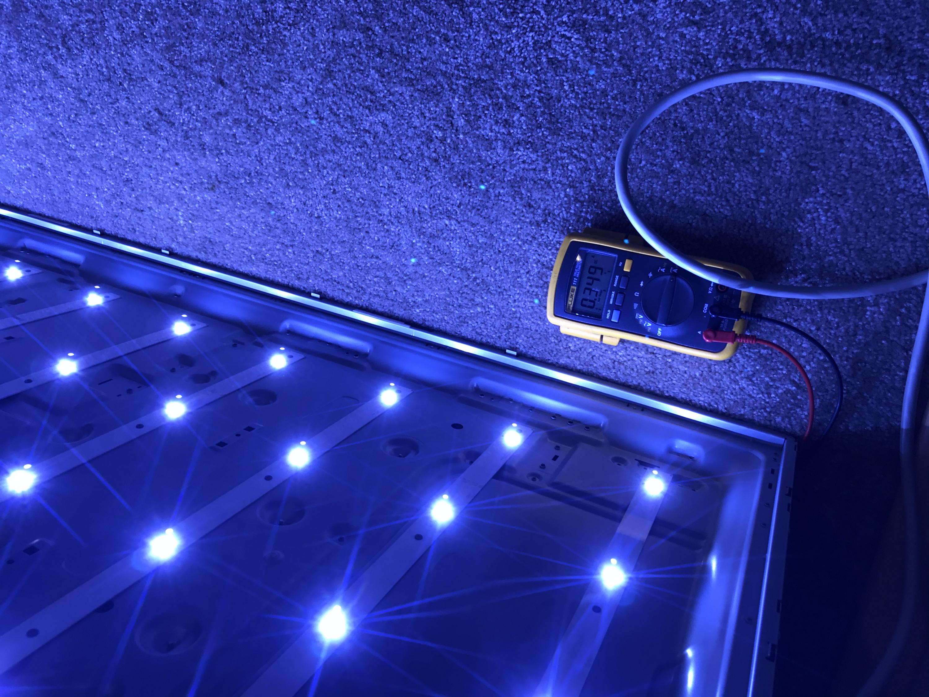

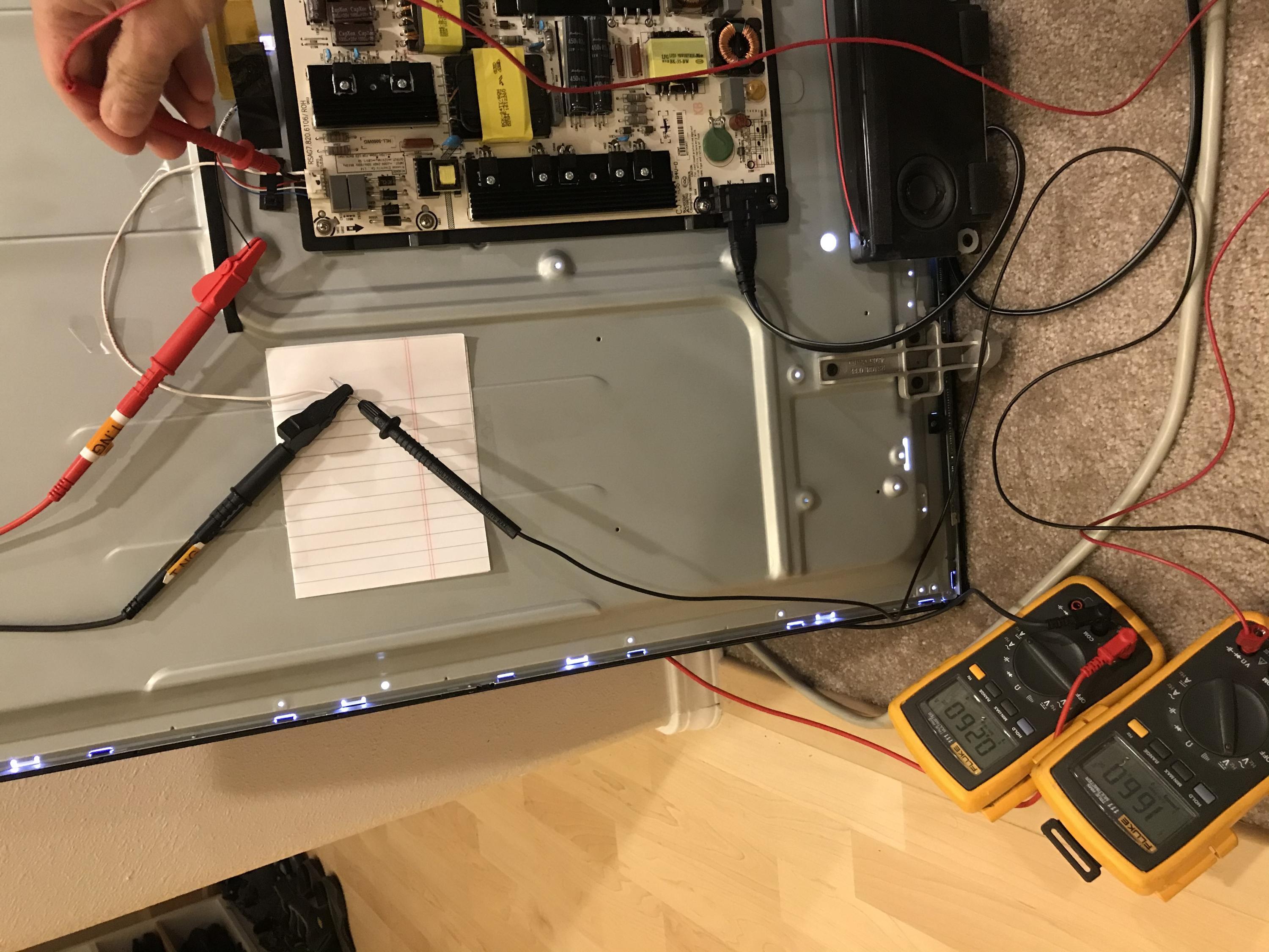

                        Finished. I made a second mod to the SMPS.
                        I changed the effective resistance of the ISNS resistor to GND equal ~0.91 Ohm (nominal). In all, i removed a 2.2 Ohm and a 5.1 Ohm resistor from the back side of the SMPS. (The left most two resistors as shown in the first image in the previous post)
                        This set the string voltage to 163V, and current to 222 mA per string at full brightness. 6.52V * 222mA = 1.45W per LED.
                        When I set the brightness effectively down to "0" - The avg PWM voltage on the DMM is 132V @ 29mA.
                        Moral of this story should go: check the darn LEDs carefully before removing them in a rush and double check the assumptions of the SMPS and the LED string configuration. I could have saved myself a lot of headache and time from the beginning.
                        I'm glad it works and I can hang this on my garage wall knowing it'll work.

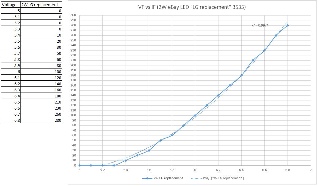

                          Here's the Vf vs If chart for the eBay 2W LEDs for future reference.
                          For the measurements, this was mounted on a LG compatible footprint LED strip.
                          Purchased here March 2020: https://www.ebay.com/itm/223494097714
